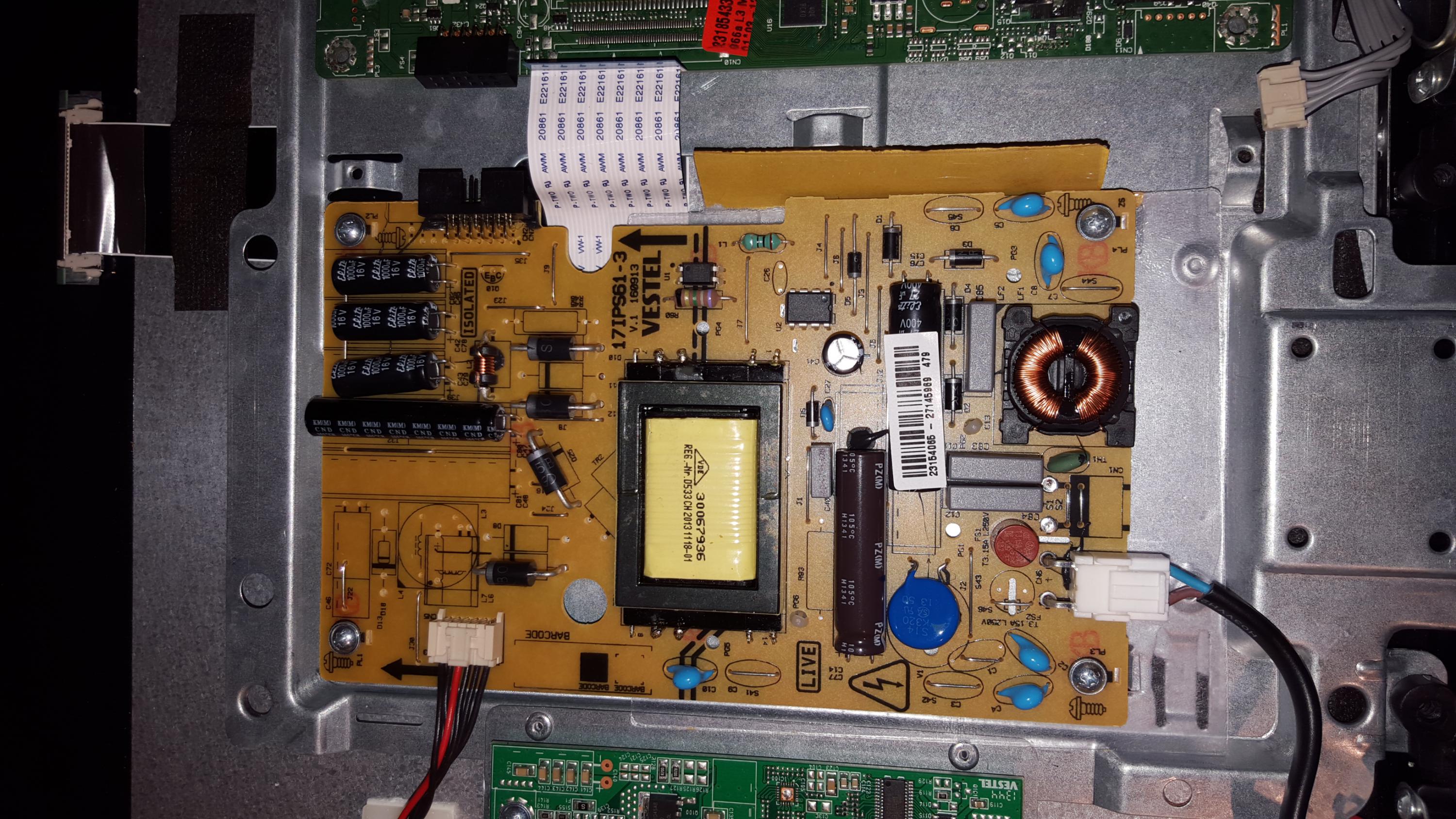

    Bought this tv tonight but stuck in standby mode just standby light flashing all voltages tested good,so searched around for a main board but as usual nothing.But searched around on google for any firmware updates and found a upgrade_loader.pkg for vestel boards 17MB82S installed this onto the usb and kept pressing OK on the remote via the IR sensor and after a few attempts it alive

    Nice fix, care to share the file here? Or a link to it?

      http://www.vesteldriver.com/TV_ANASAYFA.html
      LED TV MB70 (CORE UPDATE)
      LED TV MB82 (V.0.6.6A CORE UPDATE)
      From here tom tv working fine now but i have noticed one thing the dvd drive does not work now maybe it was faulty when i bought it but thats another thing i need to work out

        Update::
        tv still working but it seems theres a fault still,Dvd player does not work and if you use scart lead the tv will not boot up unless its unplugged but hdmi seems fine maybe the LED TV MB82 (V.0.6.6A CORE UPDATE) is not right one for this tv

          Just testing voltages and all caps from the PSU are low and the voltages to the DVD player are only 3 volts
          does anyone have a idea why voltages on the power supply are so low ?
          thanks
          Power supply 17IPS61-3
