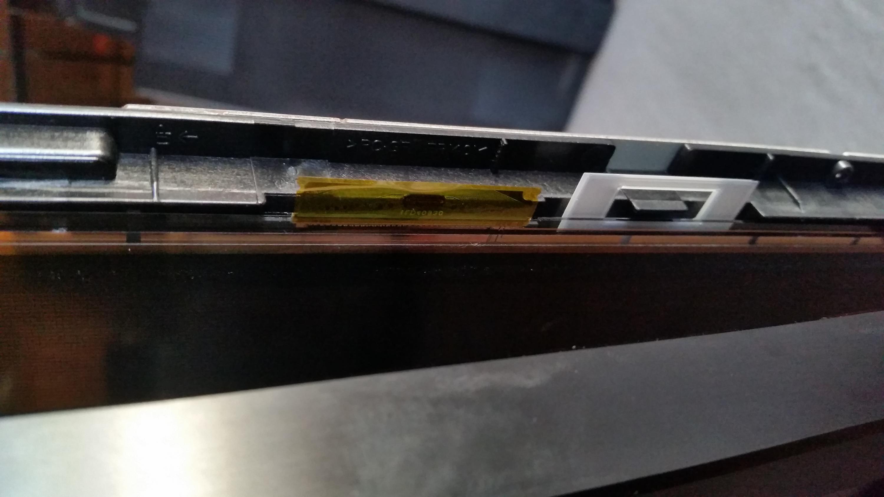

          Re: Sharp LC-70LE757U flickering display
          Yes it had one line, it look like half screen from left to right like it bearly getting to the right, but it stop like half way of screen.the other black lines were the flickering it was doing. I already remove the tab bonding directly from the screen,it was though job to do, because of the side protective aluminium trim. Well any was it was fix I was like woow new tv. I wonder why ,but we'll it is go quality tv for to watch fifa games jeje......I got another 80 inch tv sharp LC-80LE757U ...the this is doing it has a line it is weird line it do like tranverse the picture it's thin and long from right to left and it is like half of the screen like if she wanted to get to the left, but she stoped at Half way horizontal....
            I got a tv, but this is a 80 inch sharp. LC-80LE757U the driver it self does not have board like the 70 inch sharp...it is just a tab with driver only, it has 4 on each side of the panel how this work....am thinking that instead of adding a board there use drivers like jump one to another and connecting with the bottom tabs. I can see veins running from battom to the top drivers. I don't know if am right. ........??????need help in this one bit different as the 70 inch .......

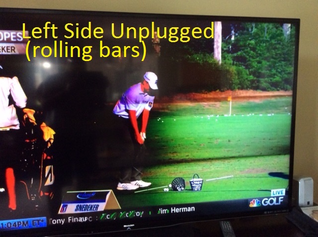

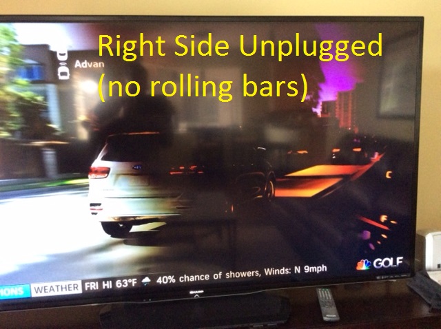

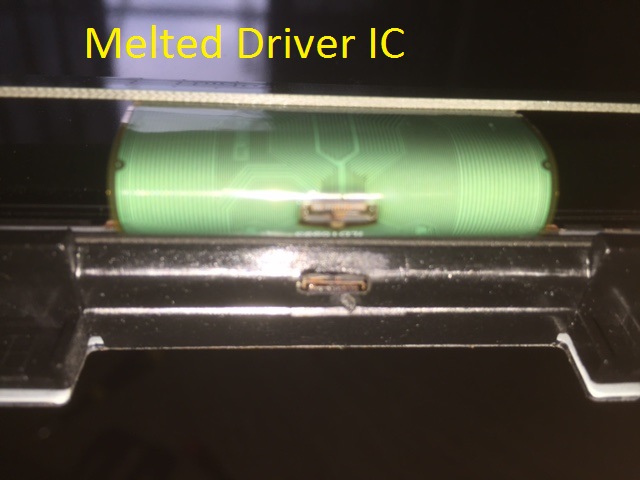

                  Hi guys,
                  For those of you that has peeled off the left side ribbons that go directly on the panel to fix the common issue on this set is the repair still holding up? just wondering how long a repair like this lasts. Please advise.

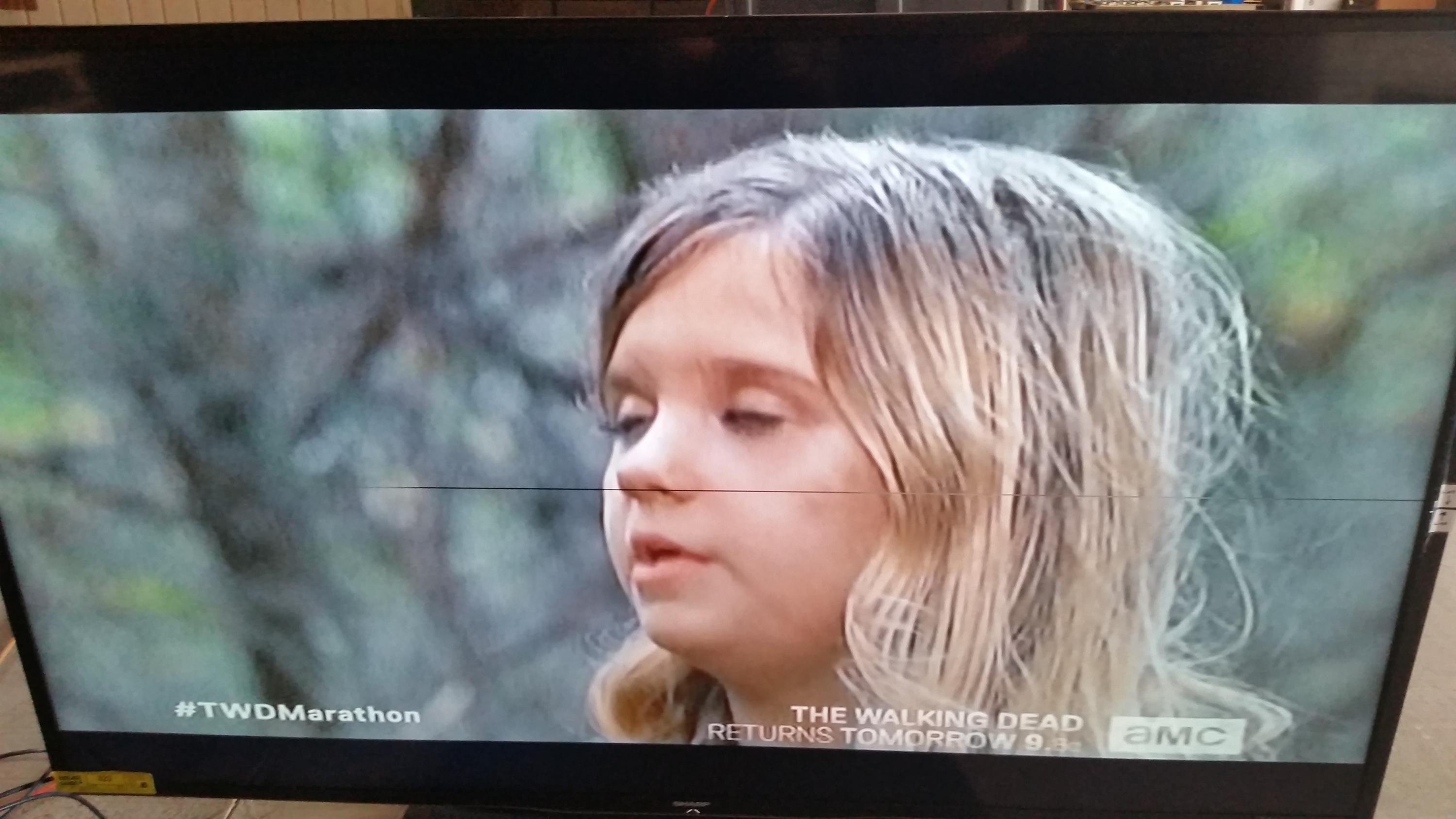

                        I have the EXACT same TV (LC-70LE757U) as grizgza started this conversation with and the EXACT same issue. I have read this thread several times and am only confused as to how to get access to remove the ribbon cables from the panel. Do I need to take off the outside bezel to get access or just loosen the driver board and pull the flex cable loose?
                            Not finding any useful videos to help me remove the offending TAB. I see some posts here which say "tear it off". Is that really the only way?

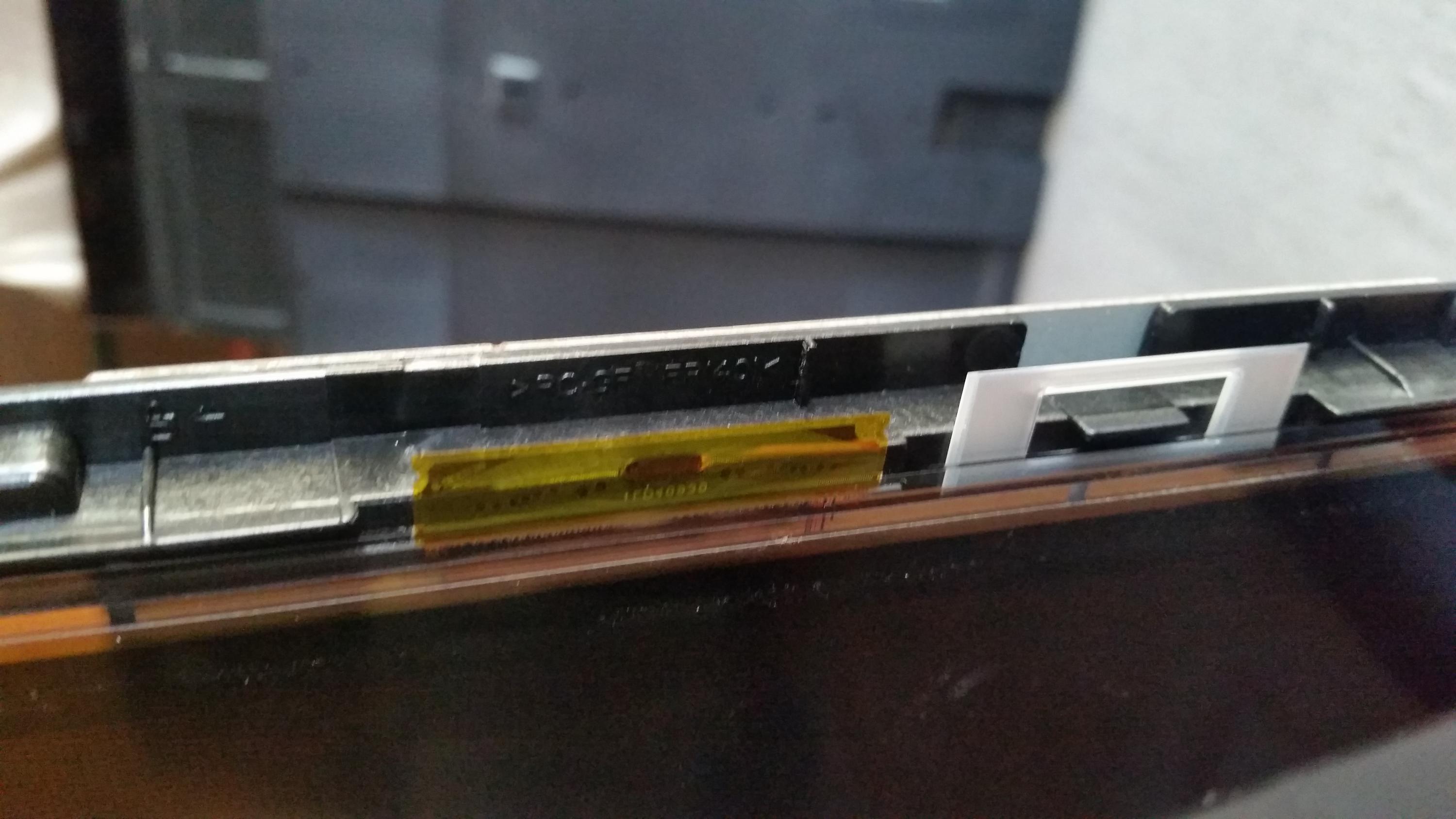

                                #35
                                budwich,
                                The only reason I am thinking about doing this is because of your efforts. Thanks for asking so many great and detailed questions and thanks to the BADCAPS community for being so helpful.

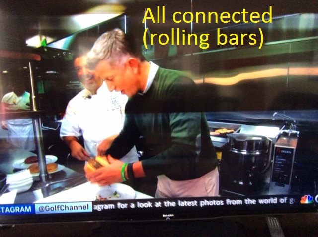

                                Here are 3 photos of my situation
                                One with everything connected, one with the left side TAB driver board disconnected at the bottom white ribbon cable and one with the right side TAB driver board disconnected (left is re connected) at the bottom white ribbon cable. Since this is non-recoverable I just want to be sure I do the correct side. I am thinking it is obvious that the right side needs to come off - agree?
                                • budwich
                                  • Jul 2015
                                  • 3097
                                  #36
                                  it would appear that indeed the right side (looking from the front of the set) is an issue. As I always suggest, you can do yourself a favor (and piece of mind) by feeding a known test pattern into your set (color smpte bars, equivalent... which can be found in a number of dvds for helping with tv setup)... this will show a picture that is then known to the forum which may highlight other things as opposed to a "running video unknown" video which might be hard to pick out issues from. Anyways, make sure your set is well supported when you remove the frame to get at the tab driver cables as any flexing in the panel will likely bring you to "disaster" in terms potential panel cracks.
                                  If you are successful, like most others, you will be enjoying a beautiful picture again.

                                      #38

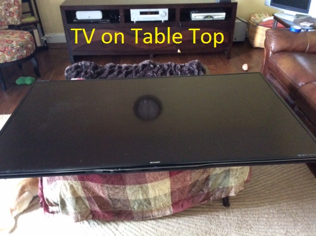

                                      Not sure how people work with the tv on carpet.
                                      Basically, I worked on the 70" on a "table top", facing up. :-) This allowed me to unscrew all the bezel screws and lift it off..
                                      I used "wooden standoffs" (2X4 "blocks") strategically place on the "backside" of the set to raise it off the "table surface".... placed on the various empty metal backing plate and frame cross members. The "table" surface was less than the area of the tv. The "wood standoffs" were screwed / attached to fence boards which ran across the table to give "overall supporting footprint" for the table.... basically a support "skeleton" Let's say the table was 3'X5'. The boards and standoffs could be readily position to support most of the set and still allow you to unscrew the bezel from the backside and lift it off. Of course you first have to removed the back cover along with some of the other stuff (speakers). It allows you to leave the boards connected if you chooose your wood pieces wisely... :-) Because the set's bezel and frame are still mostly intact, the set does not flex too much but you still have to lay onto the table / "skeleton" with help and care... gently tipping onto its back.
                                      I am sure there are others ways but for me that was the easiest way as I had the wood pieces around.
                                      I think you might be able to re-attach the stand (if your unit has one), after the back has been removed. The you might be able to stand the tv up on its stand and work from there with a vertical panel... only conjecture on my part.

                                        #39

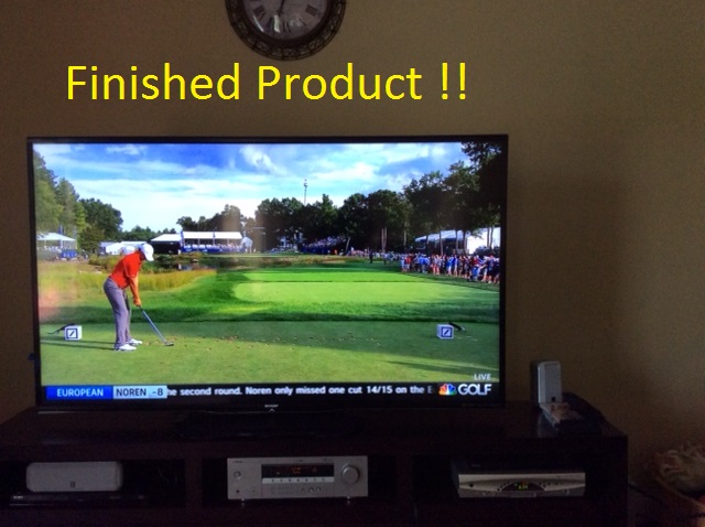

                                        Change the name of the site to BADASS. This site saved me big time. If you have a Sharp 70" LC and are experiencing this issue read this thread. Attached are a couple of pictures. I had a 40" x 40" table that I put the TV on face up and crawled around underneath the take the screws for the bezel out. I went all the way around taking out about 50 screws but as I found out when taking the side away that was unnecessary. I could have done just the side I needed and a few on top / bottom to get that side piece off. The other picture is of the offending driver IC which had melted into the plastic. The TAB bonds peeled off like tape. Re-assemble and I am back watching TV.
                                        Thanks to all.
