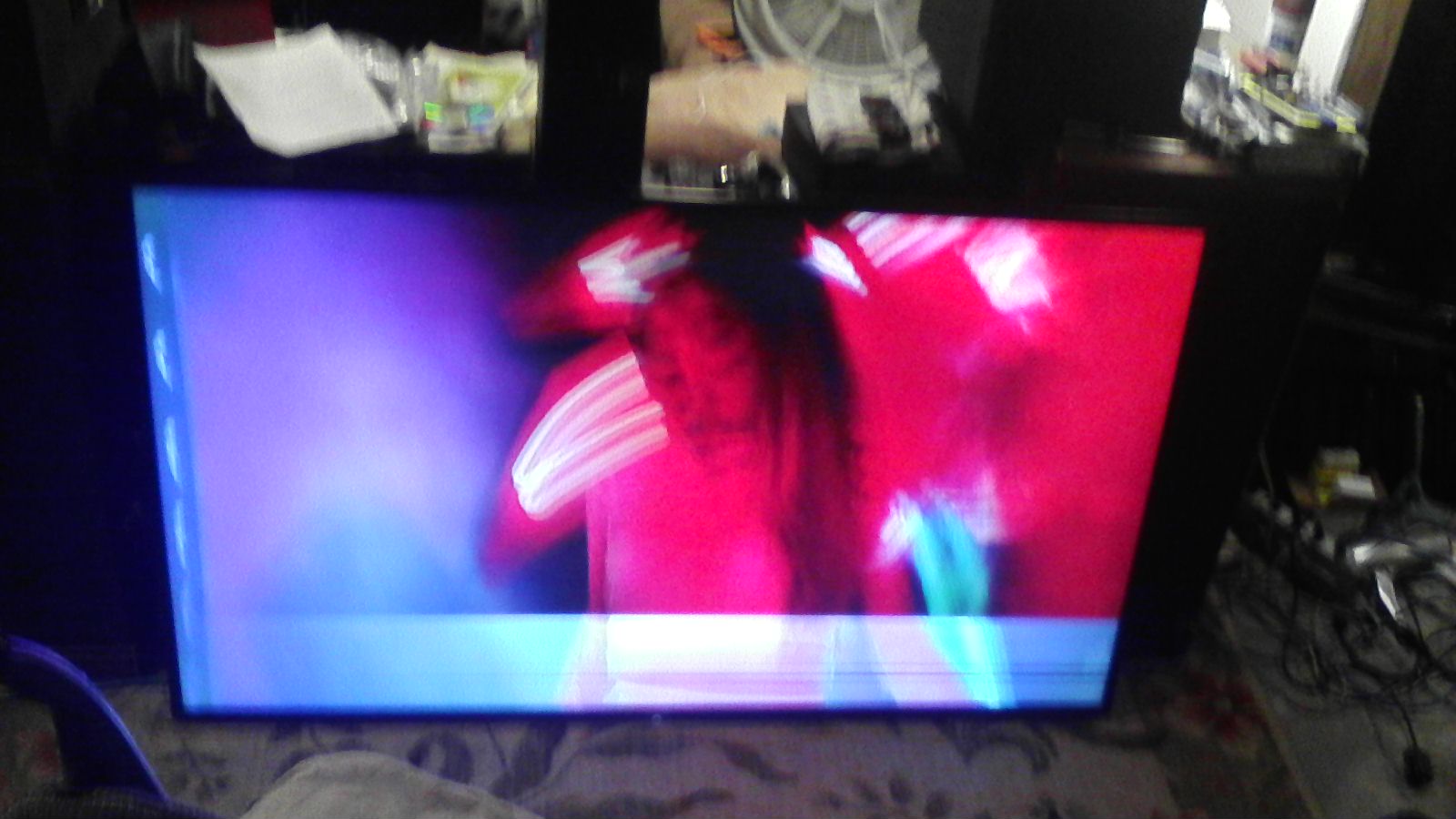

    I wish I had the same luck here everyone else had. TV is now junk. I posted it free on Craigslist Hartford CT for parts. He are pictures of my TV now after peeling the ribbon off.
      #42
      Re: Sharp LC-70LE757U flickering display
      I would say that you have some issue with the lower tab that was peeled but not clean... further have you disconnected the edged boards on that side by removing the corner cable. Of course, this is assuming the "poor focus" is the camera and not the actual set... :-)
      Further which side did you pull? based on the photo, it appears the right side (from the front view) has an issue.... check the lower right tab driver to ensure that the removal is clean.

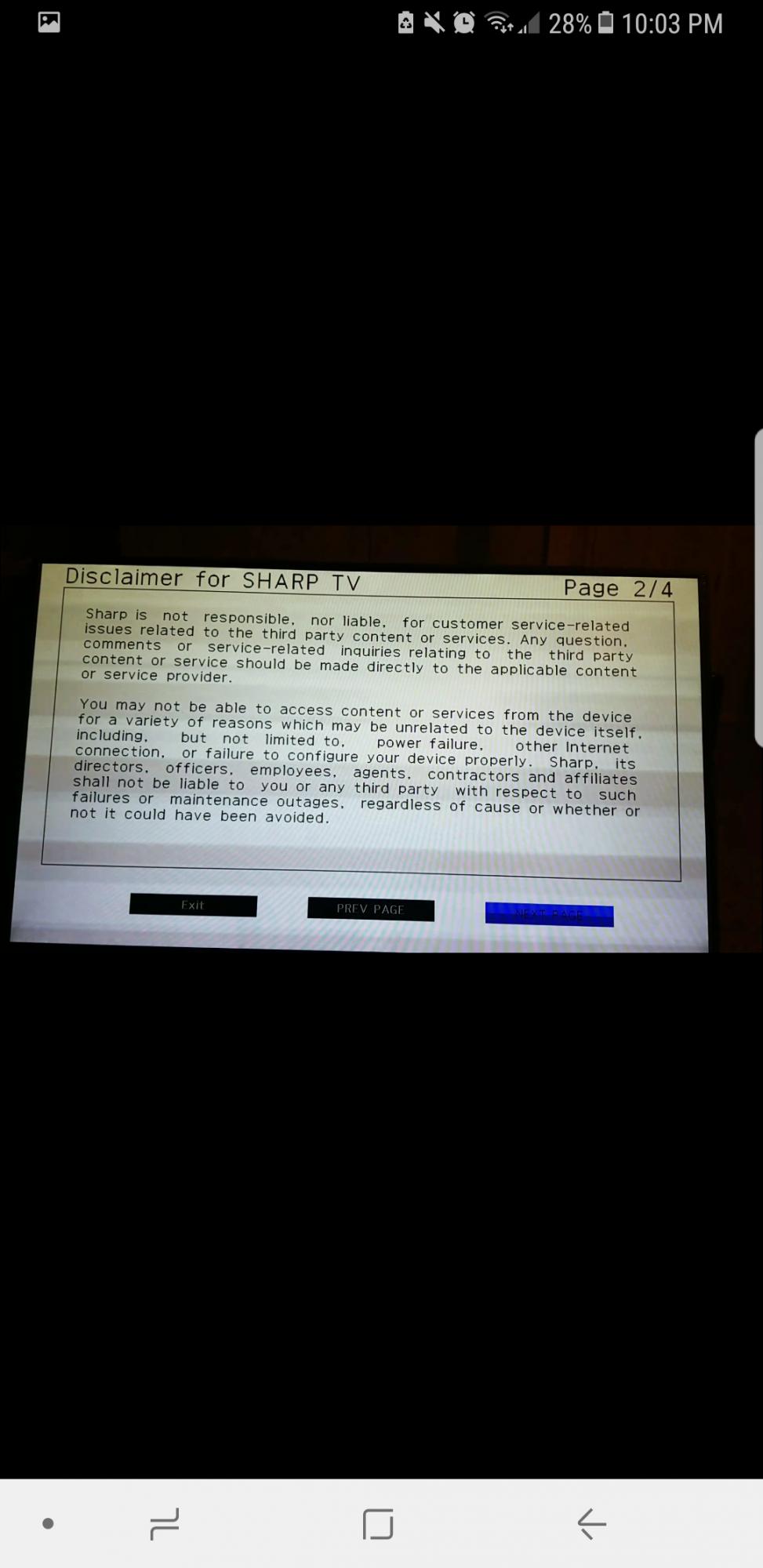

                          I have the LC-70LE757U, had horizontal rolling and flickering, after research and time decided the tab drivers were the issue on the right side (looking at front). I removed the entire right side tabs (all 5) - removed the board and lower ribbon cable that was attached to the right and bottom driver tab boards. No more flickering or lines.
                          ISSUE: The right side of the screen is "darker" that the left now, with the furthest right 1/8 of the screen being even "darker" yet.
                          The driver tabs contact points on the lcd appear to be very clean. I have tried replacing the power board (due to slight hum/buzz when powered, with no change in the issue).
                          Please advise.

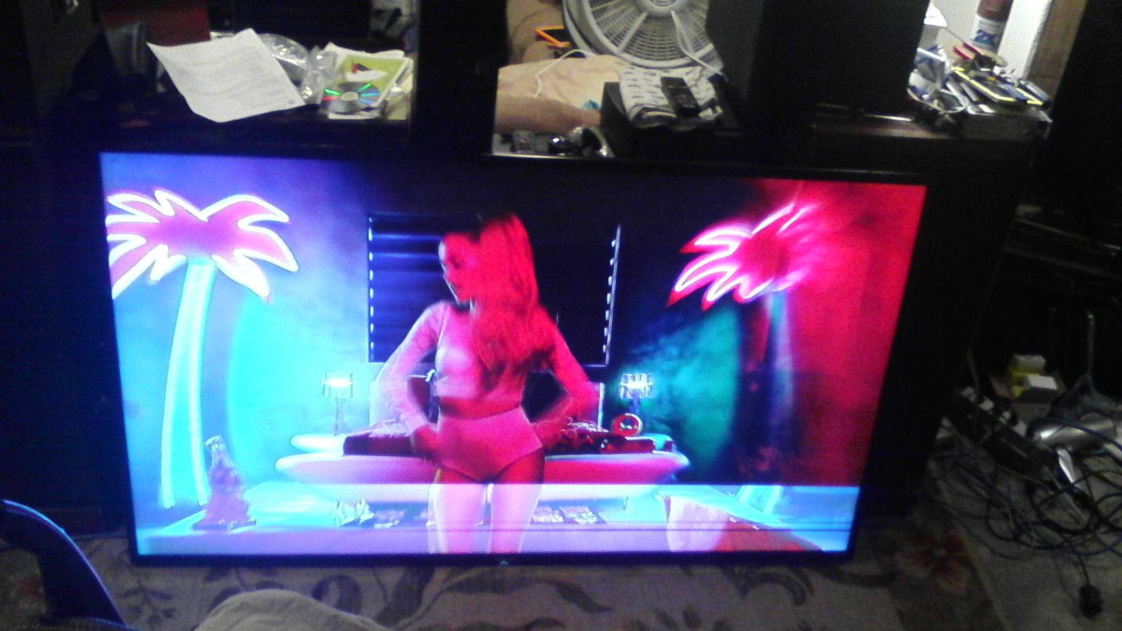

                            #53
                            A visual of the current issue after removing the right side tabs, described further in my previous post.

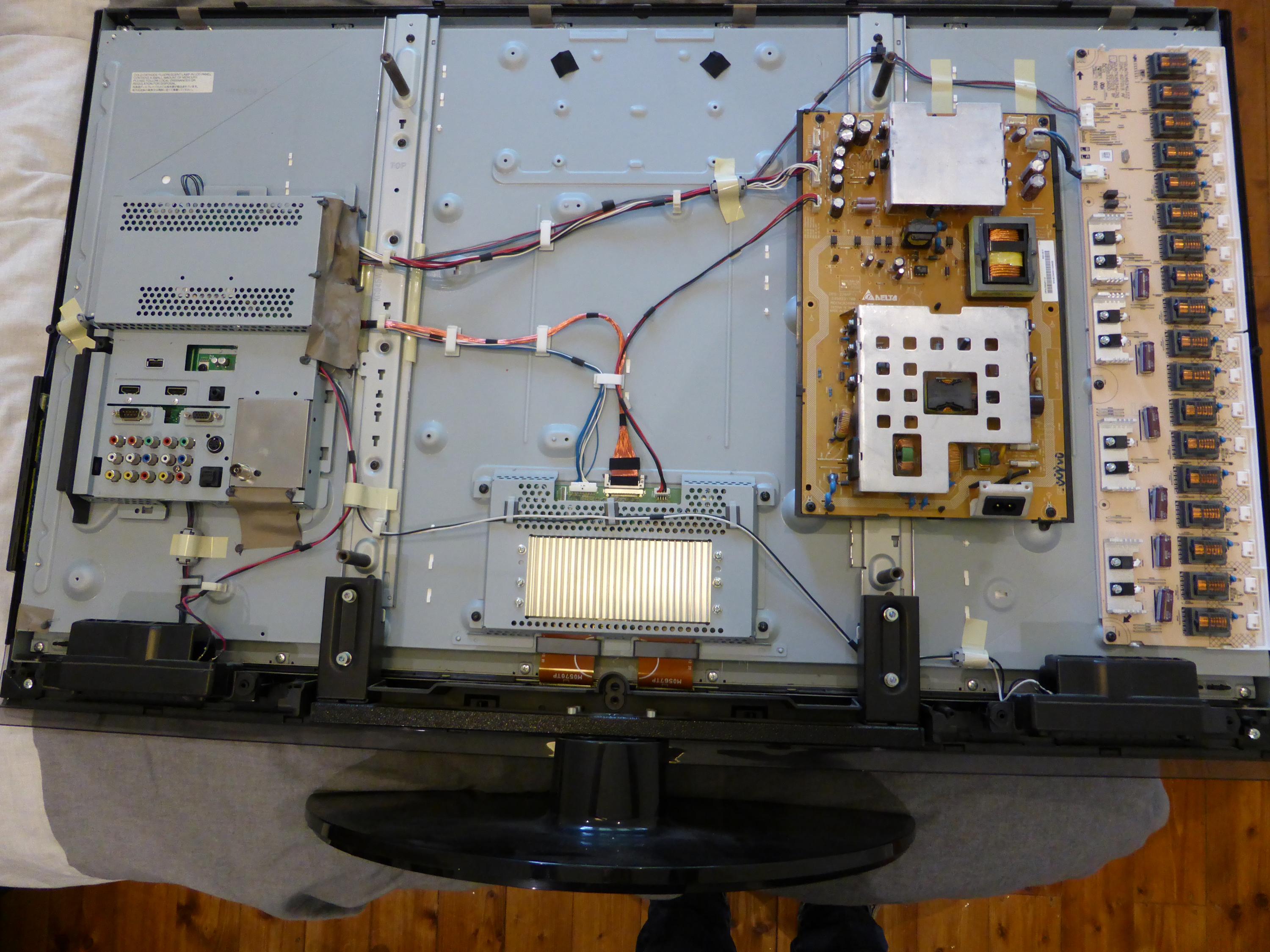

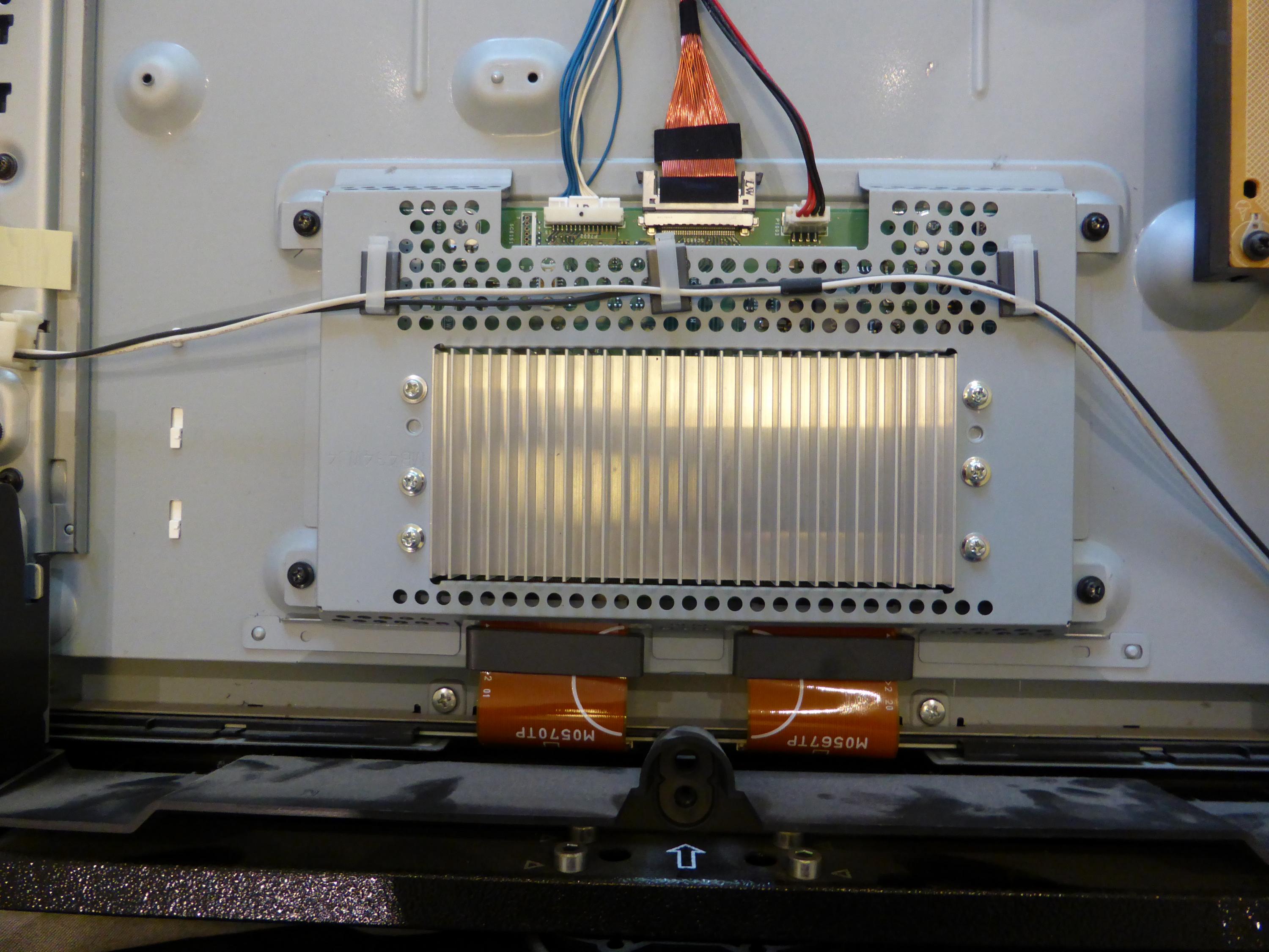

                                    Hi folks,
                                    New member so as yet unable to start a new thread for my problem so apologies for piggy-backing off this one!
                                    I've searched the forum and I'm unable to find instructions for troubleshooting/fixing my particular model, a Sharp Aquos LC-42D77X that I bought in about 2010, it's relatively old but was still a great TV but it developed a flickering screen issue about three weeks ago. The model this particular thread relates looks quite different internally and I was hoping for some guidance on how to troubleshooot and isolate the issue as well as how to gain access to the tabs referred to here. Note that I'm a complete novice in this area!
                                    I've removed the rear panel and reeated all the connectors that I can see to no effect. The T-Con on my model is in the middle at the bottom and has three connections on top and two wide ribbon connections on the bottom. I've attached pics for guidance, hopefully someone can guide me through this! Any assistance greatly appreciated.
                                    Cheers,
                                    Davy
                                      #58
                                      Pics as mentioned...

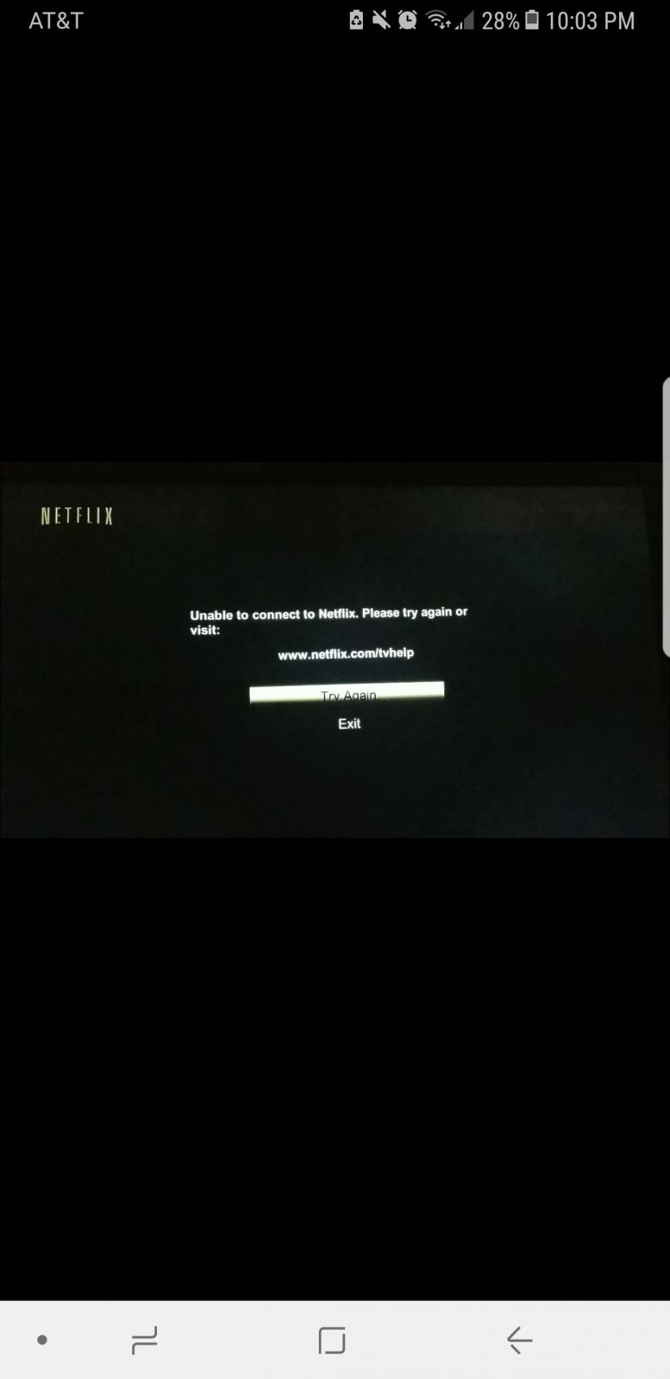

                                        Hey guys. Noob here.
                                        So I work as a driver for a major shipping company. Went to make a stop I saw a 70" sharp tv with a free sign. I get off deliver their package lady comes out so I ask about it. She says take it's it's free. It has these lines across the screen sucks it went bad a 13months of ownership 1 month after warranty. She said take it if you want. Of course I did. So came home plugged it in yeah there they are. Horizontal lines....
                                        Before I ruin this. Say I remove the back. I'm looking at the back side... will I need to remove the left or the right side?
                                        This is me looking at the backside of tv.
                                          #60
                                          can't tell from the "poor" pictures... :-( do some testing. find the small corner cable on either side. they are unclampable / clampable. Disconnect one of them (while not powered), power up and look at the display (get a good picture with an input signal of some sort of test pattern hopefully). Do the same with the other side. Post pictures of the display and go from there.
