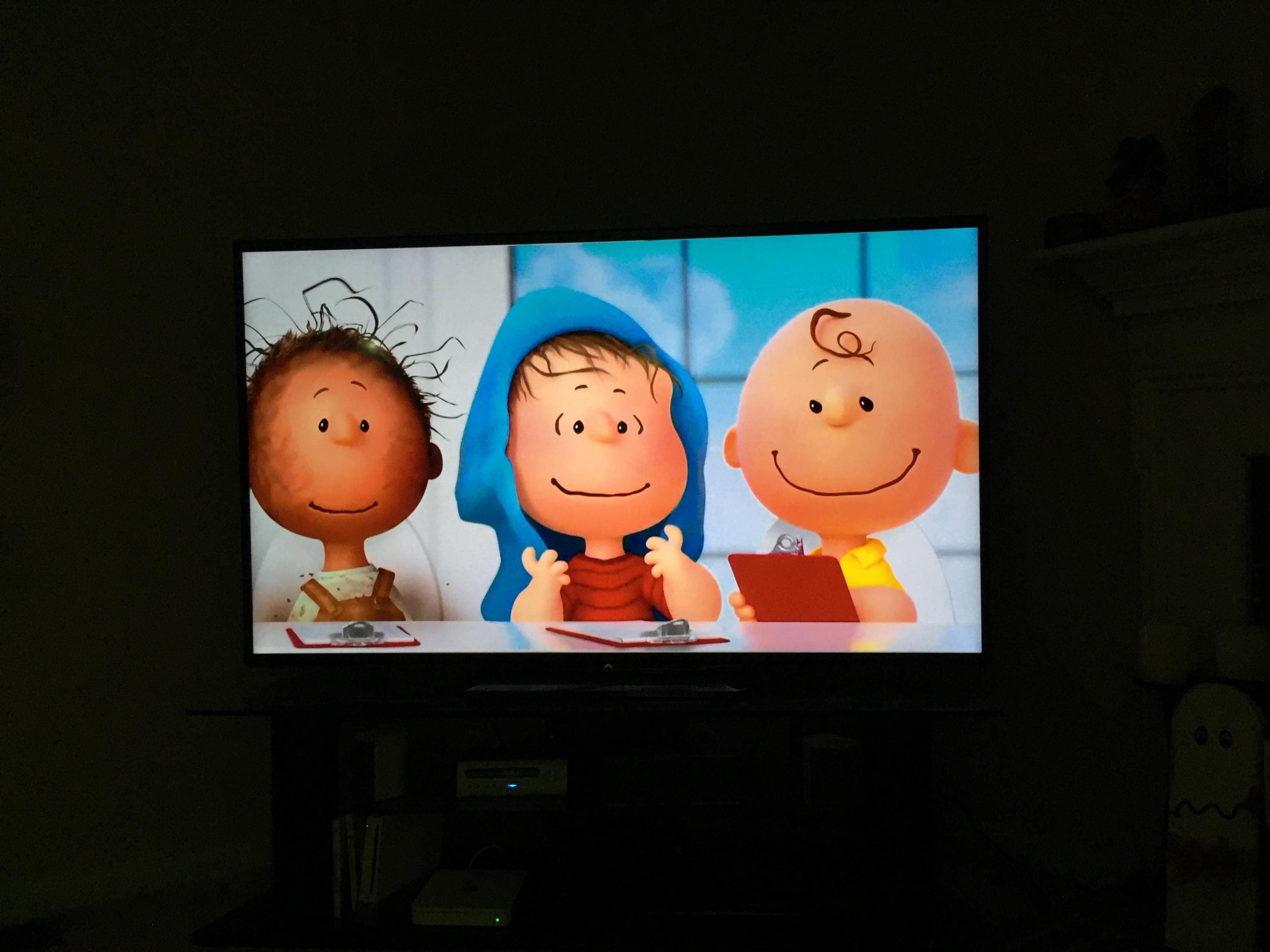

                                So I went ahead and removed the left side driver tabs from the lcd panel. And BOOOOOM it worked! Perfect picture across the screen.
                                I realize this is more of a salvage than a full repair, but I'm happy. The drivers on the other side will likely eventually go, maybe sooner than the last ones because they are doing double duty, but the set was given to me and any time I get out of it with our family I'll be happy!
                                Thanks for your help guys. Without your help and the other thread I would have never know to try this.

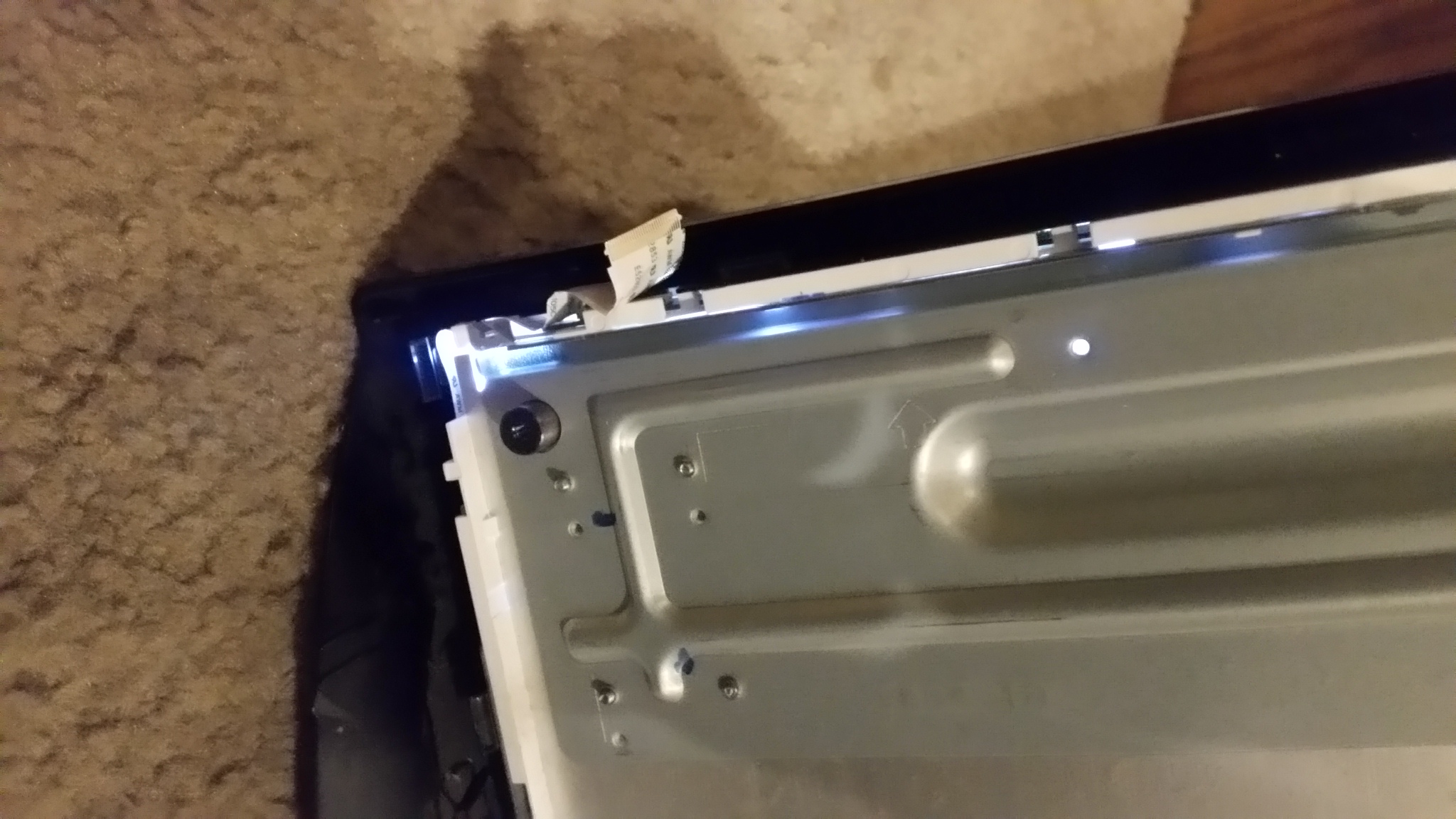

                                    Nice! Here are pics of the left-side drivers removed and the TV working like new.
                                    Watching Monday Night Football and it looks glorious!

                                        but if you remove them? why still picture it suppose to control the left side. add pics were you removed them. i have the same problem tv is working good it doesn't turn off. after i read your comments i though i was a bad t_con i have try on other tvs with horizontals lines and it was of bad t-con and i went by that. i disconnected one side on the t-con LC-70LE757U an it works good and i reconnected and flickering started. so tell me more about whats the function of driver guide me a bit to fix this tv thanks......
