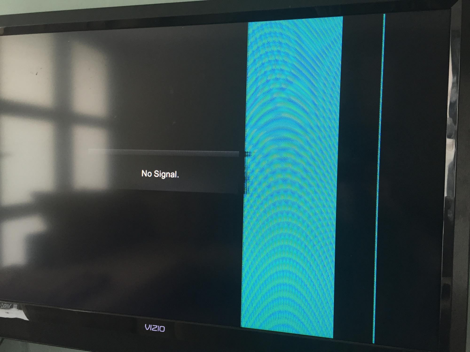

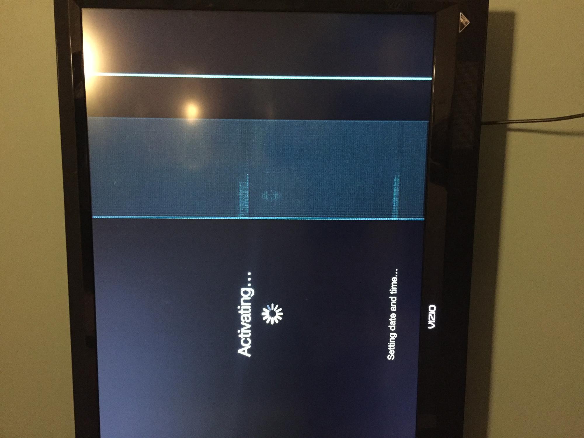

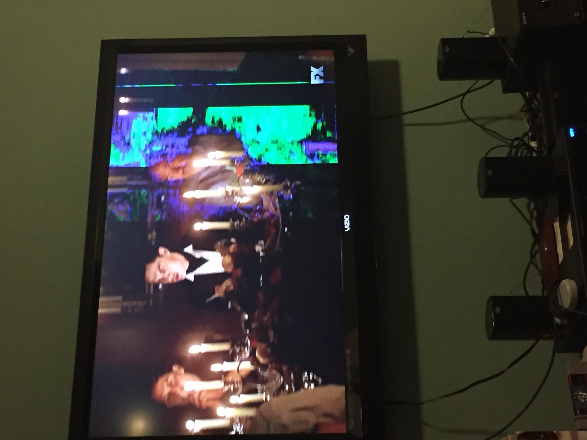

    Hi guys! Im trying to troubleshoot my vizio E470VL, i had the main board go bad once do to a power surge and i replaced with a used one i got from ebay, that was about 2 years ago, now i have this cyan/bluish/greenish bar on the side of the screen, it was going away after 1-2hours but now its not going away anymore, its more noticeable with some colors and less noticeable when something of a lighter color shows ups, i dunno if this might be the power supply board or the main board or the lcd itself, any help is greatly appreciated!

    Sorry for the repkys with picstures, it does not let me upload all at once

      Sorry for the replies with pictures, it does not let me upload all at once

        I believe that model has the main board and t-con board built into 1 unit. I'd say replace it. But before I do that try disconnecting and reconnecting all the cables to make sure you don't have a bad connection. This does not look like the panel has failed

          tab bonds

            Thanks for the replies! Yes i just tried disconnecting a reconnecting everything and nothing, so the lcd panel should be good and it should be the main board then? Is that something that canbe fix or it would need to be replaced?
