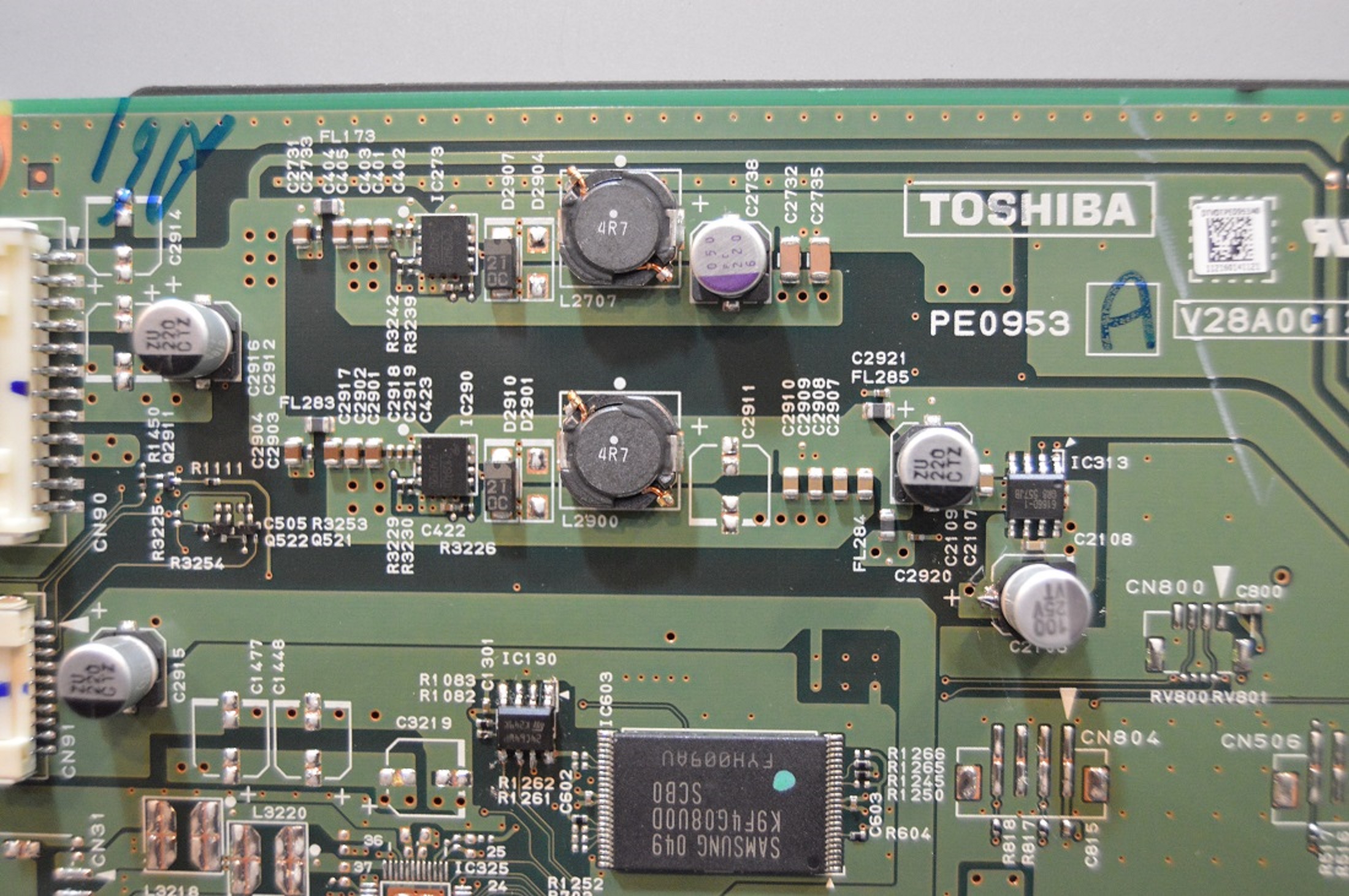

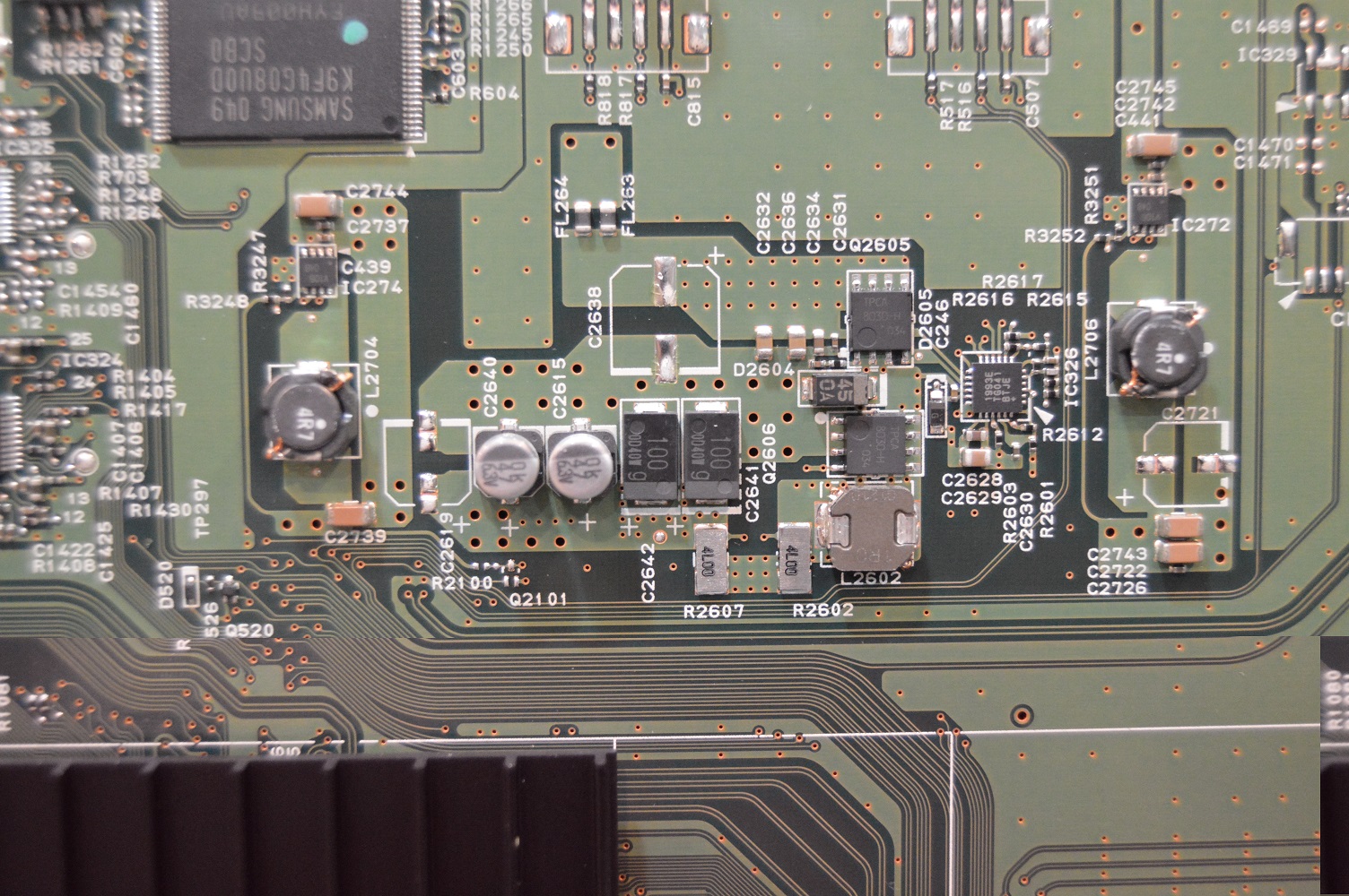

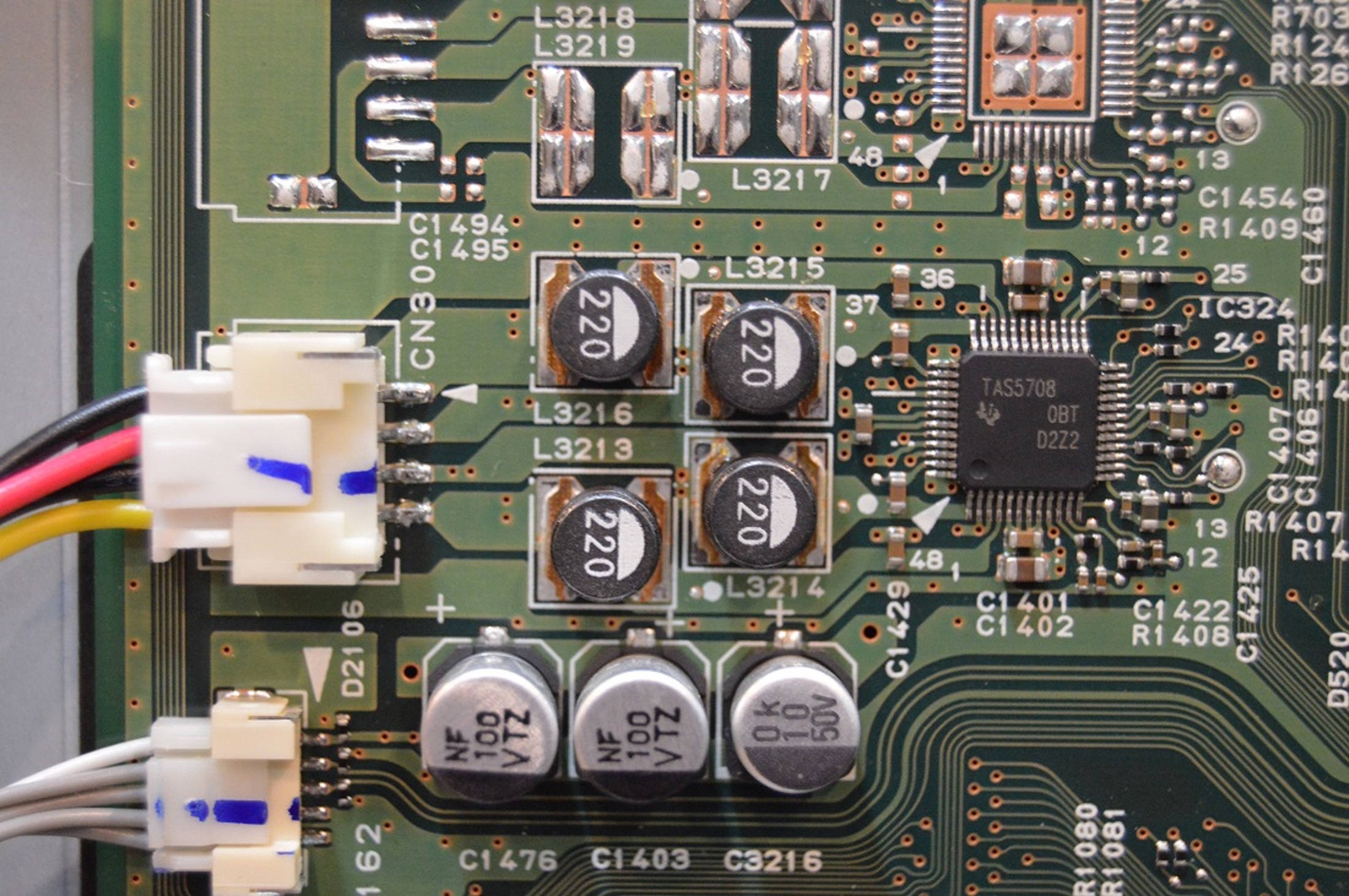

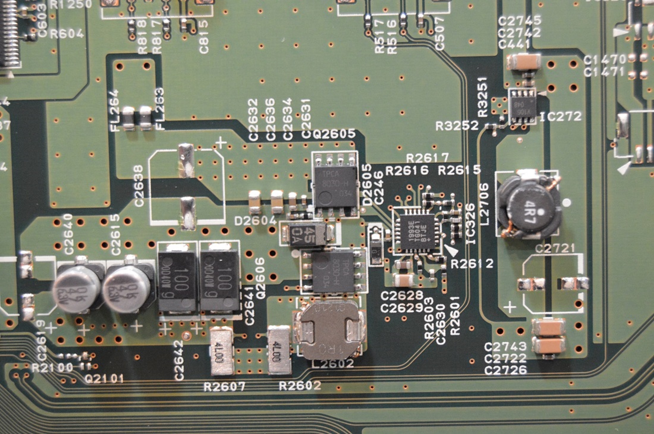

              I would measure the voltages at the regulators on the main PCB.
              IC273, D2907, L2707, C2738, C2732, C2735 constitute a stepdown DC-DC converter. Measure the output voltage across the capacitors (C2738, C2732, C2735).
              IC290, D2910, L2900, C2907-2910 constitute another stepdown DC-DC converter. Measure the output voltage across the C2109- C2107 capacitors. These are just after the FL285 inductor.
              IC313 appears to be a linear regulator. Measure the voltage at the 100uF smd capacitor just below it.

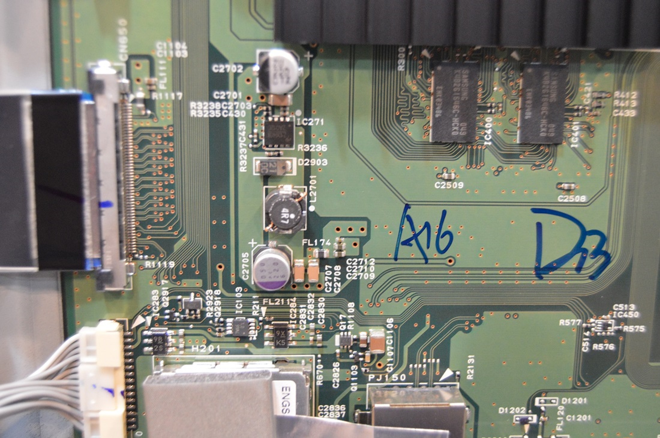

              There appear to be 3 more stepdown regulators near the CPU. Measure the output voltages at each of the 3 coils.
              There is at least one more stepdown regulator near the tuner. Measure the output voltage across the C2705, C2707, C2708 capacitors, and the voltage on the other side of FL174.
              There could be more regulators (IC327 ?), but I can't see the PCB clearly enough in any of the photos.

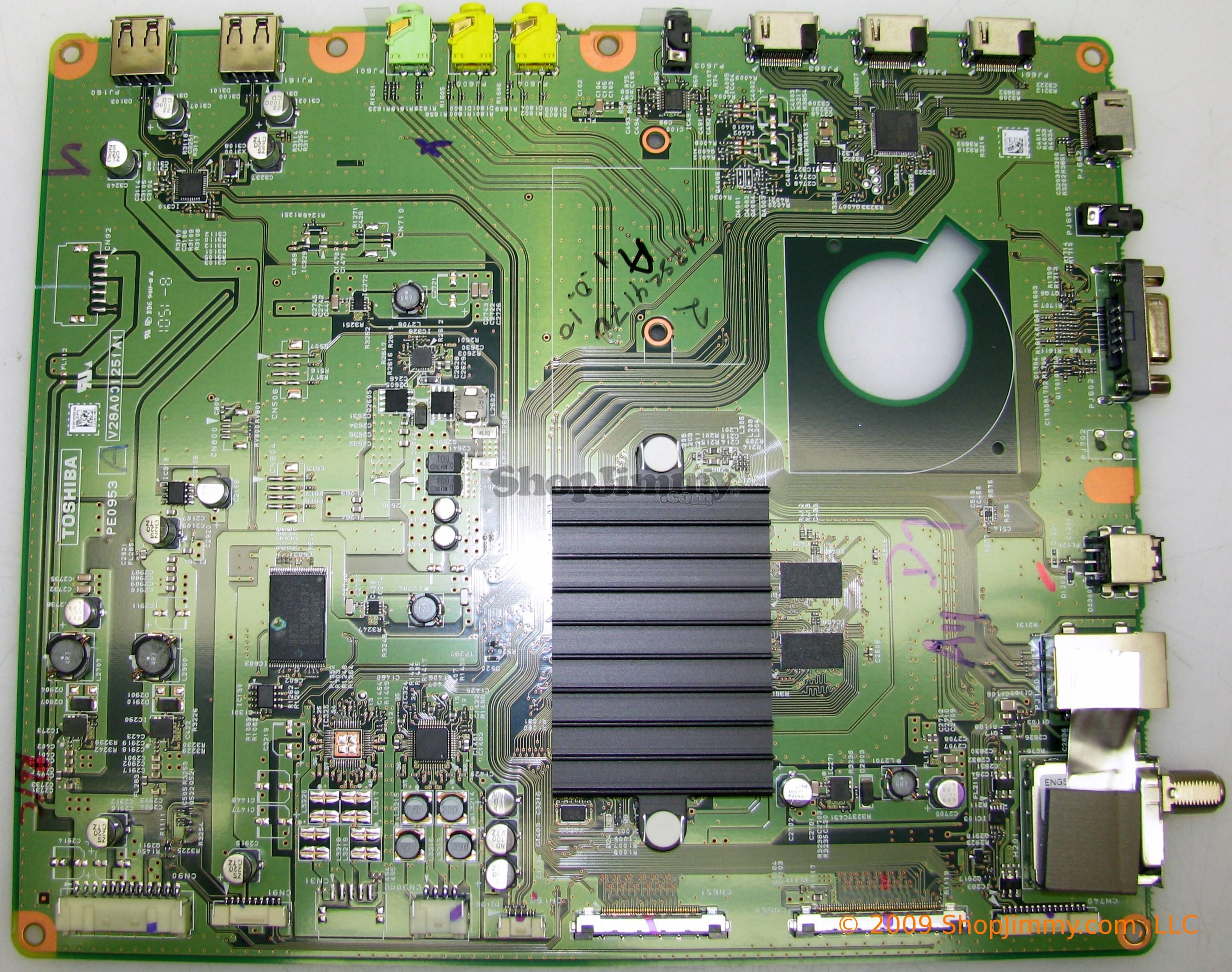

                Re: Toshiba 46sl417u main board issue
                Did you already try heating (hair dryer) and cooling (using canned air duster upside down) the board?
                Try disconnecting the WIFI card?
                    It's not really that complicated.
                    The main board is based around an SoC (System on a Chip). The SoC and its peripheral components (eg SDRAM, EEPROM, flash) run from lower voltages. For example, the SDRAM typically requires 1.8V, the EEPROM/flash requires 1.8/2.5/3.3V, and the SoC requires a Vio voltage (3.3V) and a Vcore (~1V - 2V).
                    These voltages are generated from the main supply by switchmode DC-DC converters or linear regulators. You can identify the switchmode converters simply by looking for coils. In a stepdown converter the output voltage will be present at the coil. A linear regulator typically has 3 pins, Vin, Vout, and Vadjust or Ground.
                    When testing a CPU based board, you first check the onboard supplies. Then you look for the reset signal at the SoC and verify that the oscillator (usually a crystal or crystal oscillator) is functioning.

                        I don't have a schematic for this board I did go around and test a bunch of the sections of the main board and found the voltages you mentioned in your last post. what I am lacking is the 12v on the t-con connector cn652 pins 1-4. how do I check some of the oscillator functions? That might be getting a little deep. I have a scope and hot air soldering station also if that helps.

                          I tryed heating and cooling, and disconnecting the wifi card with no luck.

                            Your voltage readings are unhelpful. Sorry, I can't help you.

                                  Is there anyway you can give me some test points and voltages so I have a little direction to go hear. If it helps you I can go through all the caps you mentioned and tell you there voltages.

                                    The capacitors I mentioned are the test points that I would be looking at. So yes, their voltages would be helpful. A close-up photo of the three coils would help too.

                                      I'd be following that Blon pin backwards towards the main IC.

                                        The SoC appears to be braindead or stuck in standby mode.
