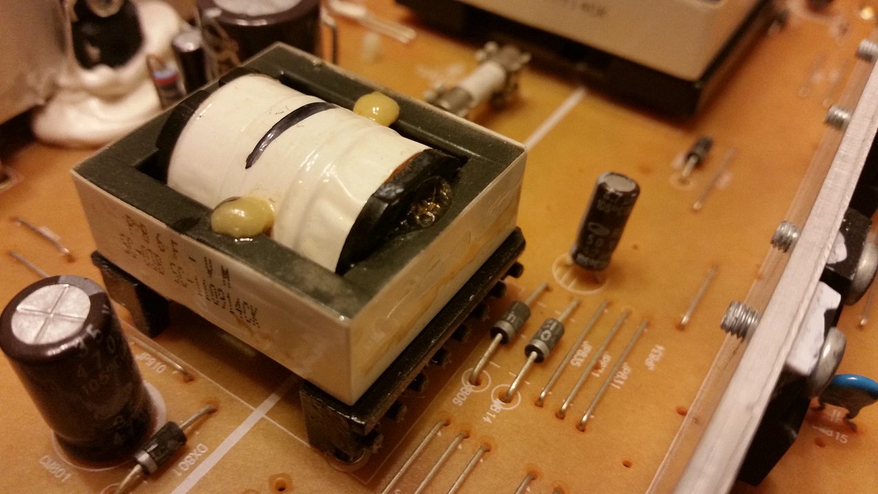

    About a week ago I picked up a Samsung 59 inch plasma that someone was throwing away. The model number is pn59d530a3fxza. When I attempt to power it on the red indicator blinks and it makes clicking noises. I know that Samsung had an issue several years ago with bad capacitors causing this problem. Please bear with me, I have very little experience troubleshooting at the component level. I did not find any bulging or leaking capacitors but it appears that one of the transformers is damaged. My problem is that I can't find any information with what I believe to be the correct part number. The power supply board is BN44-00445c PB6F-WVL. The board is stamped TX801S next to the damaged transformer and the transformer itself is labeled PB6F - VM. There are two other numbers (SC-03B and SC-110914CK) as well but those are also on other components. Can someone help me identify the part and possibly tell me where I can get a replacement? I have found a replacement board online but I'd rather spend a few bucks and hope it works instead of dropping $150 on a TV I know nothing about.
    Re: The Dreaded Clicking Sound And No Power On Samsung pn59d530a3fxza
    That is the transformer for the stndby power supply, so what DCV do you have on each pin of the CN801 connector? Make sure to give the pin number and pin names after each reading.

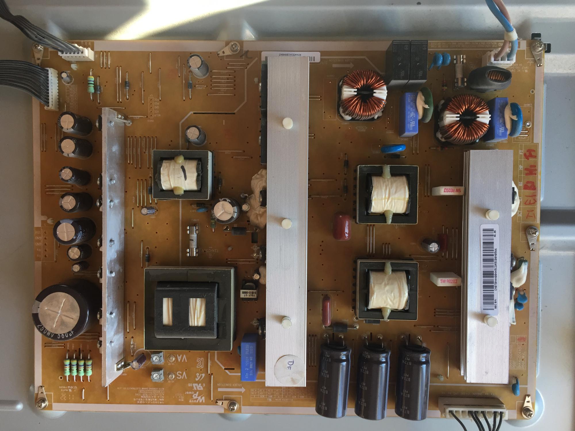

                      • Rodeo9ine
                        • Oct 2015
                        • 4
                        • U.S.
                        Sorry it took so long but here is the board photo, the capacitors that I thought would be blown seem fine...
                        • vinceroger69
                          • Mar 2012
                          • 6714
                          • uk
                          maybe worth checking/resoldering all the devices bolted on to the heat sinks some times these get dry jointed and crack at the soldering.
                            The tv gets the red power light, clickes when it turns on, then will stay on for about 3 minutes, then shut off and lose the red power light.
