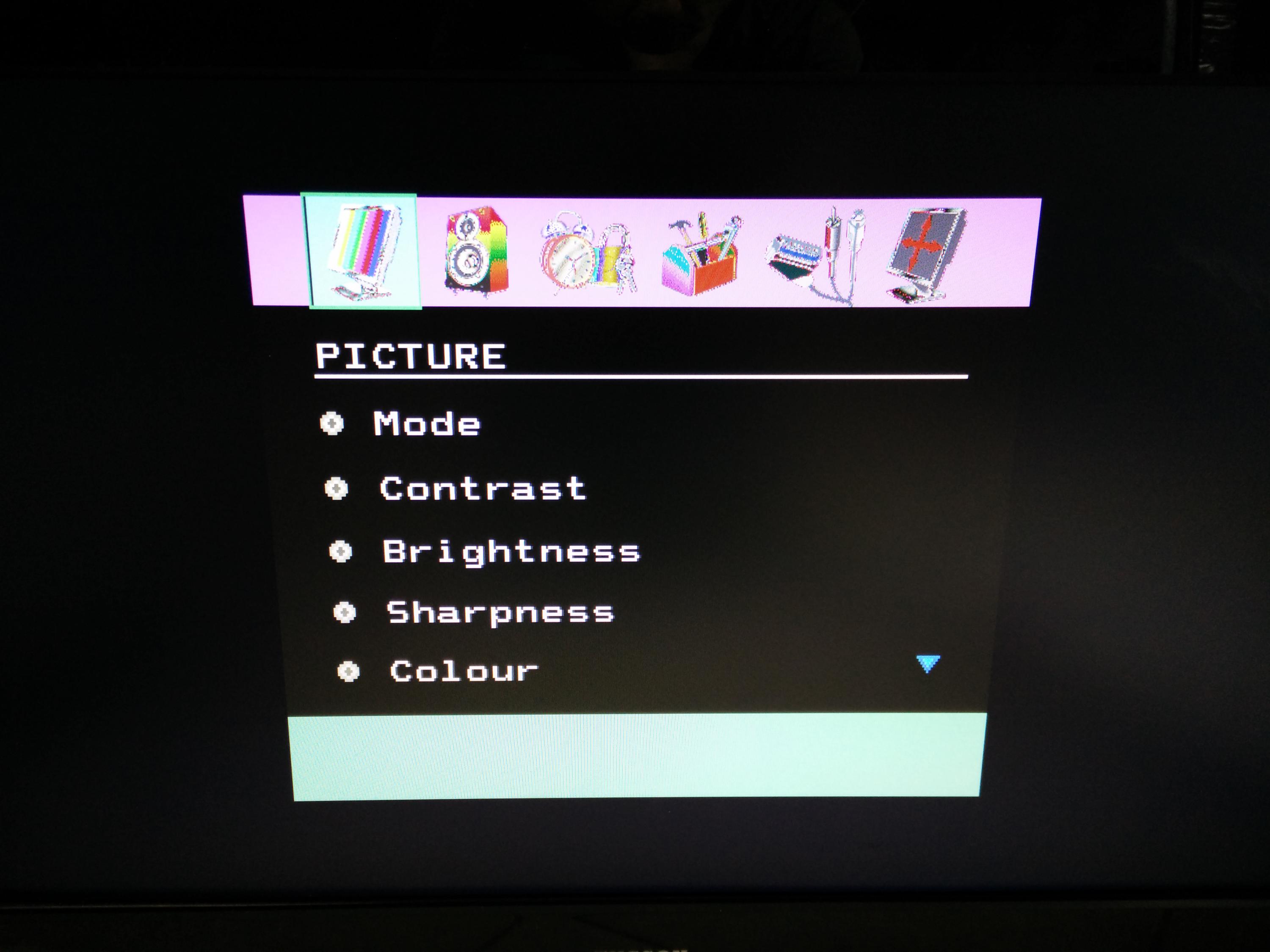

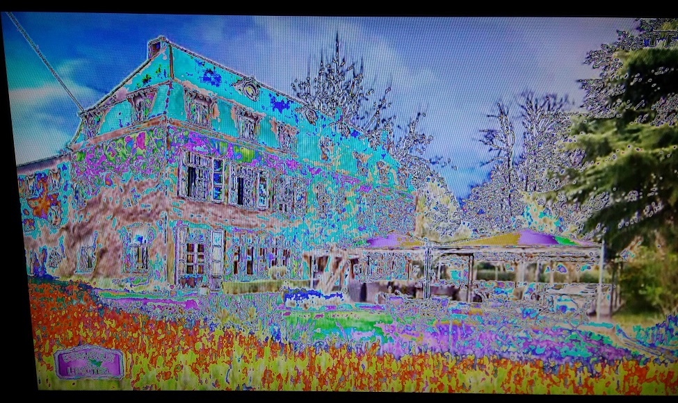

    i have a problem with a tv tucson 26HD782
    mainboard is a 17MB12-3
    colors are distorted (see photos )

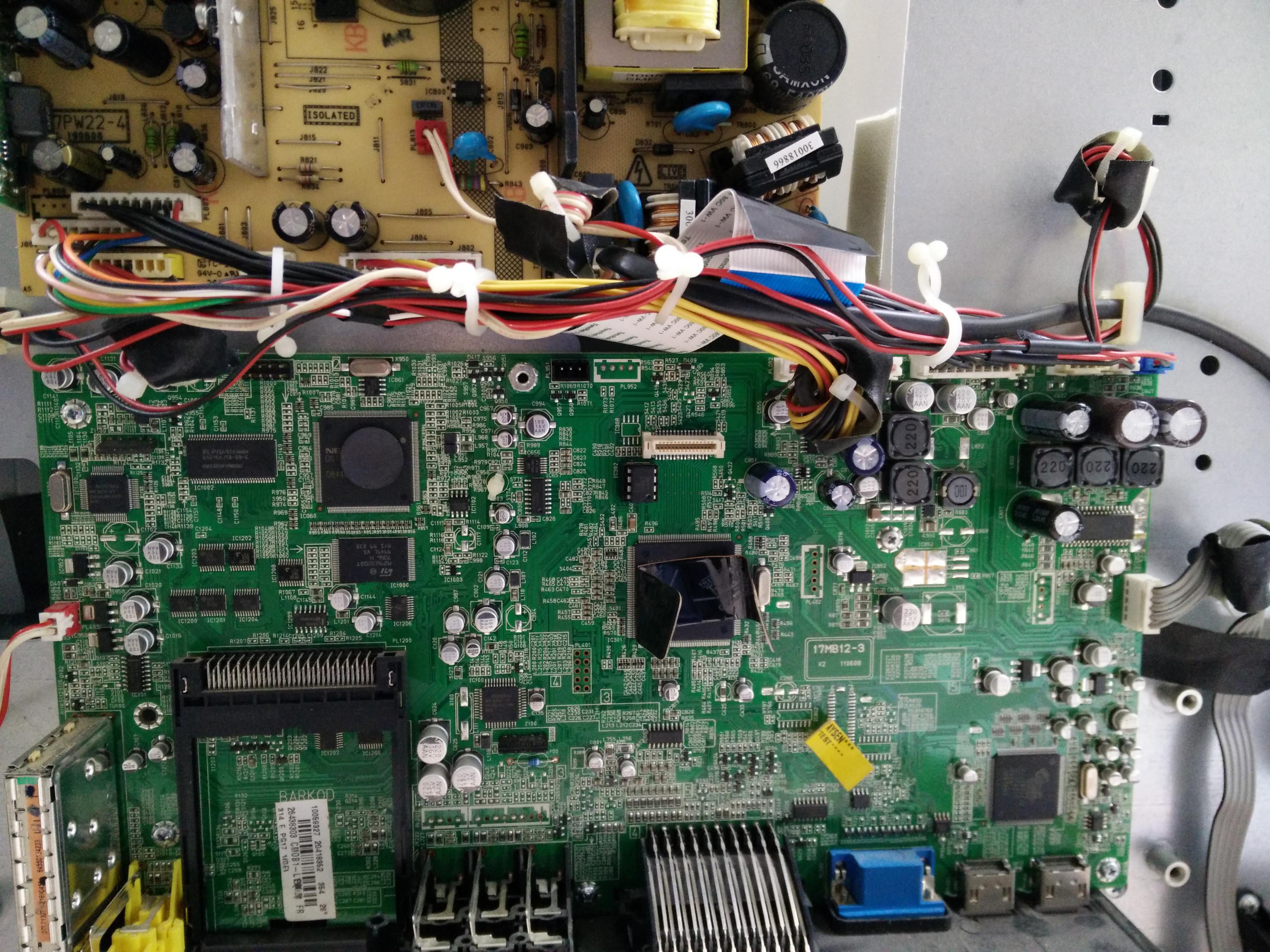

        Can you take pictures of the boards and how they are laid out please, looks to me like a fault gmma Ic or the Lvds setting is wrong in the service menu.
          Re: Tv tucson 26hd782
          here's photo of mainboard

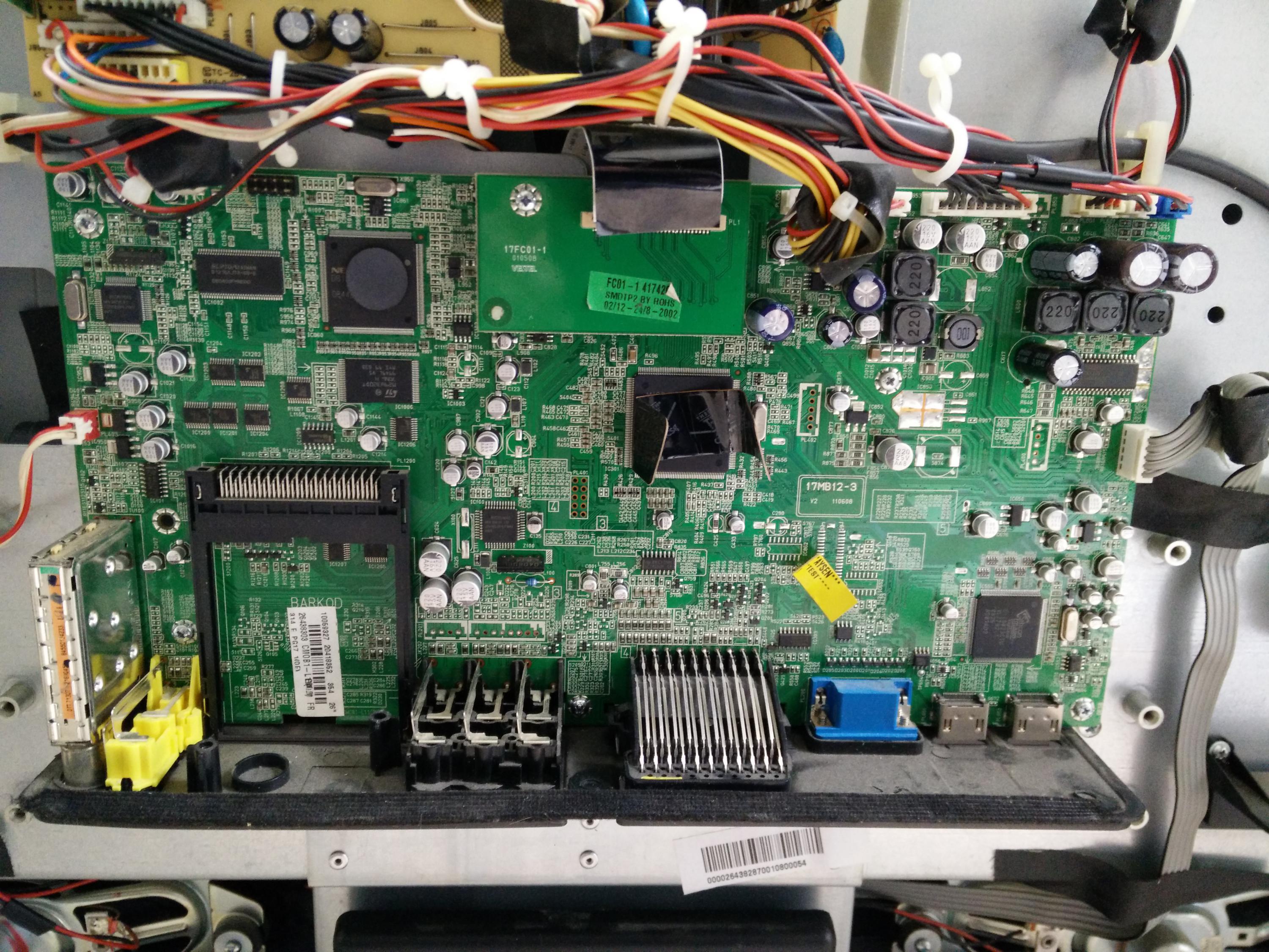

            Hmm can you remove that card where the Lvds plugs in ?
              here's without card :

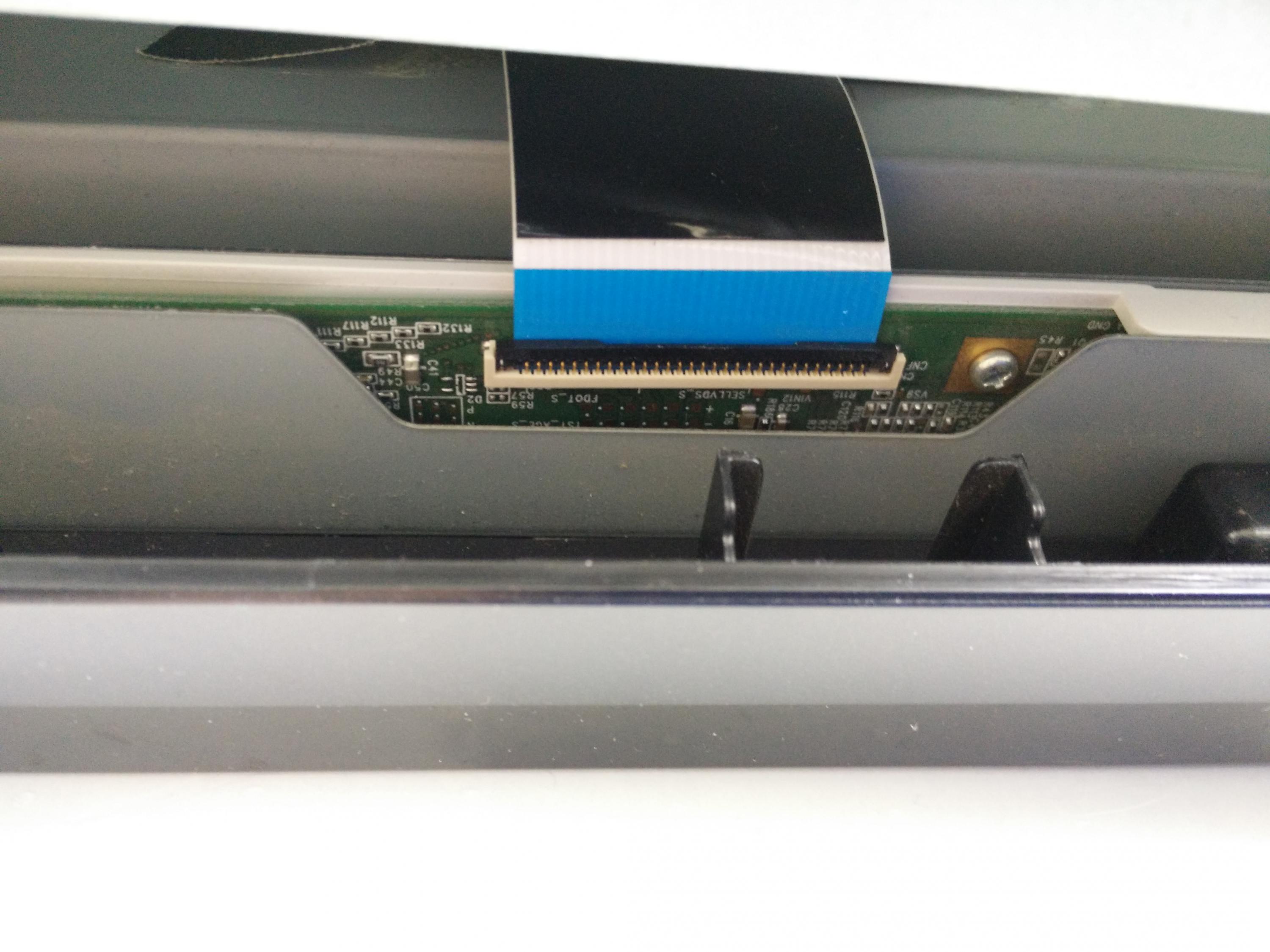

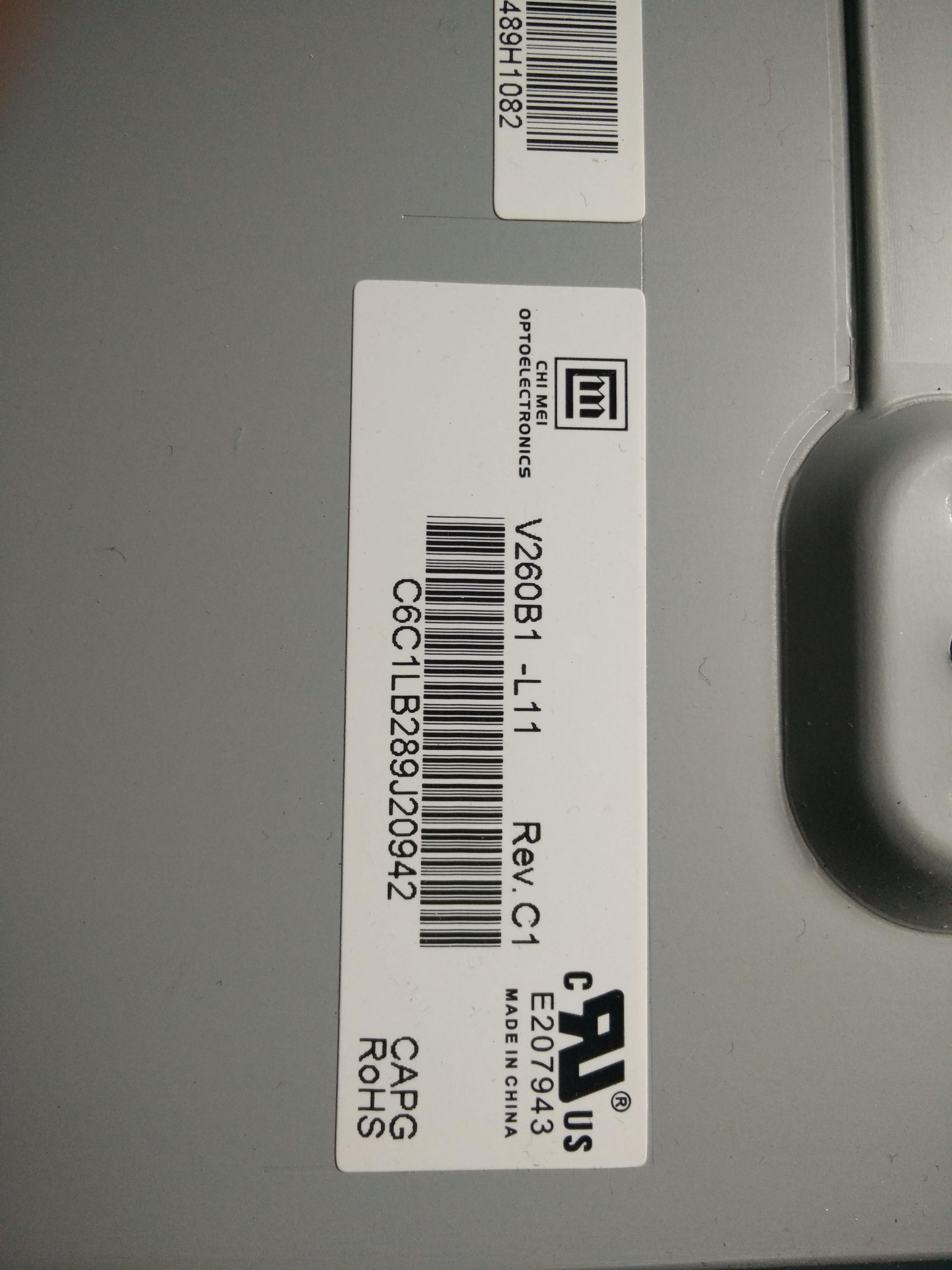

                I like to see the other end of that white flat LVDS cable that goes to the panel, it looks to me the panel may have integrated T-CON, and that board is just the connector converter. Are there SMD components on that board?
                Is there a model number sticker for the LCD panel to look up the spec sheet?
                  heres's photos
                  in menu only images are distorted , letters are ok

                    Panel with Integrated T-CON.
                    V260B1-11 REV. C1
                    Not much you can do to fix it.
                    You need to get access to the board to do the Gamma Voltages check.

                          yes!!
                          i have change Lvds mode and screen is ok
                          thanks a lot

                            Nice one Common issue on these Vestel boards Lvds mode messes up, I have no idea why just guess that the firmware glitches nice fix ! Also the lcd panel used in that tv is very problematic so let us know if you have any issues again.

                              Nice fix, so what mode was it in to cause that symptom? and what mode did you change it to?
                                i go to video ---> lvds mode , it was on "yes" , i have change to "no"
                                JOVY RE7500
                                  I think when its on yes the mainboard inverts the gamma voltage, no idea why Vestel included this though.
