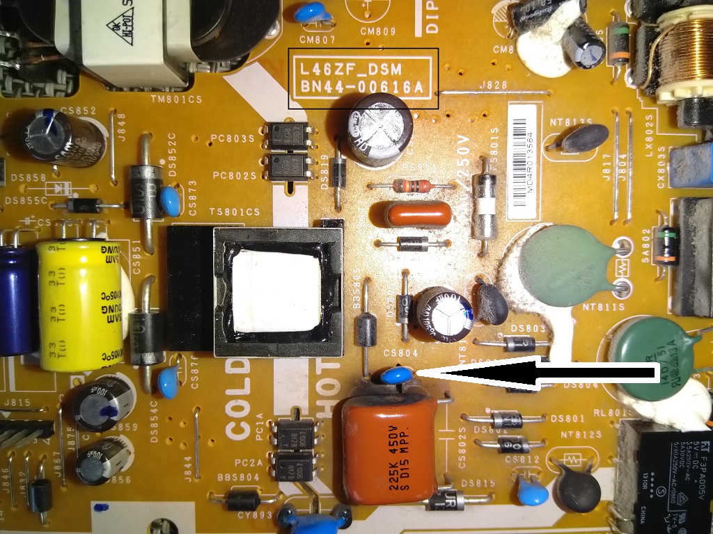

        Re: Samsung. Ue40f6200ak
        I have a L46ZF_DSM BN44-00616A Power supply. There is broken (exploded) high voltage capacitor CS804 on HOT side of PSU. My capacitor have exploded on "identification" side and capacitance value is unknown for me. If somebody have possibility to check value of this capacitor, please inform me by reply to this thread. Arrow directed to CS804.
          why not to olen your own thread instead of ruining other ones?
