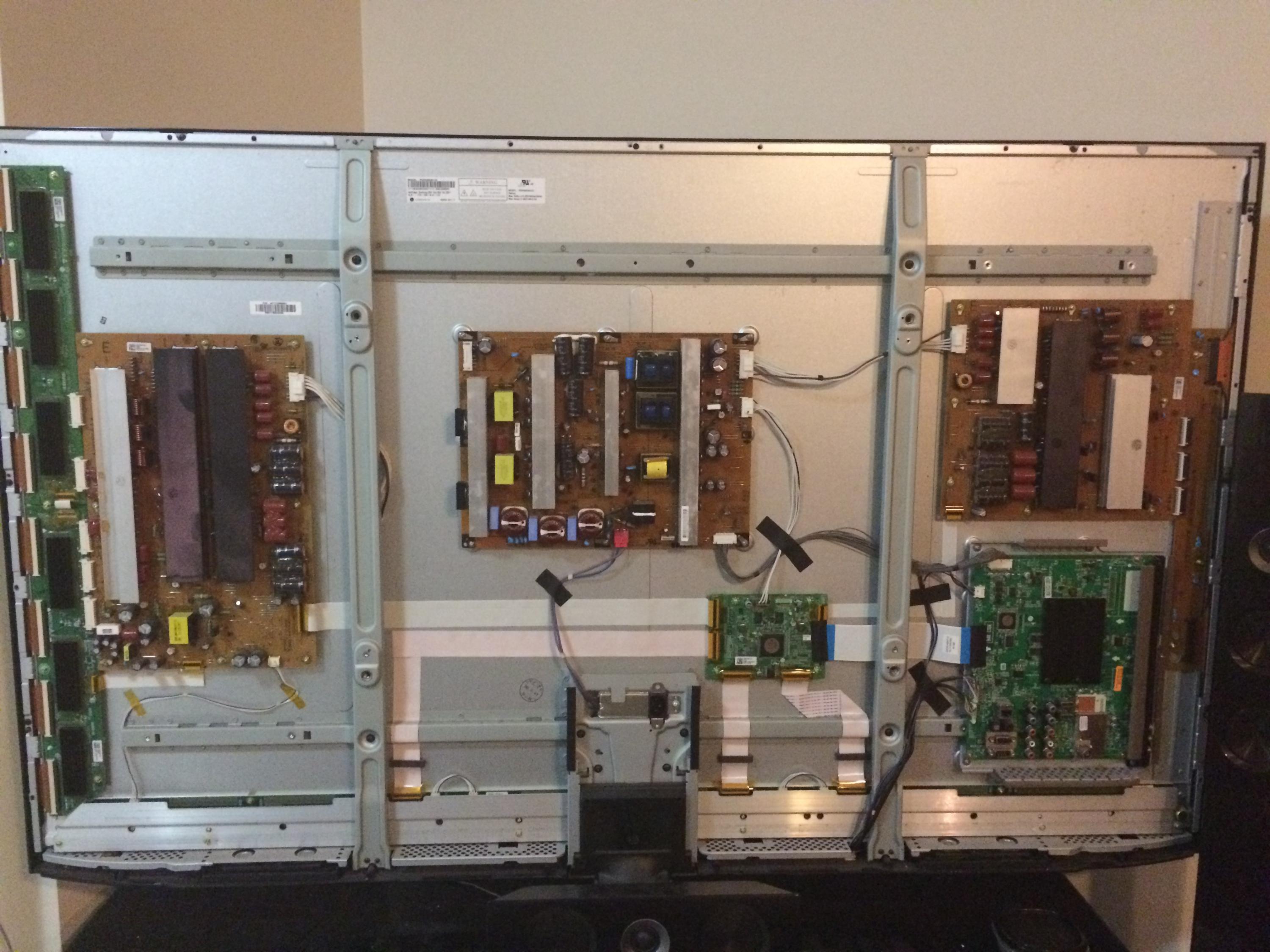

    Hi All,
    My 60 inch LG 60PZ570-TB decided to turn itself off the other day. It now clicks once and then clicks again 5 seconds later shutting it off. I researched it a lot and purchased a replacement C802 1.6kV capacitor. The original one had bulged a little bit, unfortunately the new capacitor made no difference.
    I'm now stuck as to what to do next. I'm still learning when it comes to these things, but like everything else i've pulled apart i'll have a crack at anything.

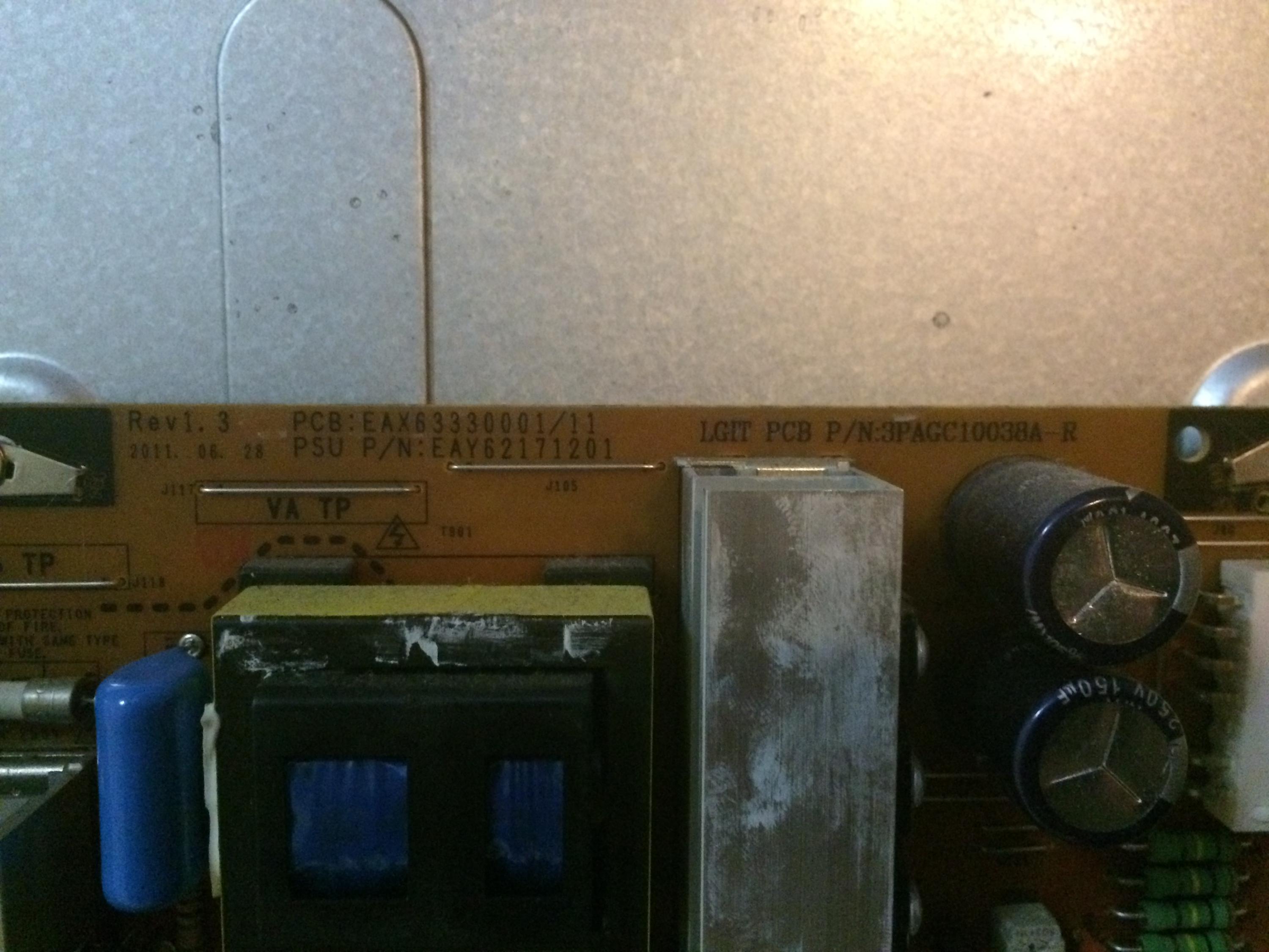

    PCB: EAX63330001/11
    PSU P/N: EAY62171201
    After reading a few posts I'm thinking it could be the voltage regulator, that's a stab in the dark for me. I managed to find this kit, thinking it may fix the problem.

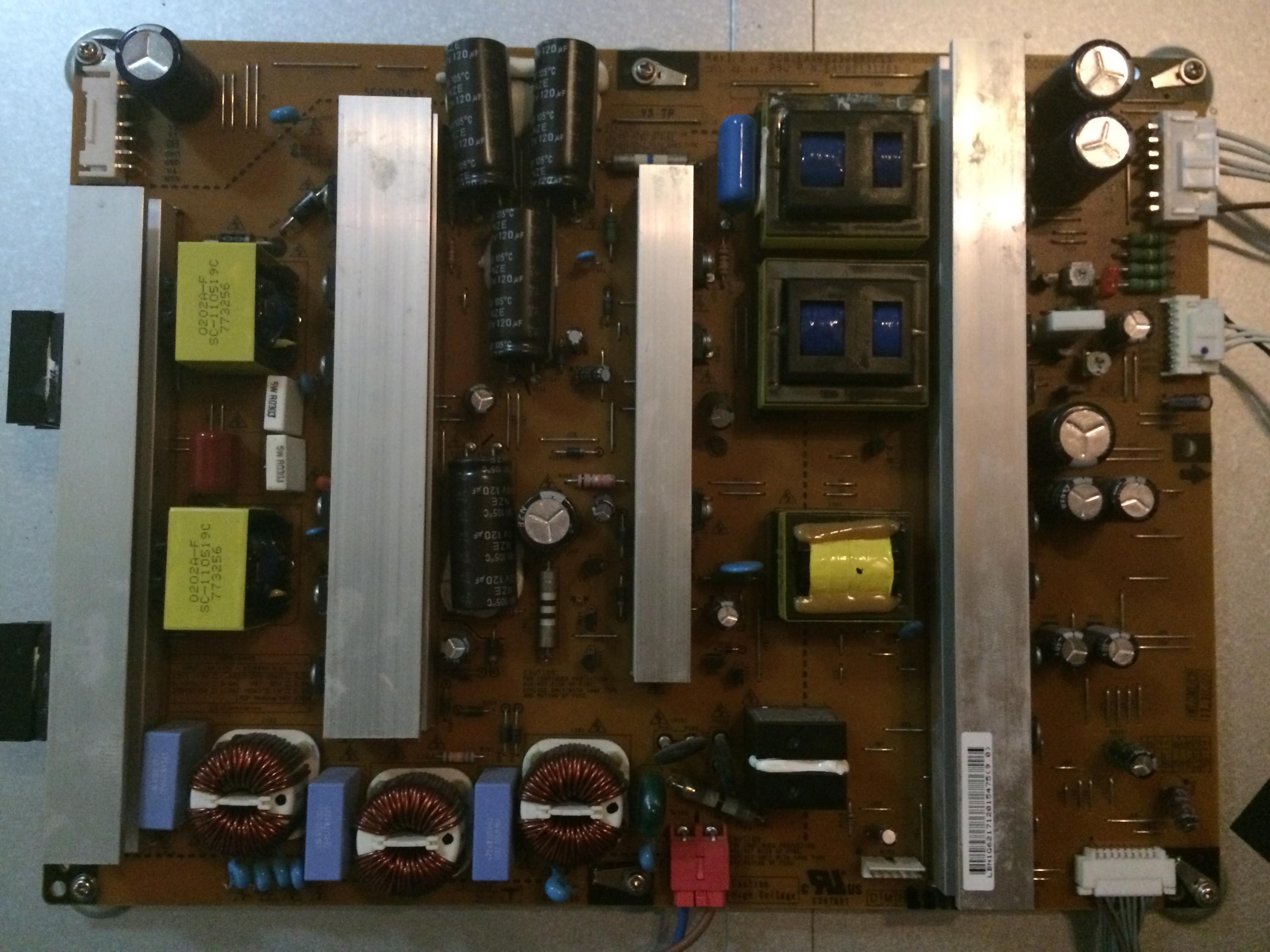

        Just took some readings on the pin outs on the power supply board, they are as follows:
        Incoming mains = 248v
        YSUS and ZSUS had exactly the same outputs
        VS=203v
        VA=starts at 53v drops to 46v then shuts off
        Mv5=5.2v
        Pin out to ctrl=5.2v
        I had a bit of a play to try and eliminate different boards, the only thing I found was that wen I disconnect the YSUS and ZSUS the TV will stay on with sound only This is the only time I've managed to get the tv to stay on.
        Cheers.

                With both YSUS and ZSUS removed tv stays on with only sound and no picture. Vs test point reads 203v and Va test point reads 54.9v while tv is running.

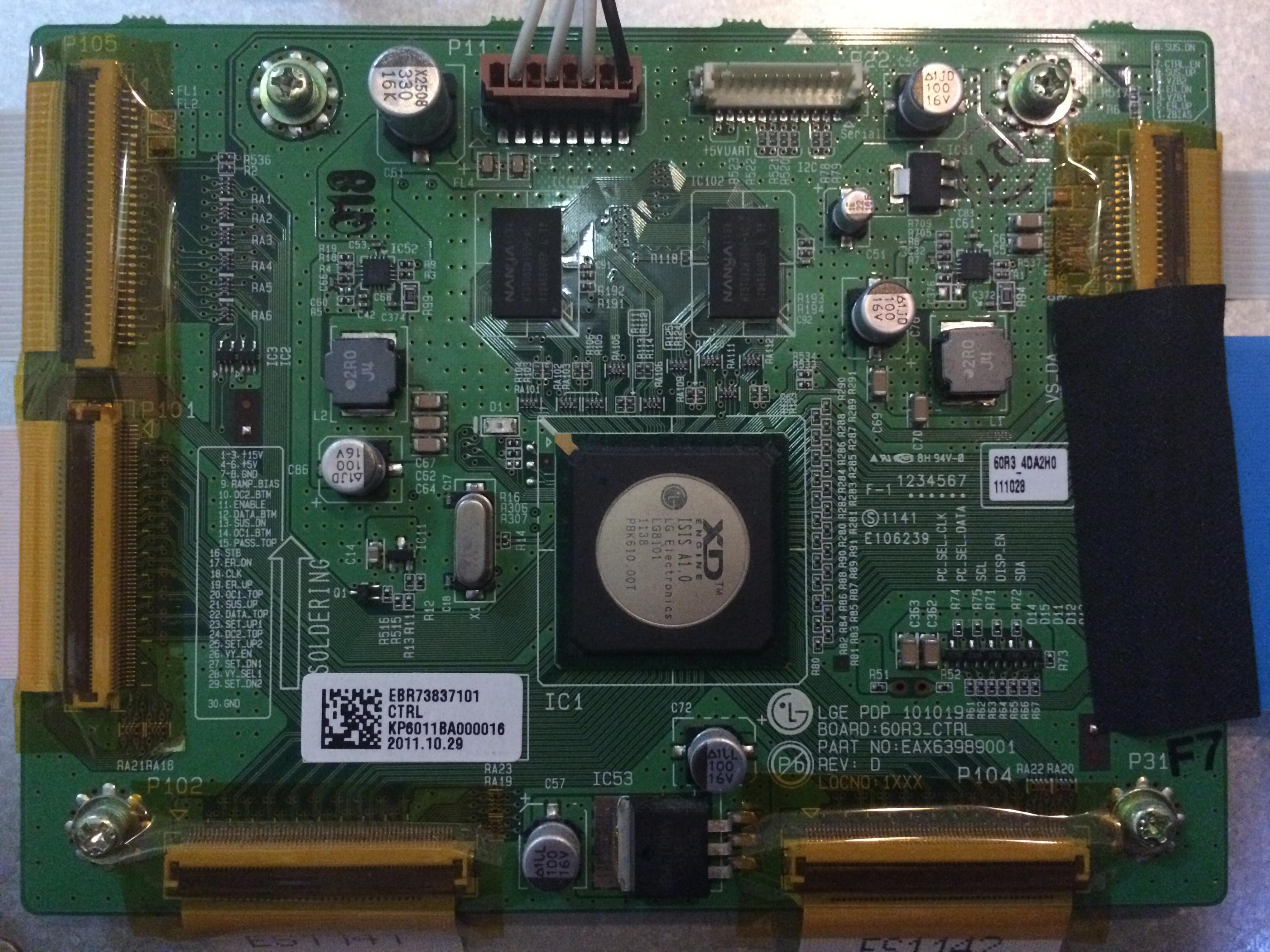

                        With both boards removed the control board LED flashes green. Two long flashes, followed by two shorter flashes
                          Re: LG 60PZ570-TB only stays on for 5 seconds
                          Well, it's not a control board fault then.
                          Baffling - not really sure what to suggest.
                          Could be a short on one board - but seems to affect both?

                            It's got me stumped, could it be that something on the YSUS and ZSUS failed at the same time? The panel is all good.
                            The shut off time seems to vary a little bit depending on how long I leave the tv off. Sometimes I can get a glimpse of the picture before it turns itself off, it seems like it's very close to staying on. Randomly before it stayed on for around 5 minutes with picture and sound working and then it failed again. Haven't been able to reproduce that result again.

                              It wouldn't be the new C802 capacitor causing the problem would it? The output voltages would be wrong if this had failed, correct?

                                Hm, wouldn't be a short if it worked like that, maybe it is a misbehaving mainboard.
                                Try this:-
                                Disconnect the LVDS cable between the main board and control board. This is the only ribbon cable that runs between the two boards. The main board has the HDMI ports on it; the control board has the blinking LED.
                                Disconnect the power cable between the power board and main board.
                                Put a jumper across the EXT AUTO GEN test points.
                                Plug the TV in, do you get test patterns on the display?
                                If so - replace main board
                                If not - we may need to jumper power board connections to be sure

                                  Can't seem to locate the EXT AUTO GEN test points. Are these on the control board?

                                      AUTO GEN not marked, but it's the two holes next to R51,R52. These need to be shorted together.
