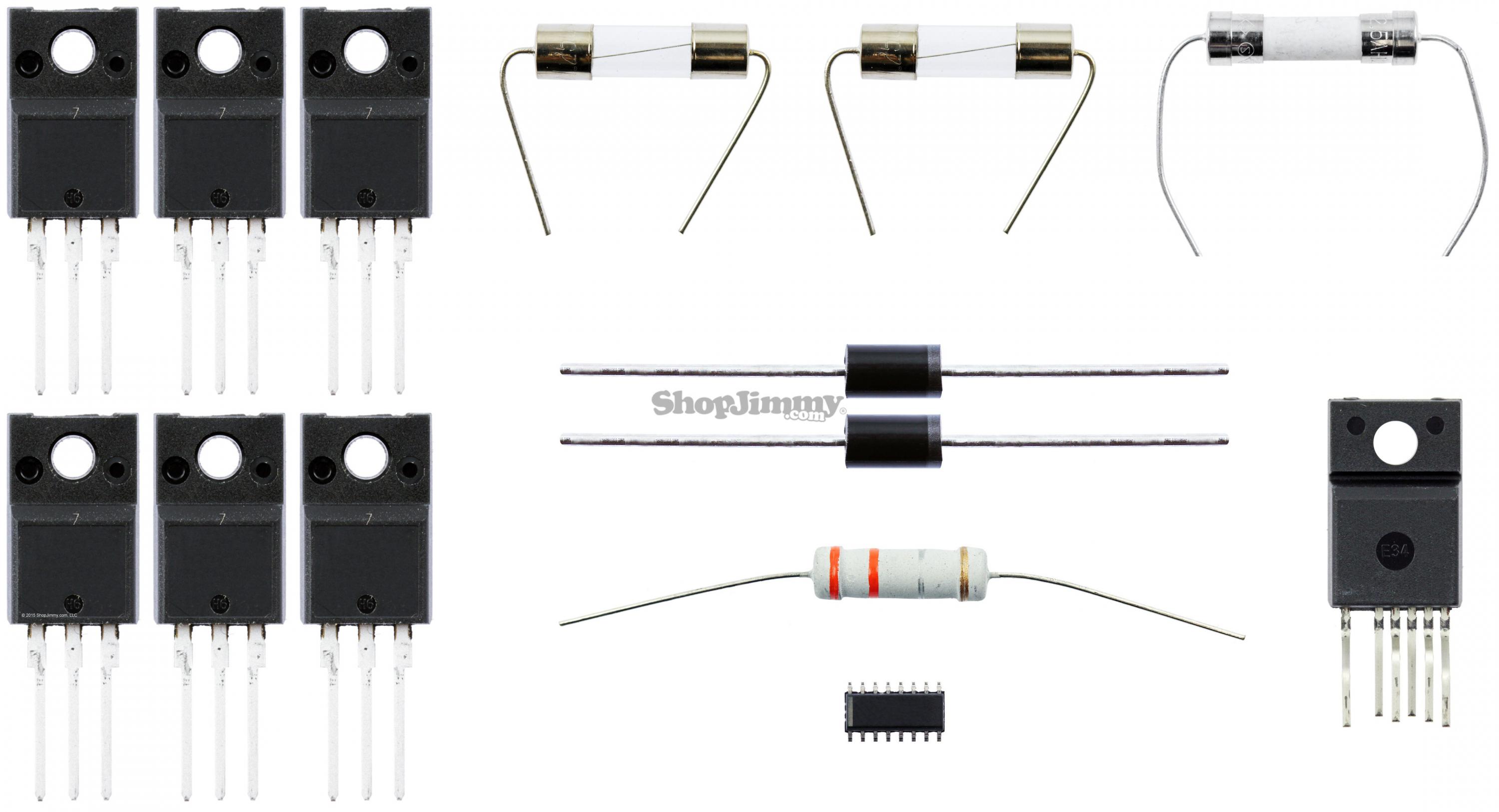

Is there any way to troubleshoot the faulty part on the power board or is it a matter of buying a new board?
CheersComment
Re: LG 60PZ570-TB only stays on for 5 seconds
Any chance this would help my problem?
http://www.shopjimmy.com/lg-eay62171...repair-kit.htm
Doesn't seem to be many board replacements around.Comment
Must just be the UK, I can access it in Australia. Anyway this is the product:
It's around $30USD. Everything's telling me it's the power board but the voltages are all correct. Have you ever heard of a power board reading voltages correct, but still being the problem?
The LG EAY62171201 Power Supply Component Repair Kit includes all commonly failing components on the power supply board. Symptoms include dead, no power, no 5V standby.
SKU: sj-EAY62171201 Repair Kit
Part Number: EAY62171201 Repair Kit
Warranty: No Warranty
TV Brands: Lg
Specifications: Kit Includes
Description Quantity Board Location
Fuses 3 F101, 302, 801
Transistors 6 Q601, 602, 603, 604, 801, 802
Integrated Circuits 2 IC301, 801
Diodes 2 D601, 602
Resistors 1 R305
TV Part Types: Complete Board Repair Kit
