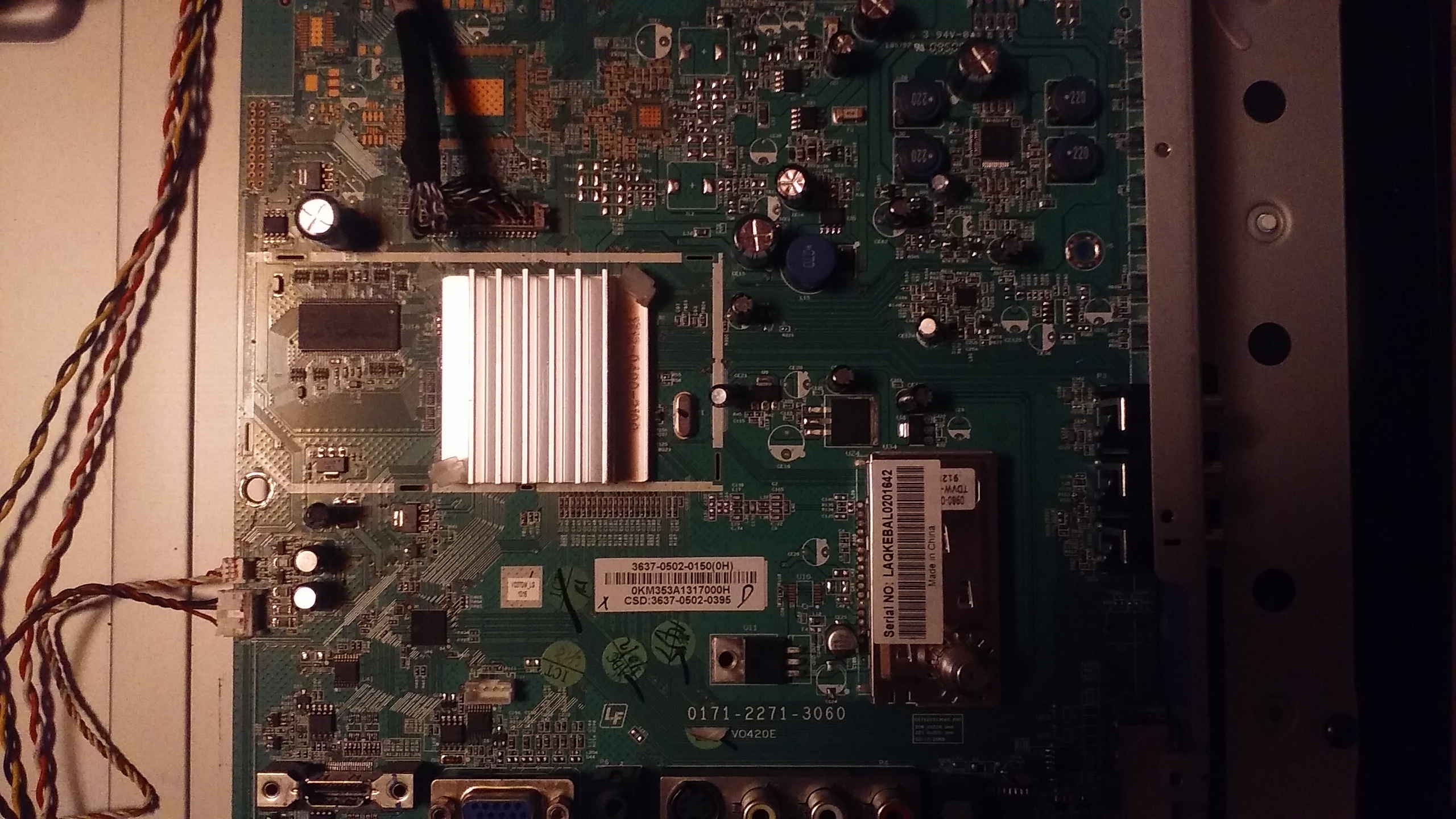

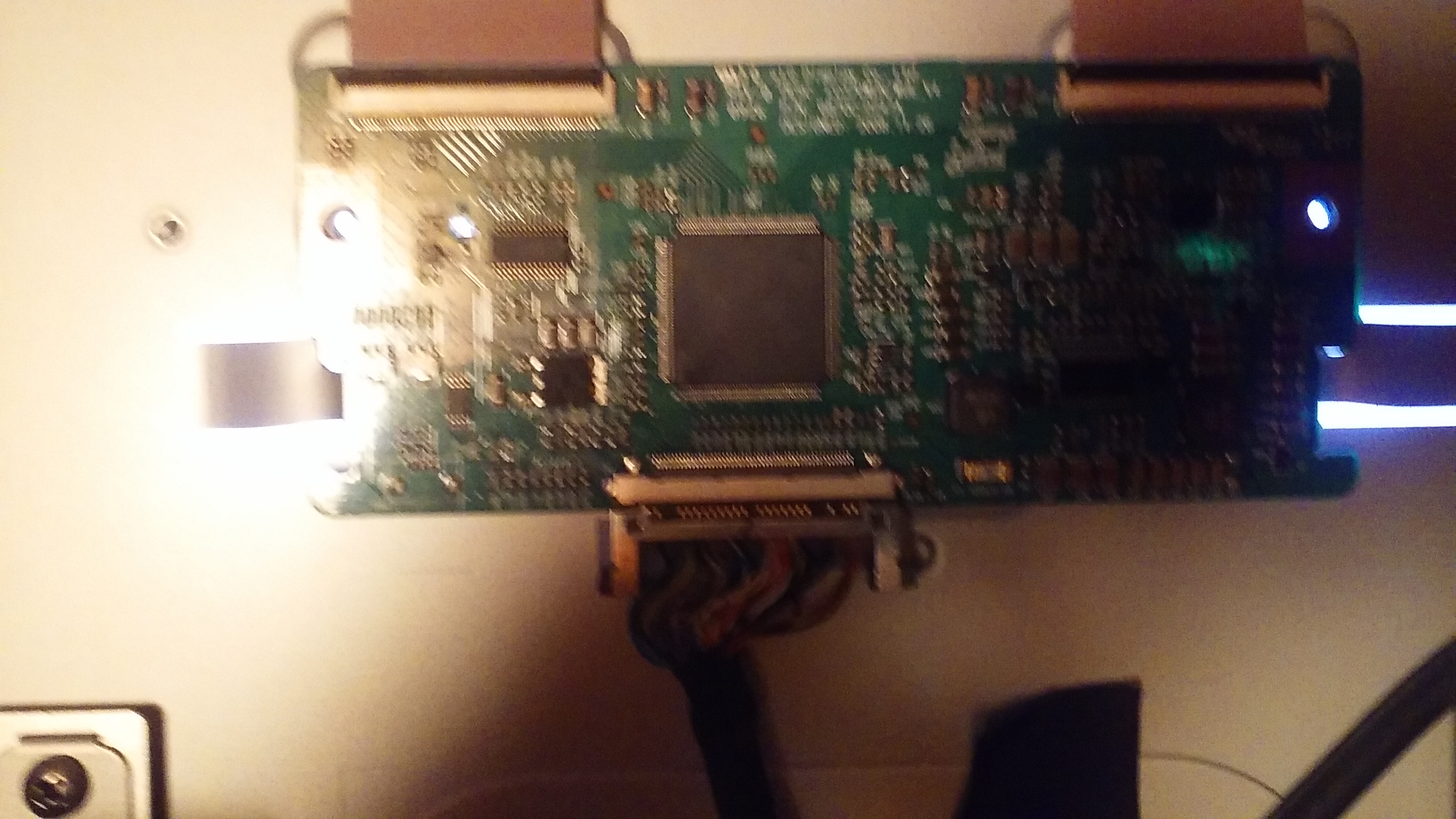

    i found thistvin dumpster watched a video on youtube and ended up buying a tcon board from a "broken screen working" tv needless to say this did not fix my problem and i found this forum i am very capable if i know what i am doing however i dont know much about component repair although i think if pointed in right direction i could handle it what i cannot find is a listing of what components should have what power i cannot see any burnt resistors or any bubbled capacitors the tv will hook up via hdmi and have audio which was what led me to believe it was tcon card which the "new to me" one i am not 100% is good or bad any help would be greatly apreciated

    have you tried a strong flashlight to see if there is any video on screen? it may be the backlights not working but vizios are noted for bad eproms as well.

            either the main board or the display itself. mainboard is fixable display isn't. I would guess the eprom is bad, vizios are well noted for eprom failures. budm is the resident expert on these and he will chime in I am sure. I mostly do plasma the lcd led sets once and a while. shop jimmy usually has the eproms in stock.

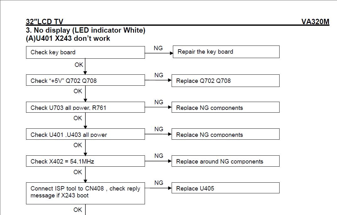

                Re: Vizio Vo370m display lights light comes on no display
                here is a chart from coppel tv it might help find the problem. if the voltages are present going to the main board then the problem may be on it.

                  also here is the service manual, you might try freezing the eprom with a can of compressd air turned upside down and see if anything changes
                    Do get 12VDC at the SMD fuse on the T-CON board? Use chassis as the GND ref for the meter.
                      budm from whaat i can tell there is only one fuse on tcon and below it it says
                      f1 125v/2.0a i checked fuse it is not open will that be 125ac? or dc
                      i checked the fuse and there is no power ac or dc at the fuse
                        12 volt dc on the tcon fuse check both sides. ground on chassis. check both sides for 12vdc.
                          no power

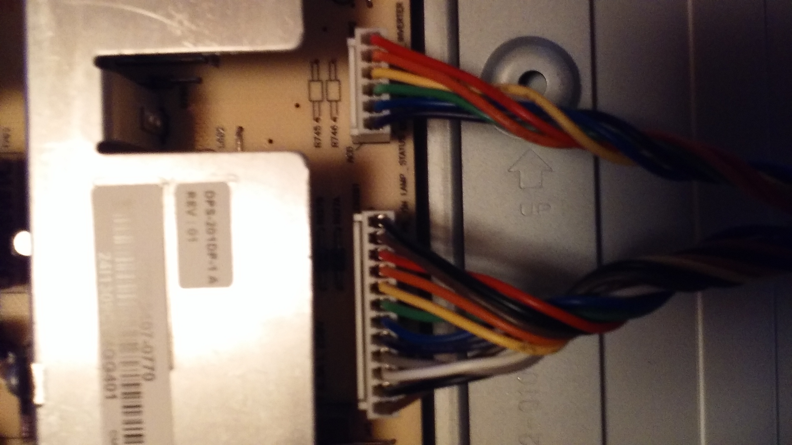

                            either the 12v power supply or something on the main board budm should be around somewhere. he is the expert on these. are any of the power board connectors marked with voltage if so look for one that says 12 v and see if there is any voltage there.
                              there is and there is 12v at the connectror coming off power supply board
                                u21 pins 5,6, 7and8 should have +12vdc on them. I think you will find it on the power board.
                                    f1 and f2 show on the shop jimmy pic on the mainboard these are surface mount fuses little larger than a resistor with gold ends. several 0 ohm resistors on the backside which may act as fuses
                                      pins 1-3 have 5v 4,6,7,8 continuity to ground,9-11 12v and pin12has 1.76 on big connector on little connecter 1-4 have neither conntinuity to ground or voltage 5 has 2.2 and 6 has 1.7
                                        f1 has 5v f2 has 12
