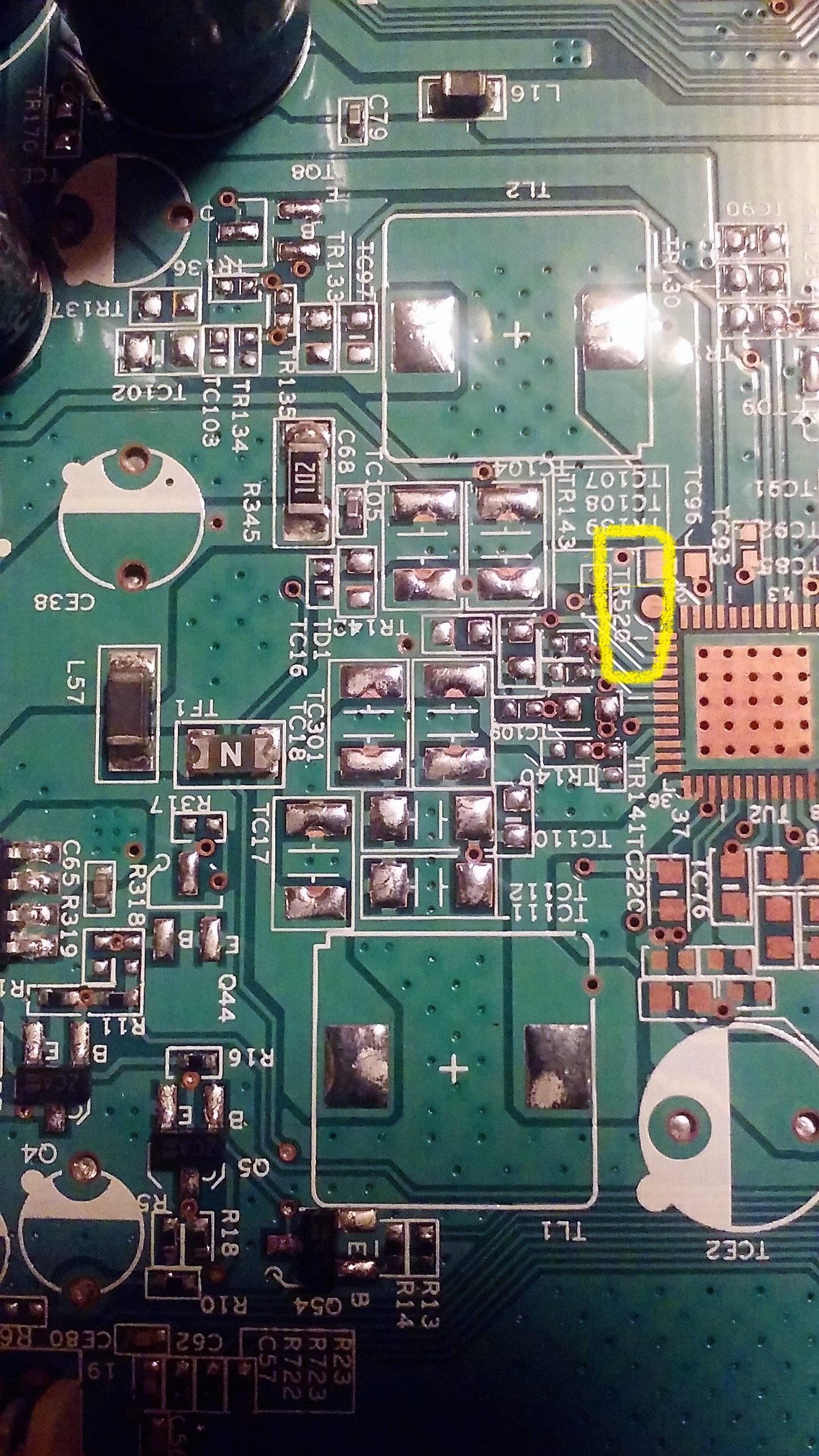

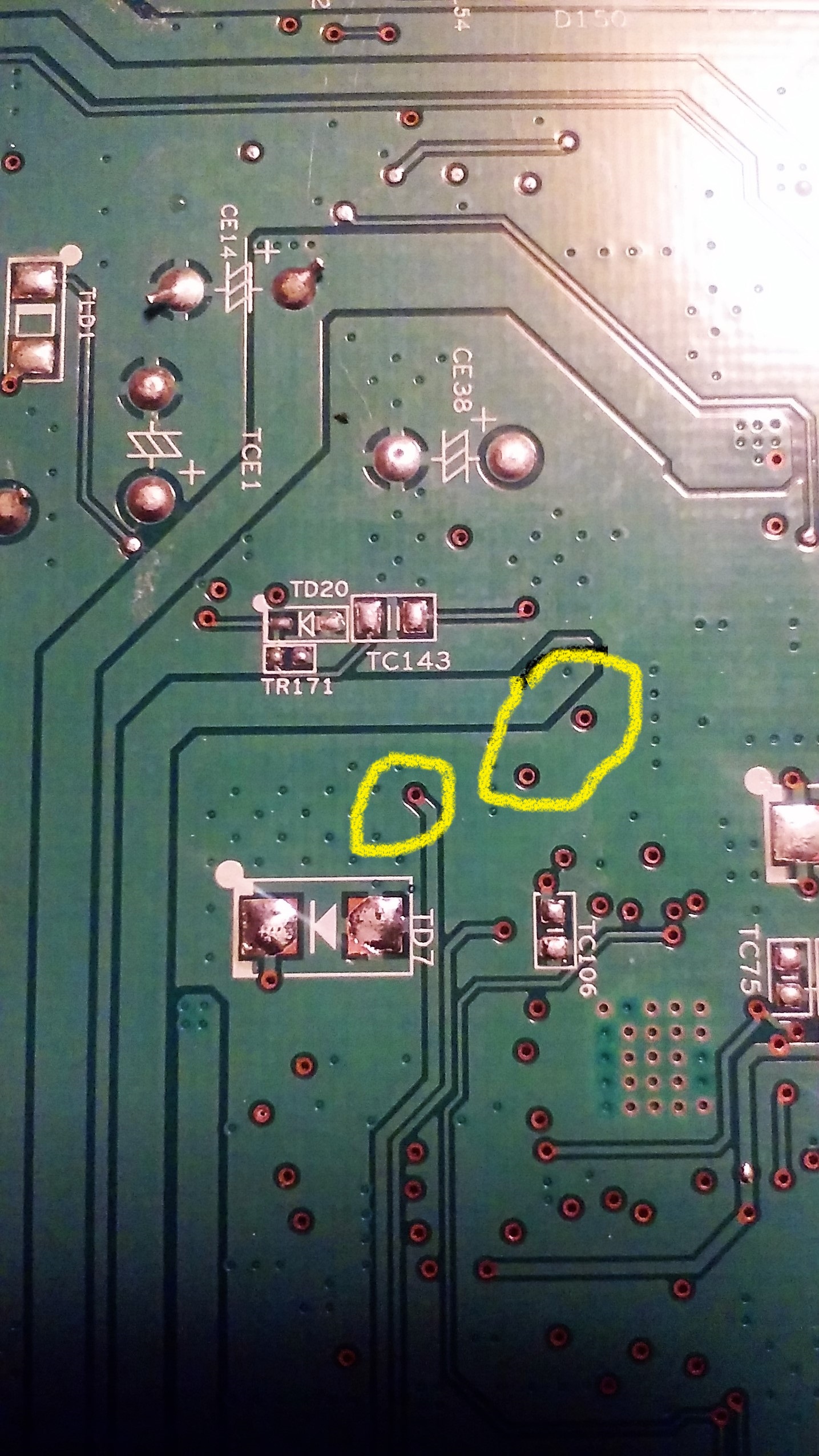

                  i have traced the fuse on the tcon board to the mainboard but not to any odvious ic i have traced it to the places circled on the pictures and have tried tracing those points back but am having no luck am at a loss as what my next step should be

                      Re: Vizio Vo370m display lights light comes on no display
                      ended up replacing main board and tv works fantastic i am keeping this one as it was the first tv i dug out of dumpster and started my interest in vixing these
