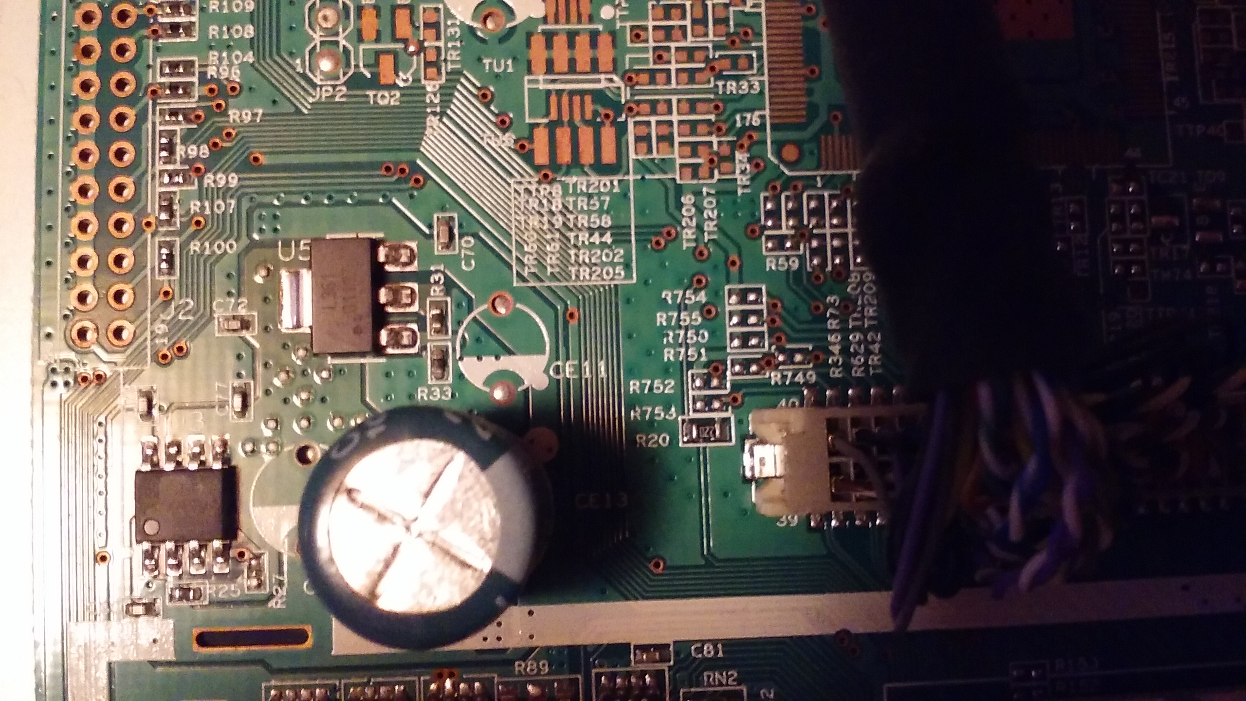

                the mosfet is u5 right
                left to right i have 1.38 2.62 5.10 2.62 on back tab

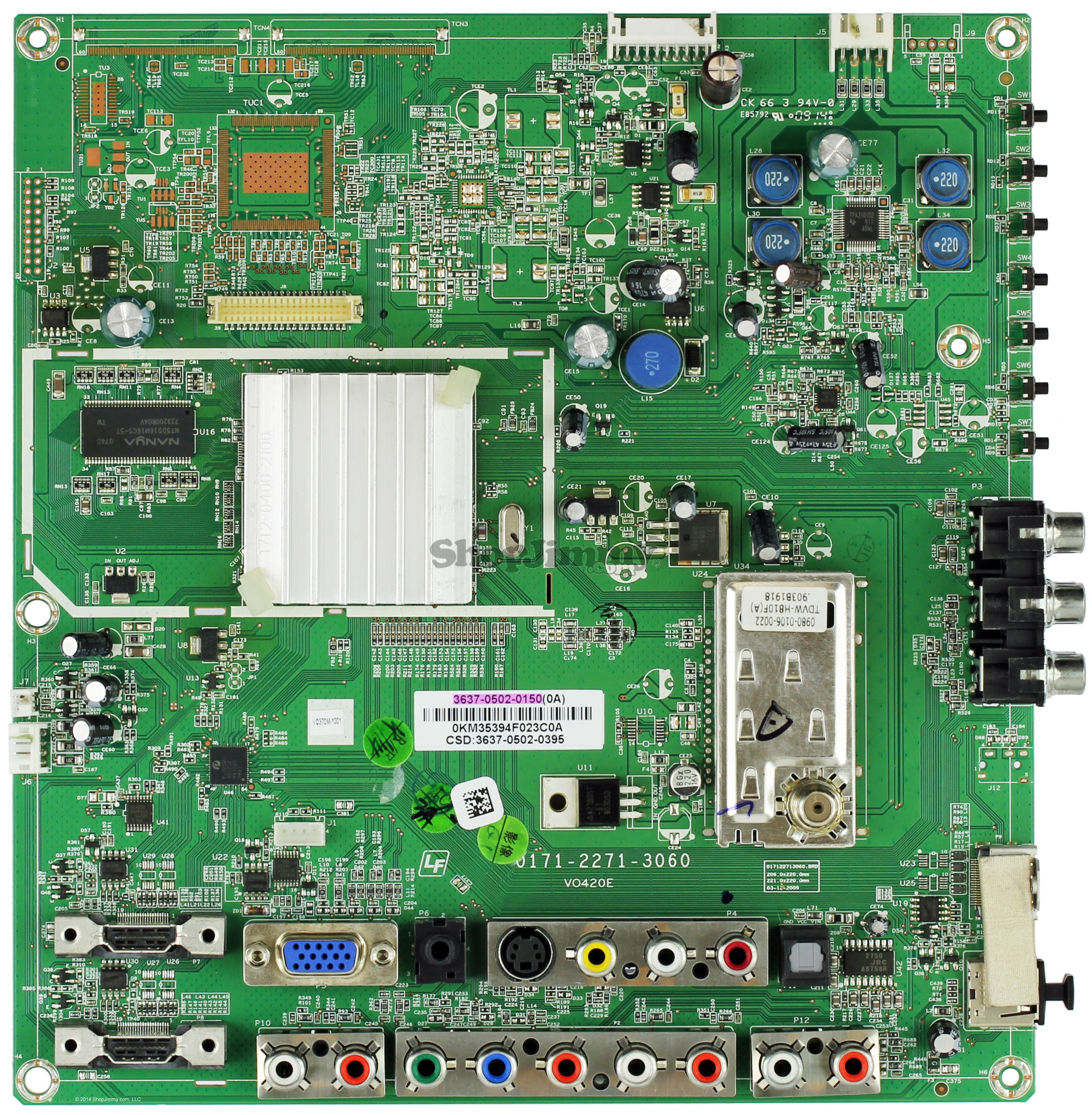

                  There are more than one version of your main board, which one of these is your board?

                    That will not be it, one of the pin will have 12vdc on it, it will 8-pin type.
                    That is regulator IC 1.25Vref + 1.38V on the ADJ pin 1 = 2.63VDC on output pin 2 (middle pin, or top tab), pin 3 is the input pin.

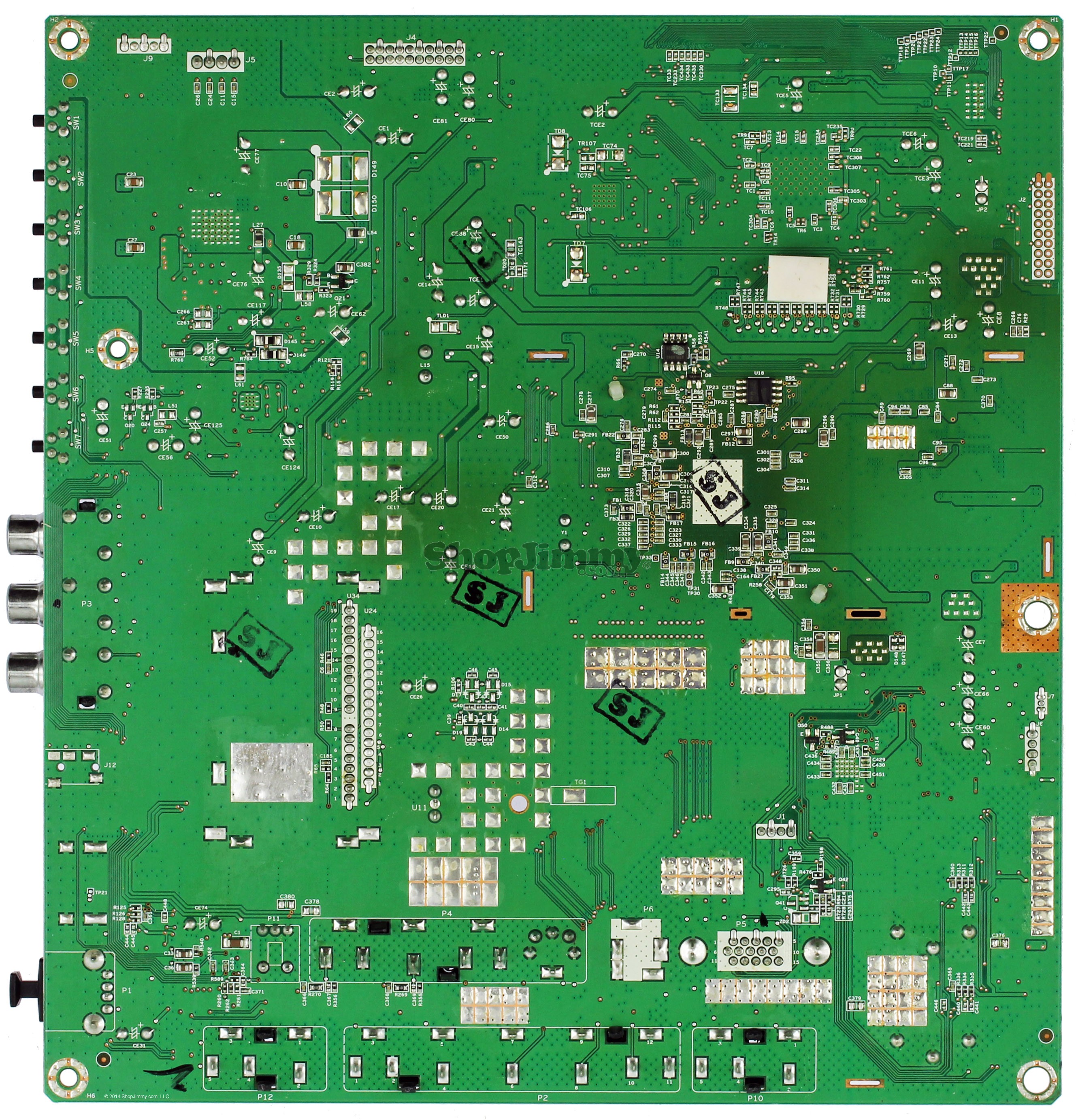

                        Look at post 28 and tell me which main board you have.

                            if the pic in his first post is his tv then it is the 3637-0502-0150 board the numbers are there.
                              #34
                              Re: Vizio Vo370m display lights light comes on no display
                              that is correct 3637-0502-0150(oh)
                                #35
                                oh it is u21 right next to f2 fuse which is the 12v fuse it has 12 bothsource and 0 on gates and drains are 12

                                  OK, let me trace the board out.
                                  Pictures provided by shopjimmy.
