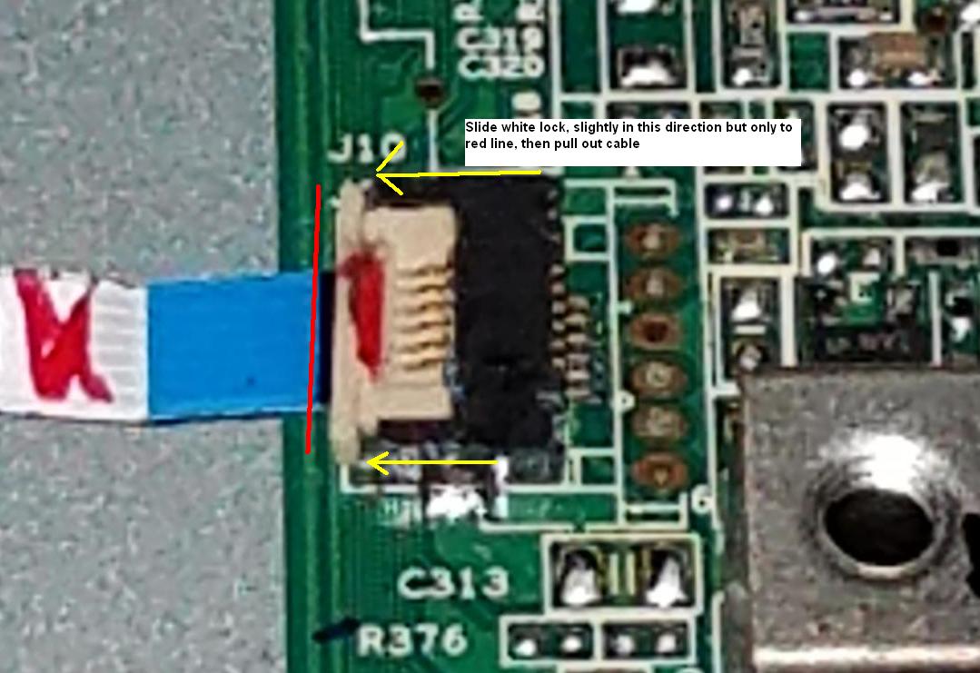

    I think you have an extra 1 in the diode number It could be:
    MBRF20U65CT
    MBRF10U60CT
    To unlock the small cable, slide the white lock in the direction of the yellow arrow but not too far, that will unlock the flat cable and it can be removed.

        Re: JVC JLC42BC3000 screen froze on "JVC" logo.
        Thank you budm & RJ for the VERY helpful responses.
        Next time I remove the TV back cover, I'll "practice" removing the small ribbon cable. Fortunately, I managed to replace the CE1 and CE22 caps w/o disconnecting or breaking it!
        Indeed, the labels I read on D201 and D202 could be incorrect. The letters/numbers are very faint and, worse yet, the caps in front of them do not allow direct viewing. I used a flash light and even a dentist's mirror to get those. A photo of D201 and D202 shows nothing useful. I'll search online for the labels w/o the "1" and see what comes up. budm's answers already put me on the right track.

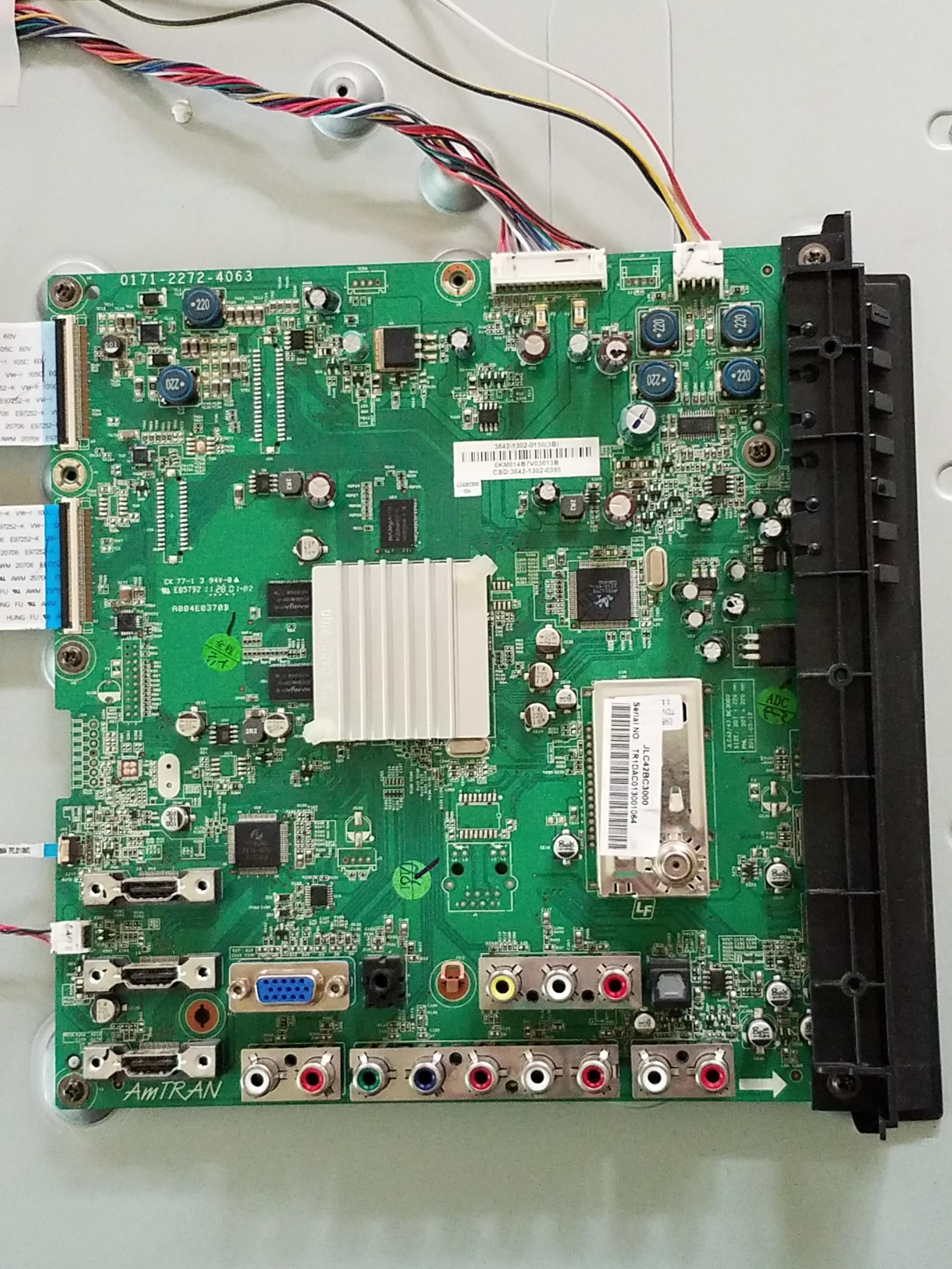

                                  #56
                                  Originally posted by NewAtThis
                                  Thank you, nomoresonys. I cannot find an EEPROM, however, and, as I mentioned in #50 posting, JVC is incredibly unhelpful.
                                  The only thing that's JVC is the screen printing on the front.
                                  Is this your mainboard ? https://www.ebay.com/itm/JVC-3632-16...0/272421970166

                                    #57
                                    diif, No. My main board is different. Please, see attached photo.

                                      #58
                                      Whole board there for 60 bucks plus 8 something shipping, I didn't see any eeproms either, not sure if any other eeproms from slightly different models or screen sizes would work???: https://www.ebay.com/sch/i.html?_fro...3642-1302-0395

                                          #60
                                          Update on Feb. 4, 2020: I got tired of waiting to find an EEPROM, so I just bought a new Main CB. Hopefully, it will fix the problem.
