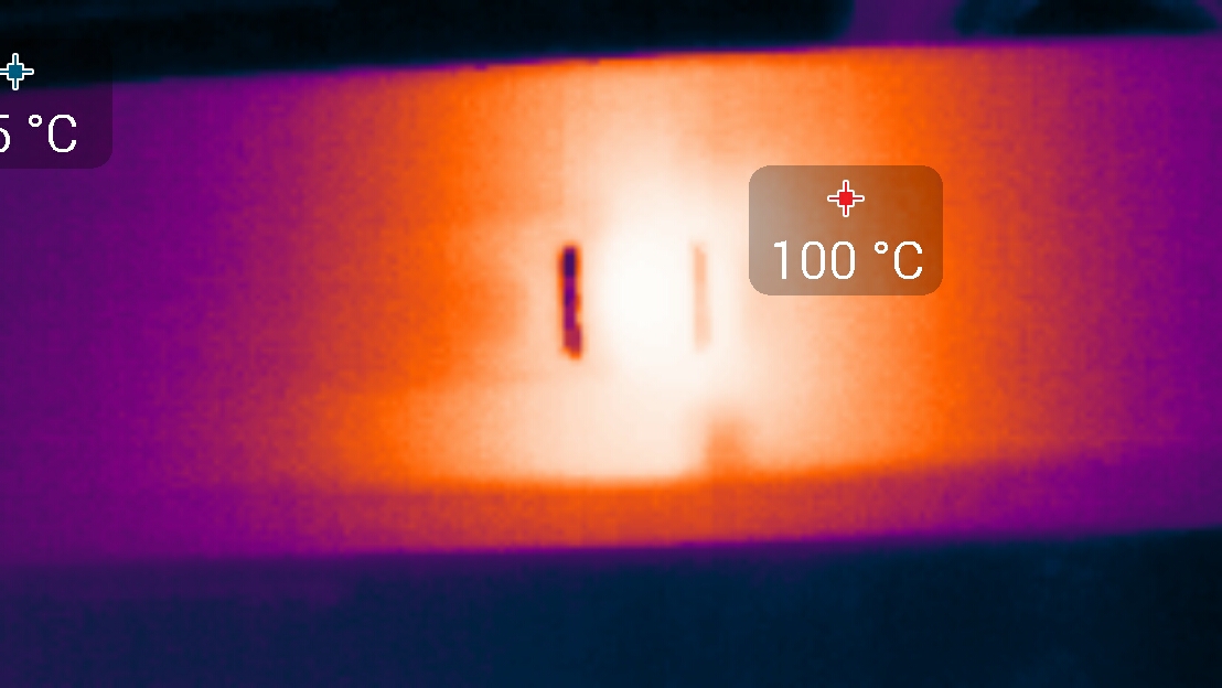

                  Was testing LEDs wrong, not on max brightness. They actually have about 400mA through them (0.87V drop across 2.2R resistor)
                  So each LED dissipates approx 3.5V * 0.4A = 1.4W. No way an SMD3528 LED can last that long dissipating that much power.
                  So now I know why they fail. I will simply have to turn down the backlight current, perhaps modify PSU for lower current limit for CC output.
                  Bonus thermal image of how hot they get. With the panel off.
                      That is lots of current.
                      What thermal imaging equipment are you using?

                        Yea. Lifted some of the current sense resistors to set current to 200mA. LEDs now run at 50degC which I now feel comfortable with, not much dimmer (50% less light, but human eye is non linear so it still looks ~70-80% bright)
                        Thermal camera is a Seek Thermal device for Android, works with my Samsung Galaxy S4 phone. About $200 USD, with a $20 laser cutter lens for macro capability (ZnSe transparent to IR.)
