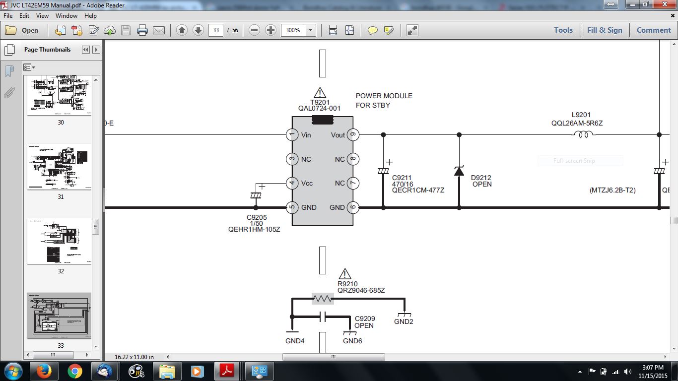

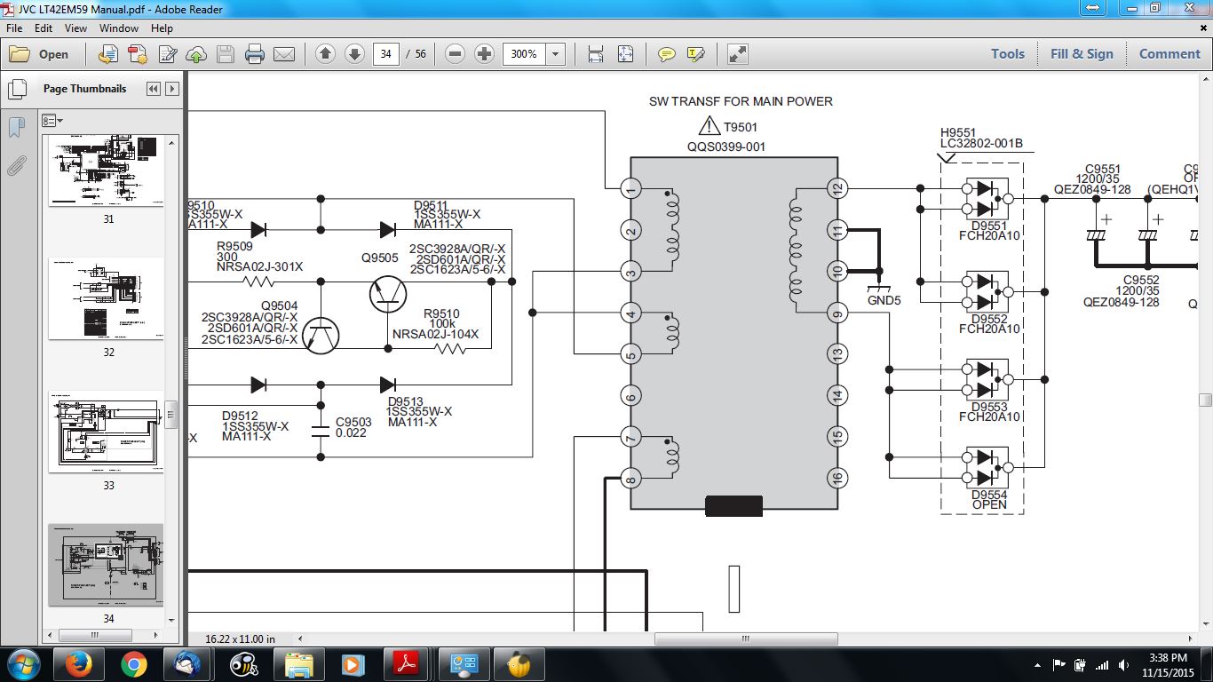

I found two transformers. I unplugged the inverter board and on T9501 I measured the following:
1-3 .1ohms
4-5 .1ohms
7-8 .1ohms
9-12 .2ohms
On T9201, I'm not sure what you want me to measure. I have attached snips from the manual depicting the transformers.
Are we saying the power board is the issue?
