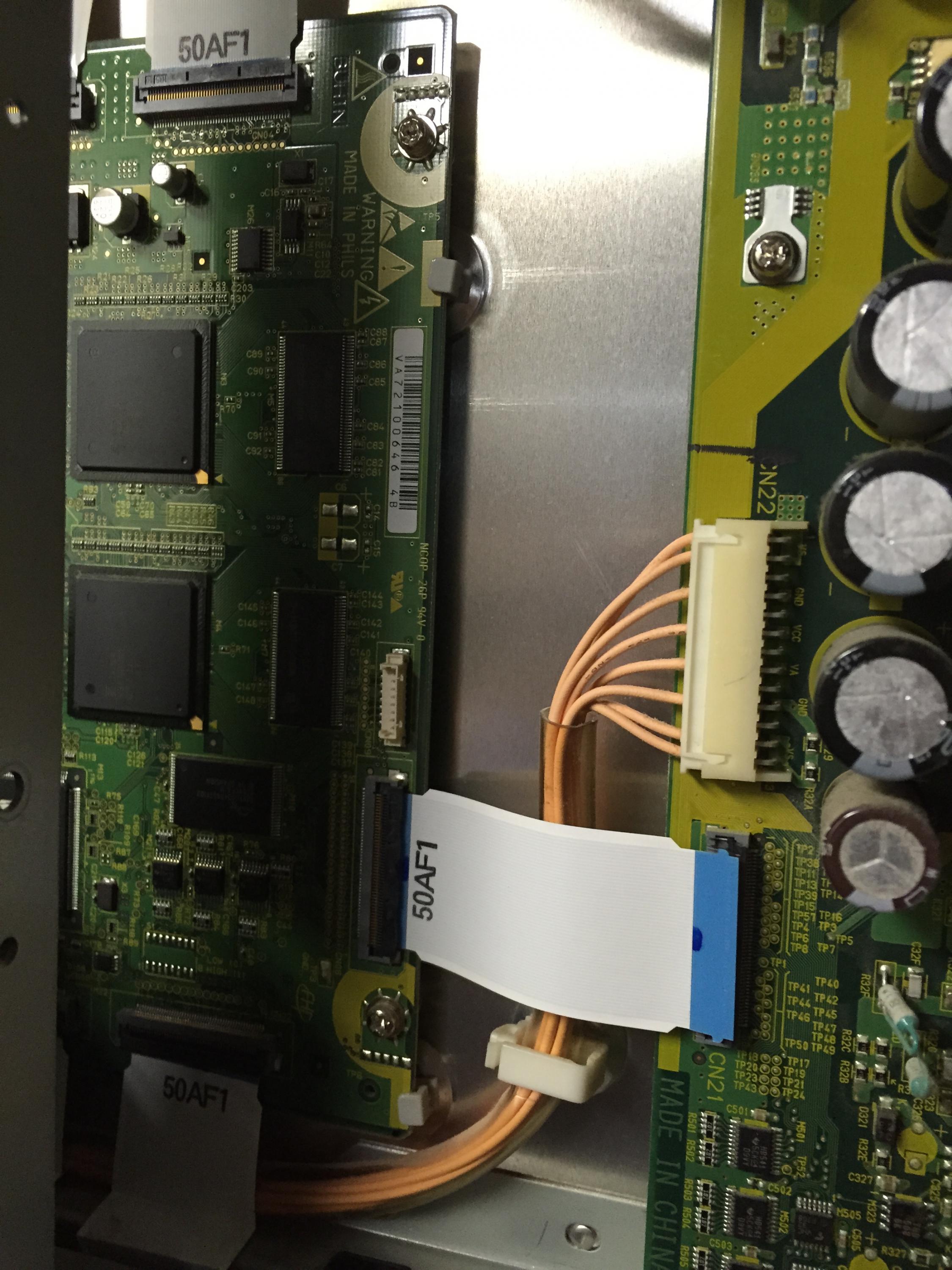

It seems that when I power up the tv, it shuts down after a few seconds. I do get VA and VS voltages for a few seconds when everything is connected as well as my other voltages. The standby LED is red then goes blue for a few seconds then flashes blue after. When I remove the ribbon cable from the logic board(see pic), I can power it up and the power stays on for about 20-30 seconds then shuts down. The light stays solid blue during this time. Could the logic board be causing the issue or the X SUS since this logic ribbon cable goes from the logic to the X sus board.
Re: Domed Capacitors
Could be bad Vscan voltage, that is low on power up. This can cause buffer damage if logic voltage still present due to SCR latch up. Or could just be maldischarge.Please do not PM me with questions! Questions via PM will not be answered. Post on the forums instead!
