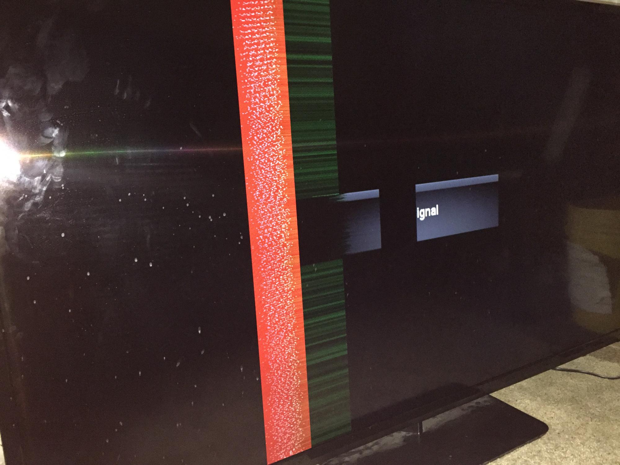

                              Hey freak, I read your entire post and everything you mentioned about how you fixed your tv and helped others do the same! But as I was going to start working in mine following your instructions, I came across a guy selling the same tv as mine with a cracked screen for $20. Of course I bought it today, brought it home and basically moved everything from that one tv to mine and the tv has picture!!!! Minus 3 vertical bar lines that able up in the left of the tv if you're facing towards it.
                              I'm really bad at this, but I'm a stubborn diy person and I really want to finish and fix this tv. What do you think it's wrong with it that I can do?
                              Just to mention what I did, I removed the bottom metal bar holding the long board in the middle and I noticed whe. I pushed on the 1st fat cable hook up the red and green bara kind of flickered. I cleaned that with alcohol and blew on the port and that didn't help.
                              Here's some pictures of how the tv looks and the fat cable I'm talking about.
                              Thank you very much for your help!!!
                              • Brinn
                                • Oct 2015

                                  Re: e701i-a3 no picture but backlights
                                  Sorry, I'm doing this from my phone as I wasn't able to put the images on my computer. But those
                                  Are the 3 pics I have. I can get more if needed.
                                  Thanks again
                                    Are those pictures with your original boards installed or the new ones? IF they are the new ones... :-( BUT what was the issue with the old ones? Recheck your cable connections at the tcon board especially for that side.
                                      It looks like you have a bad connection from the tcon board to the panel. You might want to check those flat white ribbons again and try to clean them off with alcohol. There's a possibility that this could be a panel failure also and that's what took out the original tcon board which is the reason why you did not have a picture and eventually this fault will take out that tcon board as well. And if that's the case this is known as vertical tab failure

                                        Yes, the pics are with all
                                        3 boards from the cracked tv. I actually bought a new T-Con board from FTVparts and it didn't change anything, which got me thinking the main or power board were bad and fries the new t-con. That's when I decided to buy that tv for $20.
                                        I will clean the cable on the side of the tv that's affected and see if that changes anything. Would you suggest cleaning only the cable going from the tcon to the lcd or all on that side?
                                        If it was a vertical tab failure. What does that mean?
                                        Thank you again guys!!
                                          If it is a vertical tab... its toast as those can't be removed or repaired... :-(
                                          The side ones are duplicated in some form of "redundant operational design" that allows the set to still function with only one side but the bottom one are all needed.
                                          Not sure if you answered the question about what was the symptoms with old boards as you say you had other boards with "no change" resulting in your "quest" for additional boards... so was there initially no picture, same picture as the new boards (ie. no improvement), what?
