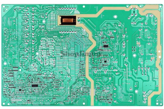

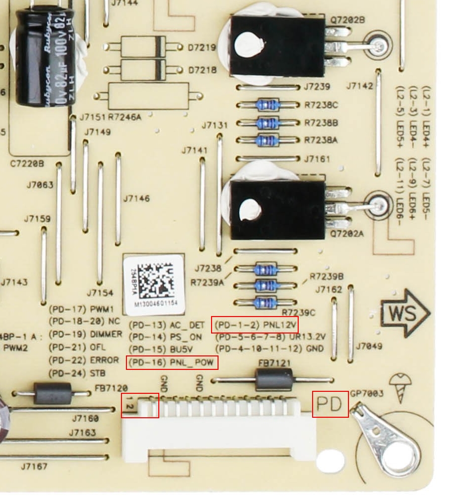

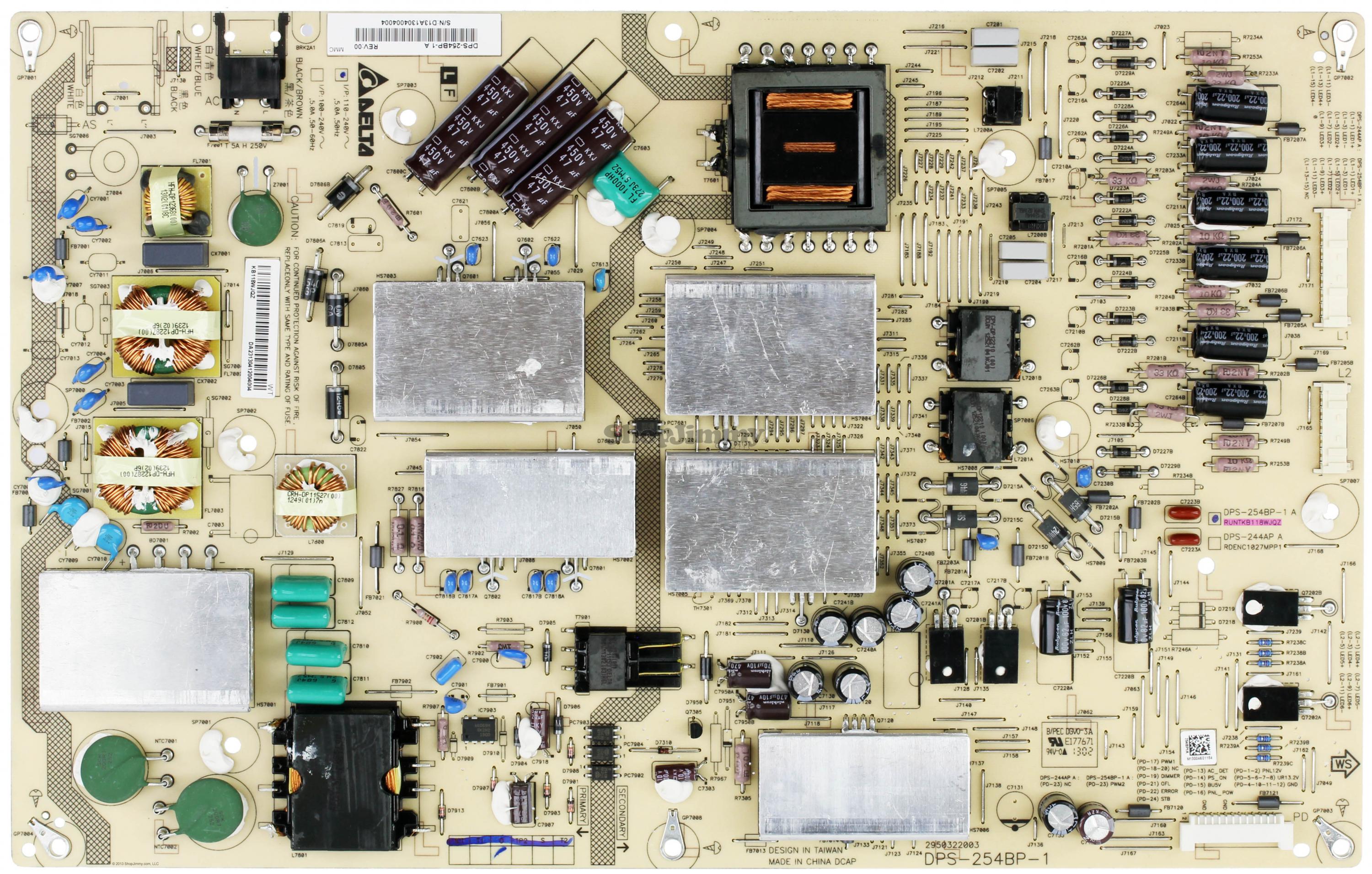

              Is this your power supply board?
              http://www.shopjimmy.com/sharp-runtk...led-board.htm#
              Just look at the PD connector pin 1 and 2 (they are electrically tied together) to see if you have 12VDC output, if you do then move on to the T-CON and the LCD panel.
              Pictures provided by SHOPJIMMY.
