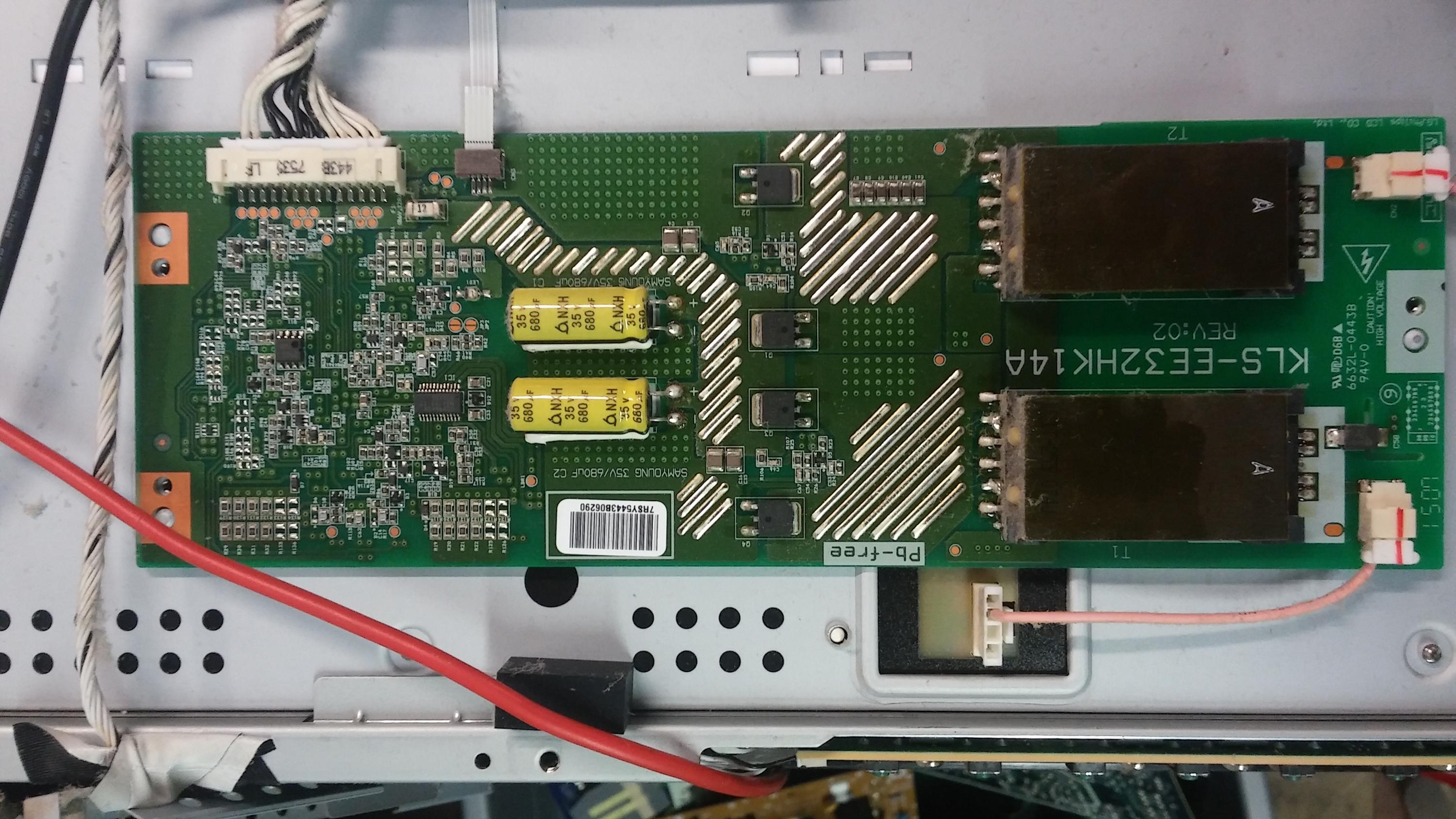

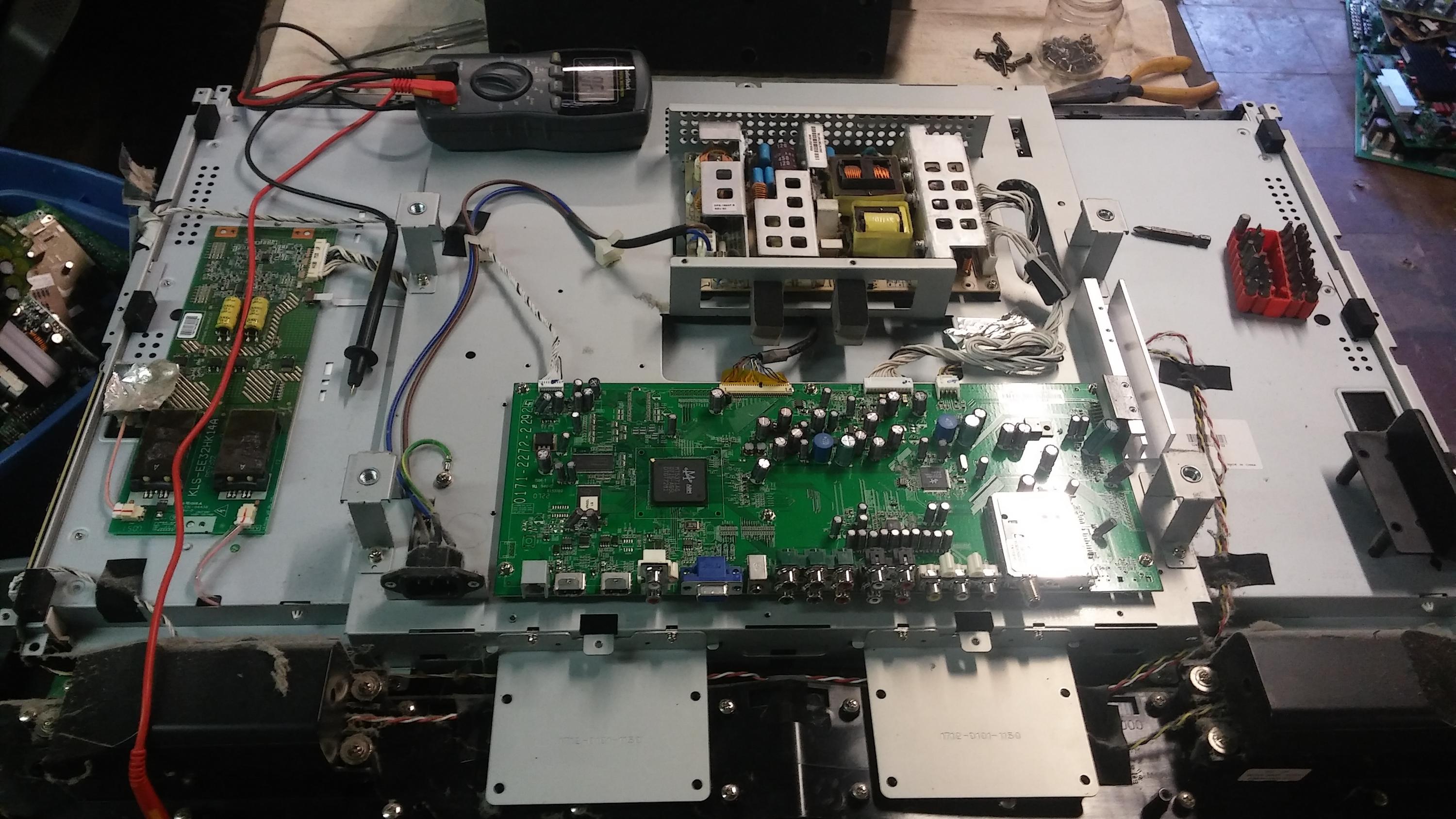

ok I got this set turns on just no backlights, has 24 v coming from inverter, fuse on inverter is good. I just don't see anywhere to check for bl_on or dim voltages . trying to troubleshoot this to determine which is bad. its model numbervw32lhdtv10a
vizio no backlights bad main or inverter help?

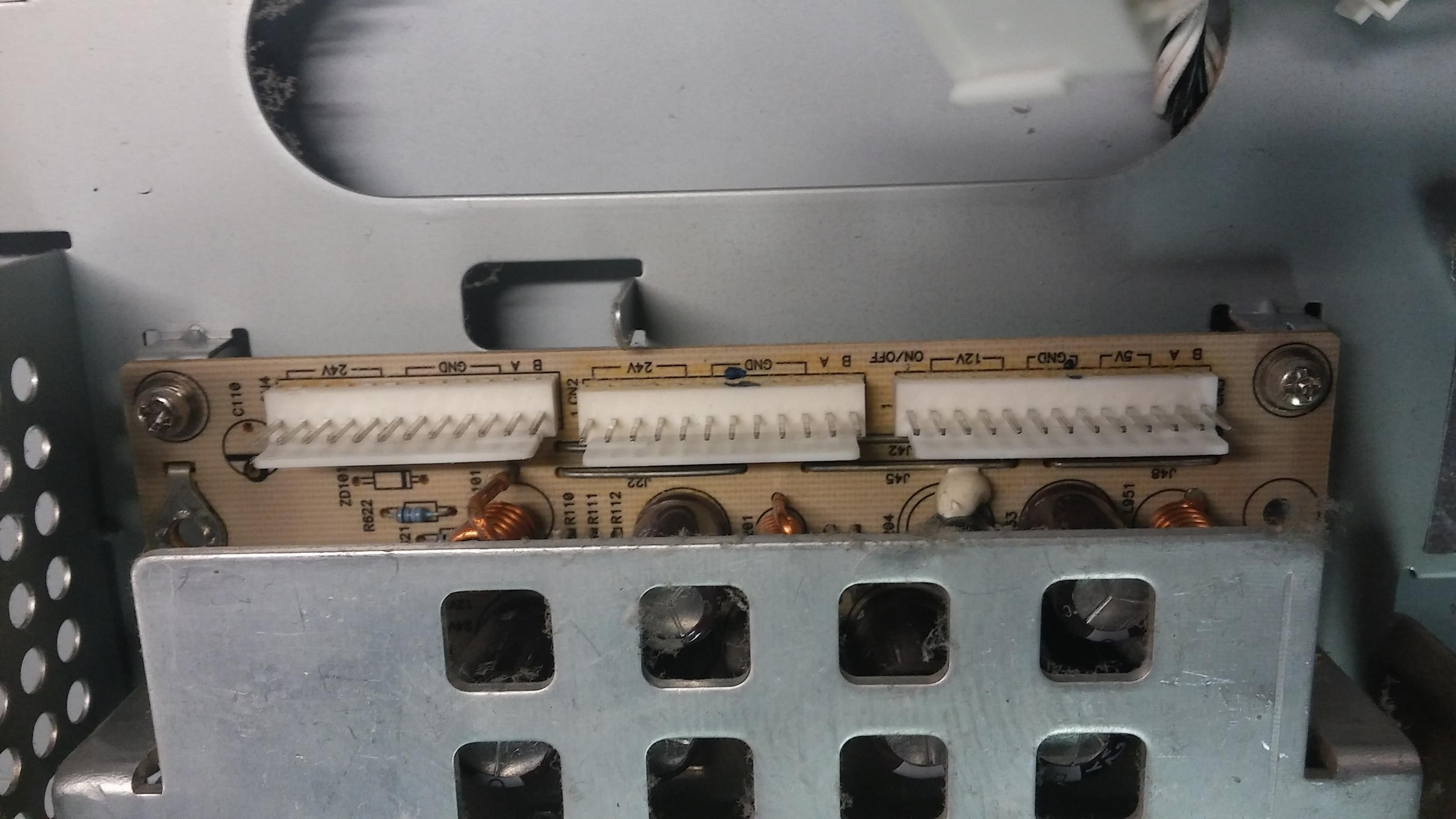

Check the DCV at the power supply board connector pin 'A', and 'B'. when TV is OFF and when TV is ON.Never stop learning

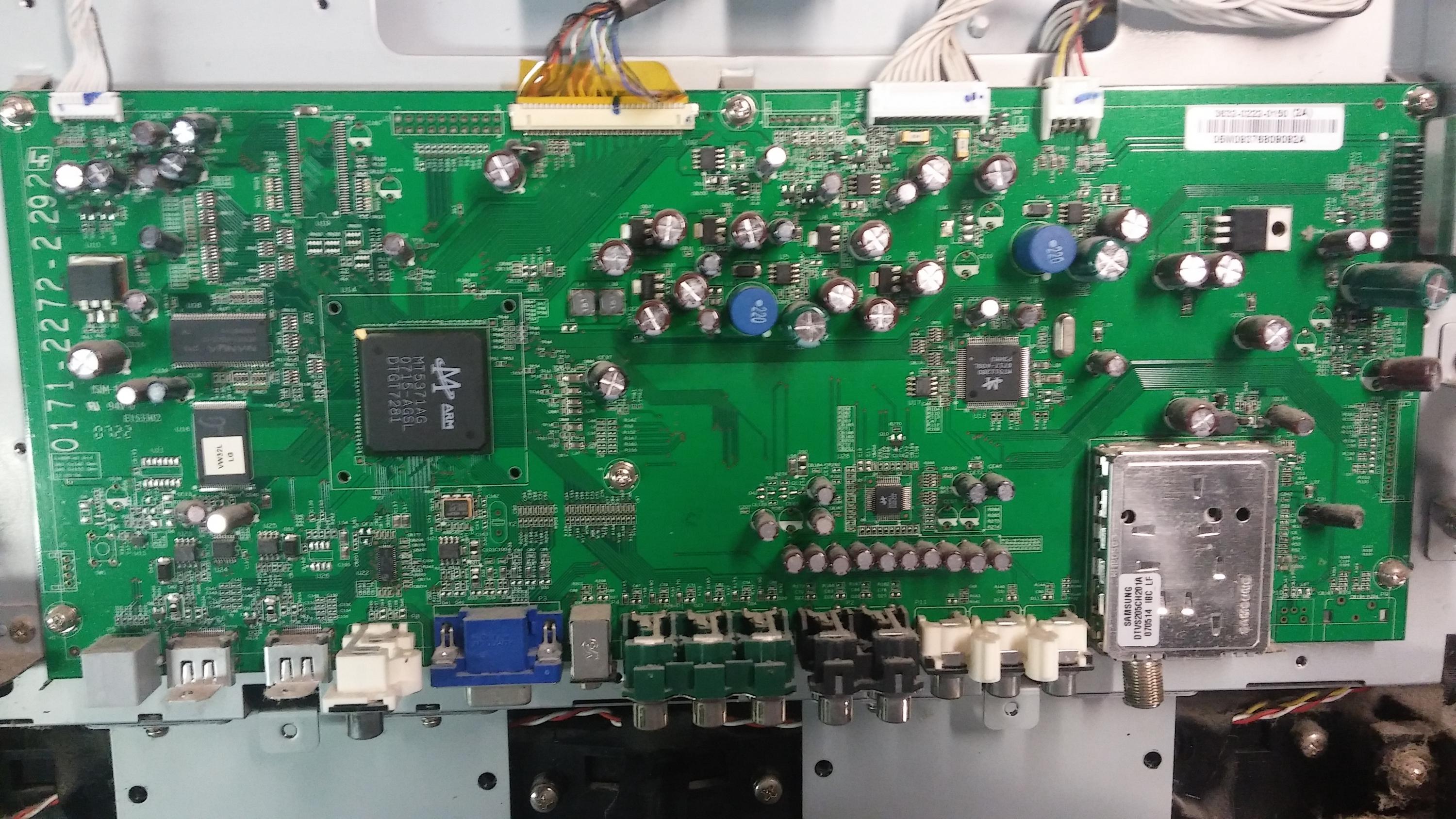

OK BUDM they both have pretty much nothing when tv is on and off. so if that's the dim/bl then main is bad, now is there anyway to figure out what on the main causes that?Comment
Re: vizio no backlights bad main or inverter help?
You need to check the Voltages of all 3 pins of those Voltage regulators on the main board, also the fuses on the main board.Never stop learning
