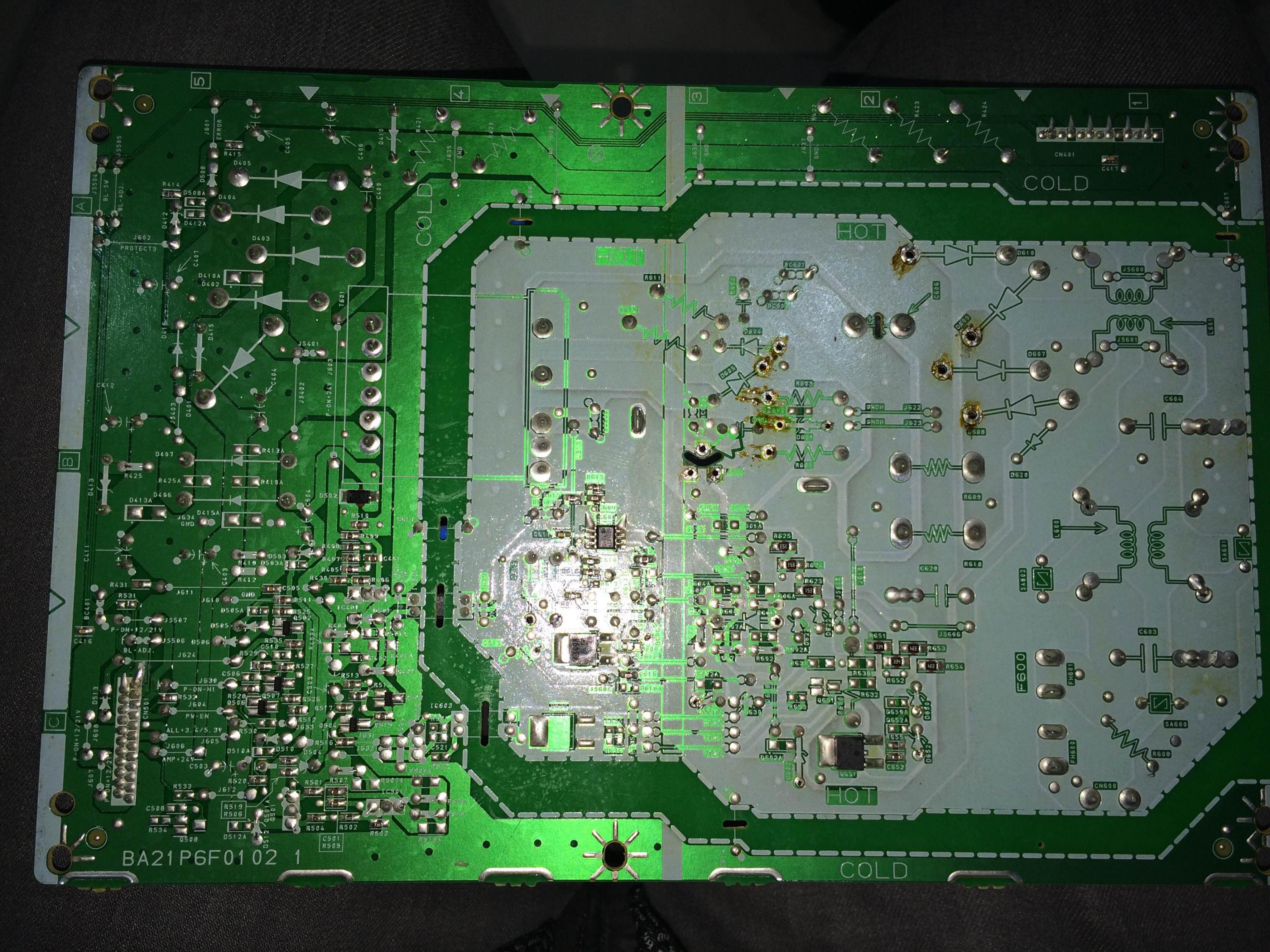

    Hello Experts
    Need your help with SMPS repair for my LCD. The details as below.

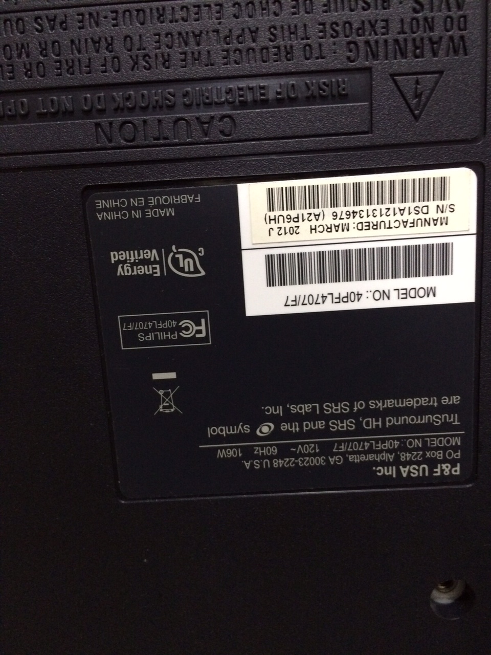

    1. Philips 40PFL4707/F7 Manufactured March 2012
    2. SMPS Board BA21P6F01 01 1
    3. SMPS board has a sticker that says A21P6MPW C 7219720
    4. This is a 110v Mains Supply TV sold in USA
    5. I imported this from USA into my country where we have 230V.
    6. I have a simple winding transformer that converts 230v to 110v
    For last few months, the TV was not in use and last week when I wanted to use it,I found it not powering up.
    Primary suspect
    1. Something went wrong inside the TV OR
    2. Someone messed up the Main supply point and by mistake connected it to the 230V supply directly

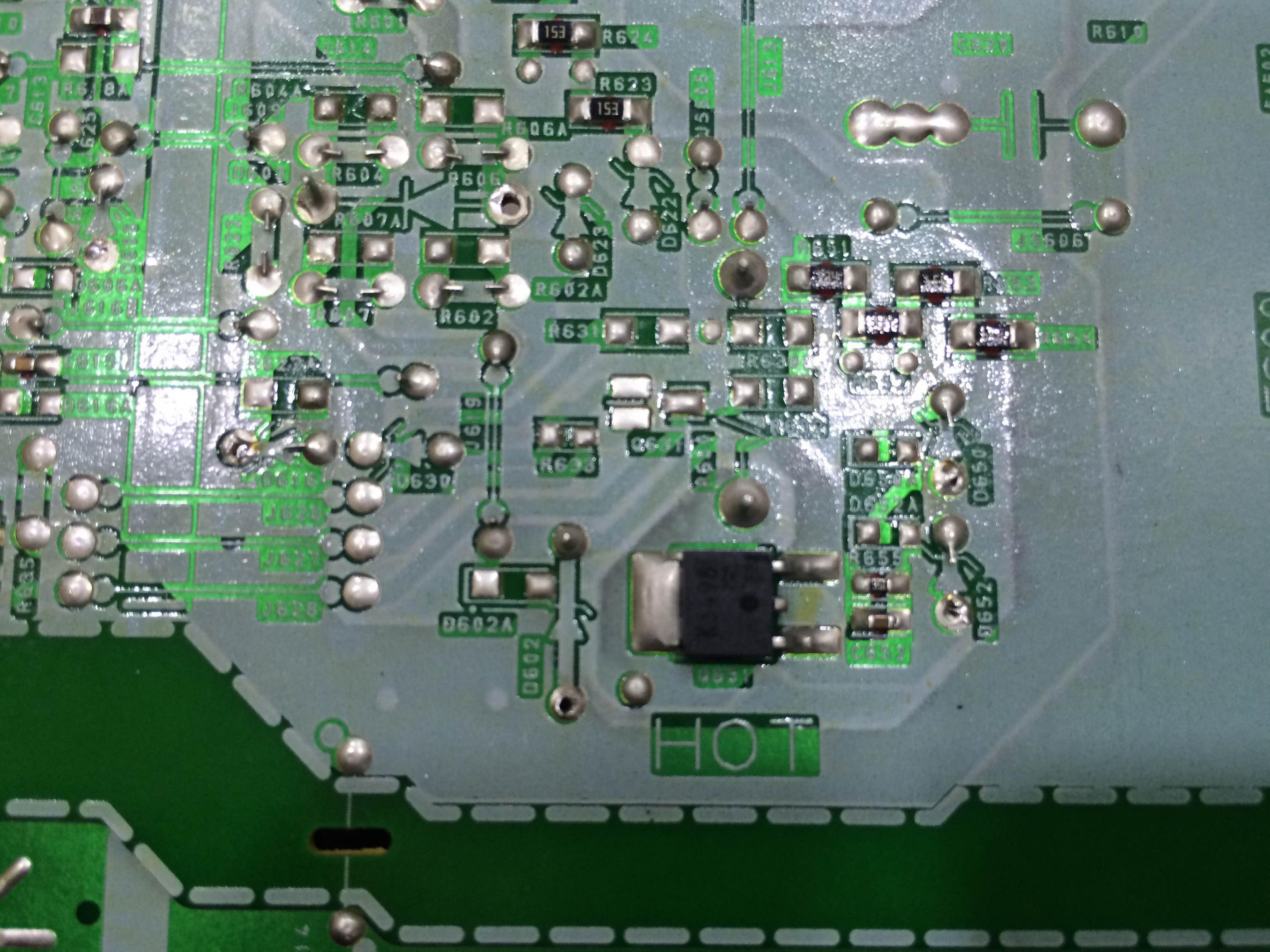

    I opened up the TV and found the fuse was blown. DMM test of Q601 ( K10A50D Toshiba MosFet) revealed that its Drain Source is shorted.
    I did following tests
    1. Desoldered one leg of all the HOT side diodes and all are Ok.
    2. Did DMM continuity test of all the primary suspects on the HOT side and all are ok
    3. No component is burnt
    4. I had a spare IRF840 Mosfet. Its rated 500V and 8.5A. I replaced it for Q601 and the fuse got blown again. The MosFet was shorted again.
    I looked at the shopjimmy.com repair kit for this TV model. All those components that he sells are perfect tested on my board.
    Need help in various areas like
    1. Any one has the schematic and service manual accessible for this model ?
    2. Should I just insert a K10A50D and try once ? I feel it will blow up. I used IRF840 as its cheaper and easily available locally.
    3. Do not solder Q601 and insert fuse and see if it blows up again ? That will show something else is wrong in Hot side.
    4. Should I suspect the Gate circuitry ?
    I am still not sure the root case of this issue. If its indeed supply of 230V then some component is blown up that appears hard to find.

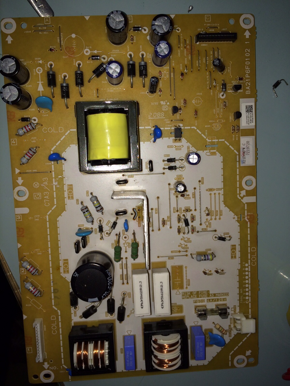

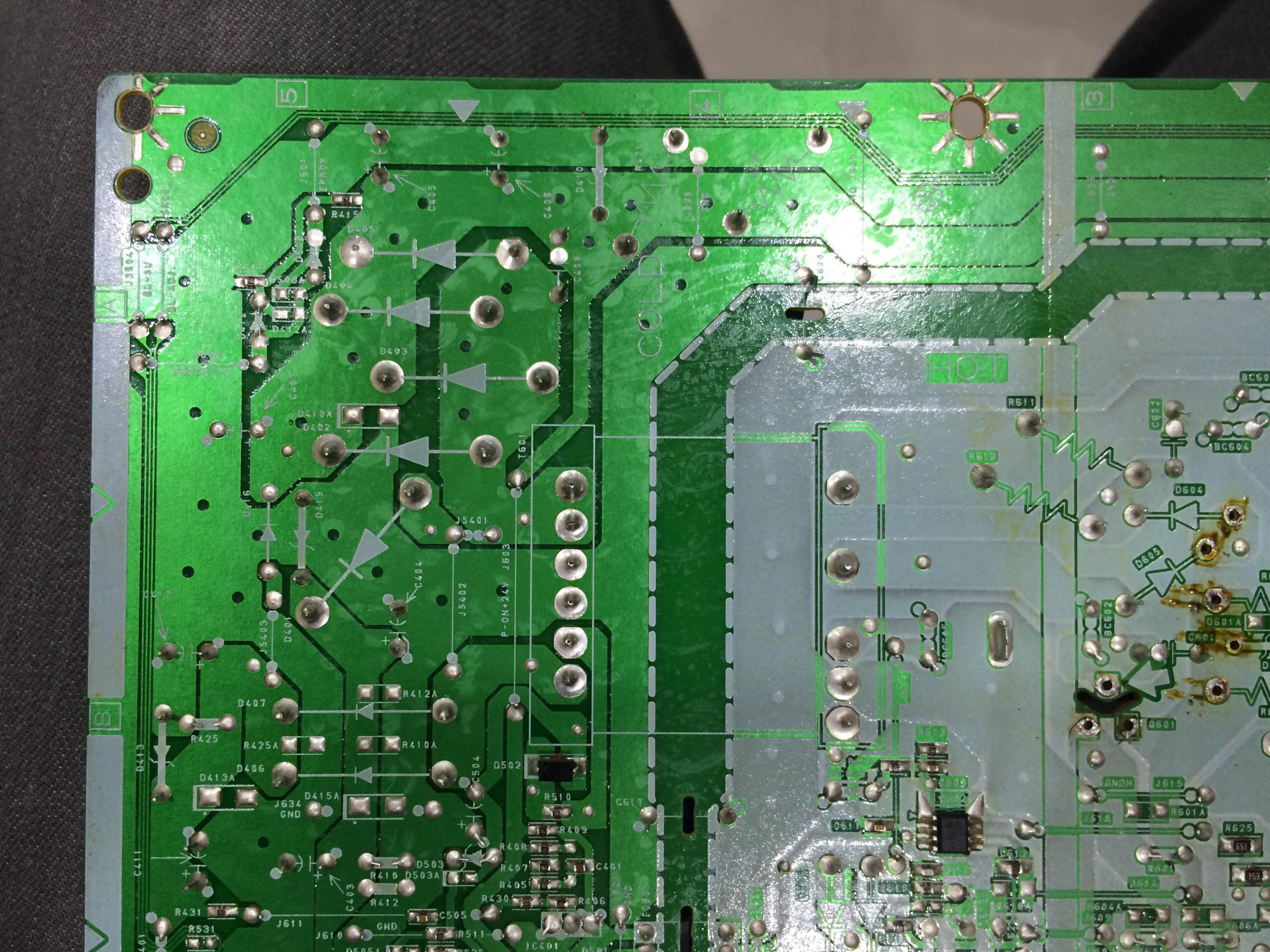

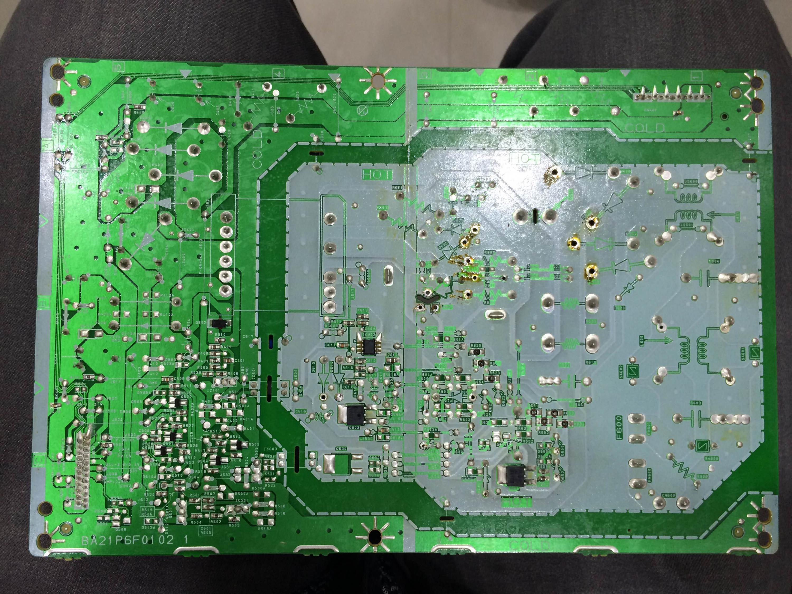

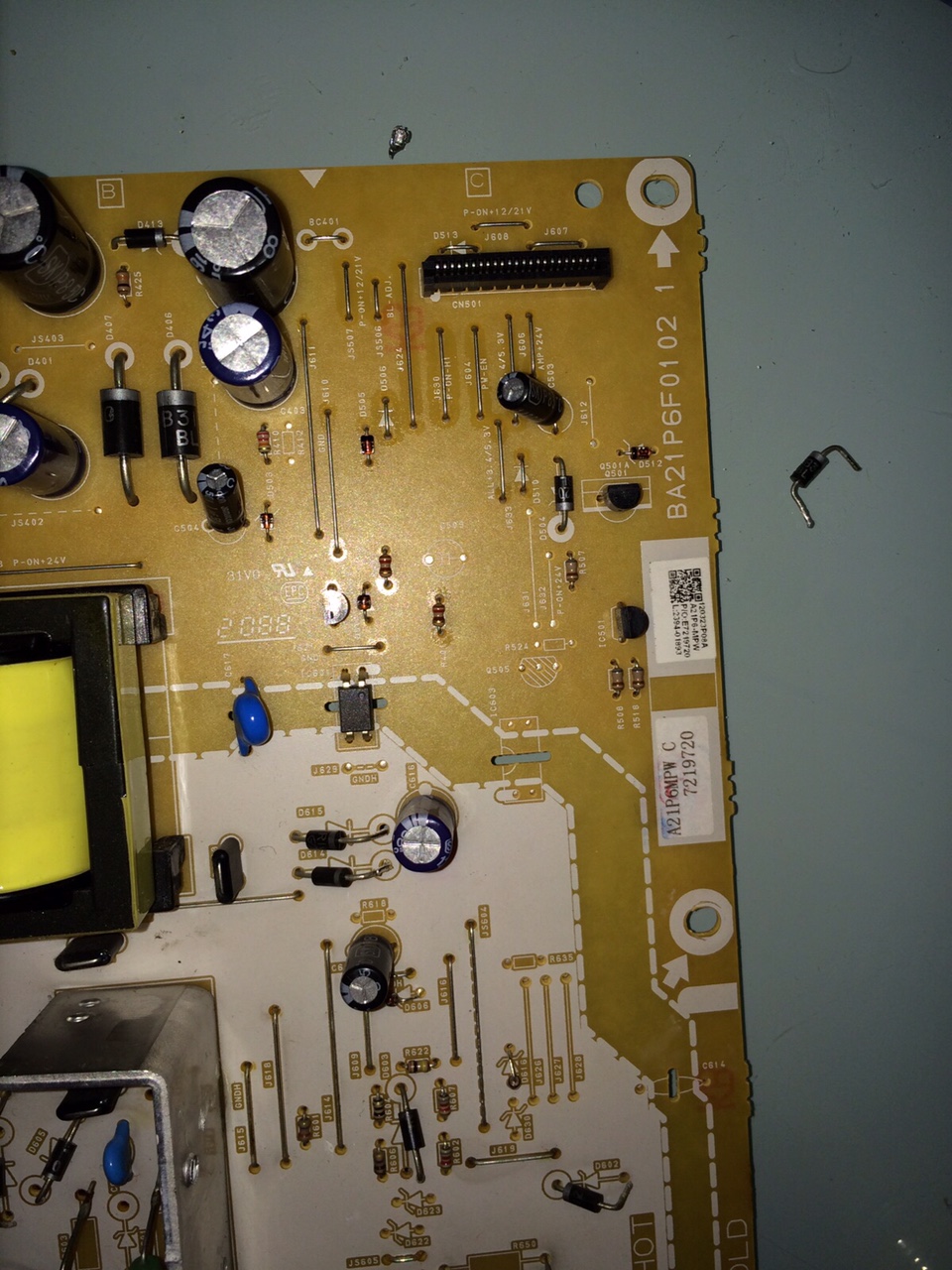

    I am attaching some images

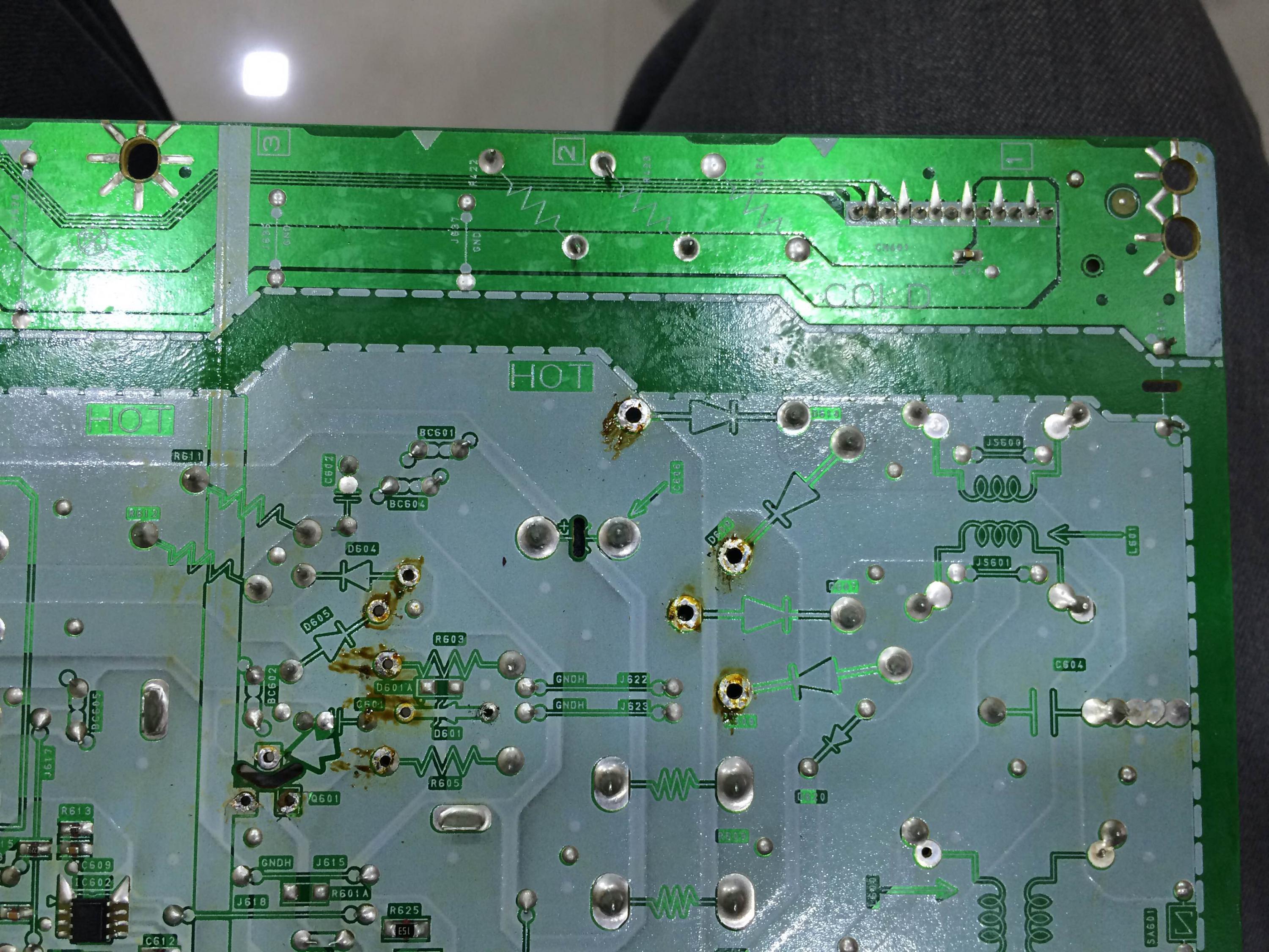

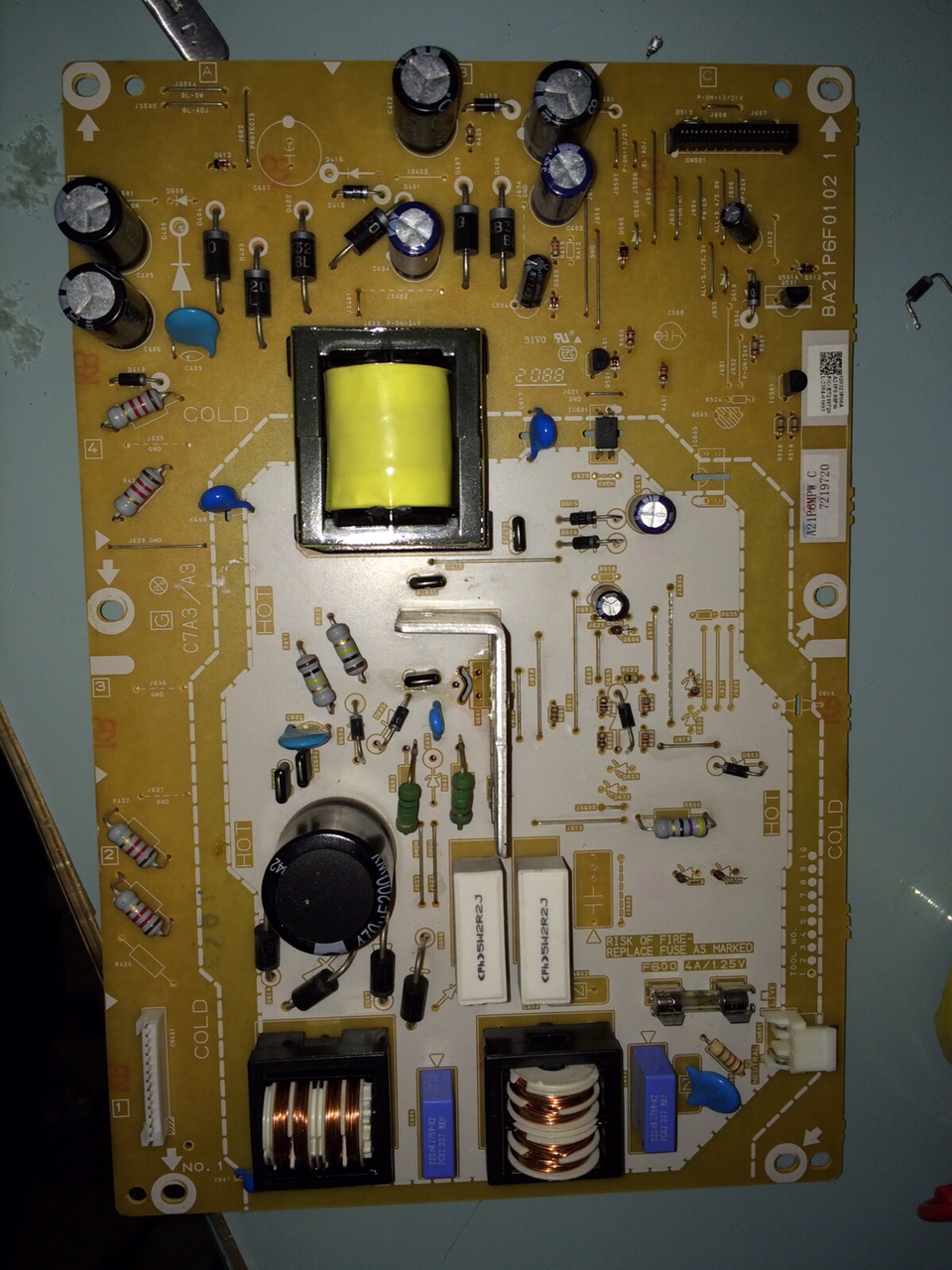

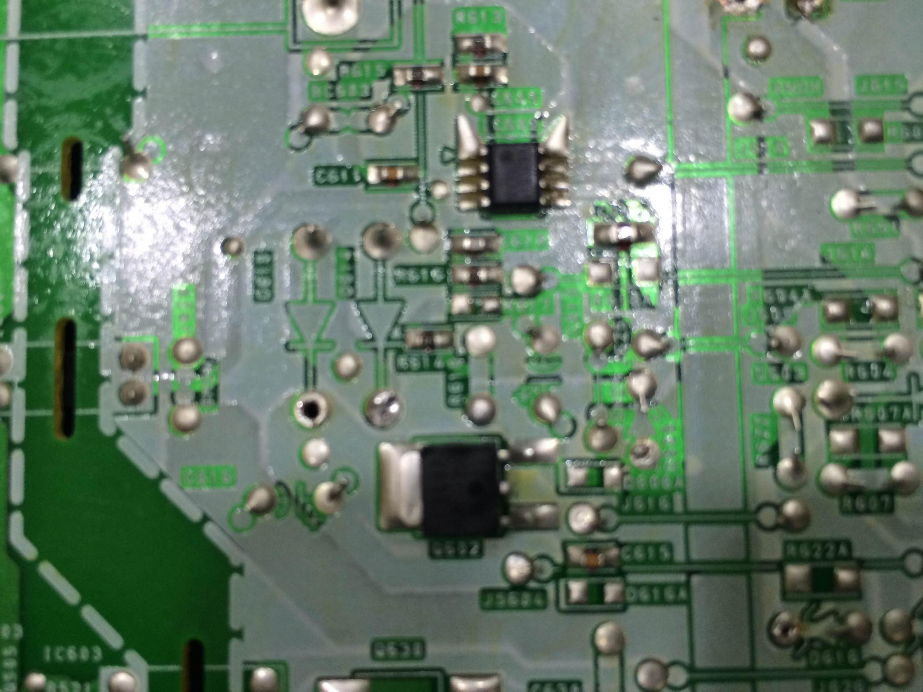

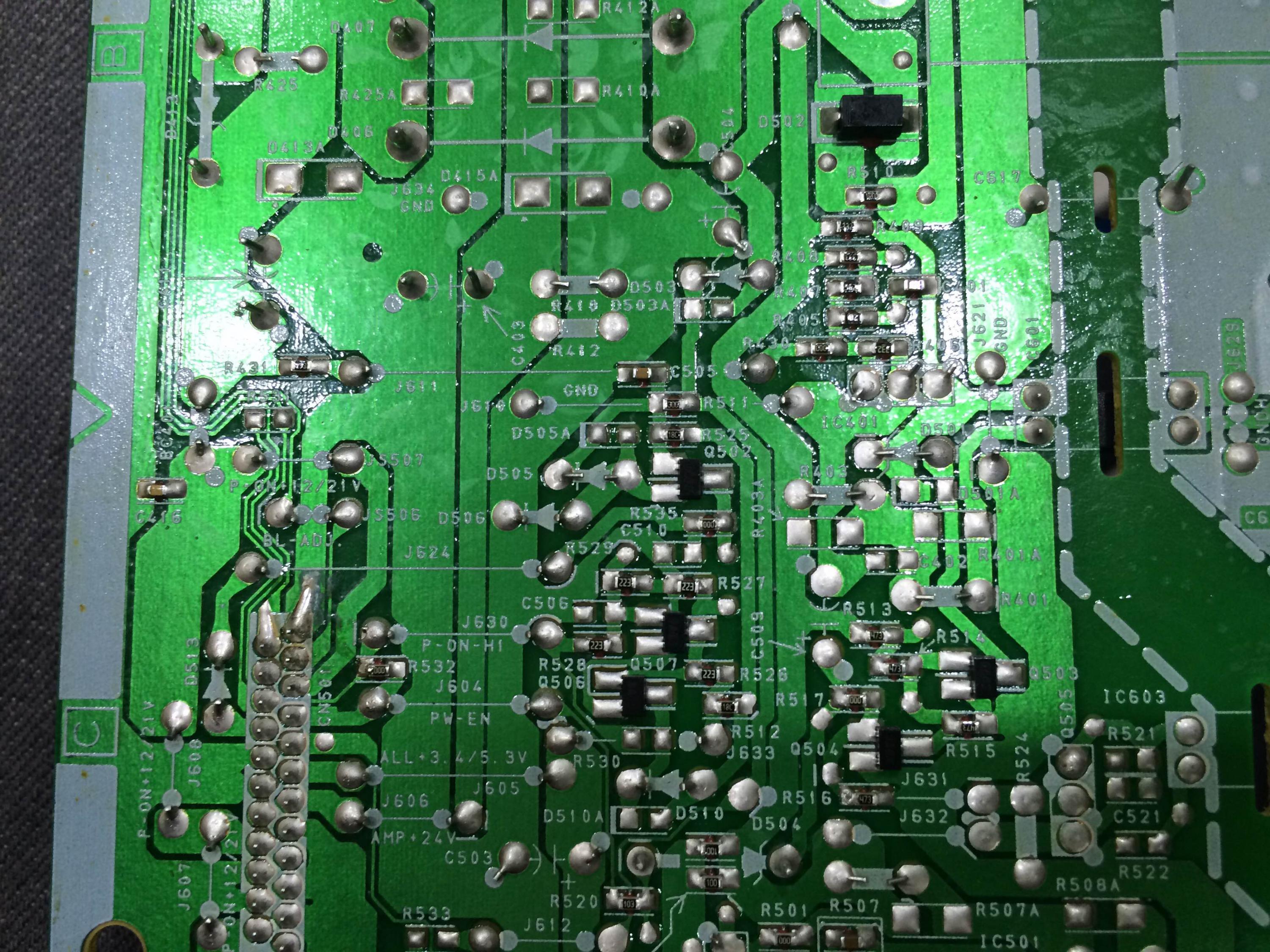

      If the Fet fails it will probably kill the gate circuit. Take pictures of the underside of the board buddy.

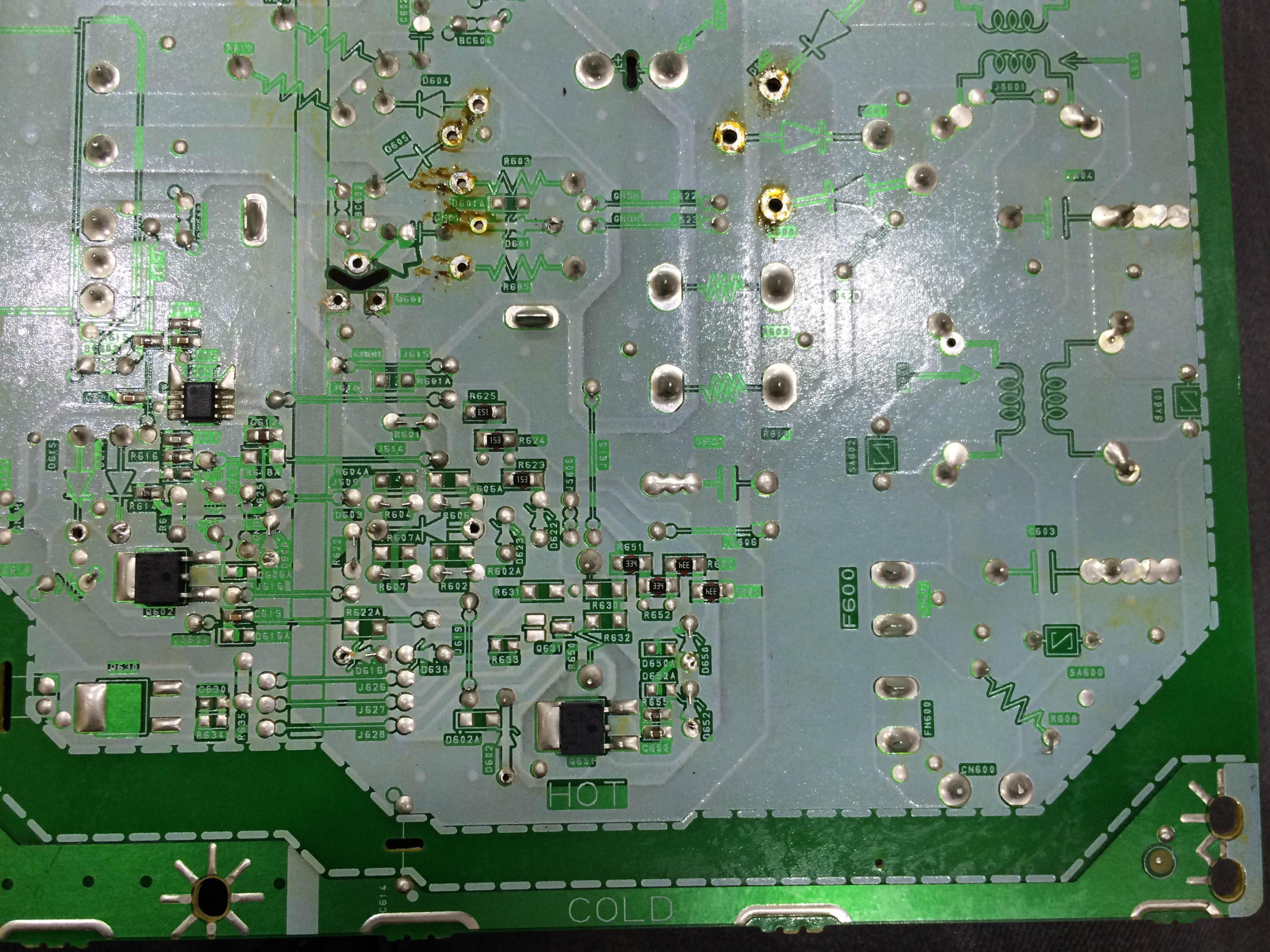

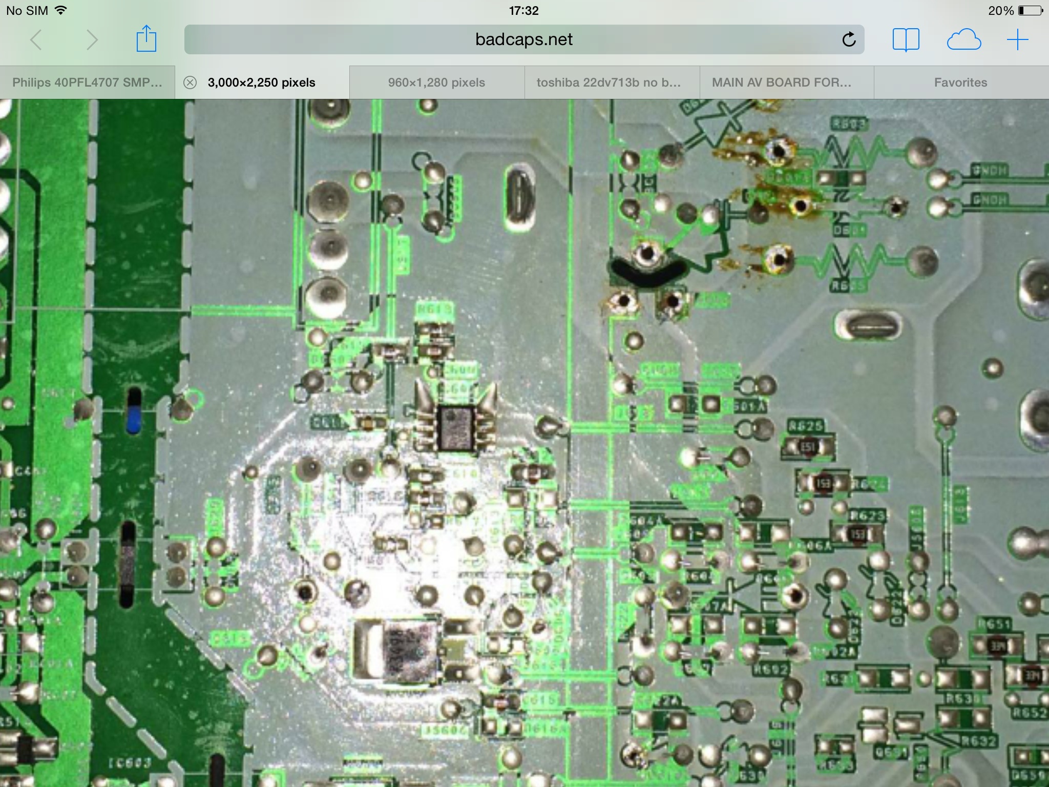

        Re: Philips 40PFL4707 SMPS fuse blown.
        Hello ReeceyBurger123
        Thanks for your response buddy.
        I am attaching the pic
          Ok checked the resistors and Ic showing in my pic for S/C. If there aren't any other shorts on the board after that probably safe to put a new fet in and fuse and test.

            Is there a particular resistor you want me to check for shorts ? Or you want me to check for all the resistors short in this circuit in your picture ?
            Can you please elaborate how to check short circuit in the IC ? Any particular pin pair I need to check ?
            Right now, I have desoldered one leg of all the diodes on the entire board and none of them are short and they pass the DMM diode test nicely.
            I was thinking to do this for all the resistors and then repeat the one leg desolder test for all capacitors.
            However I will follow your expert instructions if there is a definite way to zero in on the problem.
            Do you know the IC no ? Do you the schematic or service manual ? I am not able to read the IC no even with a magnifying glass.
            • fzabkar
              • Mar 2009
              • 772

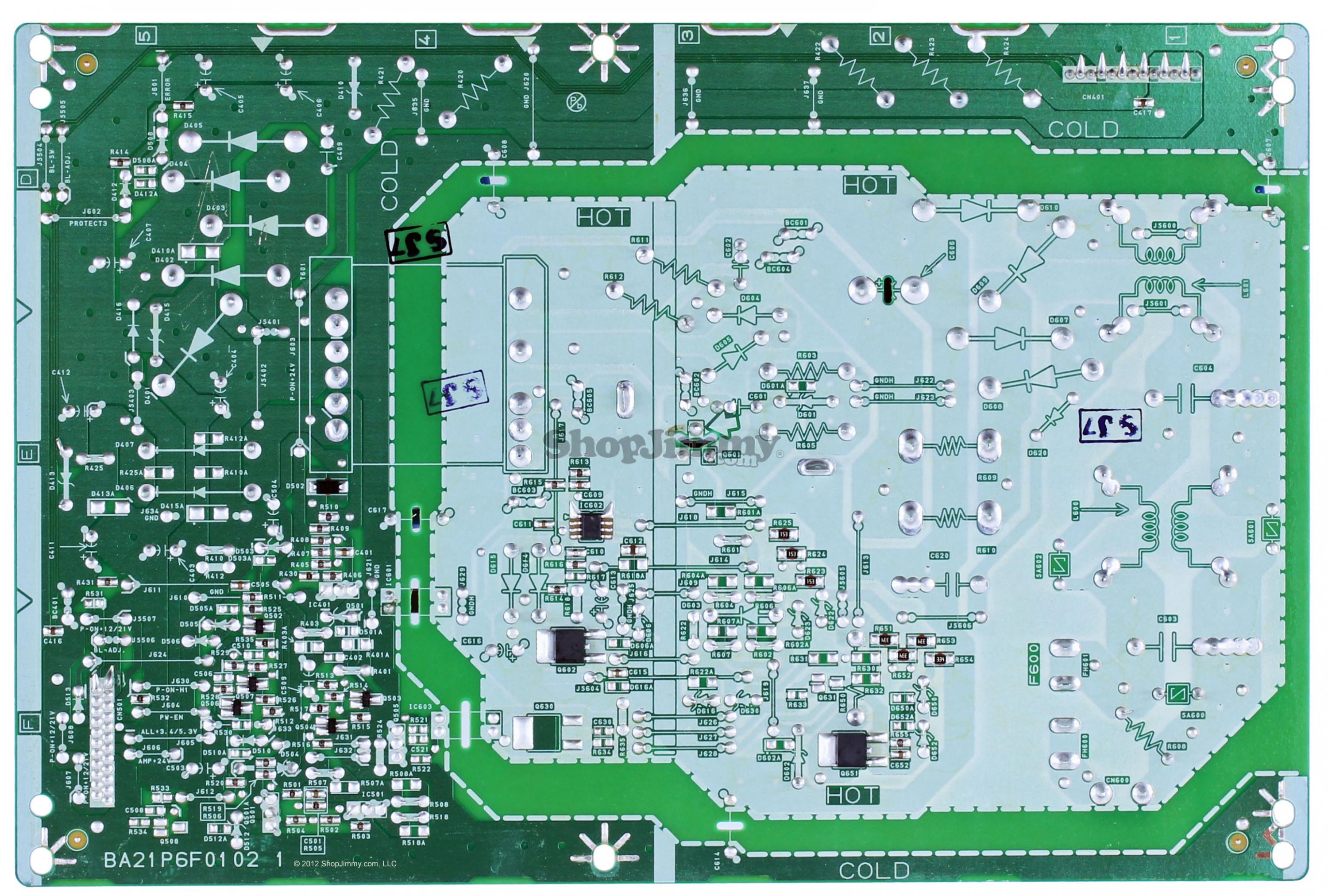

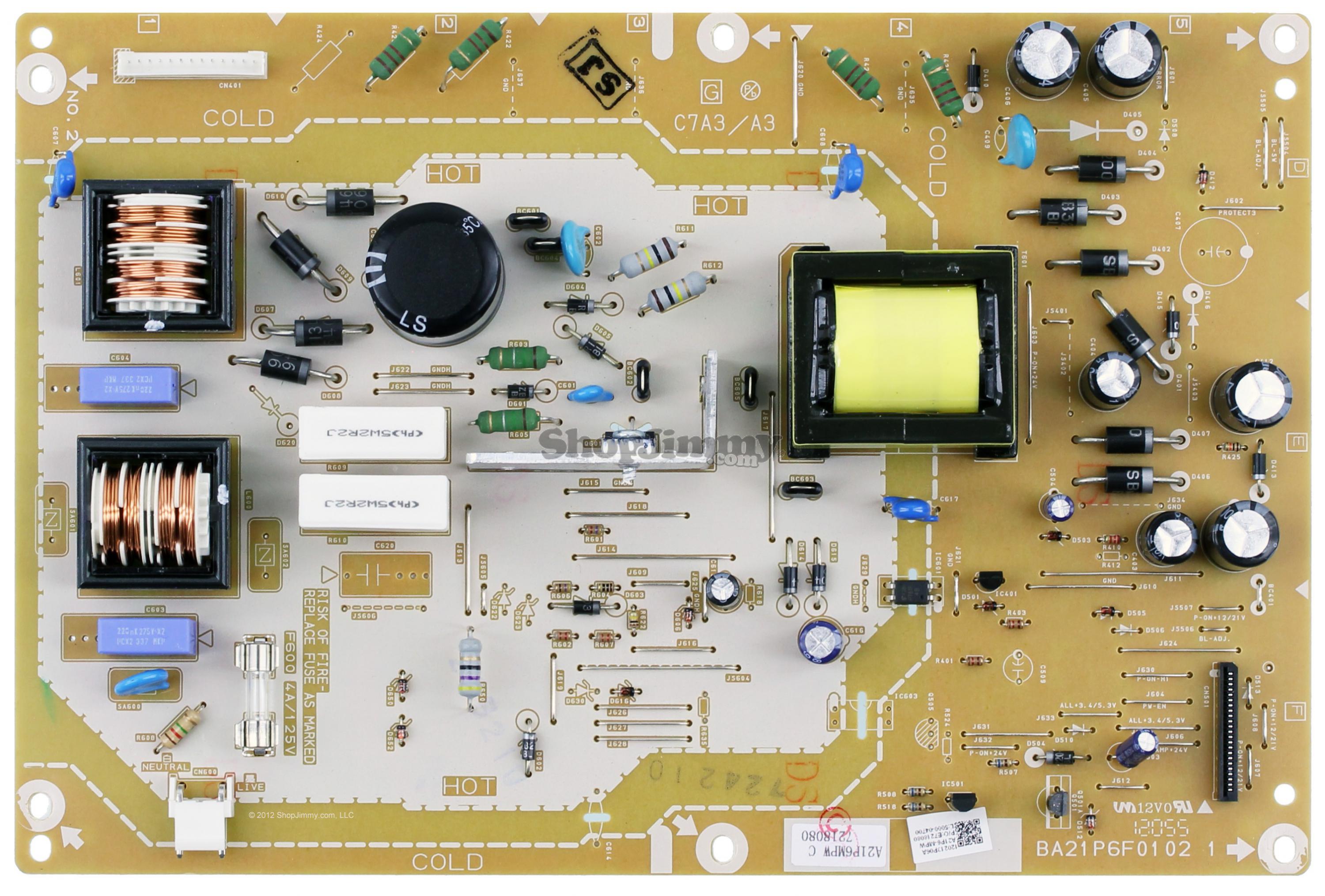

              Here is a better photo of the top side:
              http://assets.shopjimmy.com/media/ca...pw-001-top.jpg
              Can you tell us the markings on the PWM IC and Q651?
                  Pictures provided by SHOPJIMMY.
                  Look at the repair kit and then inspect those parts on the list.

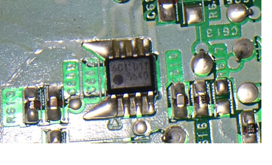

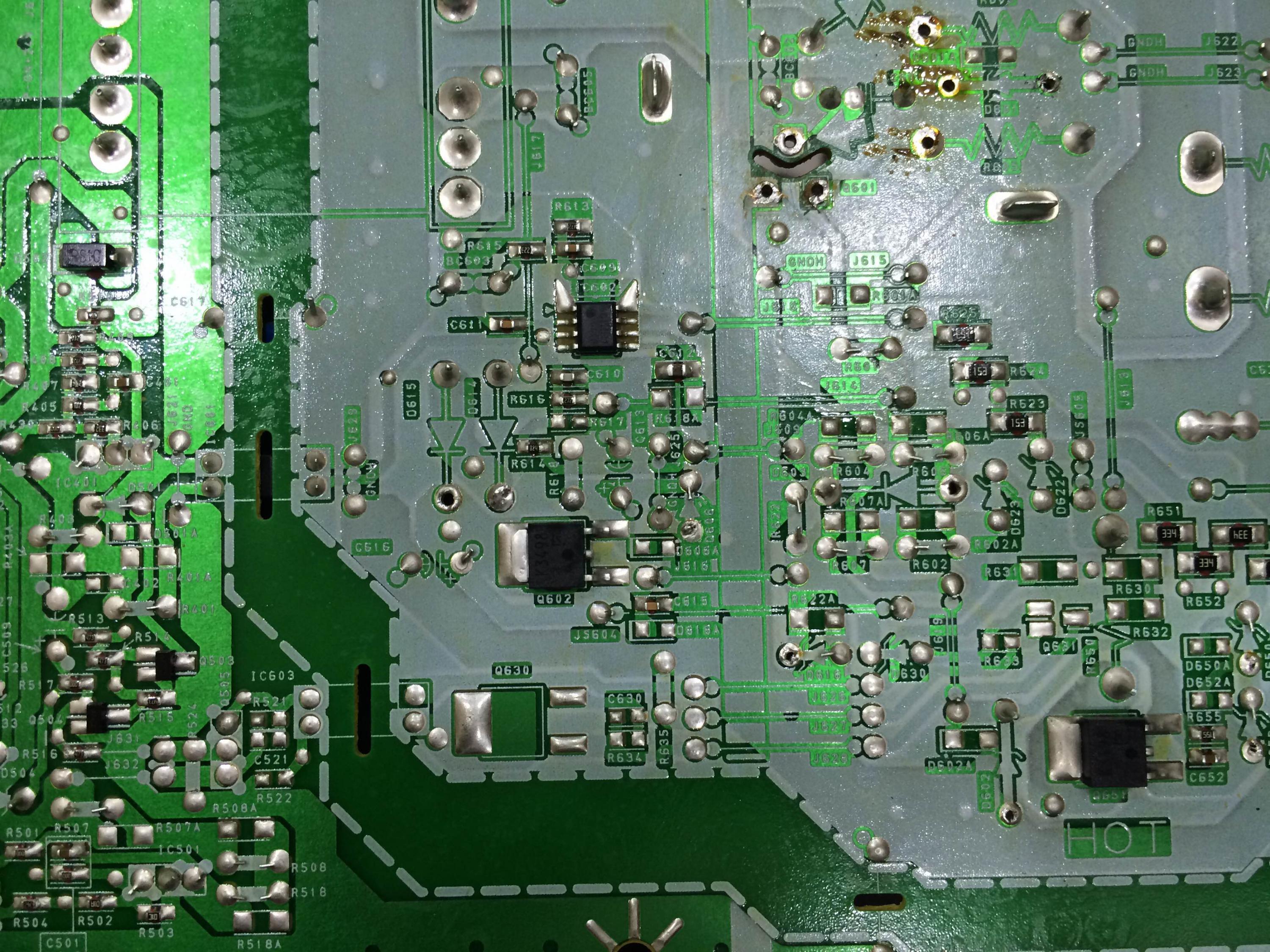

                        Did some troubleshooting. Here are the updates
                        1. All diodes are good on the board. DMM test passed after desoldering one leg
                        2. All small and big resistors are good. DMM test passed after desoldering one leg. I am yet to test the SMD resistors and there are very few very very small ones.
                        3. Tested DMM test of capacitors and they appear good. I dont have ESR meter.
                        Please find attached image of the SOP-8 chip. I need some help. Is it a buck converter IC ? Is really a G5640 2.5A buck converter ? How do I test if its good or bad
                          Make yourself a new jig. Google something like Light Bulb Trick for power supplies. I think budm also has it on his site somewhere.
                          I wouldn't bother testing the small resistors...
                          Just make sure all the Mosfets and diodes, caps are good and the gate drive circuit on the Mosfet. Then try the PSU on the Light Bulb protection trick and see what the PSU does. The light bulb protects the PSU from blowing out again.
                            I suspect the FA5640 SMD PWM chip. All other components are tested and they are working properly.
                            I am not able to buy this chip locally. I am thinking to replace it with TL494 which is readily available in my local stores.
                            I know replacing a IC with a totally different IC is crazy idea ( as I will have to create an additional circuit for it) but I am not a professional repair person who has to finish the task in limited time. I am a hobbyist.
