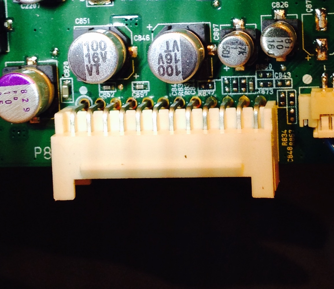

    LG 47LG70 Video Board P800 Soldering
    I have an LG 47LG70 that has no video or audio. Backlight works fine. I was examining the video board and noticed on connector P800 on the board that the pins are soldered on the bottom of the board but a lot of them are not on top. Is this normal? Should they be soldered on both sides of all the pins. I am attaching a photo so you can see that I am talking about. Looks like on the bottom of the board it is 12v, 16v Grn, and 5v pins. Board has number EAX55177902 (0) stamped on it.

    Re: LG 47LG70 Video Board P800 Soldering
    No not needed ,the holes are bonded through and require only to be soldered one side
        checked the voltage on the fuse on t-con board and it is 12 volts. Suspect that the video board is bad but cant find a replacement anywhere. Has anyone found any repairs for this video board?
