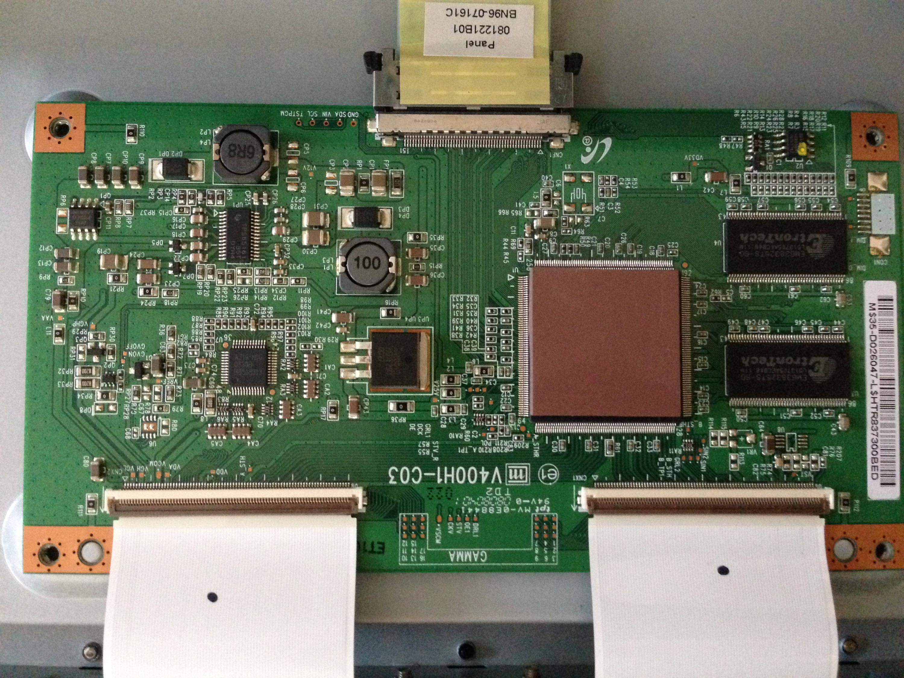

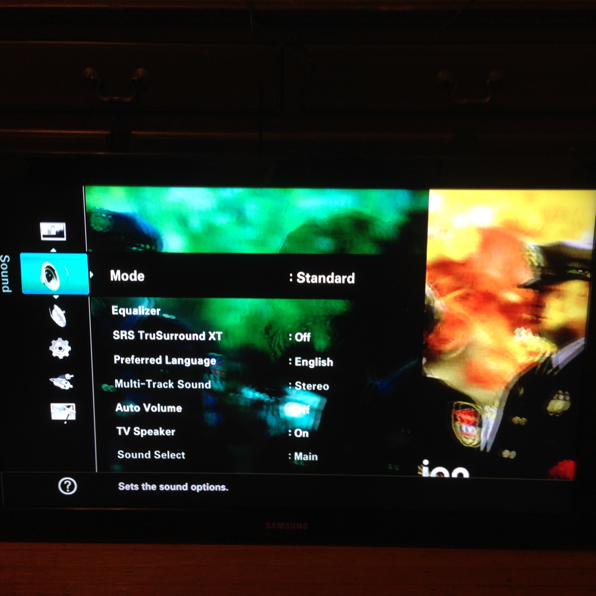

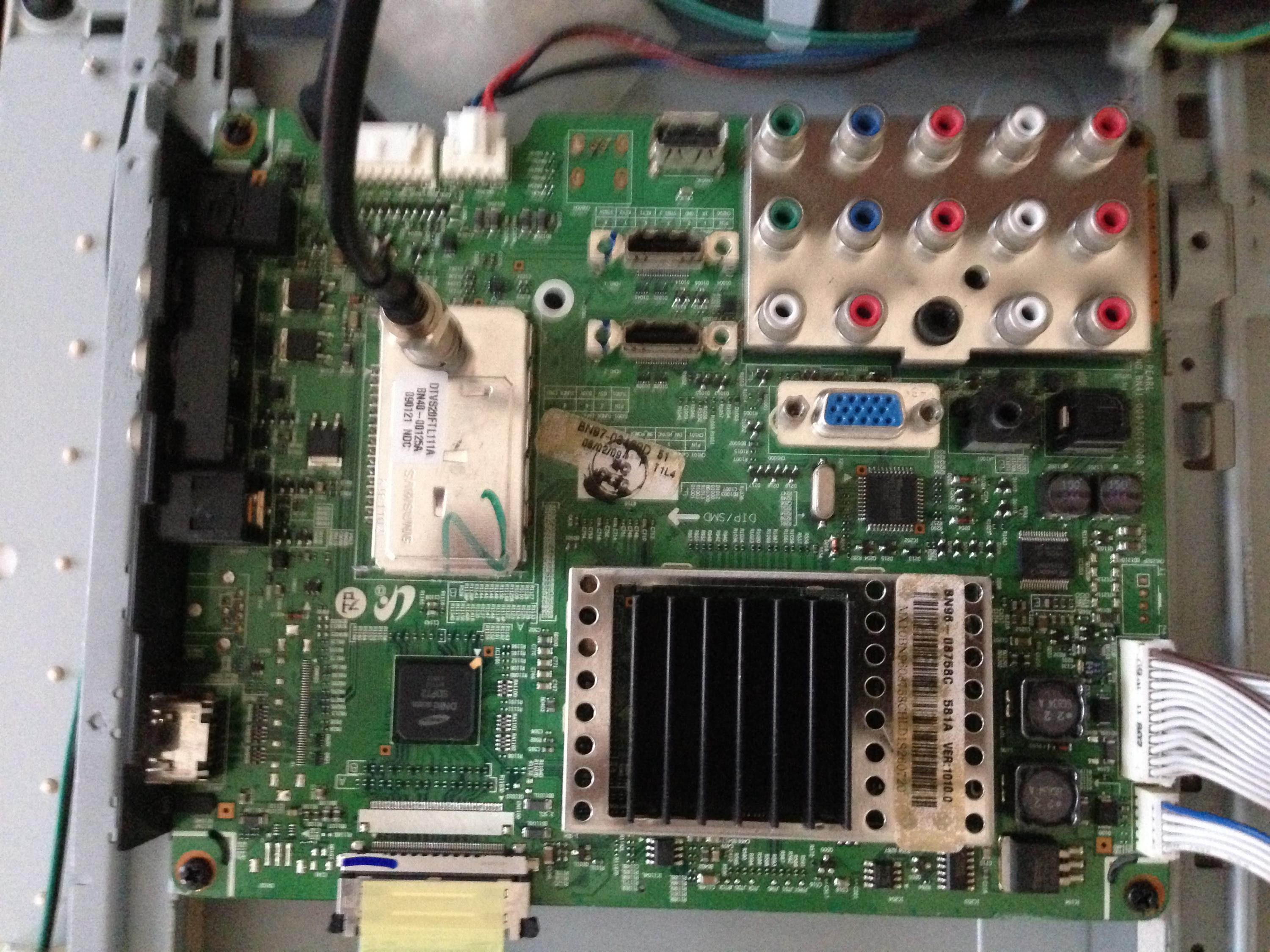

    I want to take a crack at fixing the solarization issue with this LCD TV. I think its the T-con board that needs to be replaced based on my views on youtube and this forum but i wanted to double check before I proceed.
    The main choice is loose connection, bad main board, and bad T-Con board. I posted a picture showing solarization of the menu options which leads me to believe that the it is the T-con board which is the issue. I tried playing around with the connections and did not help much at all.
    So I'm thinking I need to buy a t-con board and replace it. I have no soldering experience so I want to just buy the whole board.
    Can someone help double check my thought process and also please help me find a place to buy this board. I've seen options from $25 to $80 so obviously would like to keep the cost low but also do not want to spend more than necessary. I've attached three images, the solarization itself, the pics of the main board and t-con board. I hope they are adequate.

    More than likely the as19-h1g chip on the t-con.
    If you're not confident of replacing the chip
    You could phone round a few local computer or TV repair shops and ask if they will solder on a new one. It should be far cheaper than buying a board.
    You'd need to check your gamma voltages to be absolutely certain, but I'd say it's very likely to be that chip.

      Thanks so much I'm fine buying a board for up to $50.
      Can someone recommend both a supplier also a procedure to make sure I buy the correct board!!

        Please provide the gamma voltages for your TV.
        You have 17 test points labeled here:
        Don't buy boards unless you are 100% certain it will fix the fault.
        Provide your results and we will be able to tell instantly if it is indeed the t-con at fault.
        As for 'where to buy boards'.... Anywhere that offers a full refund should the board be found to be faulty. Shop Jimmy are a big company in the U.S. But still ship out the odd faulty board (as other posters will testify to).

            Ok well I'm about 85% sure it's your t-con at fault.
            Please, update the thread if you change the board and the problem is resolved.

                            I replaced the t-con board with a $50 board from Ebay and TV is BACK IN ACTION! Thank you all for this! Saved me around $300 and maybe I can keep my tv lasting a few more years!

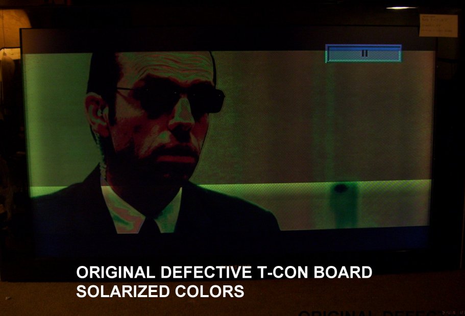

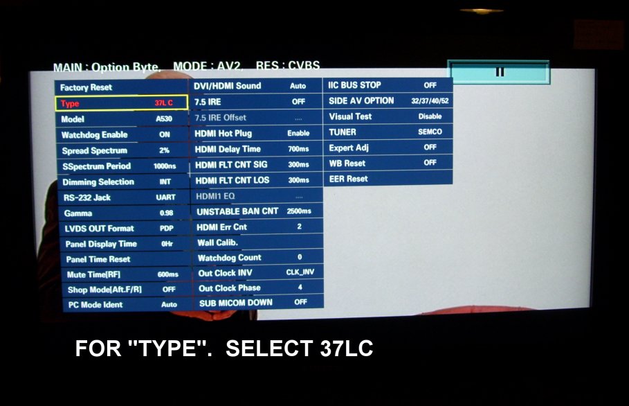

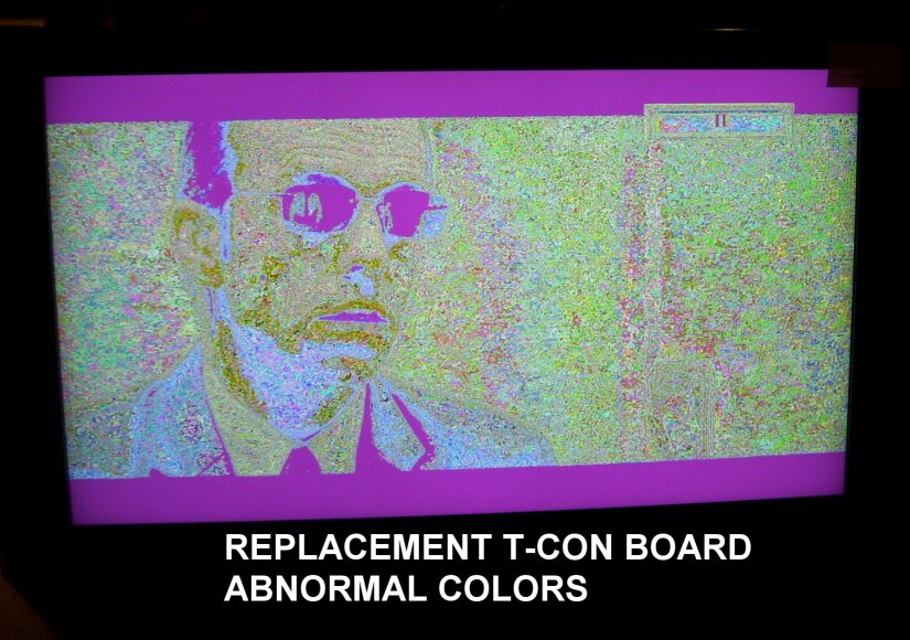

                                    About the Samsung LN40A530P1FXZA (LN40A530P1F) solarization issue.
                                    The T-con board for this TV apparently has a high failure rate.
                                    I had the same solarizaion problem. I got a T-con board from an eBay seller located in China. $44 with shipping. The board is V400H1-C03.
                                    The new T-con did fix the problem.

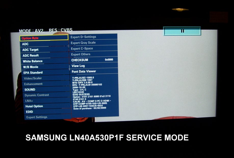

                                    However, when the new T-con was installed, the colors were totally crazy. To fix the color assignment problem, you have to go into service mode. With this Samsung model, start with the TV off. On the remote, press Mute > 1 > 8 > 2 > Power On. The TV will start up in service mode. Select "Option Byte". On the Option Btye menu, select "Type". Use the sideways arrows to select "37LC". The colors should now be normal. Cycle power to get back to normal mode.
