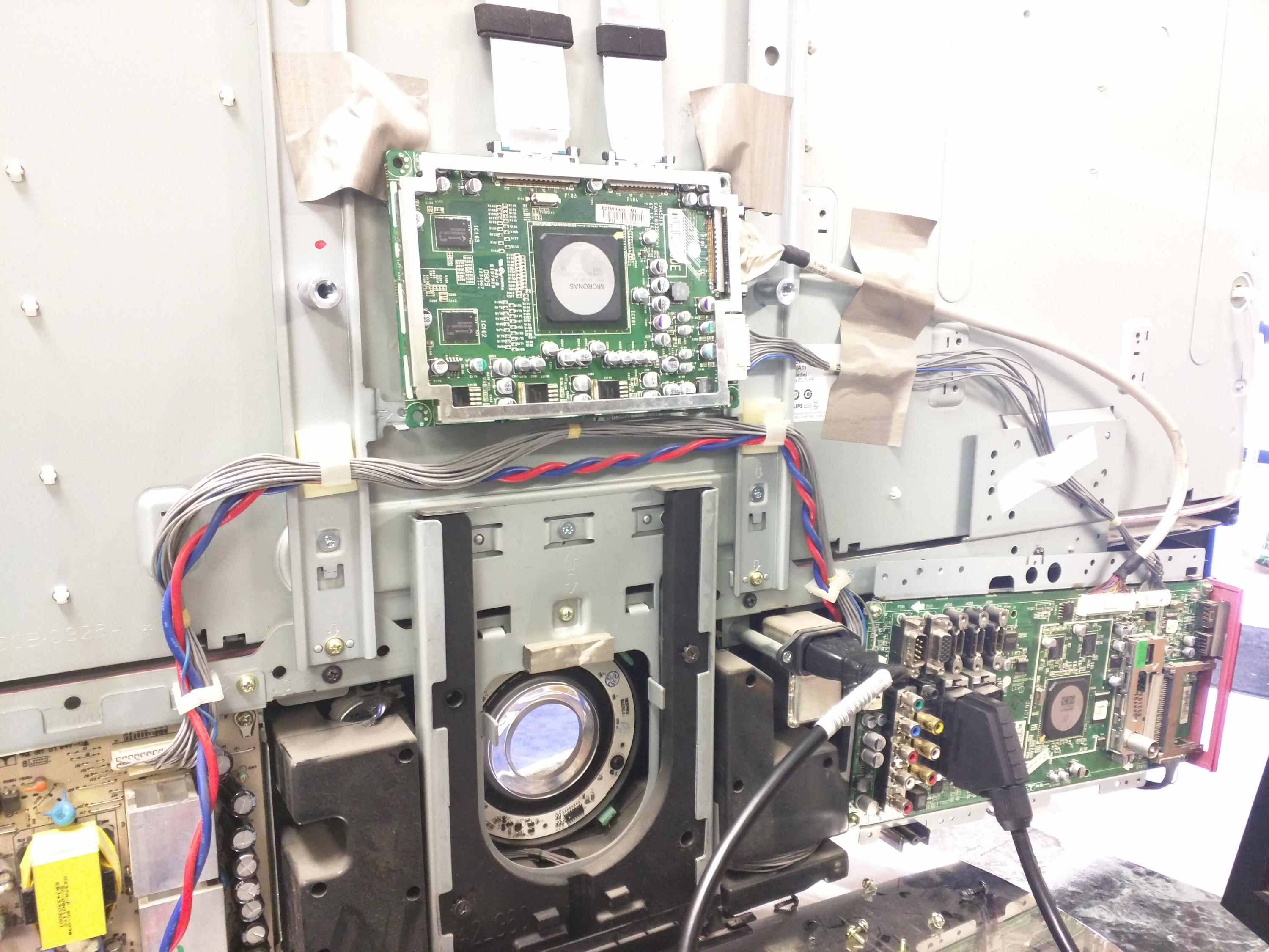

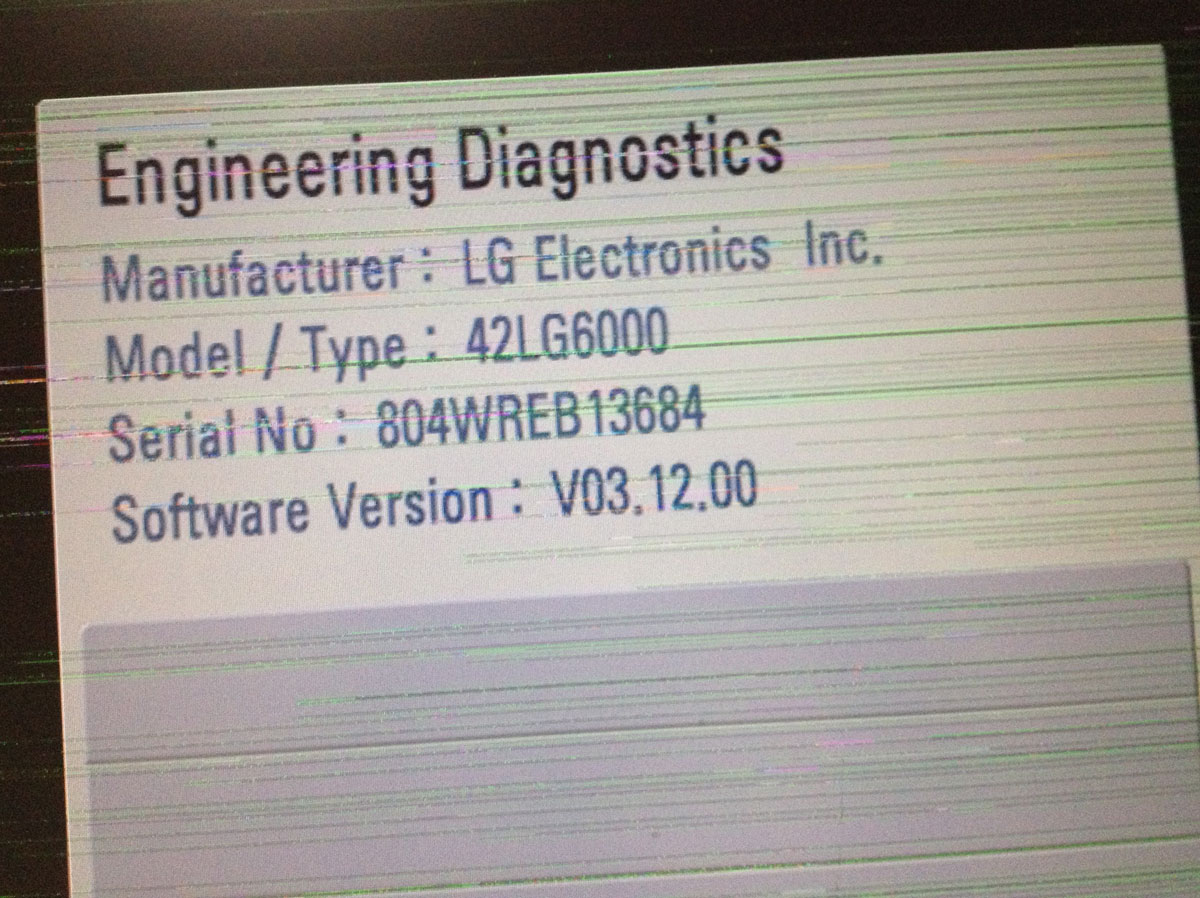

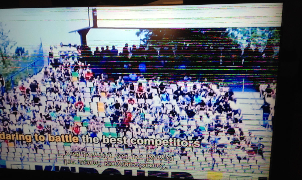

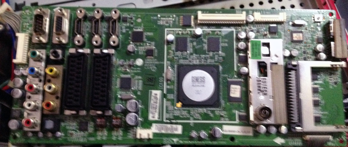

    I am very new this forum. I have a old TV model 42LG6000 model. longer to turn on, power light shows red, turning to white, black screen after 5 min showing full screen color horizontal lines. please review photos. I already replaced the LC37WU/LC420WU/LC470WU T-con logical board. Unfortunately, the problem still reaming. do i need to replace the main board? main board parts number is EAX39192001(14). can be work any other parts no similar type board.
    any suggestion would be appreciate.
    Many thanks

    This is a standard defect. You check the capacitors in the sub-module front Board t-con.

        Also try heating the Mainboard to see if that affects the issue had alot of issues with bad solder joints out of them Mainboards.

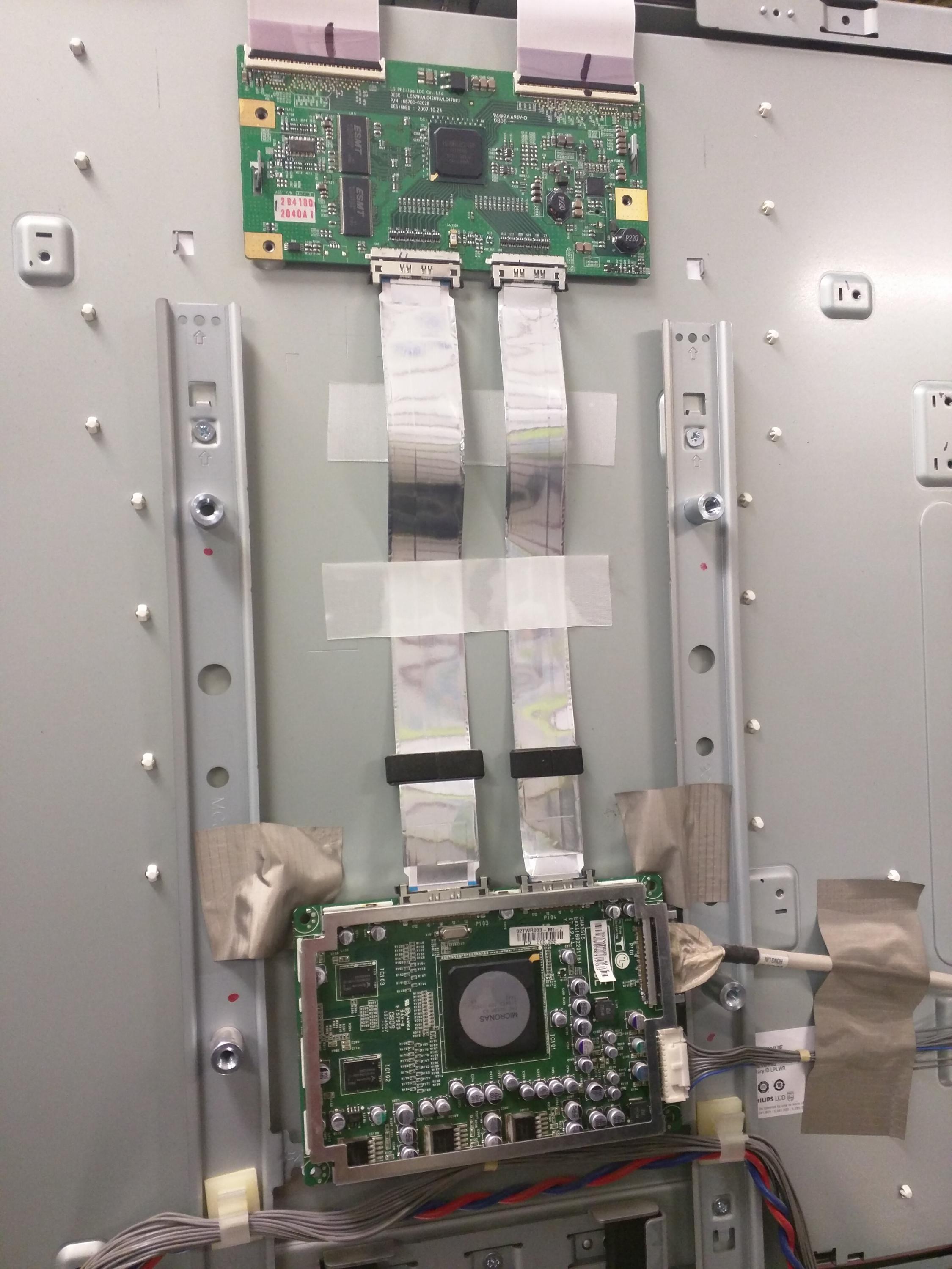

            The Tcon is the board that the Lvds connects to.
            • speedypro
              • Feb 2013
              • 561
              • United Kingdom
              Re: LG 42LG6000 horizontal lines
              TV looks like this:
              I did, however, replaced few swollen caps on the PSU.

                        Hi, this is the most common problem in this TV model. The problem is the two smd capacitors 100uf in the board between the t-con and signal board (C403 & C398). The capacitors are both in the bottom right of the board. Just replace these capacitors and the problem is solved. Do not buy this board in second hand because this problem is very common and the second hand board will fail after some time (the original capacitors of this board are very bad). {found it on internet was posted by DiogoADR i fixed mine that way same syptoms,hopefully someone else will find it usefull although its very old post}
