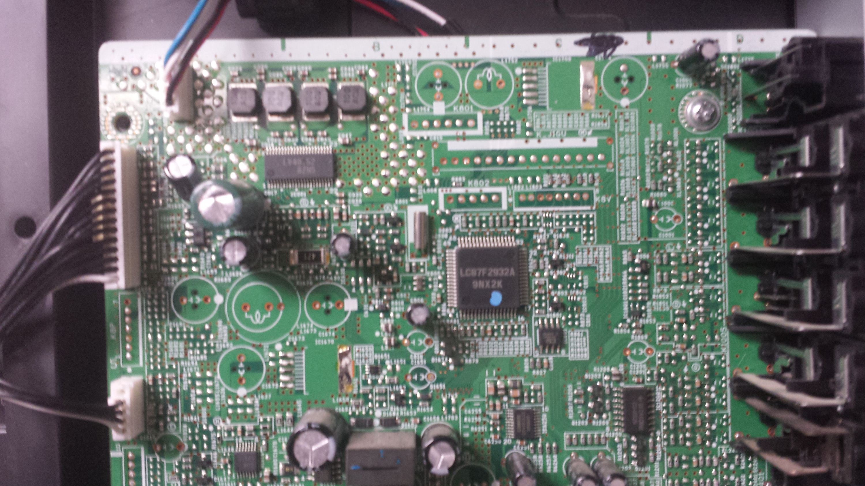

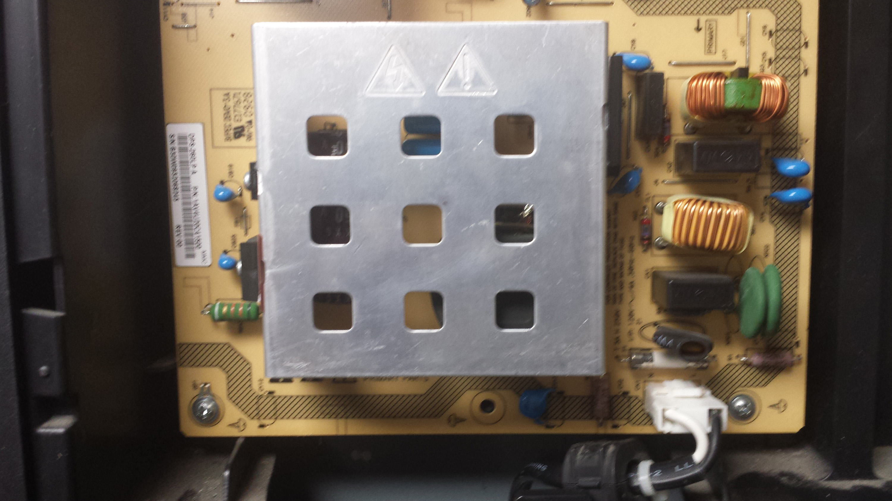

    Hi again,
    Regarding: Sanyo DP42849 LCD TV

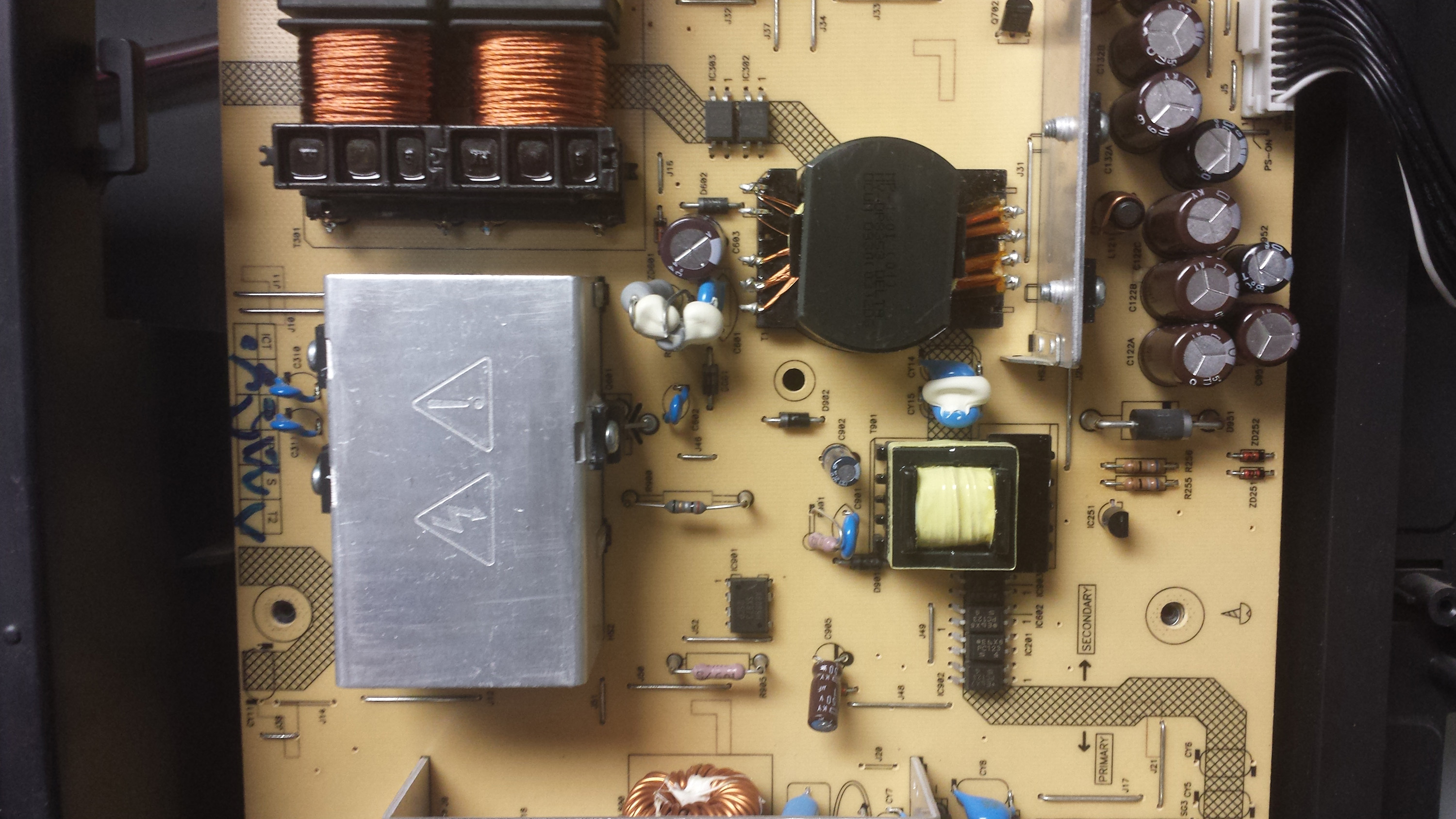

    After fighting with that DPS-260LP Power supply I had started a thread regarding for a couple of days, I opted to order a replacement power supply board as I was not making any headway on getting even the 5v standby voltage.
    To make a long story short, I ordered a supposedly good power supply board, and after installing it the TV turned on and functioned correctly with one exception: The backlight would not turn on. (Killing the room lights and shining a flashlight at the lcd screen allowed me to verify that the movie was indeed being displayed on the lcd)
    I returned the board and ordered a replacement from a different vendor. It arrived today and after installing, I still have no backlight.

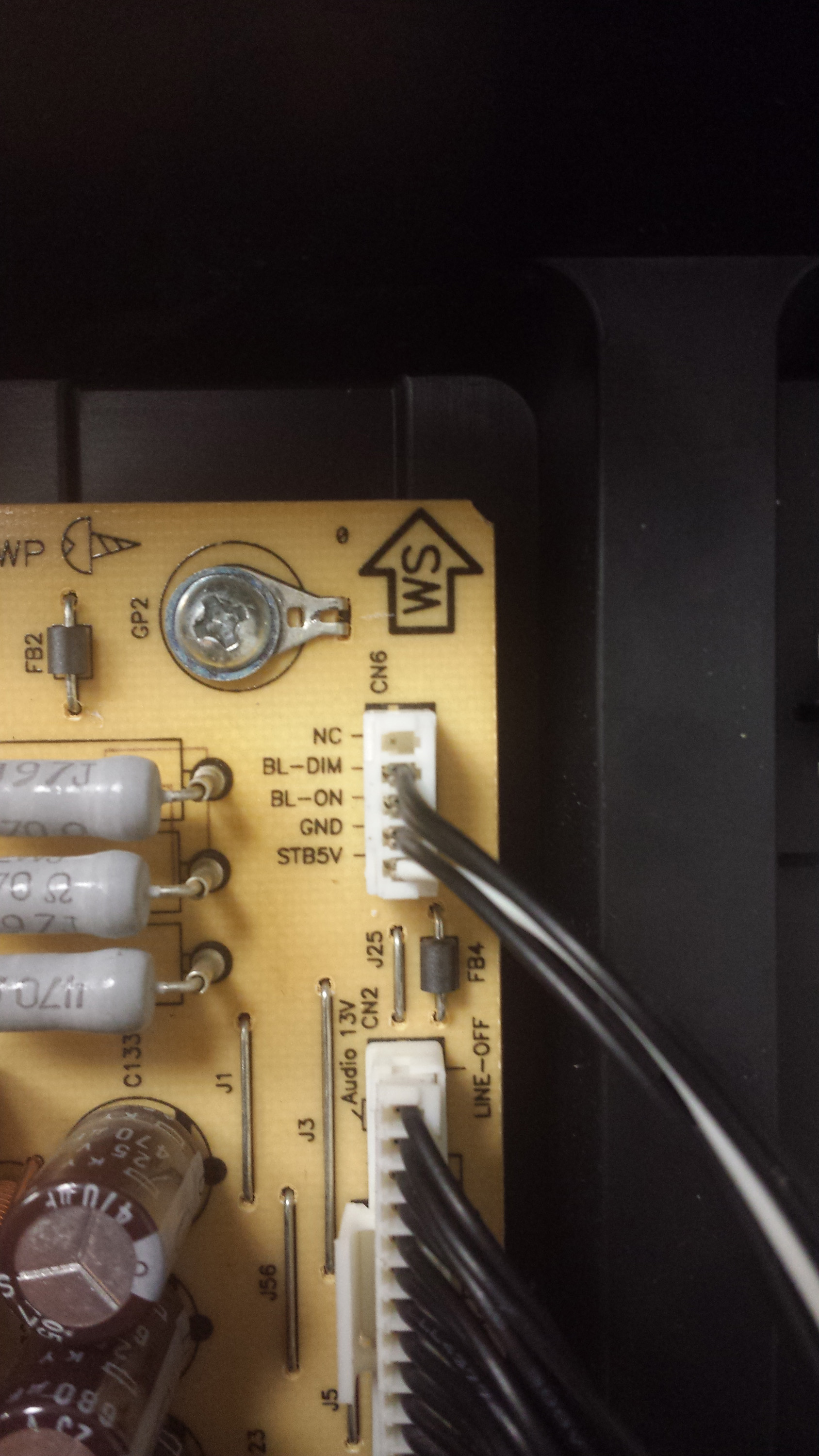

    I have checked my voltages at the 4 pin connector on going from the main board to the power supply (see pics attached)
    STB 5v: 5v
    BL_ON: 2.46v
    BL_DIM: 3.3v
    I'm going to tear it down to where I can inspect the bulbs. I read in another thread here that some tvs have ballast capacitors near the bulbs.
    Any other things I can look for?

    I am not sure which version you have but for this TV are few backlight inverter boards, including a Master/Slave inverters. Maybe worth checking the caps and fuses on there. Your main board is sending BLon, so make sure to also check the power going to the inverter.

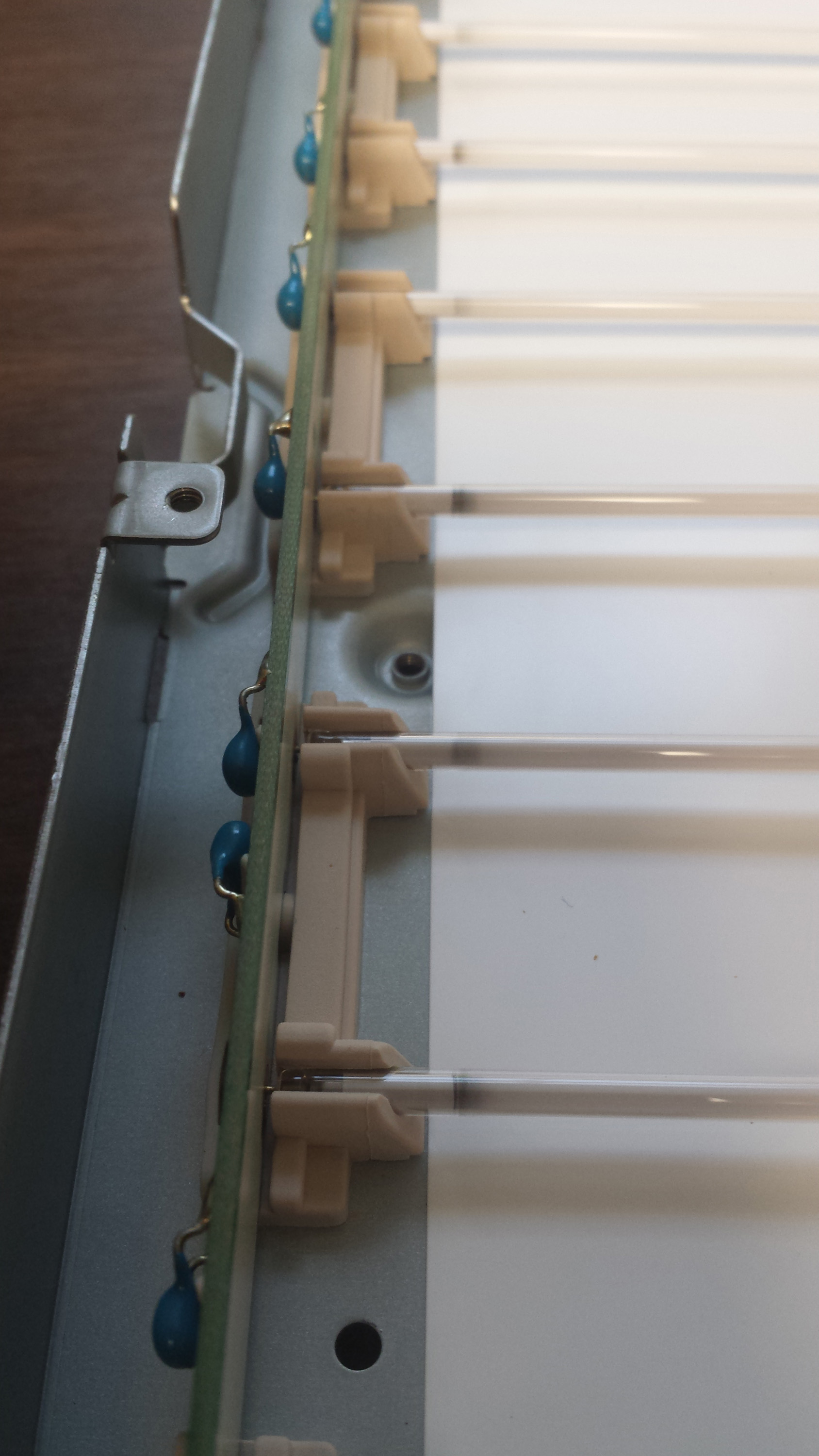

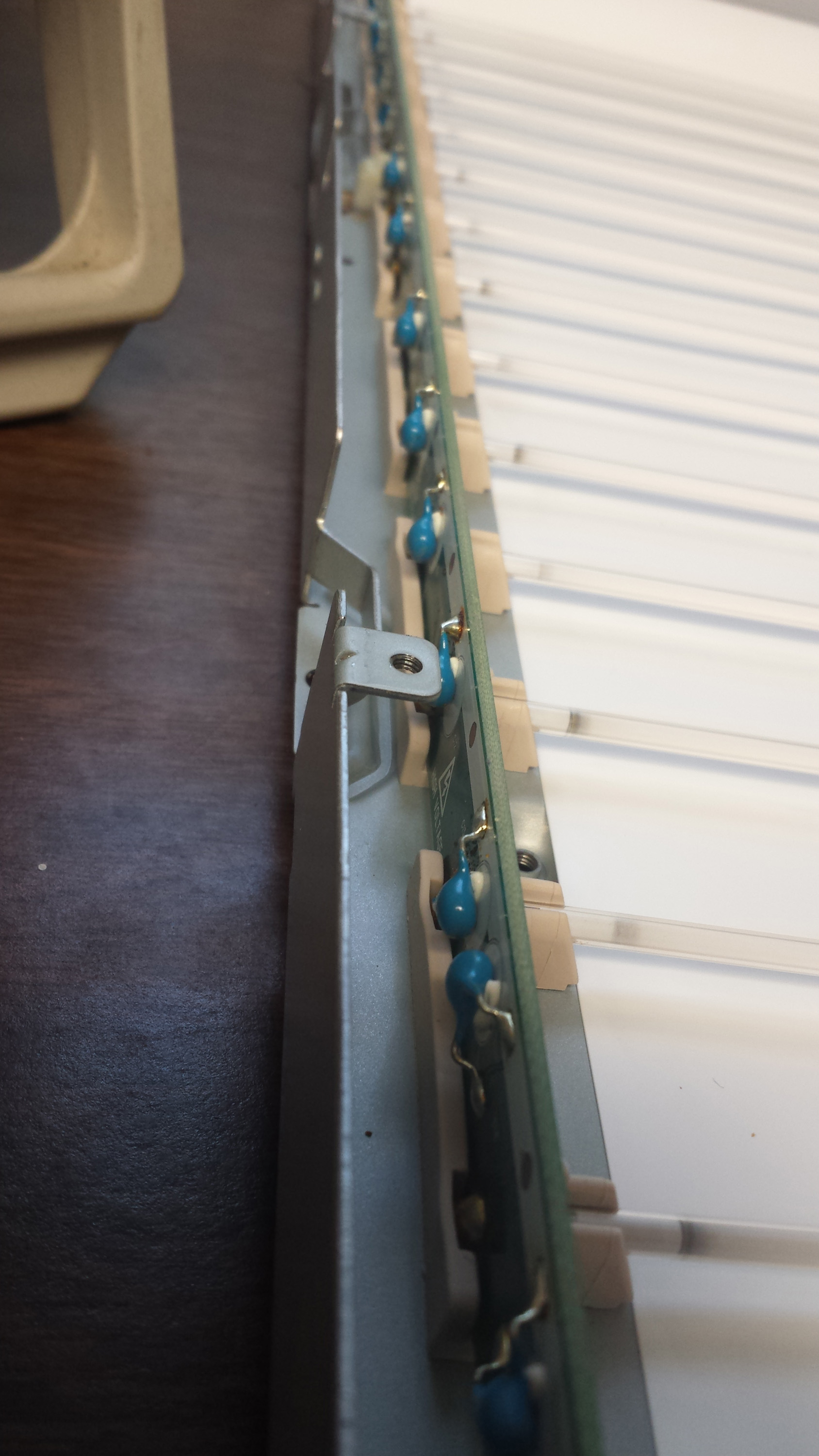

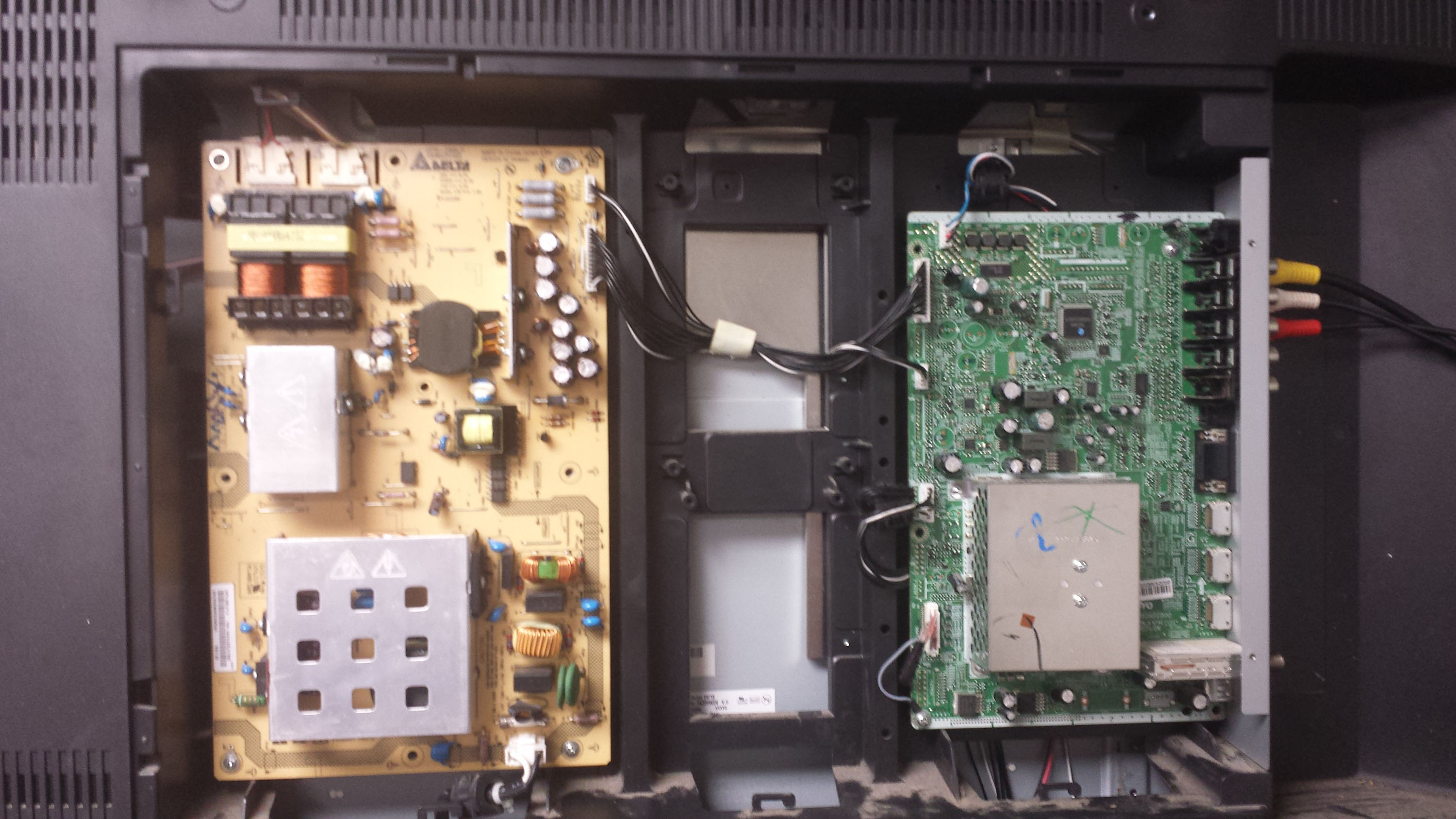

      Best I can tell though, the lamps are driven straight from the main board. I've disassembled the lcd panel to check for bad ballast caps. I have attached pictures of the panel to this post.
      I don't see any obvious signs, but since my BK meter doesn't read capacitance below about 50nf, I don't have a good way to test them either. There are some darker areas near the ends of the ccfl tubes, but should I really expect that each bulb has gone out?
      As far as testing inverter output, should I be testing the primary and secondary sides of the transformer right before the connectors that go to the backlights? If so, what voltages should I be looking for there?
      I don't discount that it could be a problem with the inverter section of the board, but thought it was unlikely that two boards could have the same problem.
        Re: Sanyo DP42849 - Backlight Not Turning On

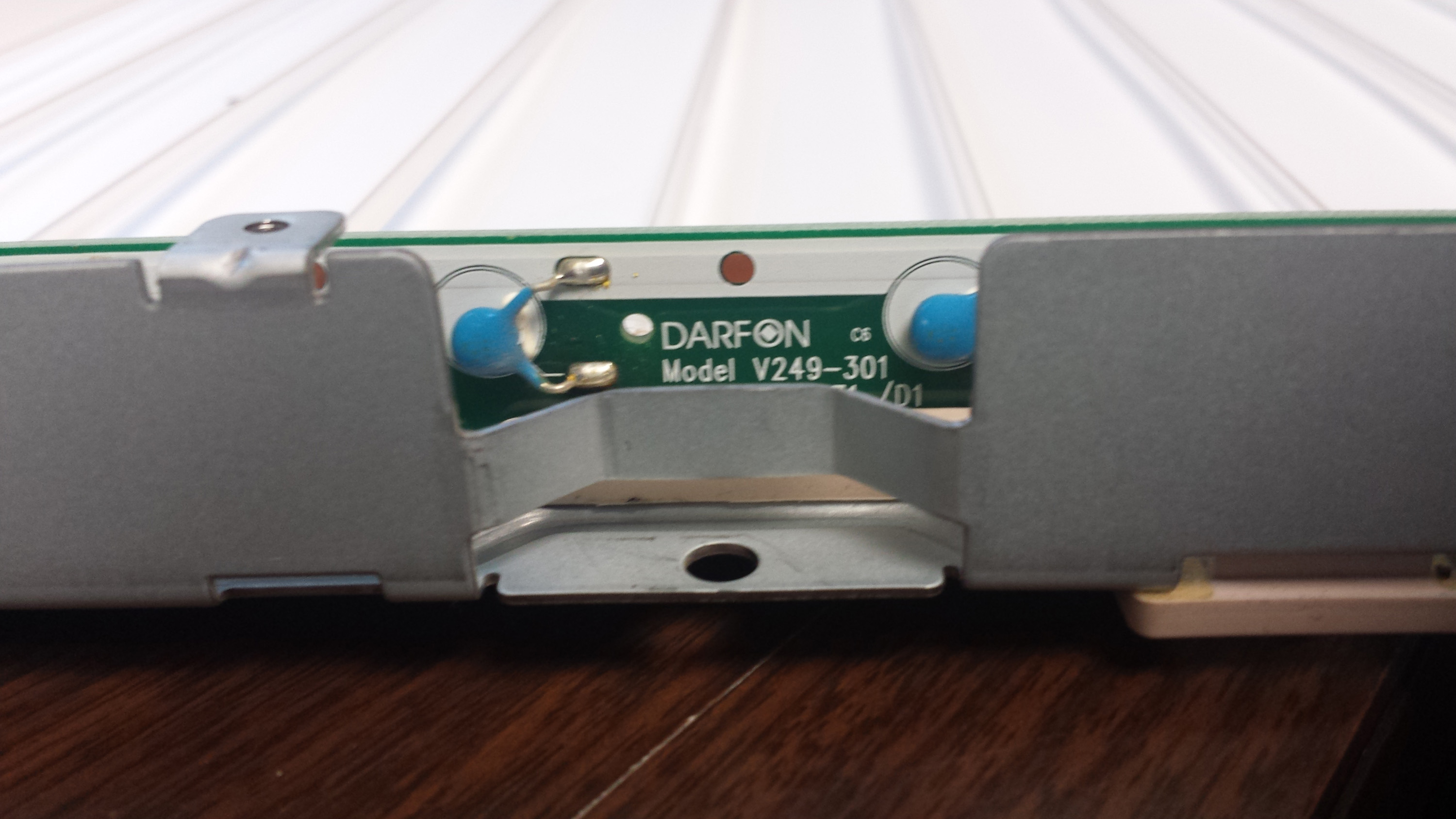

        You look for resistance leakage on those ballast caps, the cap should have infinite resistance.
        Bad one will usually has brown tint to it.
        http://s807.photobucket.com/user/bud...?sort=3&page=1
        Do not try to measure the High Voltage on the output side of the Inverter transformer unless you want to blow up your meter, the startup Voltage is about 2000V.
        Look and see if the all the lamps light up with the same intensity, see if the end of the lamp has blackened.

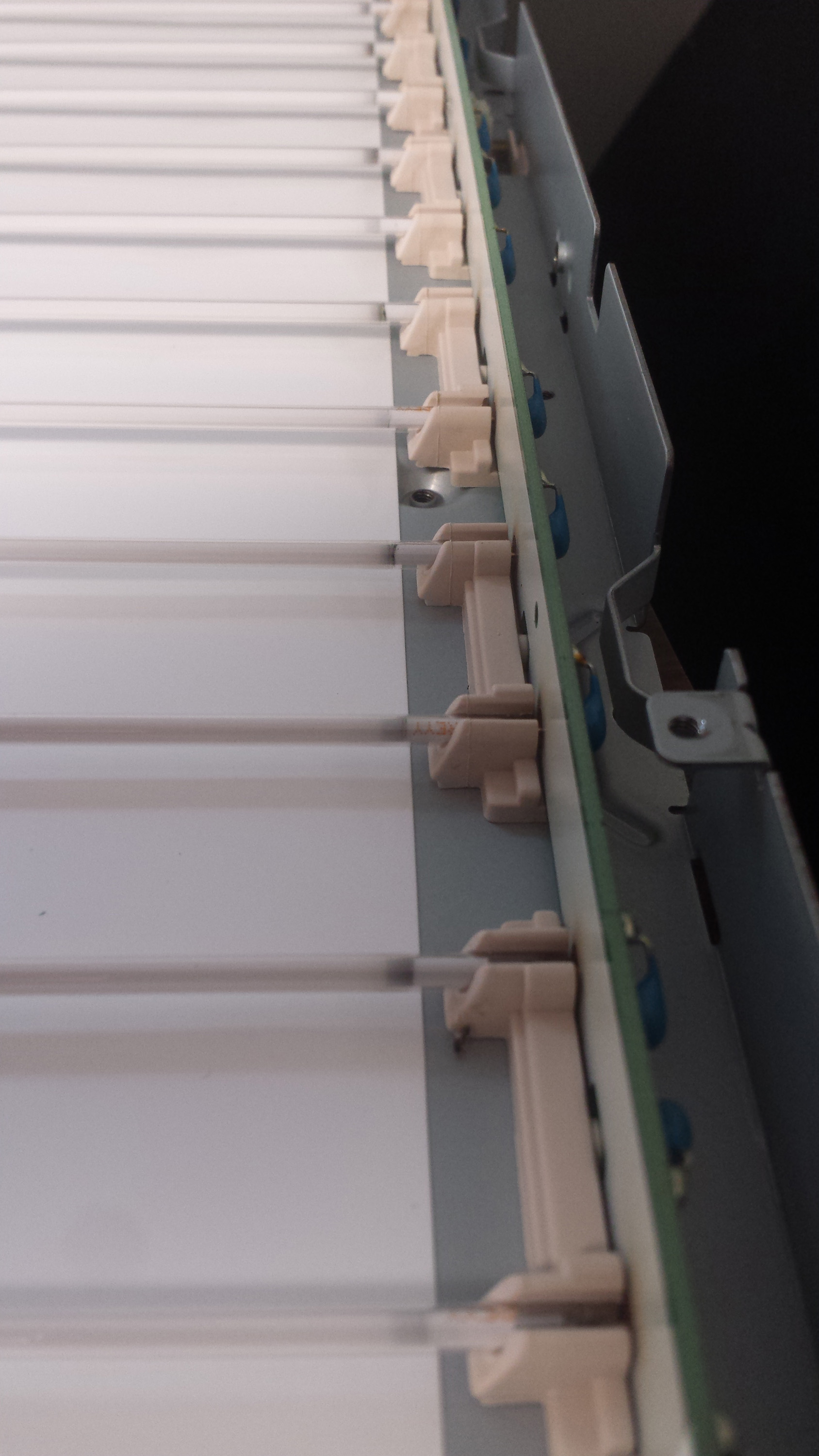

            All ballast caps are reading infinite when tested for resistance leak. At this point, would I be good to reassemble the LCD panel? If it is indeed the bulbs, it would probably make this TV not economical to repair anyway.
              you can leave the LCD glass panel out, no T-CON borrd connection needed so you can see how all the lamps light up, may be you can see which one does not light up properly.
              The lamps are also socketed so the lamps may have bad connection to the sockets.
              • wcsd106
                • Jan 2015
                • 57
                These lamps actually appear to be soldered onto the pc board. Best I can tell, they're not socketed.

                  So at this point, I should probably reassemble but leave the lcd glass panel out so that I can get a good look at the bulbs while turning the tv on?
                  • CapLeaker
                    Leaking Member
                    • Dec 2014
                    • 8188
                    yes

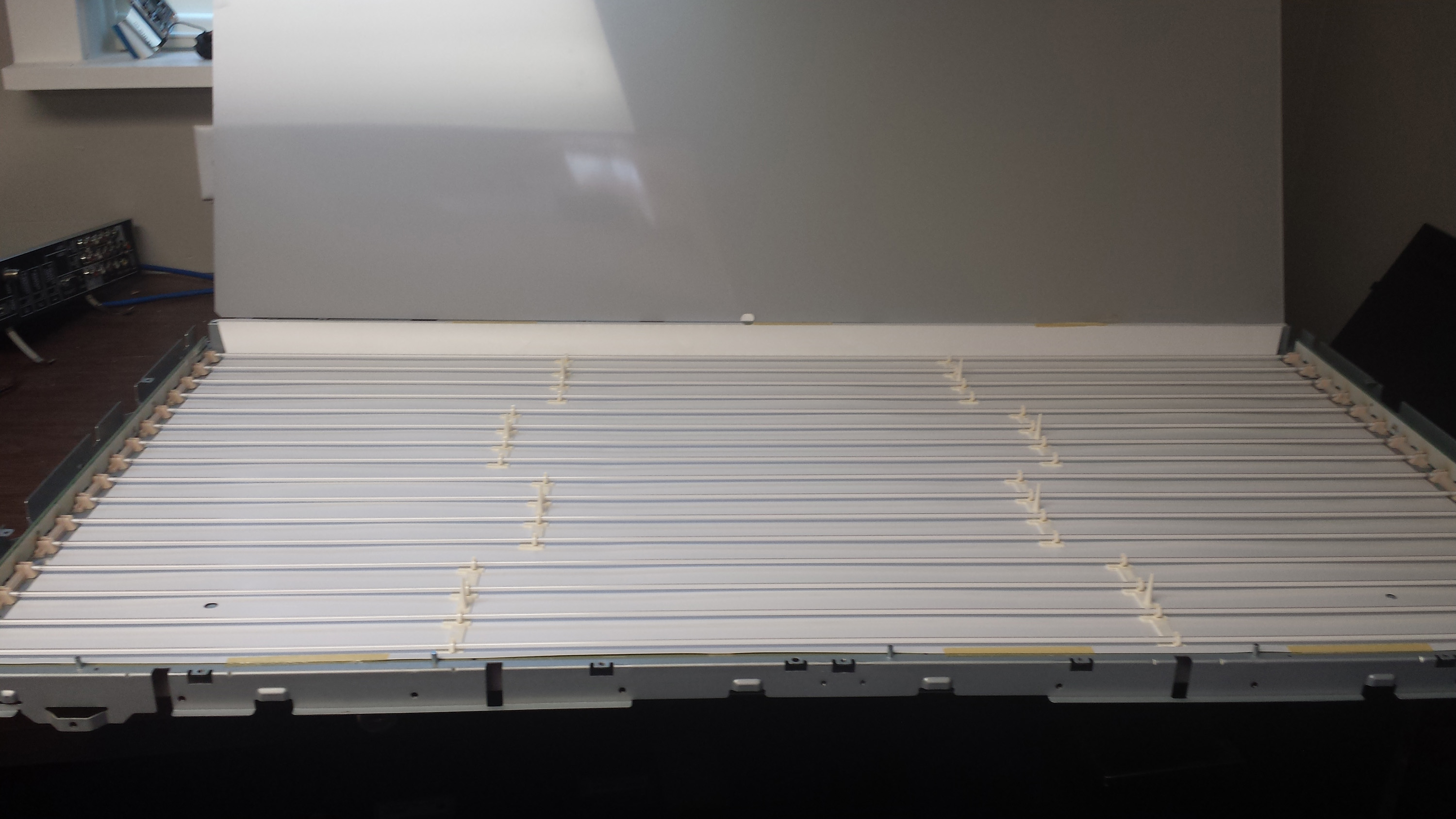

                        Update:
                        I assembled the panel and installed only the main board & power supply / inverter board. I left the TCON board disconnected and left the lcd panel and glass setting aside on the bench.
                        Approximately 5 seconds after hitting the power button on the TV, all of the CCFL tubes turn on and immediately turn back off. They all light, but they only stay on for a fraction of a second. It's more of a single flash. Then they go back out and do not come back on.
                        I'll be doing some searching, but would appreciate any advice on where to go from here.

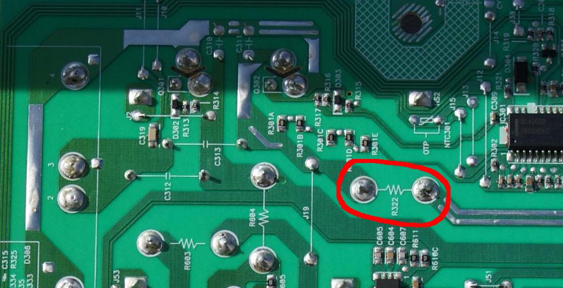

                          To save some time, I have tested: R322 (The Fusible resistor) with a reading of 0.33 Ohms.
                          I also tried connecting the BL_ON to the 5VSB at CN6 through a 1k resistor. Still only get a flash of the backlight.

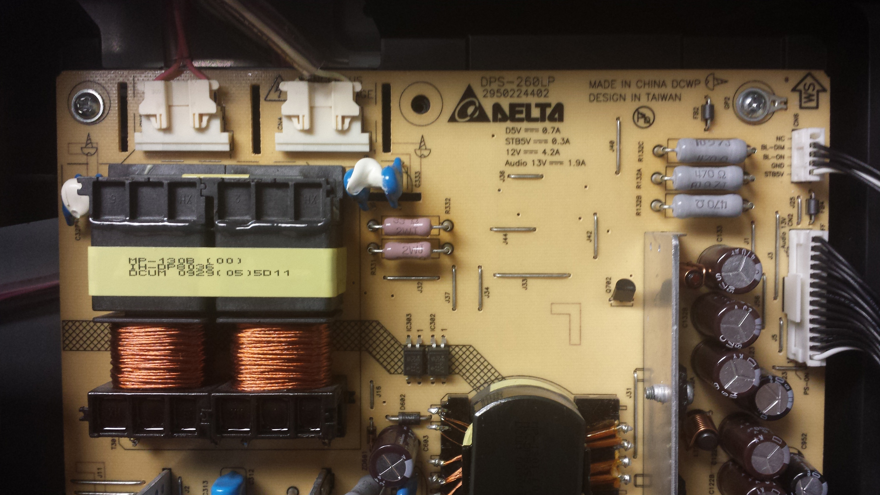

                            look at the caps and transformers on the inverter board. Compare one transformer to the other.
