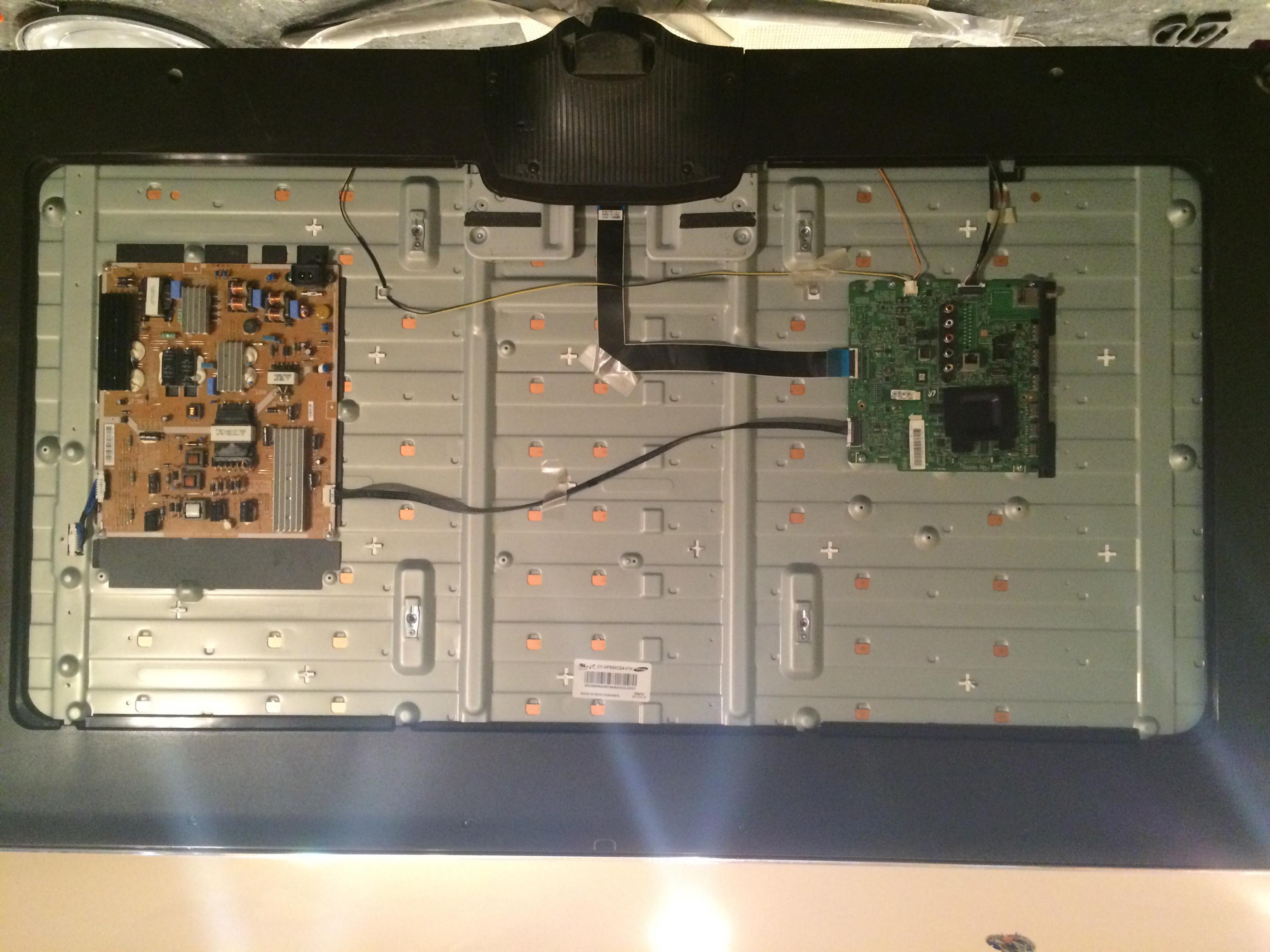

    I have a Samsung 65" LED smart TV, it never resets, or just powers off. Some days it just won't come on. There is a little red light on the bottom of the TV, if it's on ... The TV will power up like normal, if it's not the light does nothing or it blinks when I push the power button. Sometimes after I've tried to turn it on.... It will pop up 5 mins later. But once the TV is warm it seems to power on/off easy

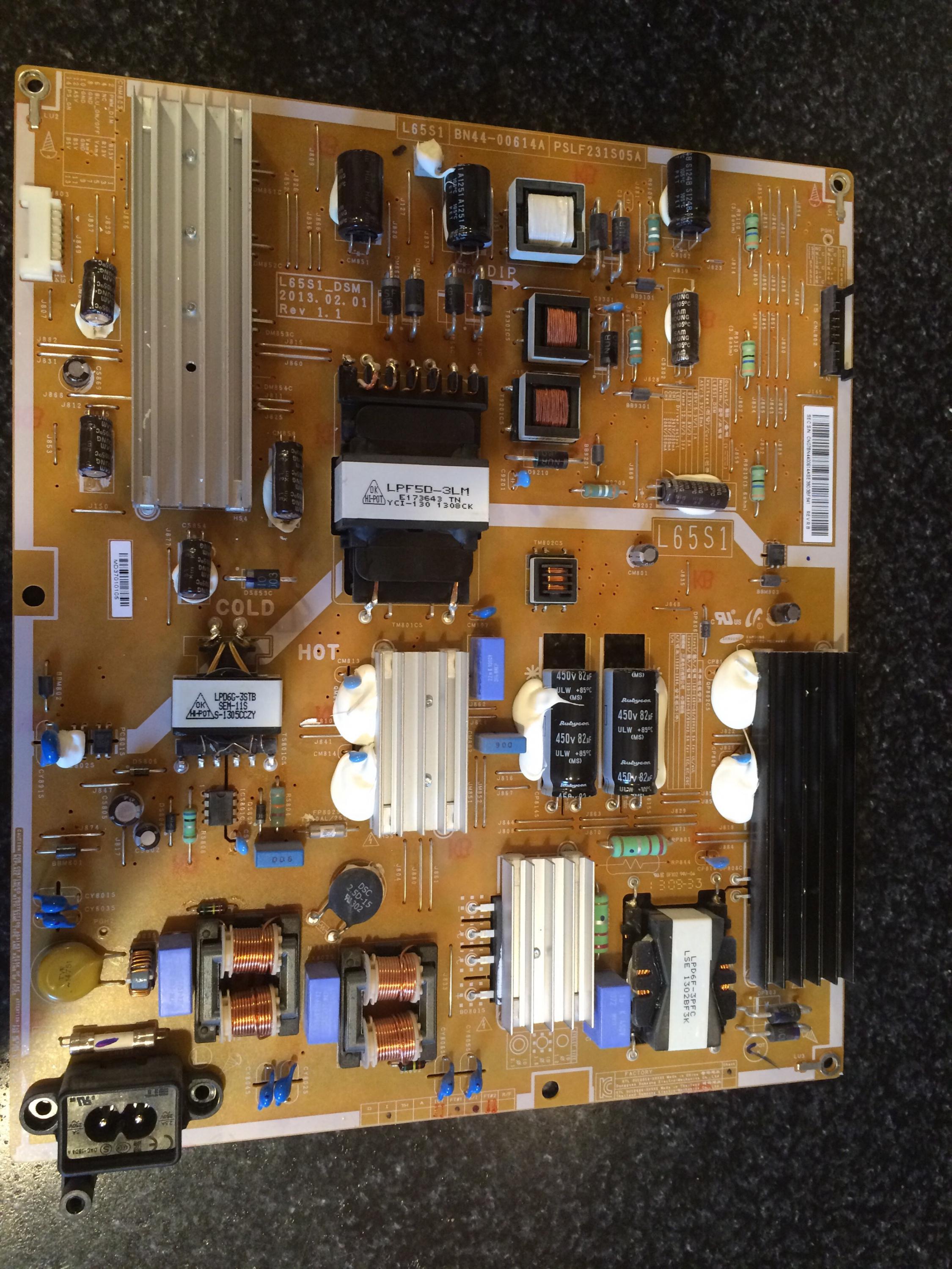

    I've taken the power board out (BN44-00614a) my version has the tall capacitors laying on their side, all the caps look normal and Samsung has went with 25v 390uf (x3) and 25v 590uf (X1) over all the older ones that seemed to have the 10v caps. I ordered those new caps but then took those 4 out and tested them, they were still good so I put them back in the board.
    I've read were a few other people have had this same issue

    The caps I pulled out and checked with a meter then put them back in are in the lower right corner of this board around the longest heat sink that's aluminum in color .

      I am not convinced that it is the PSU doing this. Load up some hi res pictures from the main board like described here: https://www.badcaps.net/forum/showthread.php?t=39740
      First what you can do is to measure the PSon voltage on the PSU when you turn on the TV. See what happens to it when the TV doesn't want to turn on.

        My TV has no buttons and only 2 boards in it. I think the other ones has all the brains on it. I tried to attach the photo of the power board to this post in a thumbnail

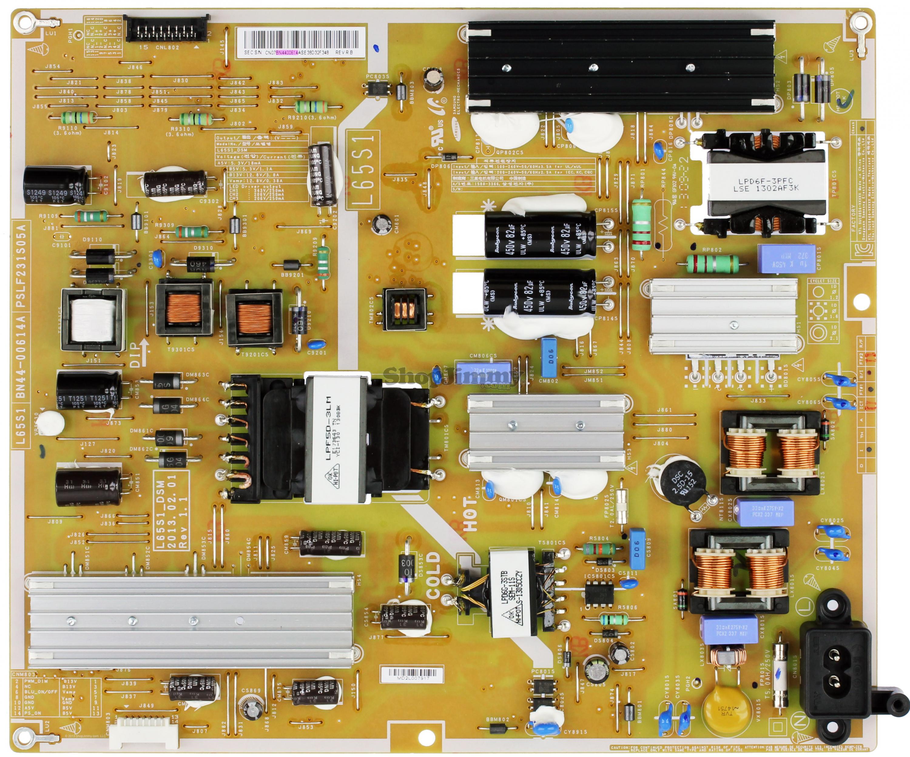

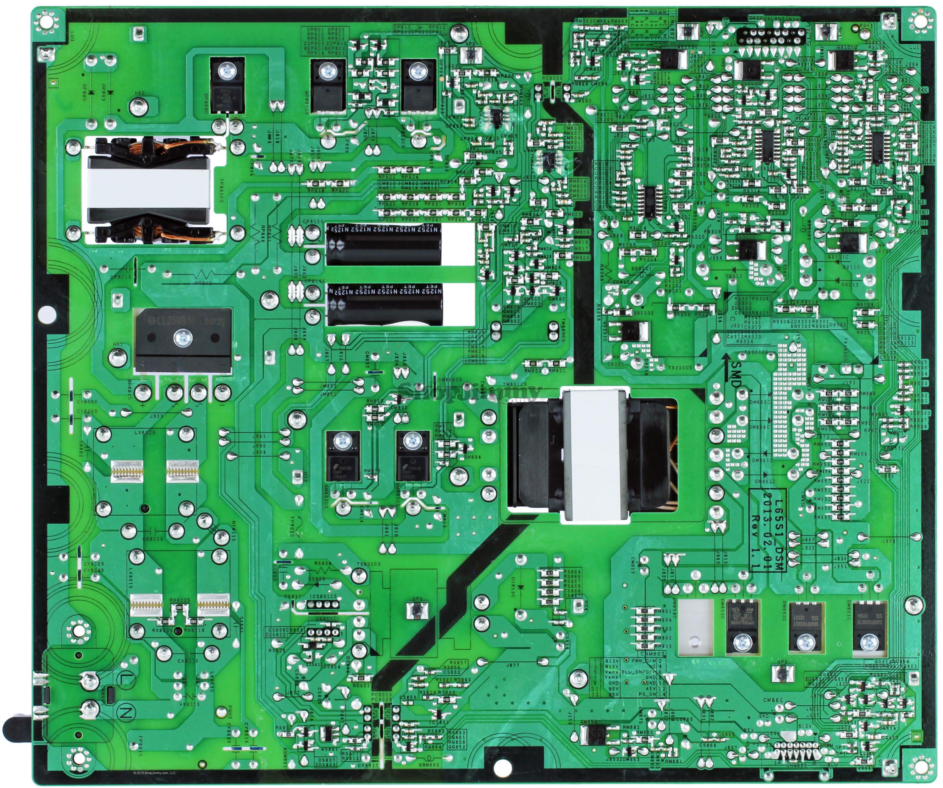

          http://www.shopjimmy.com/catalogsear...sung+UN65F6300
          It has also T-CON board and the jog/IR board.
          The question is what are the DCV readings and the Voltages of the signals are at the connector of the power supply board that goes to the main board, if the backlights will come on if the that cable between the main board and the power supply board is disconnected.

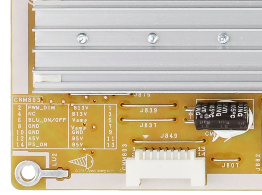

            Where do I test the voltages?
              Re: Samsung UN65F6300 won't power on (sometimes)
              If you look at the board, there are charts to tell you what the pins of the the connectors are.
              So what happen if you do not have the cable between the power supply and the main board disconnected? Do you get the backlights when the TV is plugged into the AC outlet?
              Pictures provided by SHOPJIMMY.

                  On the ribbon going to the video card ... Using the 3rd one down as ground... Top 2 i get ~13VDC and the bottom 2 I get ~5VDC with the TV on, I don't get anything with the TV off
                  On the hot side of the board there is a transformer that says 94v-0�� With the TV on the meter is just going all over the place

                    The connector CNM803 of the power supply board that goes to the main board is the one we are looking for the control signal form the main board.
                    It is pin 12 A5V (STBY Voltage which should be present at ALL times as long as the TV is plugged into an AC outlet) and pin 14 which you cannot access from the top side of the board either, the connector is arranged as odd and even row, you can see odd pin 1 ~13 form the top of the board but the even pins 2~14 you will need to get small probe to get to pin 12 and 14 to see if it is present when it will not power on.
                    PS-ON when <1VDC = OFF, >2VDC = ON.
                    "On the hot side of the board there is a transformer that says 94v-0��" that is not the Voltage rating, it is the UL Flammability rating of the PCB.
                    Do not make any measurement in the primary deadly side unless you know what you are doing.

                      12(+) and 14(-) ... I have 5vdc when the TV is off and 2vdc when it's on

                        You measure between pin 12 (A5V) and GND pin for the standby Voltage, and then Pin 14 (ps-on) and GND pin for the PS-ON signal. Do not measure between pin 12 AND pin 14, that is not the correct measurement.

                          I have 0.25vdc between 14-Gnd when off and 5v 12-grn when on.

                              Pin 12 (A5V) should be there ALL the time, it should never go off period unless you unplug the TV.
                              PIN 14 is the PS-ON COMMAND PIN that is generated by the main board when power switch is activated, when it is <1V = TV OFF, >2VDC = TV ON, as long as this is > 2VDC the TV should stay on. If you notice that the TV is turning on and off then you should see this pin 14 Voltage going up and down in sync with TV cycling ON and OFF.

                                Pin 14 I'm getting .25v off and 3.32v consistatly when on (with no HDMI cable attached)

                                    The backlights is turn on the signal from the main board called BLU_ON/OFF (BL-ON), <1VDC = Backlights OFF, >2VDC = Backlights ON (Notes: depend on the design, it may need DIM + Bl-on control signals for the backlights to be ON.

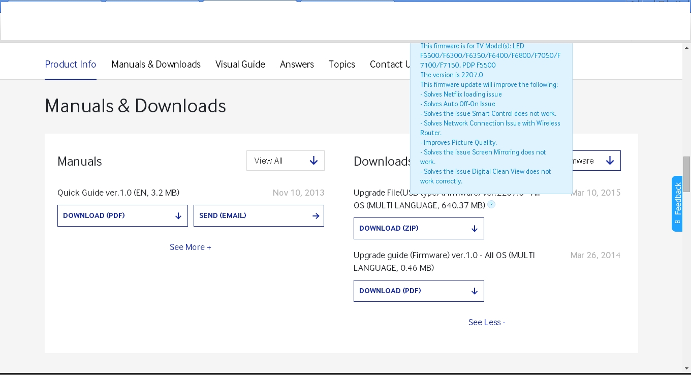

                                      I wonder if the new firmware will fix the problem:
                                      http://www.samsung.com/us/support/ow...UN65F6300AFXZA

                                        The STB input on the smart TV is supposed to become interactive with all the "set top boxes" , even supposed to pop up in the smart hub and transfer the guide onto the TV's guide and use the TV remote and not us the IR for the box at all. Maybe a little too smart or confused having an android box on there
                                        I don't know which one is my firmware and which one is my software... But it's showing 2210 and "T-MST12AKUC-2210.1" as the version
