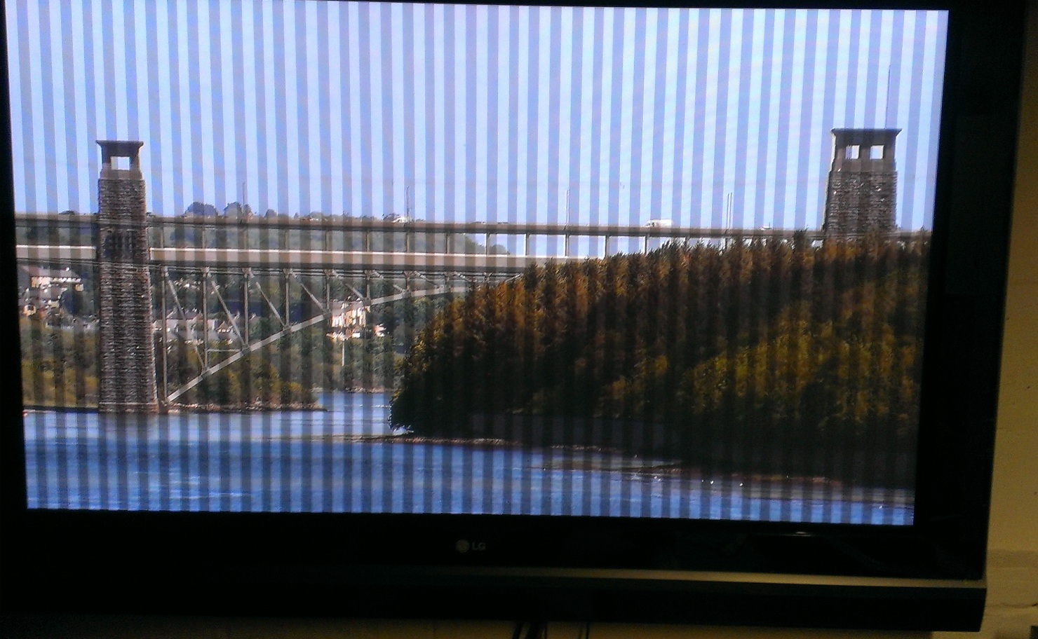

    Hi Everyone.
    I'm new to the forum and I'm hoping someone can shed some light on my old LG's issues..
    Around a month or so ago, the set lost sound entirely, we were watching TV and there was a load "pop" from the speakers, then nothing.. Not too much of an problem as we use a freeview box and now route audio from that to an amp, but I thought I should mention it in case it has any bearing on the real problem...

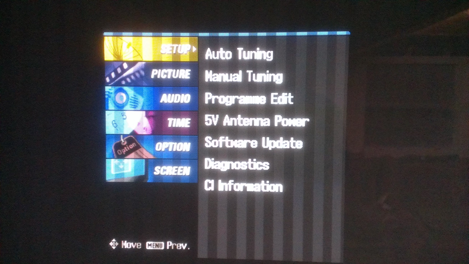

    A few nights ago whilst watching the TV suddenly started showing, for want of a better term.. "strobing" vertical lines about 1" wide over the entire screen. Initially they were Red, Blue and Green, but the last 5 or 6 times I have switched the set on the bars are a transparent grey/blackish. The bars do not move and the picture in between them looks fine.
    I am loathe to throw it away unless really necessary, it had a really nice picture. I doubt I could actually "throw" it anywhere anyway on account of it weighing a ton!
    Any ideas or help greatly appreciated..
    Thanks,
    Radial

    Sounds like a mainboard fault. Try a factory rest.

        Ok mate if not probably mainboard think its common on these seen a thread before if. I remember.

          I tried the factory reset, but no luck..
          I found somewhere with mainboards for sale and also a company who are selling a "mainboard repair kit" which seems to consist of 6 caps?
          Interestingly, when I tried it with no source, it had a jet black screen with a few random colour vertical lines, I hadn't seen that before. I think they were one pixel wide. When I switched the set off and on again they had gone and the usual grey/black transparent lines were back...
          Is there anyway to test the main board, or should I just take a punt on a repair kit or a board?
          I guess the next step is to whip the back off and have a look.
          Thanks again for the help.
