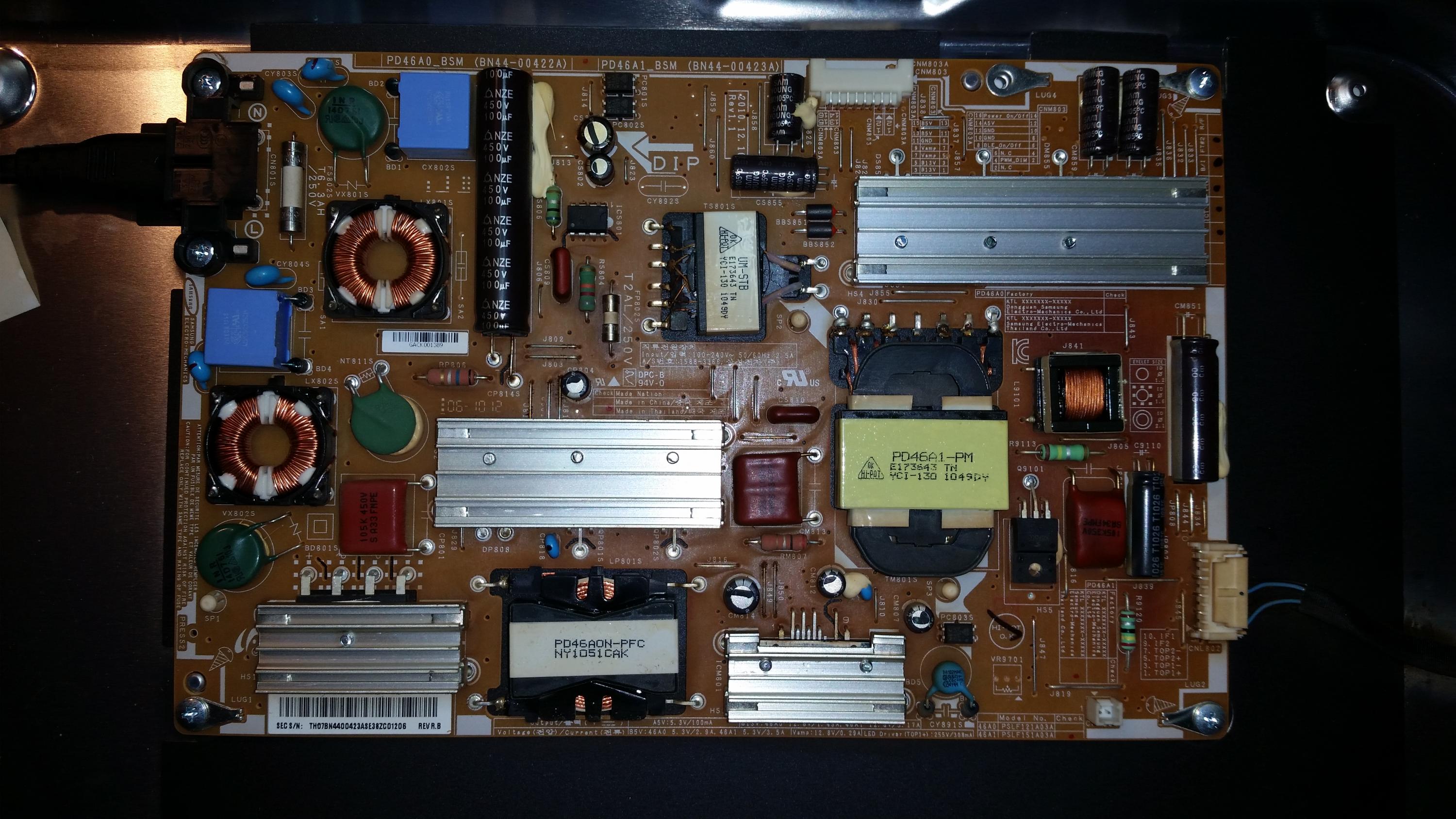

    What is the power supply board P/N? BN44-00423A?
    If you at the board, there will Voltage chart printed on the board to tell you what the LED drive Voltage will be with load.

      Re: samsung un46d6000 no picture
      "What is the power supply board P/N? BN44-00423A?"
      Yes, so I assume, the Power Board has a red dot next to:
      PD46A1_BSM (BN44-00423A)
      See Pic below:
      I'll have test results soon...

        -- Voltages at Power Board Connector: CNL802 to LED Lights
