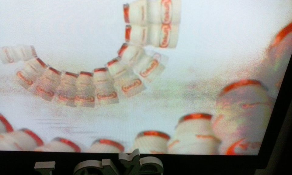

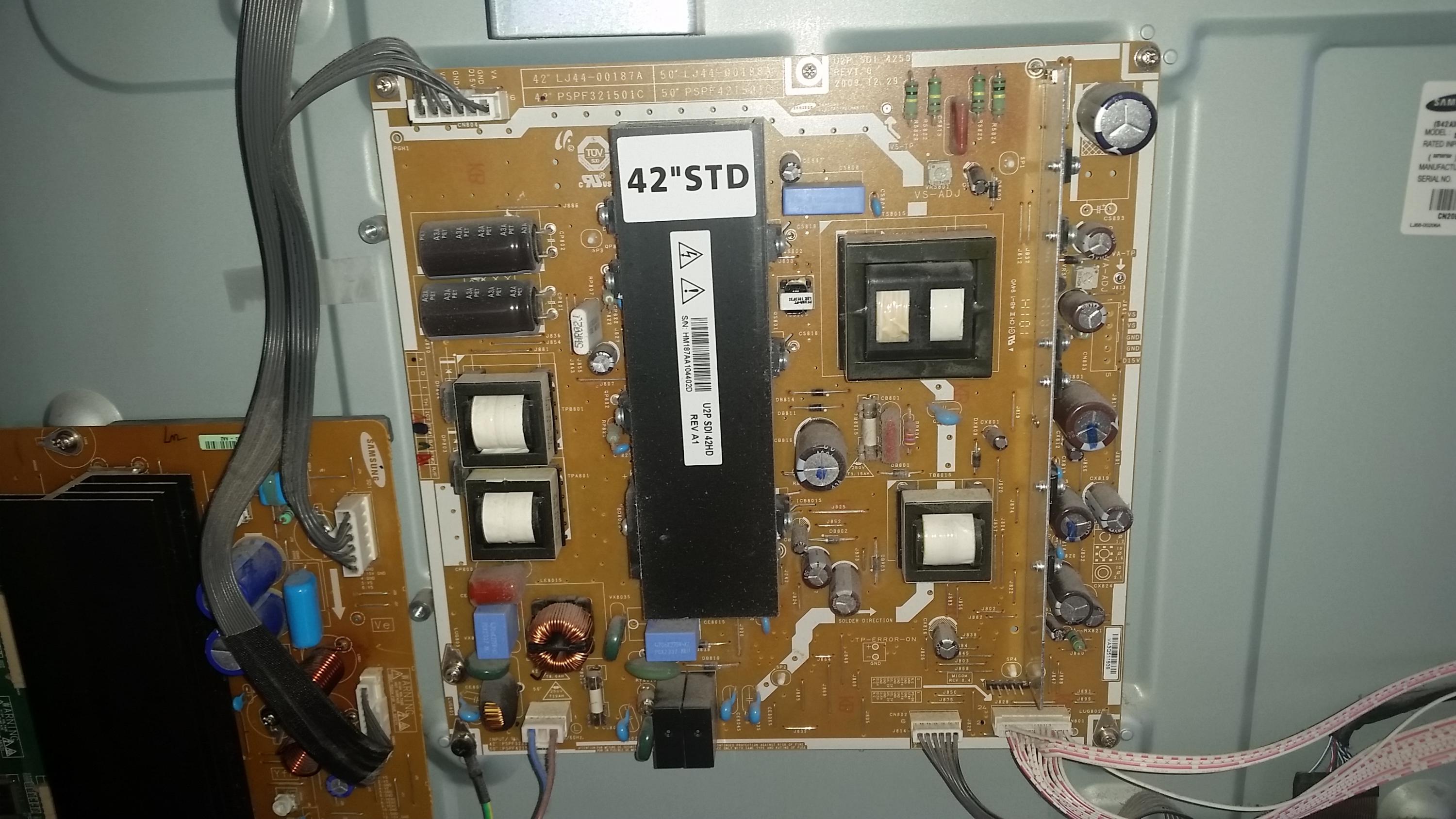

    hello guys
    got this issue at the moment where the right hand side of the screen is showing distorted colours i have uploaded picture of the fault as well
    VScan 196 Volts
    VS 204 Volts
    VE 100 Volts
    VA 54 Volts
    if anyone can help
    thankyou

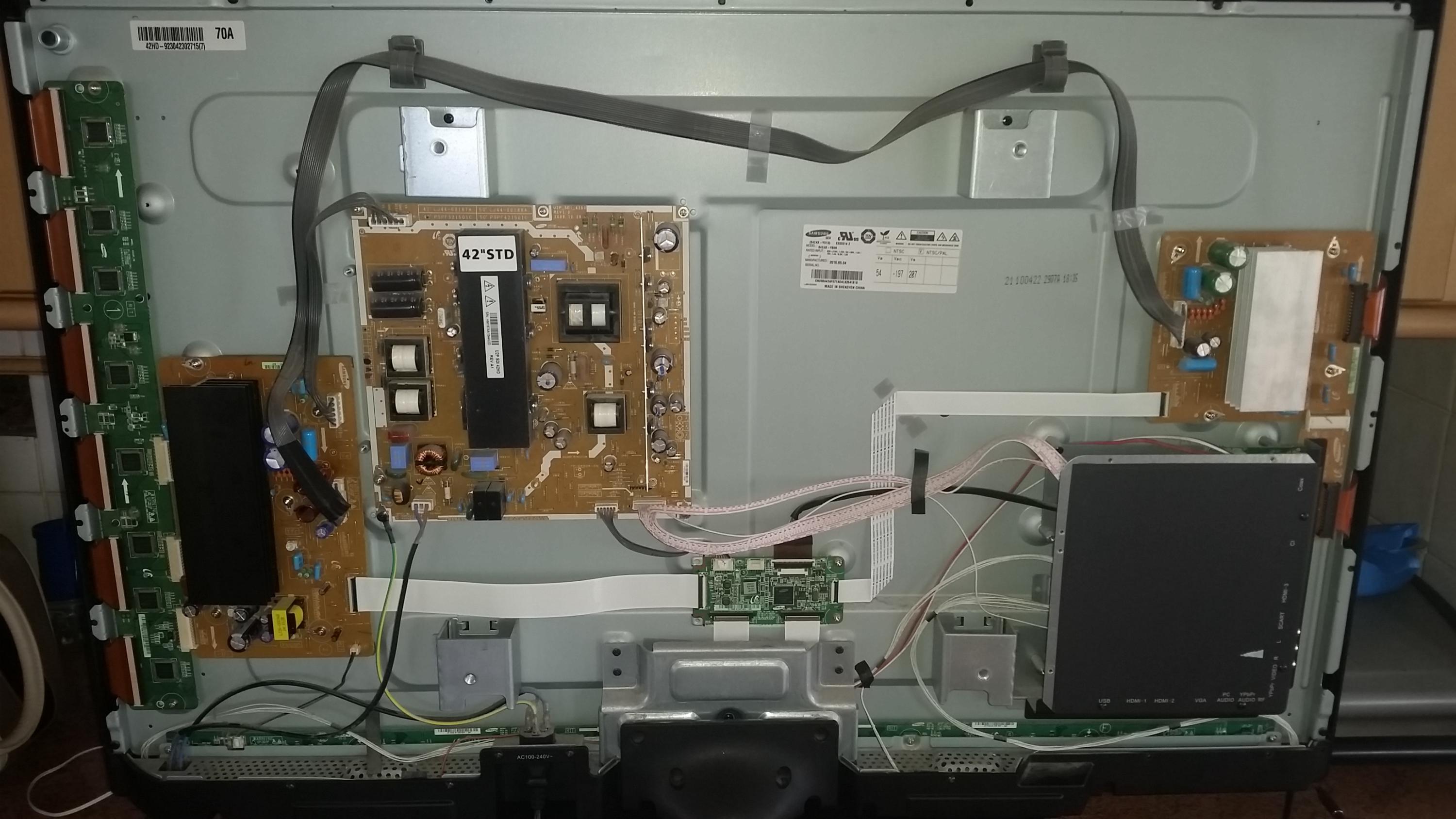

    Re: BUSH Bpdp42hd colour issue

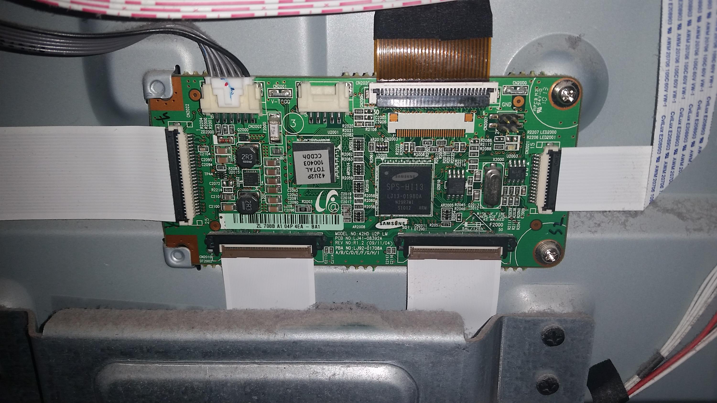

    It may be that little Timing Bd in the middle or the board at the bottom corresponding to the distorted picture.
    • sordids999
      • May 2013
      • 2149
      • uk
      Do you mean the control board ?
        Yes
          I will try a replacement control board i have tested voltages all seem ok and i cant find no shorts etc on the Ysus/Zsus
          so ill update this thread soon
          • sordids999
            • May 2013
            • 2149
            • uk
            Well tried a replacement control board still the same any ideas ??

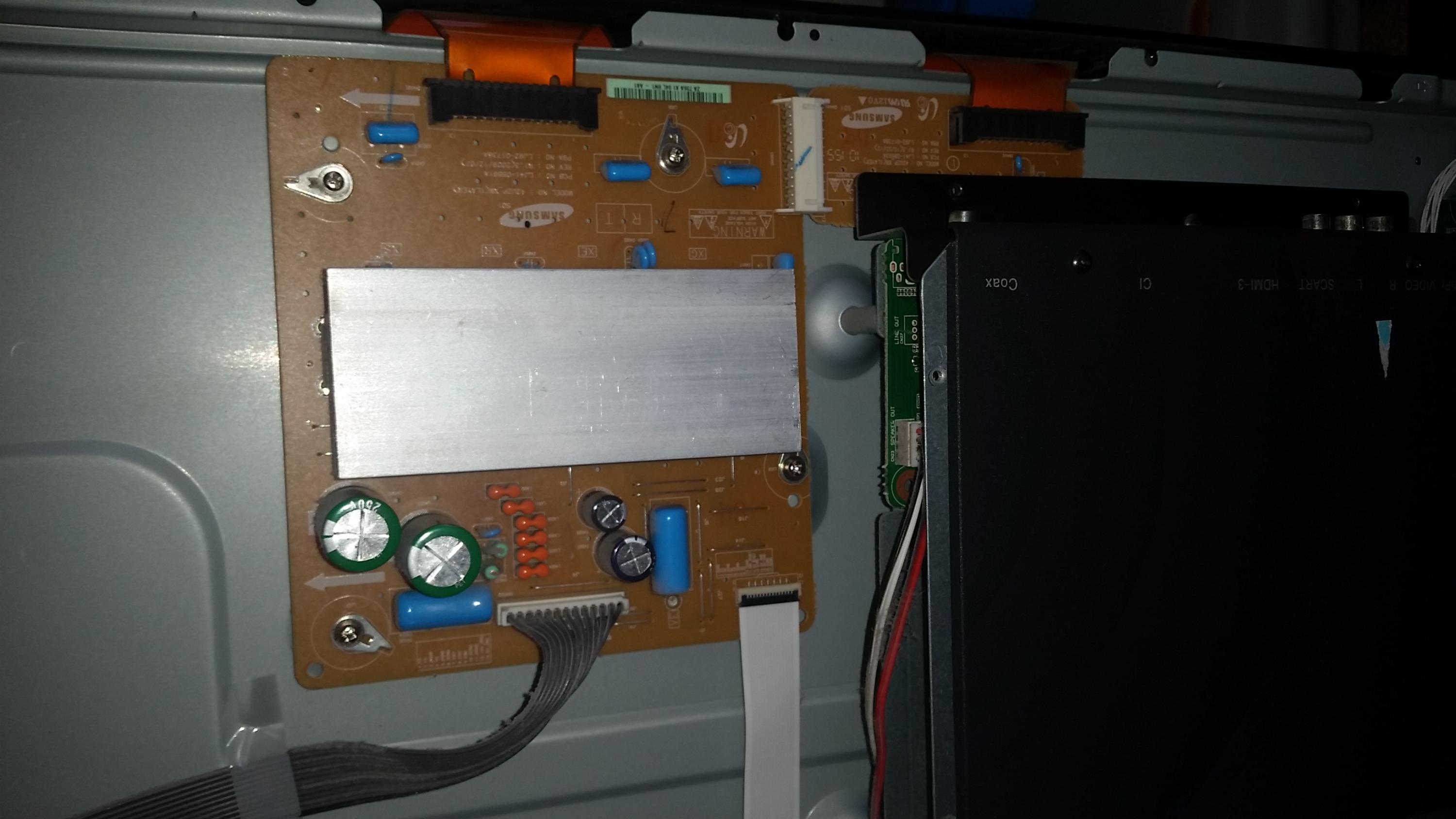

              Do your voltave readings match the sticker on the panel ? Looks to me like you have a problem on your z sustain board - I would start checking it for blown fets or burnt resistors.
                Thats the thing ive checked fets for shorts nothing and all voltages match up with the panel sticker

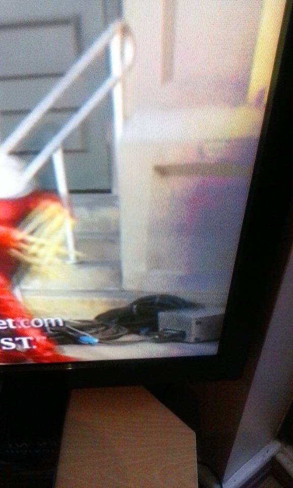

                  more pictures to the right of the screen i have a blotches of colour
                      That as well is indicative of a bad zsus or at least improper bias setting. If you adjust the bias pot does the voltage and or picture change too ?
                        Bad locallised Mal-Discharge, Its a pretty old/worn out (Samsung) panel I guess, seen a few exactly like it, in the 42C450, with 15+ K hours on 'em.
                        (For some odd reason--Its always the Right hand side of screen--Production error/tolerance I expect)
                        Sometimes careful potching with SET-Up and SET_Dn as well as upping the Vs by around 10V can help....
                        Only permanent cure is panel replacement--Which aint viable....
