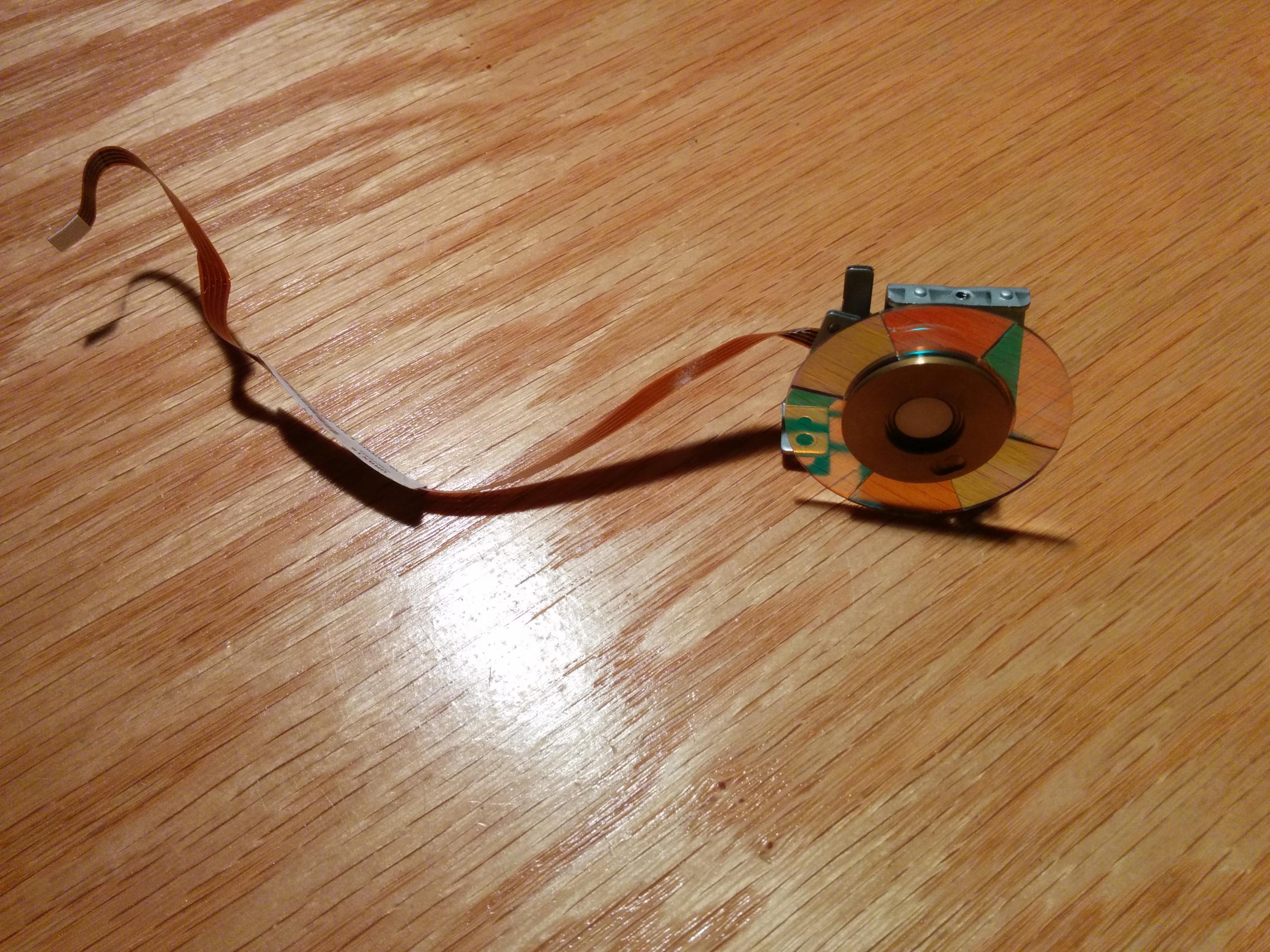

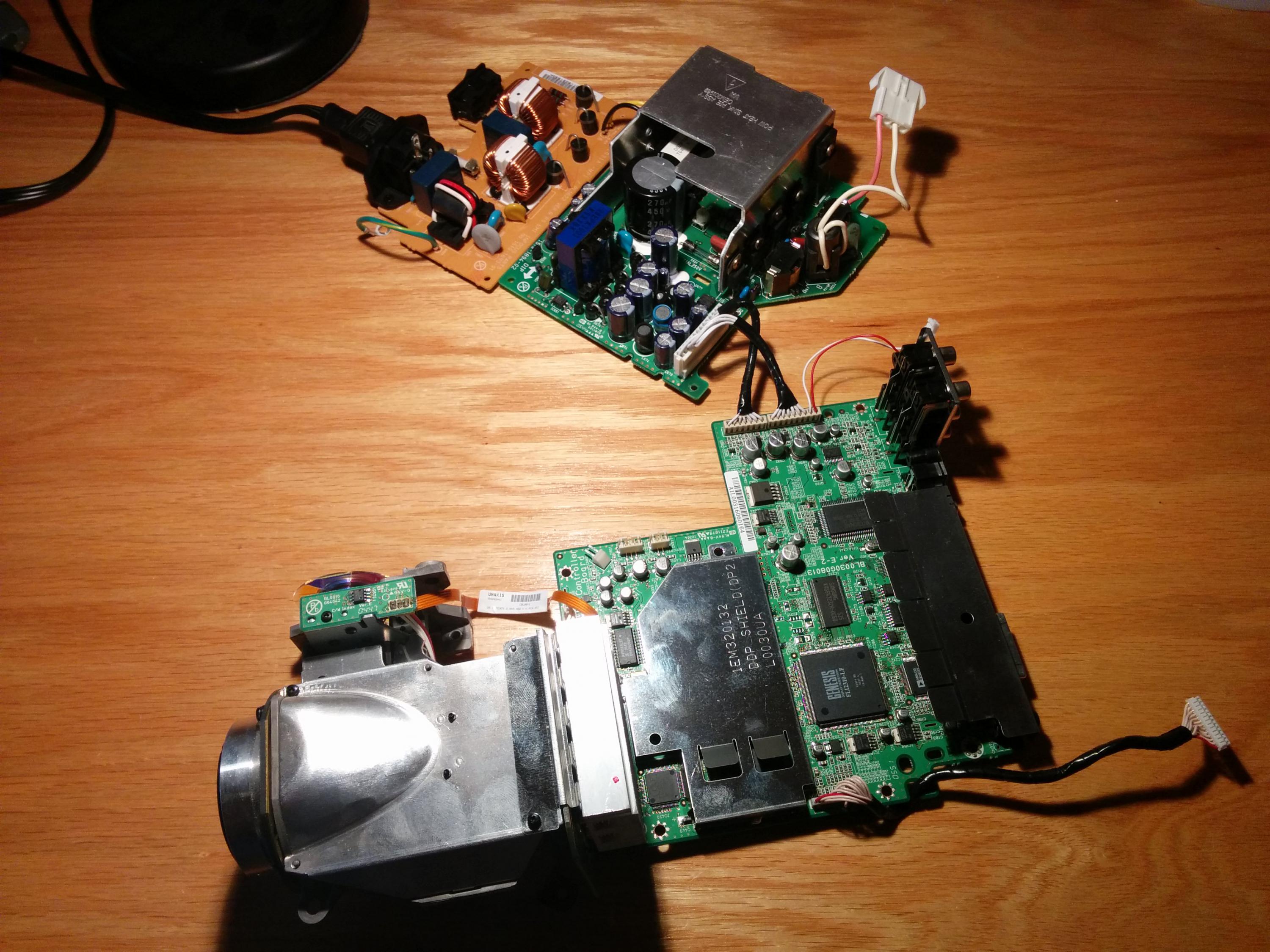

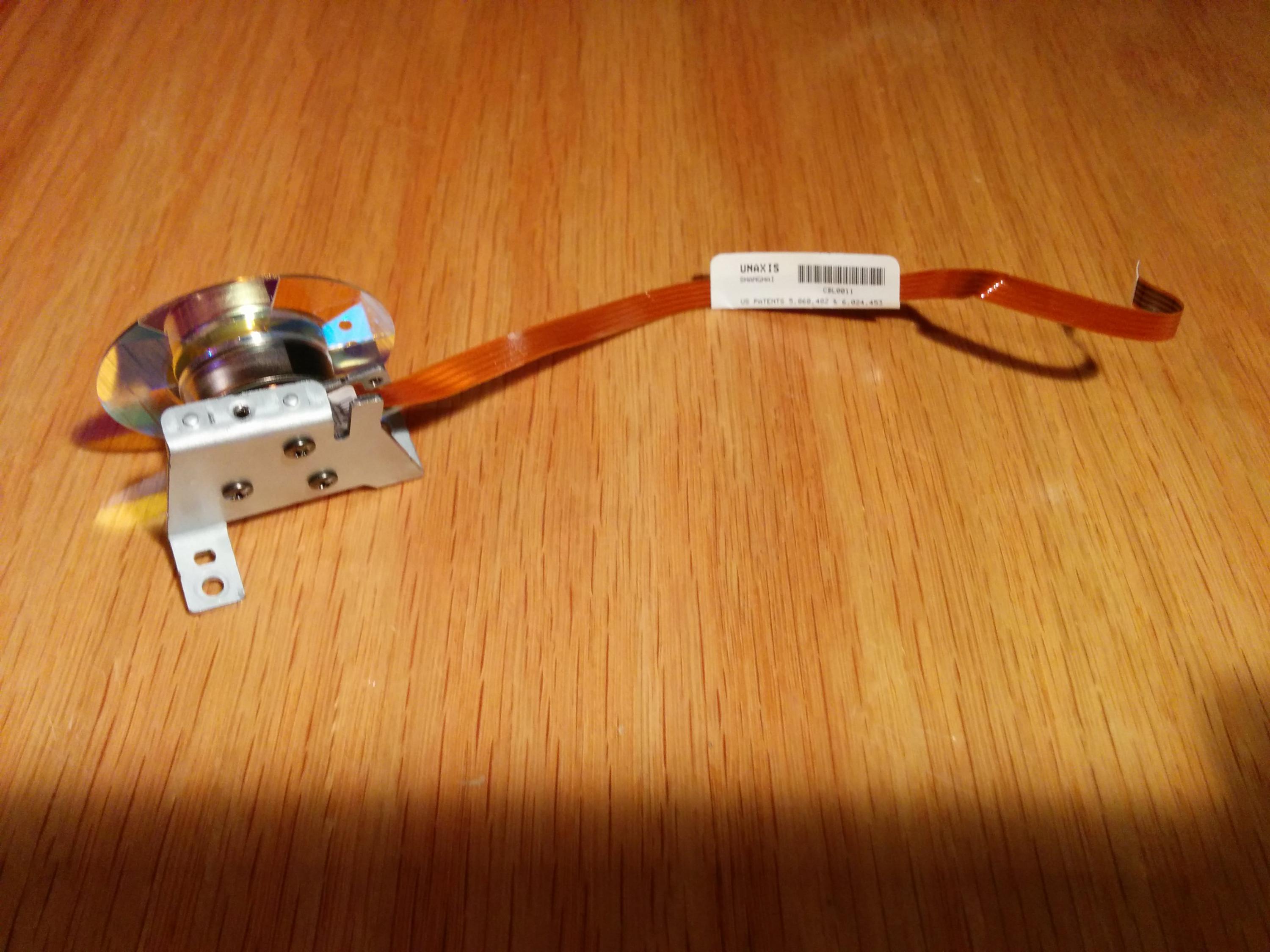

    I am pretty disappointed but figure it is probably fixable. I took it apart and did some more troubleshooting. It looked like the color wheel could be stuck since it was only twitching slightly. Apparently it has a speed sensor and will not light the lamp if the color wheel is not spinning at the right speed. I messed with it some more and noticed that after awhile it would twitch more and more and eventually spin up to full speed for a few seconds and then stop. It would do this in a repeatable fashion so I believe that the color wheel is ok and there is probably a power problem.

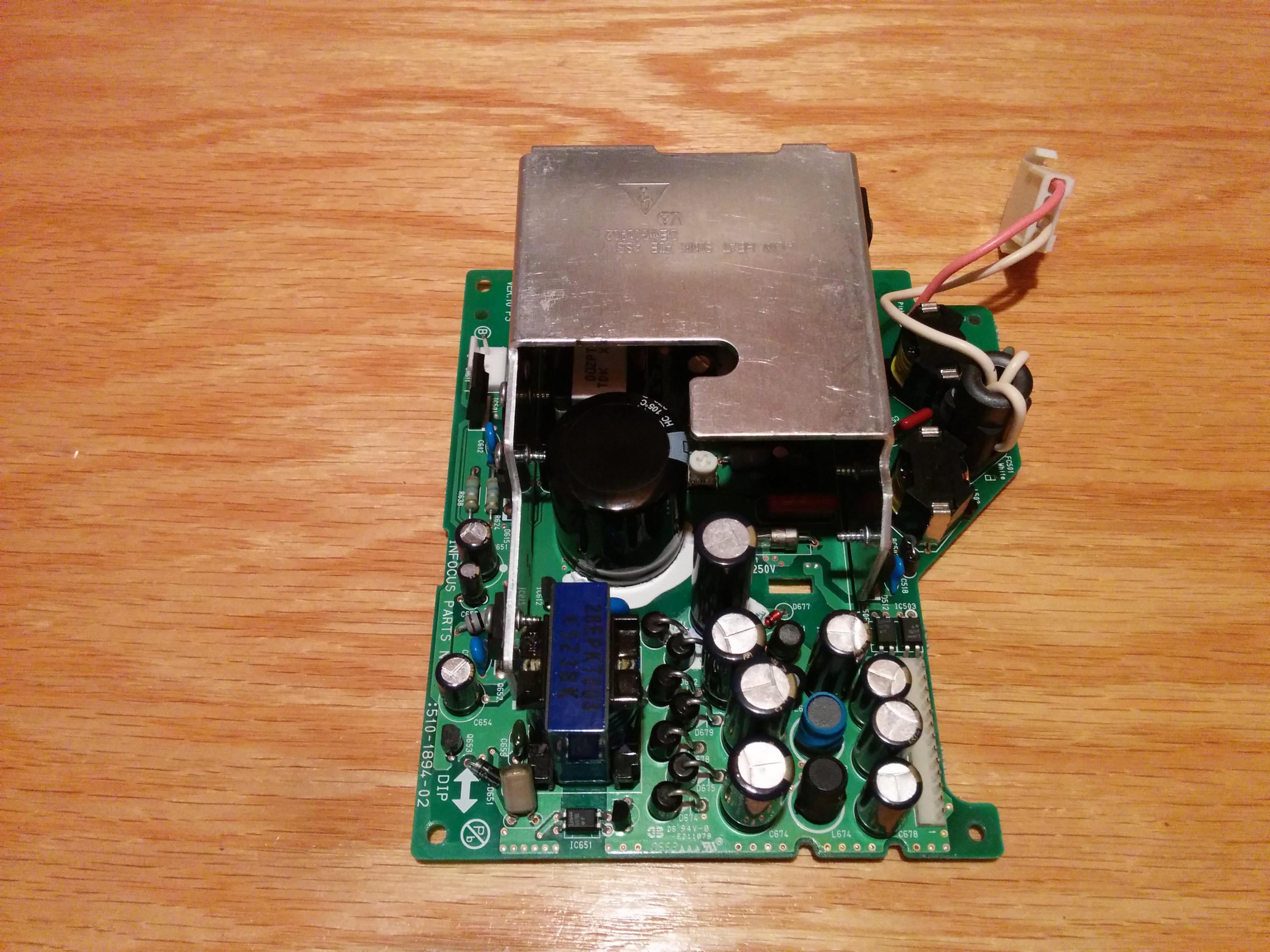

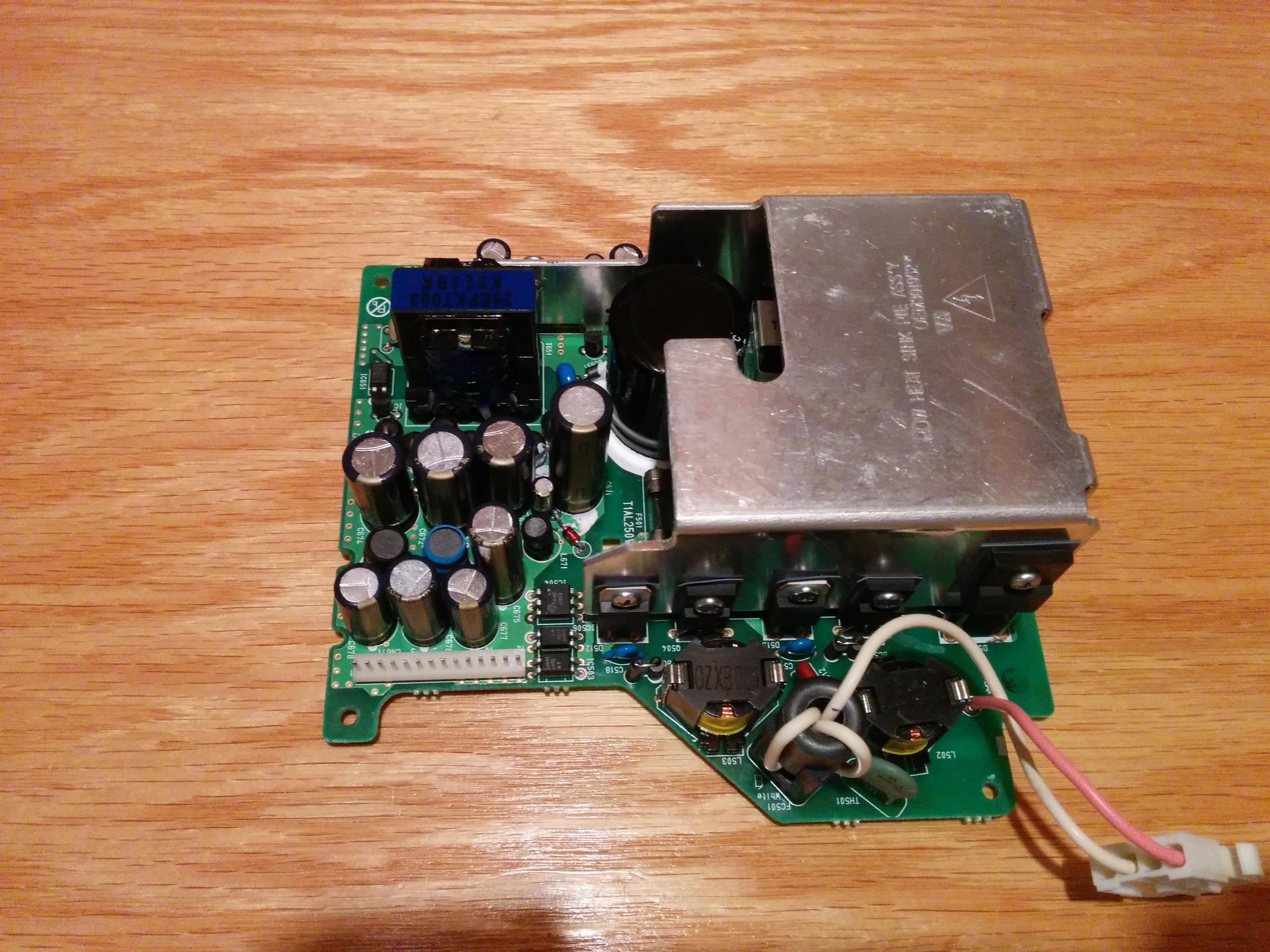

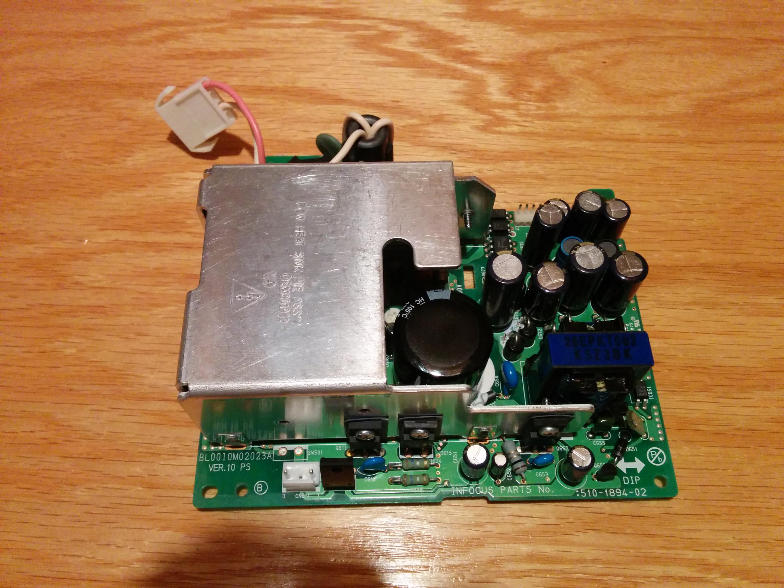

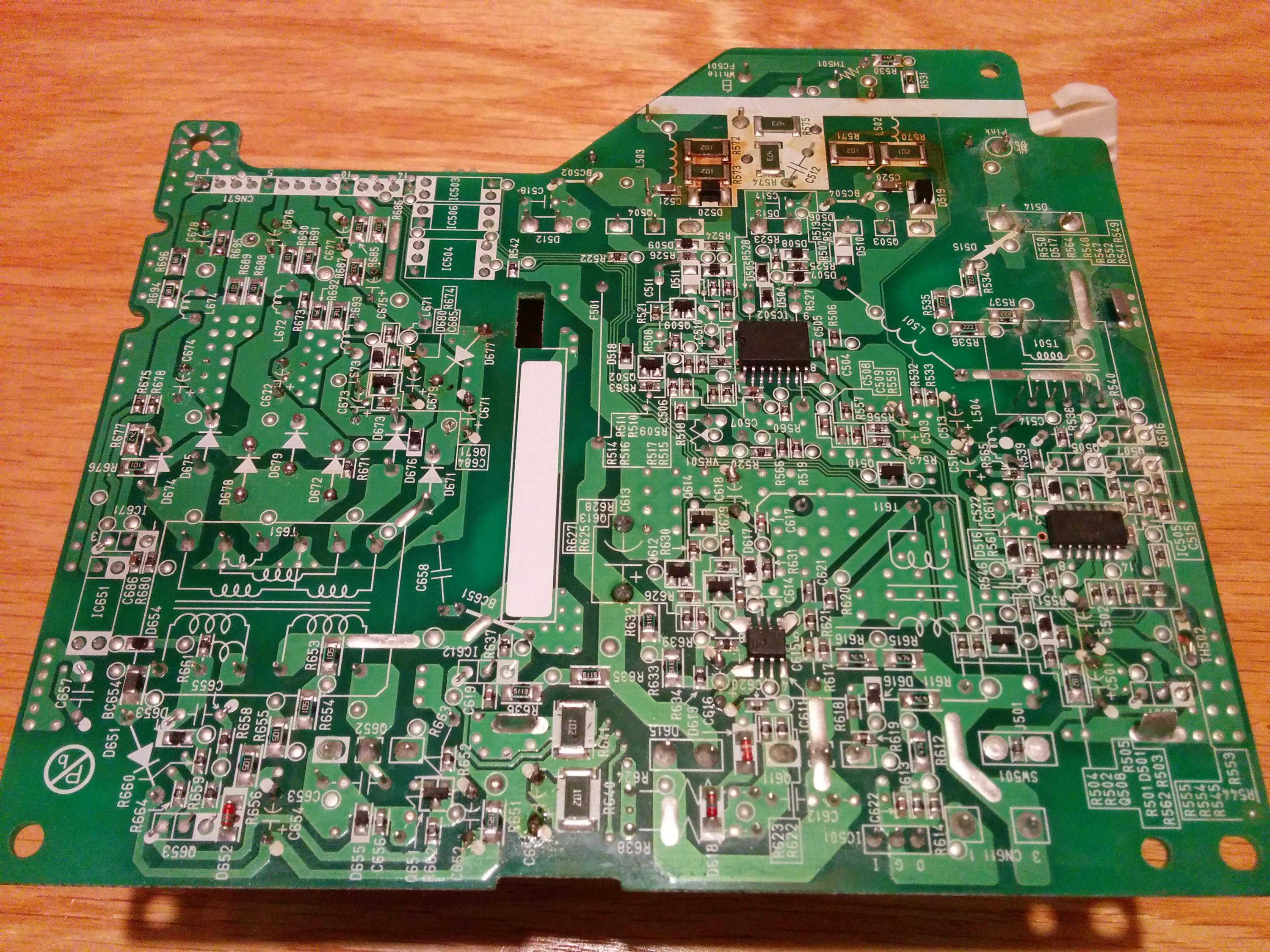

    The power supply has a bunch of lovely suscon caps and a nichicon filter cap. I figure that caps can go bad sitting around so I replace all but one of the caps with Panasonic FC that I have onhand. I powered it back up and it is still doing the same thing. I put the scope on some of the output pins of the PSU and note that there is lots of ripple. So I ordered a new filter cap and one more Panny FC to replace the last suscon.

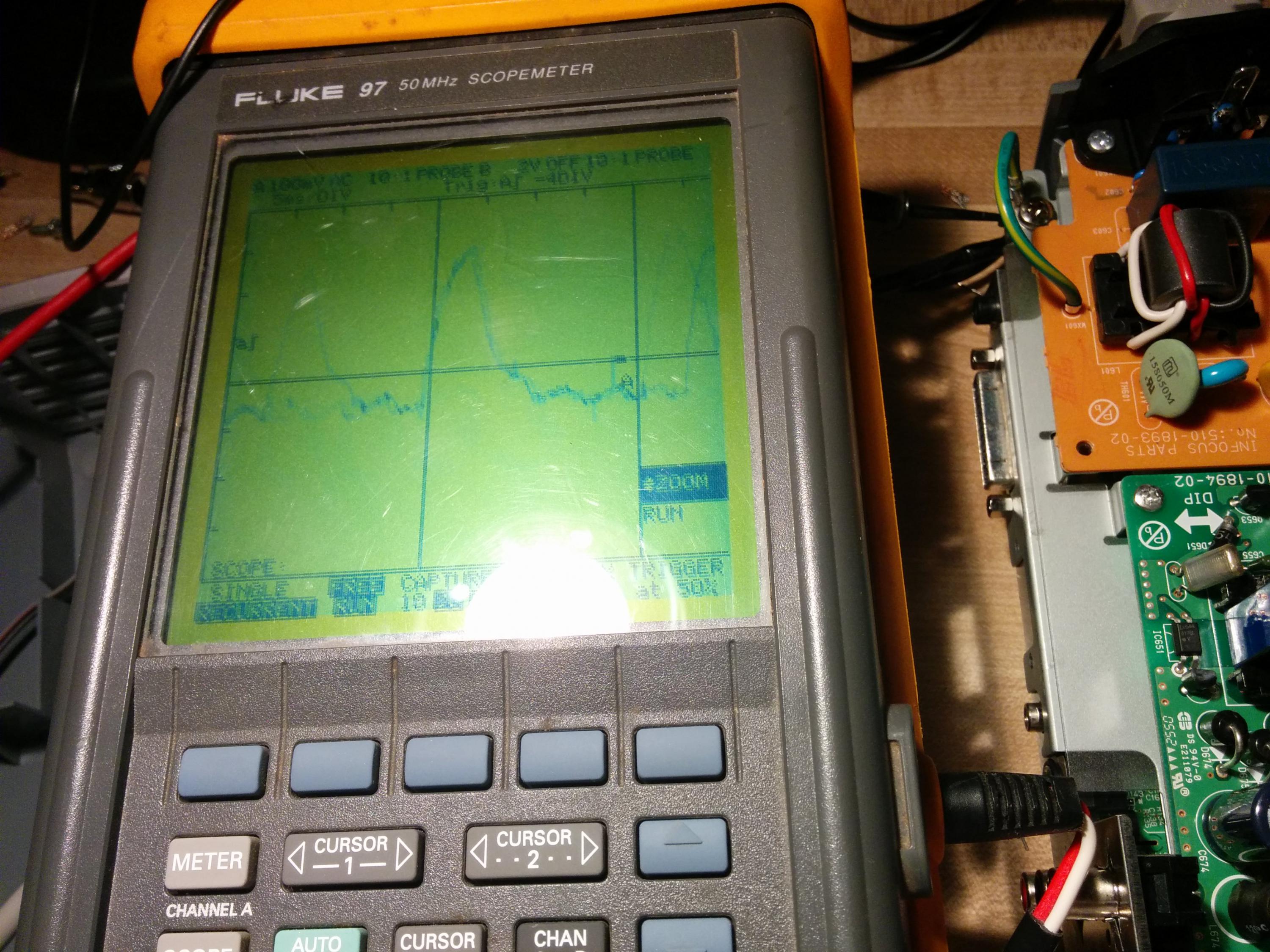

    Those caps cap in today, I installed them but the projector still behaves the same. The ripple is the same as well as seen in the pictures.
    TLDR: My projector won't work after 1.5 years in storage. The fans run but the lamp won't come on. I replaced all of the 'lytic caps (including the filter cap) on the power supply board but it still behaves the same. The attached pictures show what appears to be gnarly ripple on the output pins of the PSU. Is there anything else I could check or would I be better off to try replacement power supply for $25 on ebay?

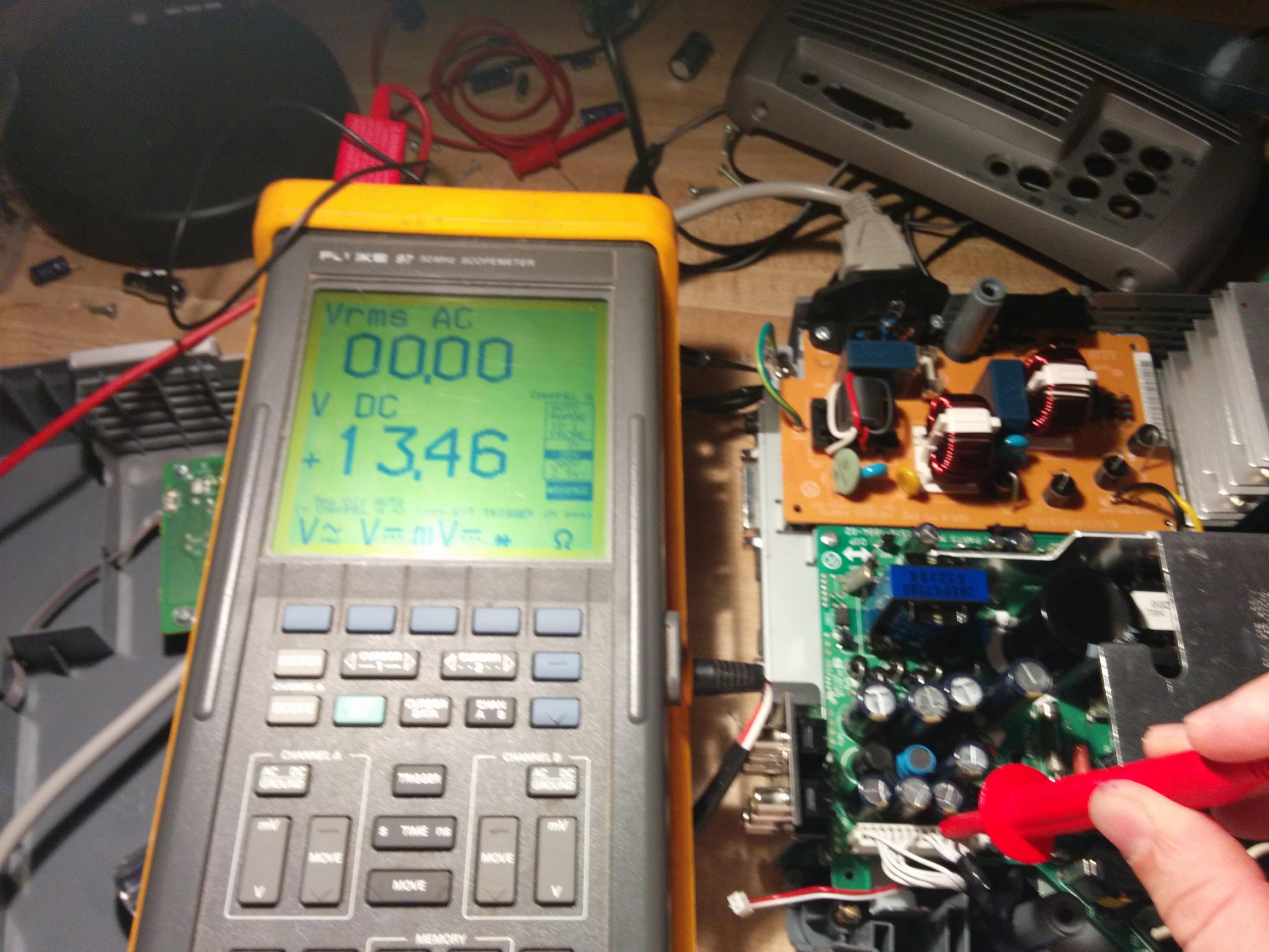

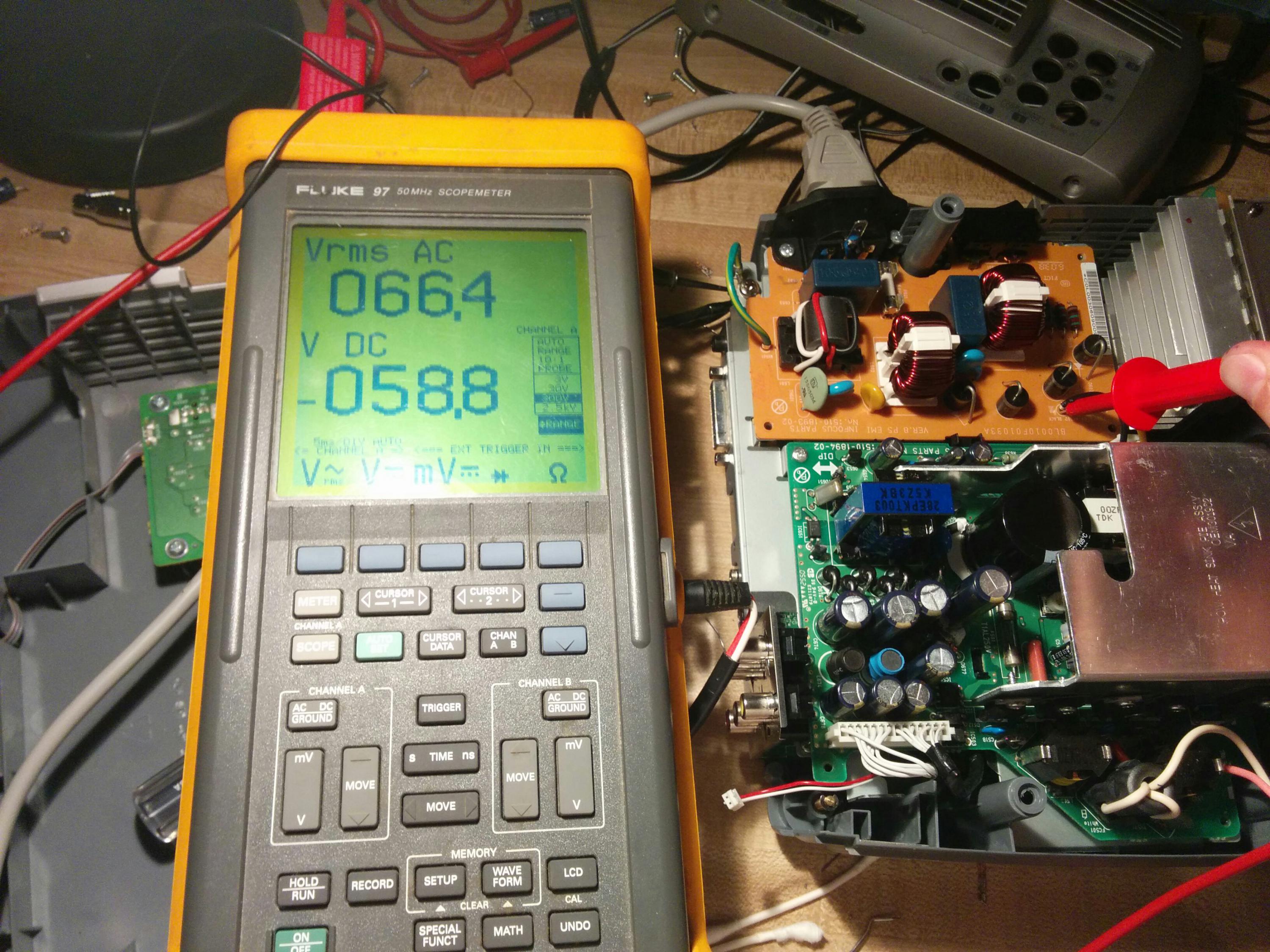

    Pics 5&6 show ripple on the 14v leg.
    Pics 7&8 show the ac input board outputting ~60v square wave dc
    Also attached is the service manual for the X1 which is similar. The voltage specifications are on page 83. The SP4805 seems similar. P/S interrupt was 3.2v, Lamp enable was 1.0v. Lamp lit was 0v.
    Power supply/ballast board part number is 510-1894-02

          I got a new power supply board from ebay for $25. I installed it today and much to my dismay the symptoms are the same. Still no signs of life from the lamp. Is there a cheap lamp that is readily available that I could use as a test instead of shelling out the $$ for the real thing?

            I would check the color wheel, if its not spinning the lamp will not light. It may have stuck from sitting. get access to it an see if it spins freely.
            • budwich
              • Jul 2015
              • 3097
              Re: Infocus SP4805 powers on but no lamp
              X2... if your color doesn't come up to speed, there will be no lamp lighting. It should come up to speed relatively quickly.... less than 3 seconds. Sounds like the drive of the wheel has an issue.
              The speed detector uses the clear section of the color wheel to determine the speed. If it doesn't happen within a time period, it shuts down. Further, the lamp starter will only attempt so many times before it shuts down but that usually happens for a bad lamp. Not sure but, I thought there were flash codes to indicate the failure. Do you see any?

                It twitches at first intermittently and then eventually spins up to what looks like full speed for a few seconds and then shuts off. It does so predictably and repeatably which originally led me to think that it was a power problem. But you may be right that the color wheel should spin up quickly followed by the squeal noise from the ballast as the lamp strikes. I have not heard that noise and the fans slowing down after a few seconds could indicate that the projector is giving up on its start up process because of the color wheel sensor not getting the correct reading.

                    Hmm I thought you had me convinced that it was the color wheel... (especially since I have ruled out the power supply)?
                    It definitely does not spin for several seconds after being spun by hand like in this video: https://www.youtube.com/watch?v=hUiYRqrNxxU
                    In any case unless I can get a parts unit with a good color wheel, this one might be a goner. The various offers for third party replacement color wheels on ebay seem dubious at best.

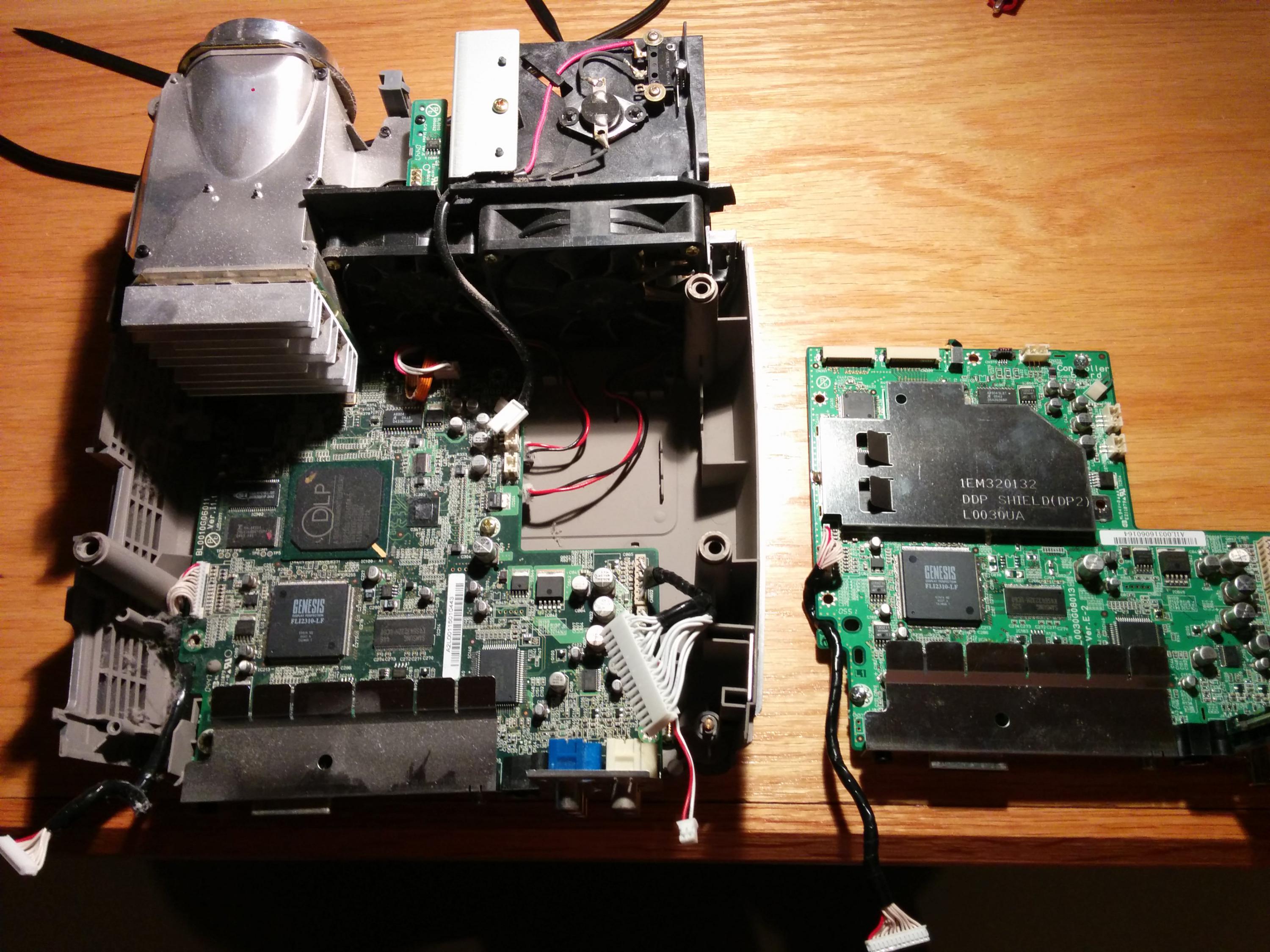

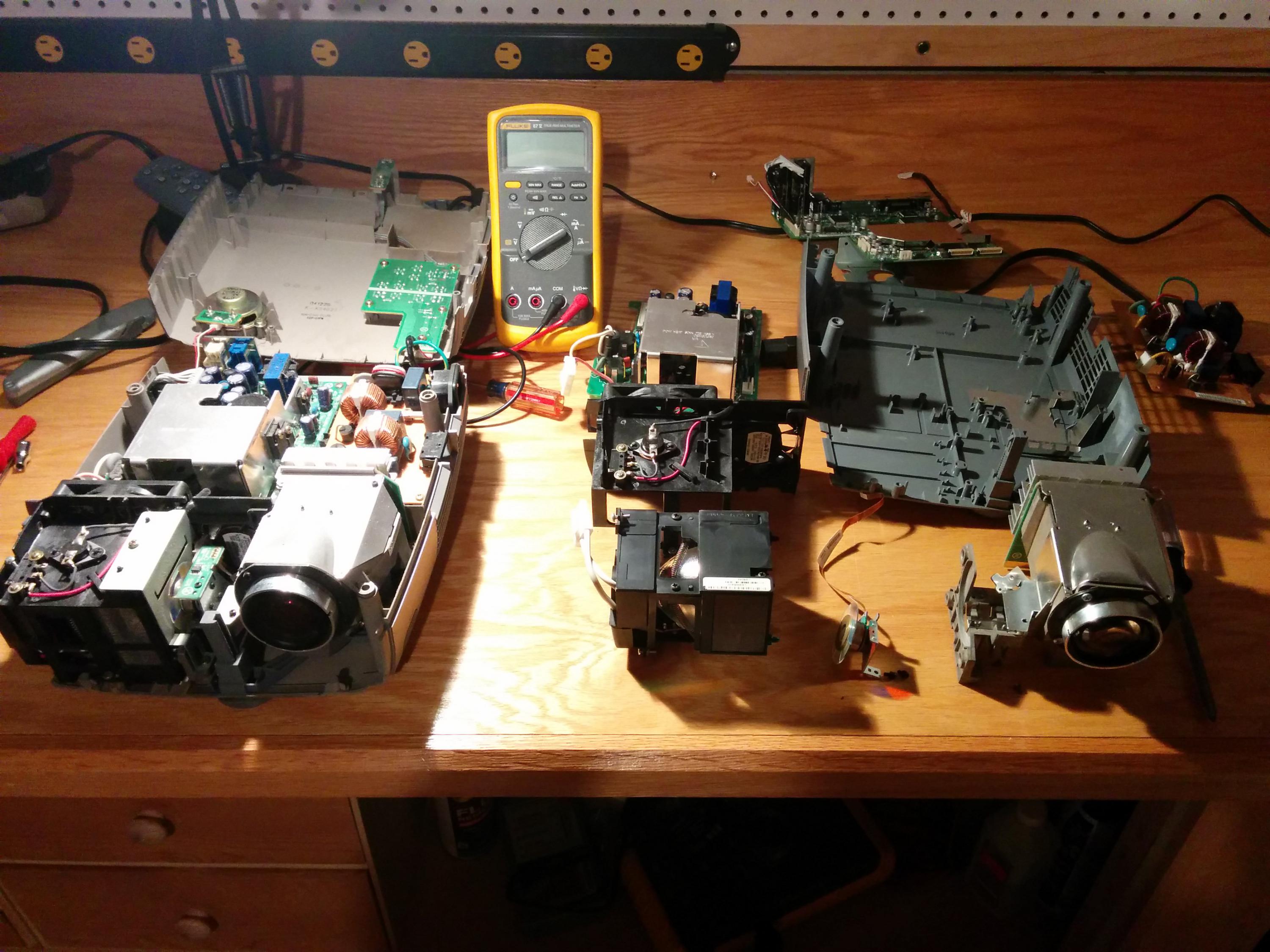

                        Hello again. I am pleased to say that I have finally solved this mystery. I was able to purchase another used SP4085 on ebay for a minimal expense. The one that I got was working but had the dreaded light tunnel burn/discoloration issue.
                        I first checked my lamp in the ebay unit and verified that it was good. Since I had convinced myself that the color wheel was the culprit, I did a swap of that component first. Unfortunately after doing the swap, the symptoms were exactly the same. The color wheel would twitch and then eventually spin for a little bit but nothing else.
                        So now I have to swap some more parts. I decided to try both the ebay power supply and rectifier board since maybe mine were cursed. Again the result was the same.

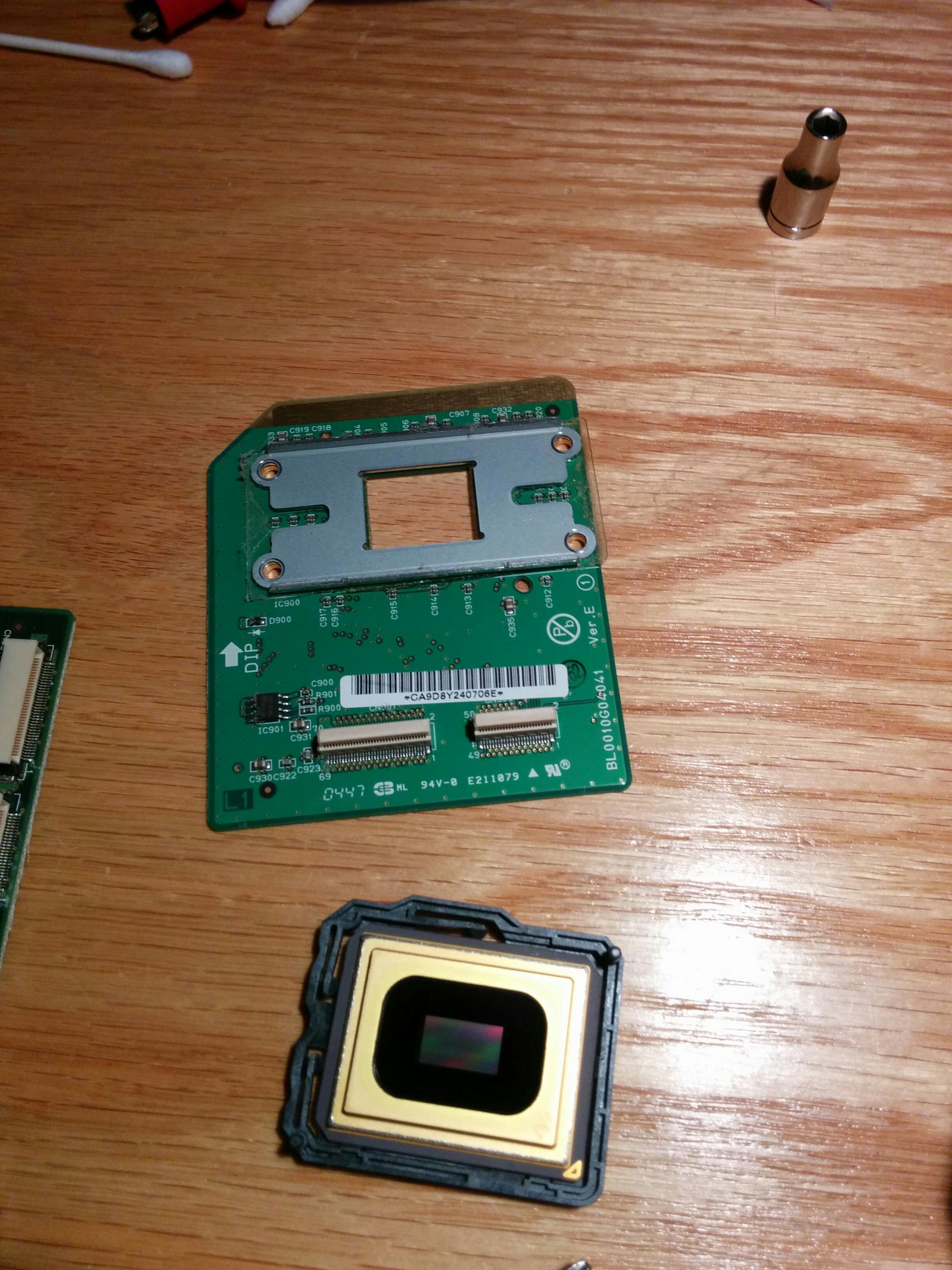

                        Crap. So now I have to try swapping the main board. I guess this won't be a big deal, maybe there is some calibration for the DMD chip or maybe not. I figure that I will just swap it and hope for the best. Well I couldn't have been more wrong because the ebay main board was an older hardware revision and the connectors to the DMD board were noticeably narrower (fewer pins) than my original.
                        So now I had to remove the DMD chip and board from the donor optical housing (because it was dusty has a bad light tunnel) and screw it onto my original. That actually too difficult and soon I had the whole thing assembled again.
                        And the verdict was... Success, it fired up the first time!! The only issue was the donor color wheel was pretty loud. So after one more time dismantling the unit, I put my original color wheel on and again everything worked fine.
                        So the bottom line here is if your unit won't strike the lamp and the color wheel twitches and eventually spins, you have a problem with the color wheel drive circuitry on the main board.
                        Final scoreboard on the swap: Original case, optical housing, color wheel, fans and lamp. Swapped in main board, DMD chip & board, power supply and rectifier board.
