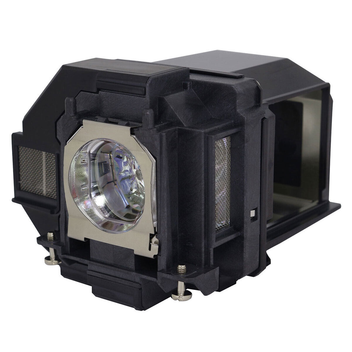

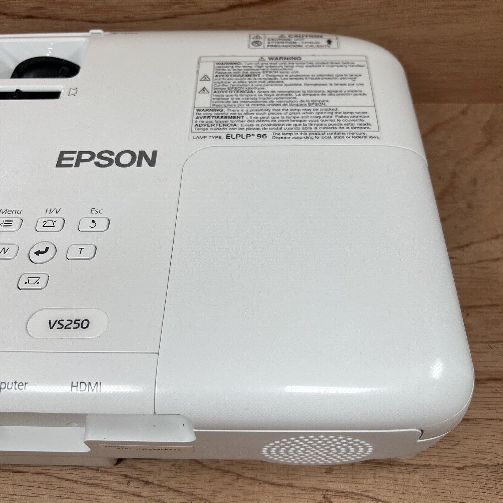

    Hi guys gooday i have a Epson VS250 Projector that turns on and is also being recognized and detected by the computer when i plug the hdmi cable.The only issue the projector lamp is not working .Are these lamps repairable ? Or i should just forget repairing the lamp and just buy a replacement. Thanks

    If the status light is flashing blue and lamp light is orange, this indicates that there is a problem with the projector lamp. Check if the lamp bulb is burned out, broken, or seated improperly
    https://www.ifixit.com/Wiki/Epson_VS250_Troubleshooting

      thanks for the troubleshooting guide.The status light isn't flashing and the lamp light is just plain off. I opened the lamp and am not seeing any signs of burnt markings or it being broken.So i think it's safe to assume the Lamp proably just reached end of life.So i will get a replacement and see how it goes from there. Thanks a lot for the suggestions Pete.
