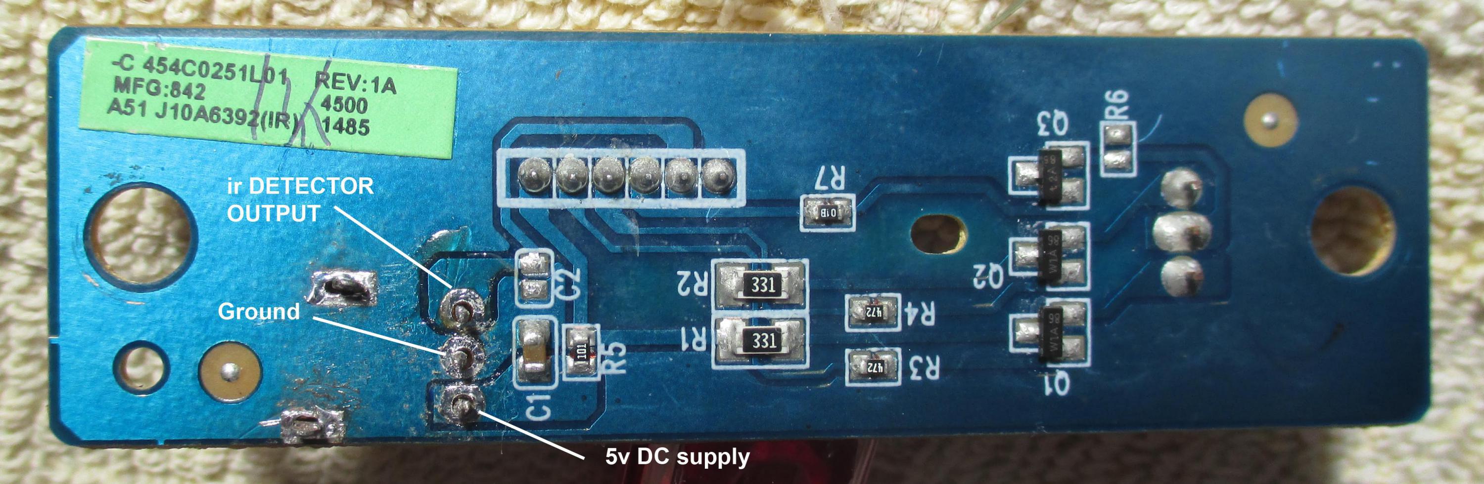

    Hello All,
    My remote is not working but all the buttons on the TV work OK.
    The remote's I.R. output passes the camera test.
    I have renewed the IR receiver even though the old one checked out ok.
    The infrared detector sensor board has an SMD 2012 (metric) capacitor "C1" which I believe to be faulty. Please see attachments.
    With the I.R. sensor removed no other elements are involved & C1 capacitance reads O.L. and it shows 1.9 ohms resistance.
    The cap has no value on it & after many hours I have been unable to find a schematic with its value.
    It bridges between the board's 5v power supply & ground.
    The TV is a Toshiba 32AV500A. (Australian release)
    Can I remove C1 for good with no long term ill effects?
    Is there a generic value that I might substitute?
    Or if someone can point me to that particular C1 value I would appreciate it very much.

    Either a 0.33uF (input) or a 0.1uF (output) depending.

      Thanks for your reply CapLeaker.
      I am not sure of the significance of input & output.
      The 5vDC to C1 is input supply from the power board via pin 1 of the the 6 pin socket on the IR board & through R5.

        that cap is pretty big, i suspect it's more like 10uf!

          The 5v would be the input, so he's saying try a 0.33uF cap there and a 0.1uF on the other. The one missing in the pic is the output.
          Many IR detector circuits don't use caps at all, I think you could try it without C2 and see if it functions.

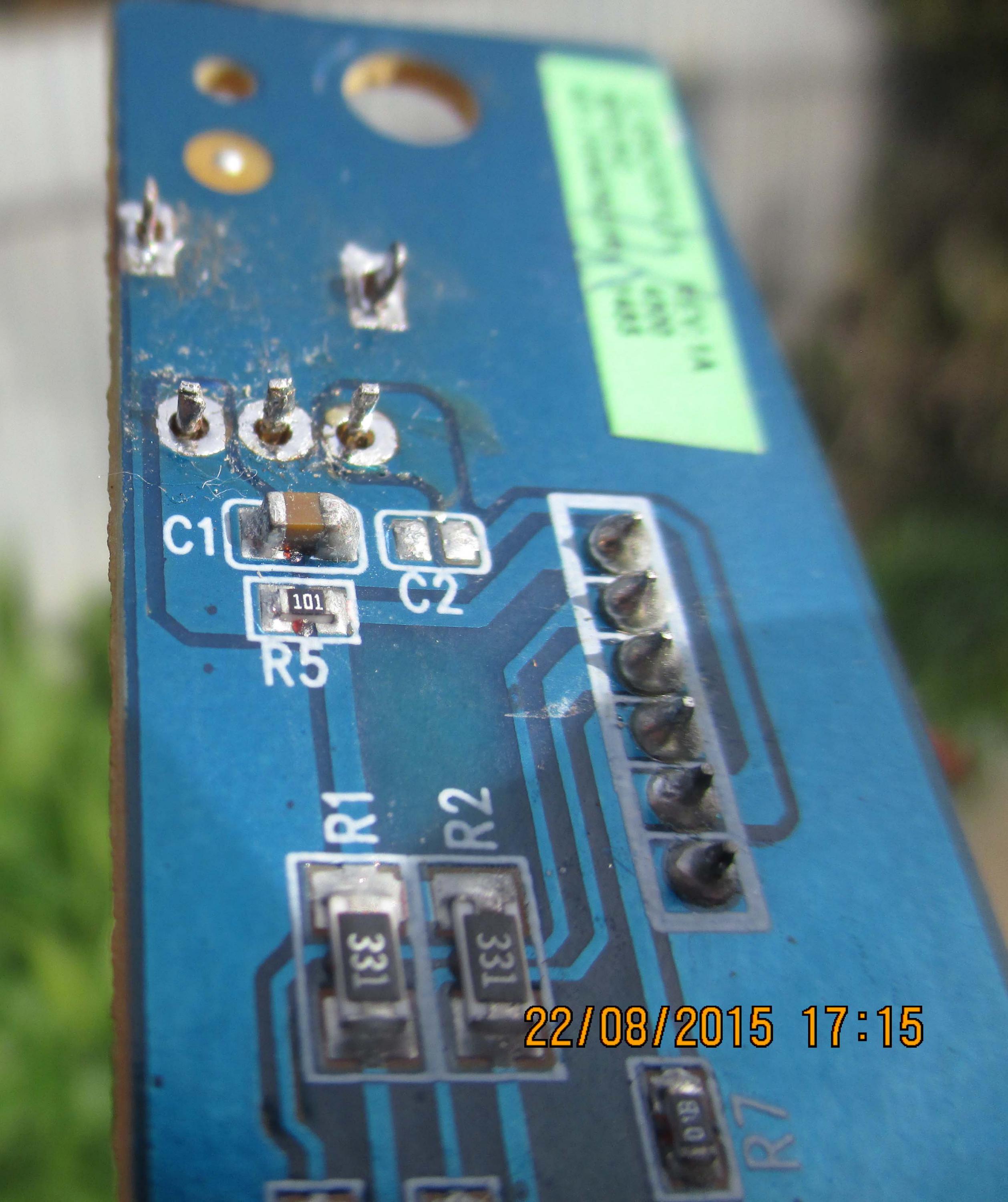

            Stj, The photo does make it look big.
            It measures 2,0mm long & 1.3mm wide (2012 metric form)
            Very general specs give those ceramic SMD caps 1nF~100uF if you call it light brown or 10nF~1uF if you call it medium brown. The adjacent resistors are dark brown.
            Steve until your post I did not realise that C2 was missing! The gap measured 0.2 nF

              I misunderstood. I saw C2 missing and thought you'd removed it and it was the bad one. My brain fart, sorry. Anyway, either way, try it without C1 and see if it works if you want to. I don't think it will do any damage to try. I believe it is there to help smooth transient switching currents and the circuit may basically function without it.

                I like your workaround. Try running without the shorted C1 & the missing C2. Suck it & see. Thank you.

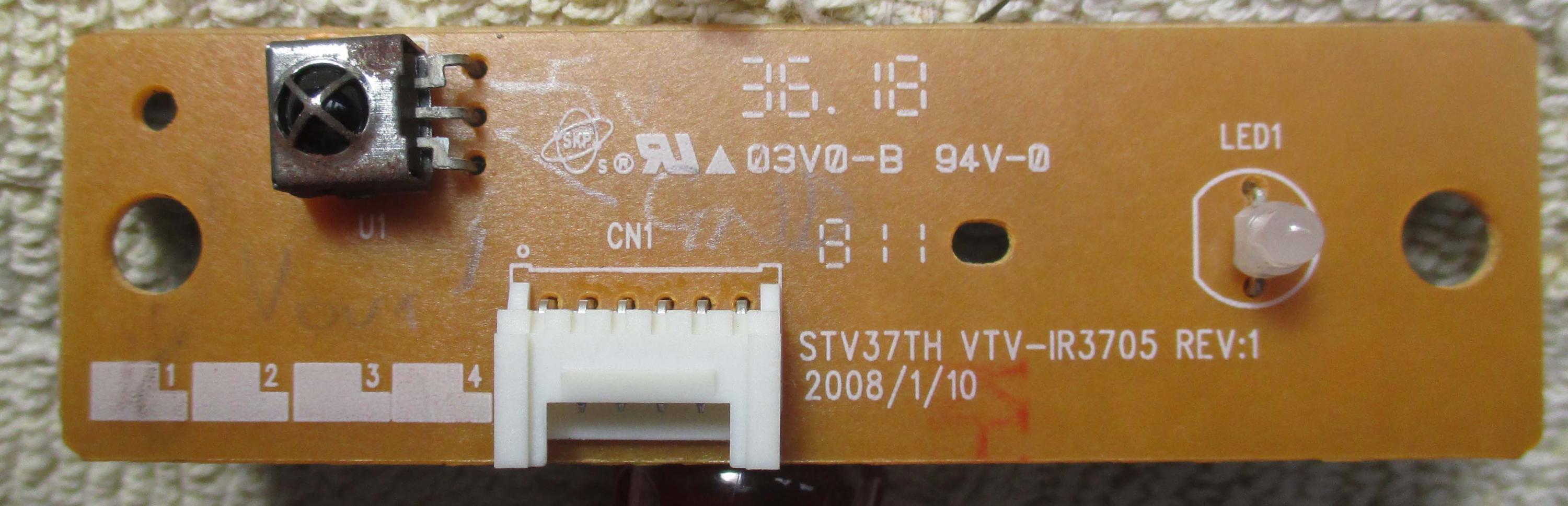

                  Any chance that IR detector has a part number? If yes, then you can can look up the datasheet for it. Usually the manufacturer will include a circuit for setting up that detector.

                    Original IR detector is
                    5B89
                    53A
                    I had Googled it but got no hits.
                    Not having brand name didn't help. However the replacement came from Jaycar
                    Catalogue No. ZD-1952.
                    Just found its data sheet but no capacitor details.

                      If you want, change it over to electrolytic. Capacitance is not that critical there, but is surely would something back in. The only problem is to obey the polarity when you do change it over to electrolytic anything between 0.33 and 1uF should do the trick.

                        if you change the sensor, dont mix up 5v ones with 3v ones.
