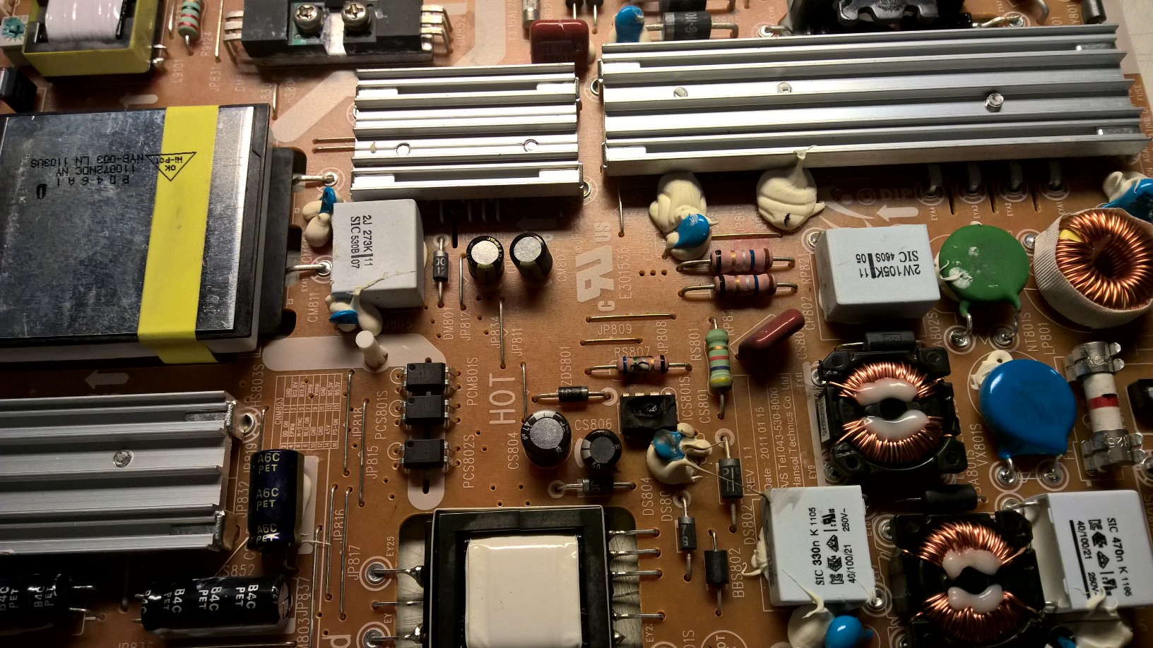

    I need what IC is used on Samsung BN44-00458 or perhaps a schematic.
    Cannot locate a schematic for those PSU's.
    It's a flyback controller with integrated FET, blown. (see picture)
    Thanx in advance!

    BN44-00458: A, or B?
    Picture of the whole board?
    BN44-00458A does not match your board.

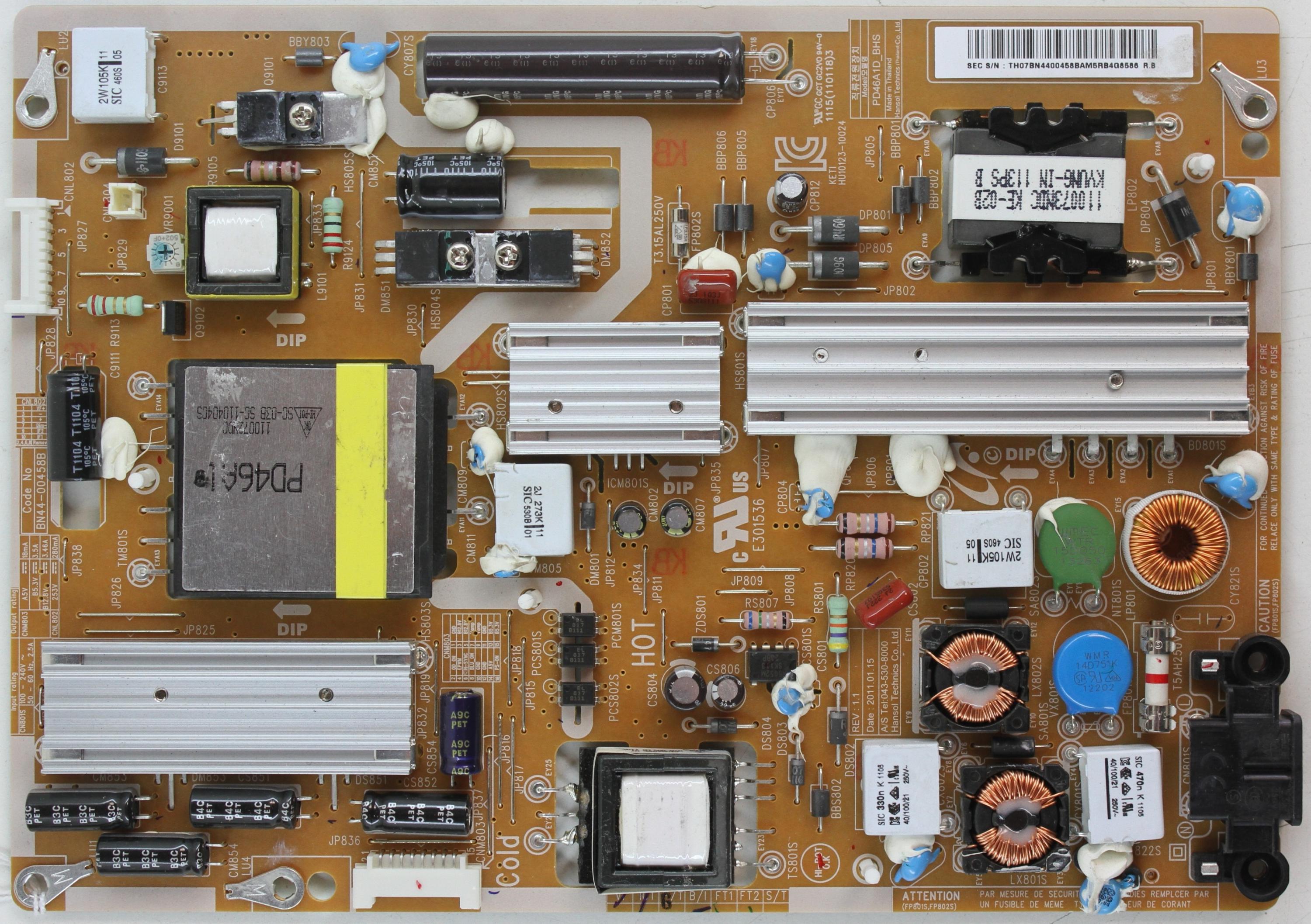

    https://flattvparts.co.uk/samsung-ue...-su10054-10050
    'B' looks kind of like your board:
    https://flattvparts.co.uk/samsung-ue...-hu10123-10024
    BTW, what is the TV model?
    May be some one with better eyes can read the #.
    ??6052M

      Reference Picture Link
      https://flattvparts.co.uk/images/sam...3-10024_rs.jpg

        Re: Component ident needed Samsung BN44-00458 PSU
        Great! Thanks for your help.
        Looks like a STRA6052 Sanken device.
