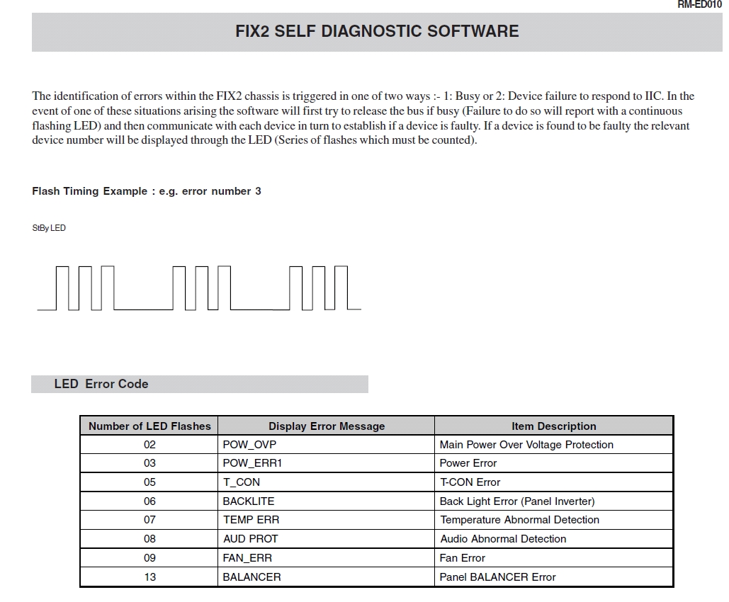

    Hi folks,
    I have a Sony 46x3000 that came to me with the led flashing 8 times, couldn't find anything obvious with the audio system so swapped the AE aboard.
    The 8 flashes have now gone, the green led comes on and the Sony logo lights up on the frame, but no backlight.
    Then after 30 seconds or so it switches back to flashing the led 5 times. I believe this indicates a TCON error according to the service manual.

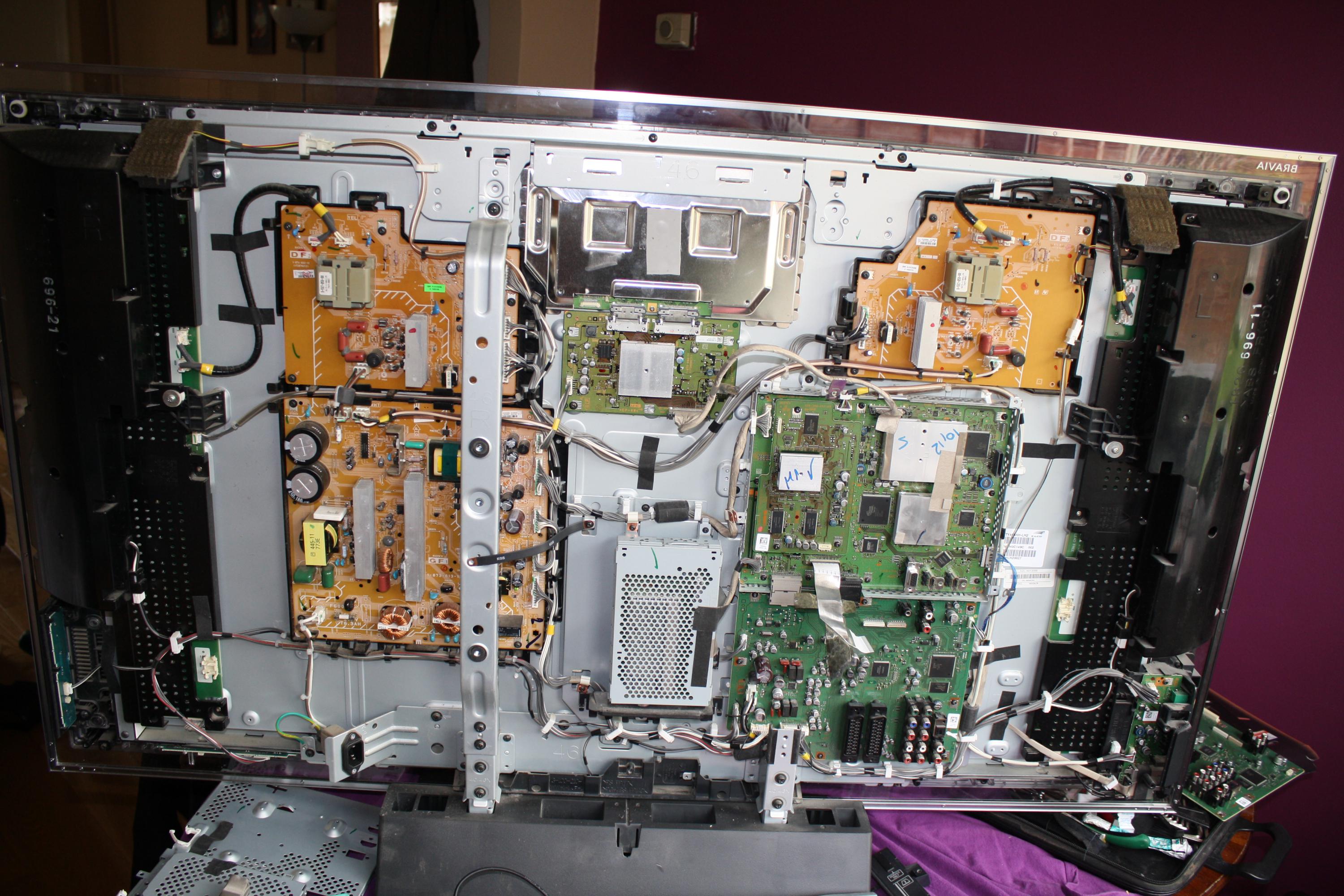

                We still need good pictures of the whole backside of the TV so we can see all the boards.
                "Just checked every voltage test point I could find and all seems as it should be." At which connectors and at which boards? And how about the signal pins what DCV do you get when TV is OFF and when TV power switch is activated and then after it goes into shutdown mode?
                3-8-5.
                When the TV Set has a T-Con error please check the following:-1.Check the BE micro pin 128 on the FB2 board.2.Replace the panel module.

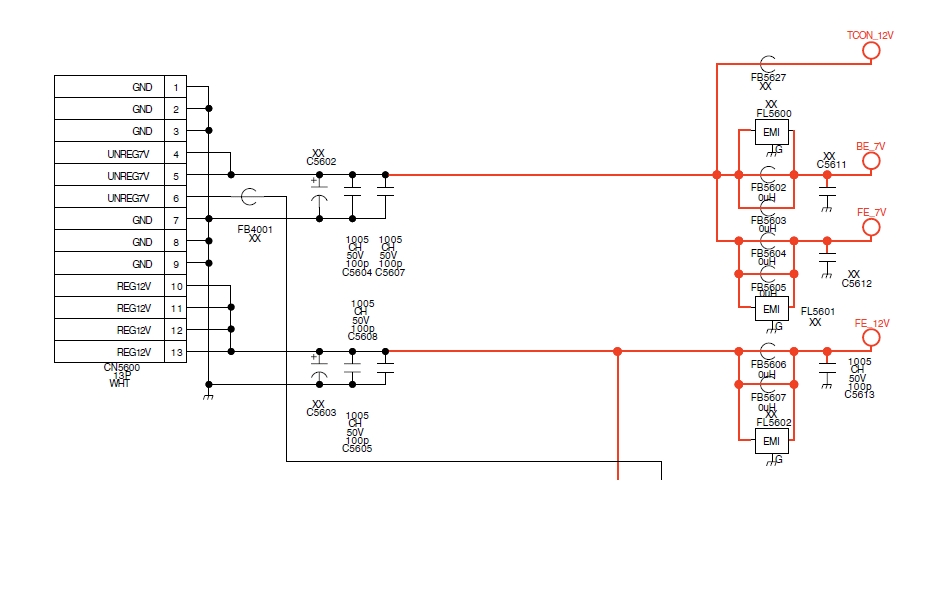

                The schematic is not easy to read due to pages are spitted into many pages.
                The diagram is really confusing, the T-CON 12V is connected UNREG 7V?

                  Is there an easy way to tell if the FB2 (main board) is outputting a signal to the UB1 motion compensation board? or the UB1 board to the TCON? I have a DVM, but my haven't turned on my oscilloscope for a few years and seems to be a bit temperamental.
                  Moving the LVDS cable around doesn't seem to change anything.
                  Photo attached.
                  Pete
                    Re: Sony 46X3000 errors
                    The T-CON board is under that metal shield, the connector on the bottom of the board is connected to the FRC (Frame Rate Conversion) board, then the connector of the bottom of the FRC board is connected to the main board.
                    So you you remove that shield to get to the T-CON board fuse? T-CON bd is replaceable.

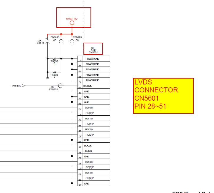

                      Yes, I had a go at removing the Tcon board a few days ago but it's pinned in by the metal bracket that seems to be supporting the panel, will have to take a lot off to get to it. Luckily the TCON power fuse was on the lower edge of the board that is accessible.
                      The linked diagram shows how the panel_on signal switches through the main 12v through to the Panel 12v which is the power for the T-con board. This is why the fluctuating signal is turning the Tcon on and off.
                      I left the TV off for a while, came back in and it's back to 5 flashes
                      http://www.ukrobotgroup.com/Downloads/tconpower.jpg
