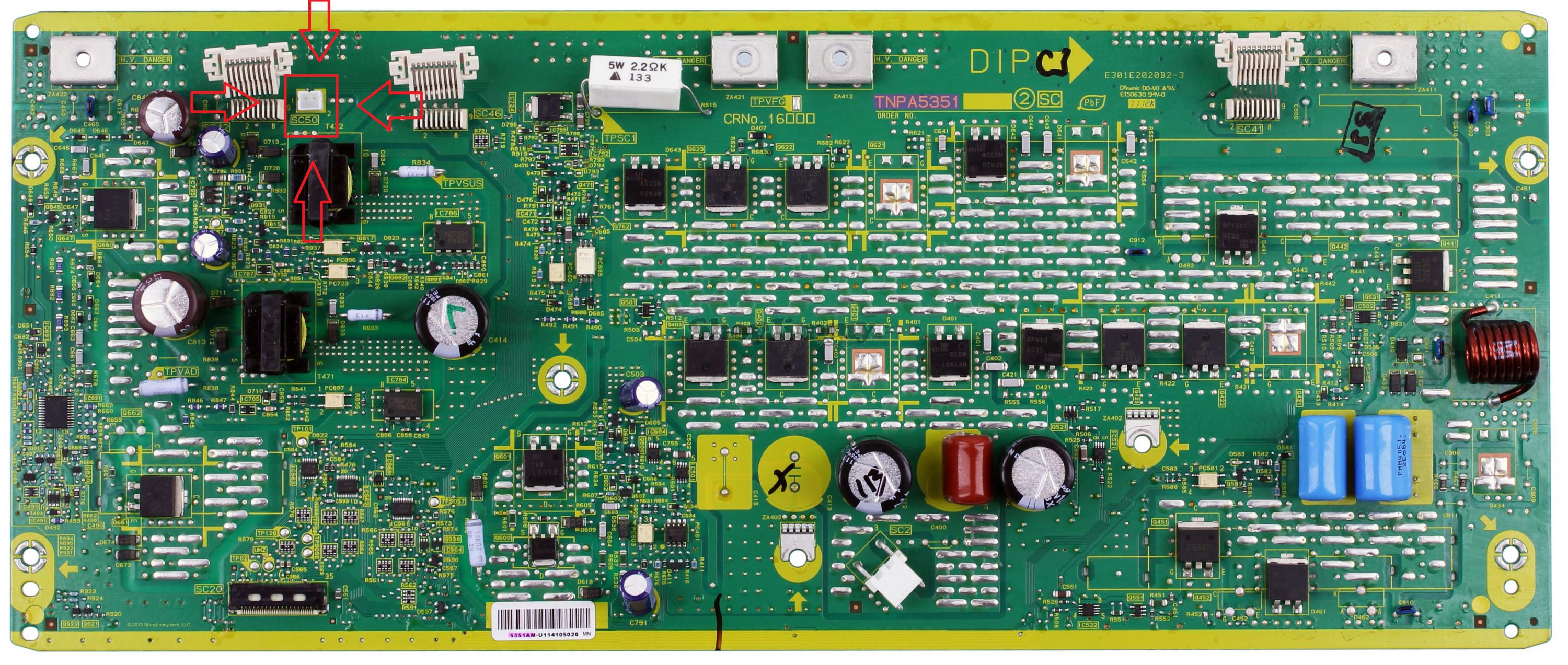

I have a TXNSU1MNUX Panasonic SU (TNPA5336AM) that has a sigle top buffer ic shorted,
you can actually see a tiny hole on it, this failed buffer ic resulted in failure of sc and ss.
Do i need to just replace the buffer ic or is there other smd's that need replacing?
The sc is shorted from sc2 upper pin 3 to ground screw.
The shorted fet/diodes on sc
2x:rfn20 ns3sw
3x:rf1501 ns3s
1x:rfn10 ns3s
The ss has a shorted center pin to ground.
The shorted fet/diodes on ss
2x:rf1502 ns3s
The ss also has the top brown cap 220v 120uf with residue on top unlike the sc,
any recommendation on replacement?
Im just gonna order it now and replace it while i can i cant afford a tester yet.
Is there any other smd's that i gotta replace such as the repair kit you can buy?
For me to order the repair kit is a waste of money because they are not all faulty.
I just need to confirm before i order so evrything comes in at the same time.
