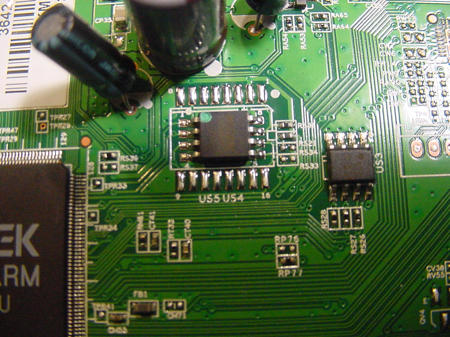

    TV won't turn on power on with remote or buttons (LED indicator remains same color). The PS-ON stuck high, BL-ON stays LOW.
    Got the replacement EEPROM from SJ through AMAZON due to free shipping.

      'did the EEPROM fix the problem?'
      Yes, the TV is working with all functions.

            Hello guys I have this tv but the maiboard is different from the picture and I cant Locate the eeprom to change the board I have is a 0171-2271-5032 and the only eeproms I find are labeled as UP5 UP3 UL1 UH11 UH10 please help me out finding the right eeprom to replace thanks I cant find the US5 US4 on it....
              Re: Vizio E420-A0 with bad EEPROM

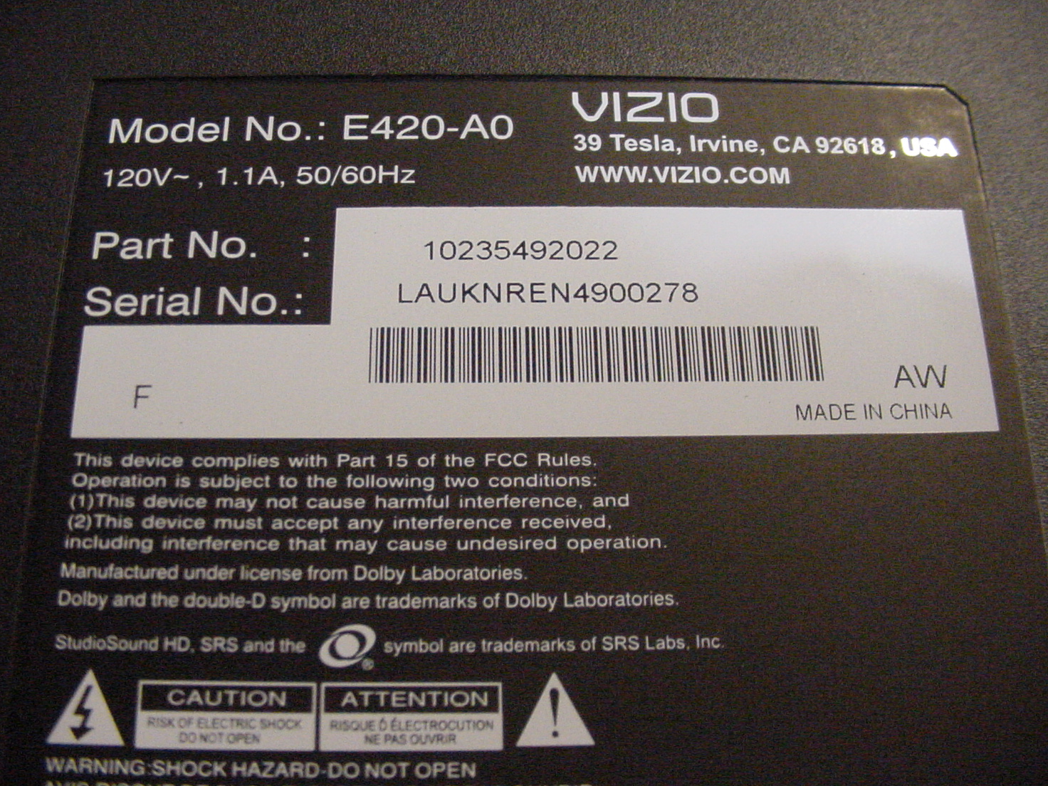

              What is the Exact model number and serial number of your TV?
              E420-A0 is not the same as E420i-A0 (Smart TV).

                you are right my tv is the E470i-A0 I was under the impression there were similliar and had the same problem, when i was doing research I saw people talk about E420 and E470 with the same issue, I got the eeprom but after I look in the board I cant find the eeprom I have to change, I hope someone has had this and know which one to change
                Thanks for any help
                  You should start a new thread and upload good clear pictures of the boards and the whole backside of the TV showing all the boards.
