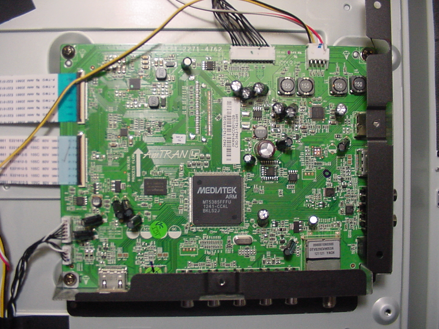

    Hi everyone
    Iยดm trying to repair a TV Vizio E320-A0 that I found in the street
    The symptoms are it doesn't respond with remote or buttons, the LED indicator is always off and also there is no image on the TV.
    The power supply board works fine (I probed the terminals with my multimeter) but in the main board the EEPROM doesn't works correctly because the voltage on the pins doesn't match with the parameters of the datasheet.
    So, Iยดm going to replace the EEPROM with a new one, but the problem is that my programmer (CH341a)...

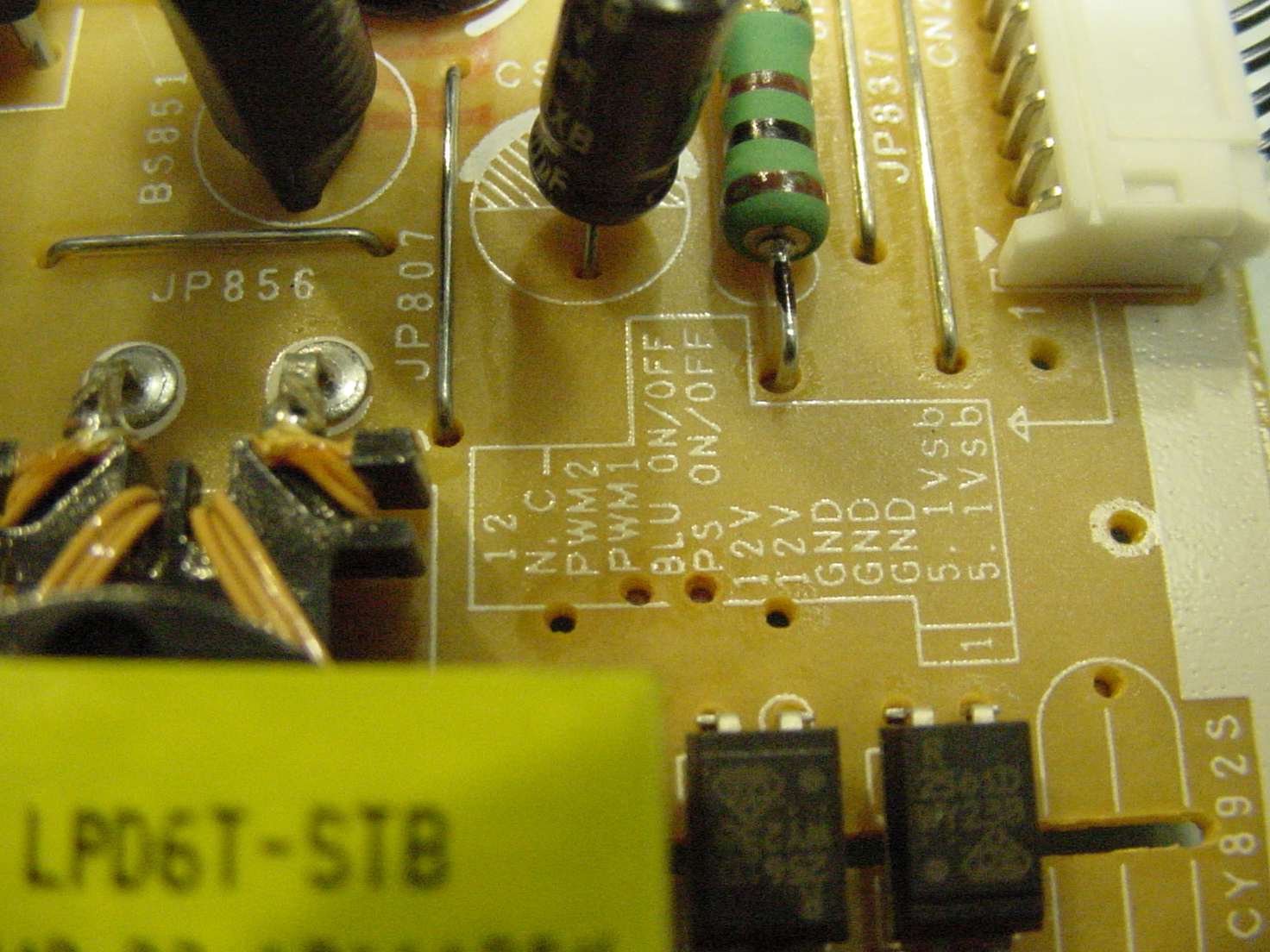

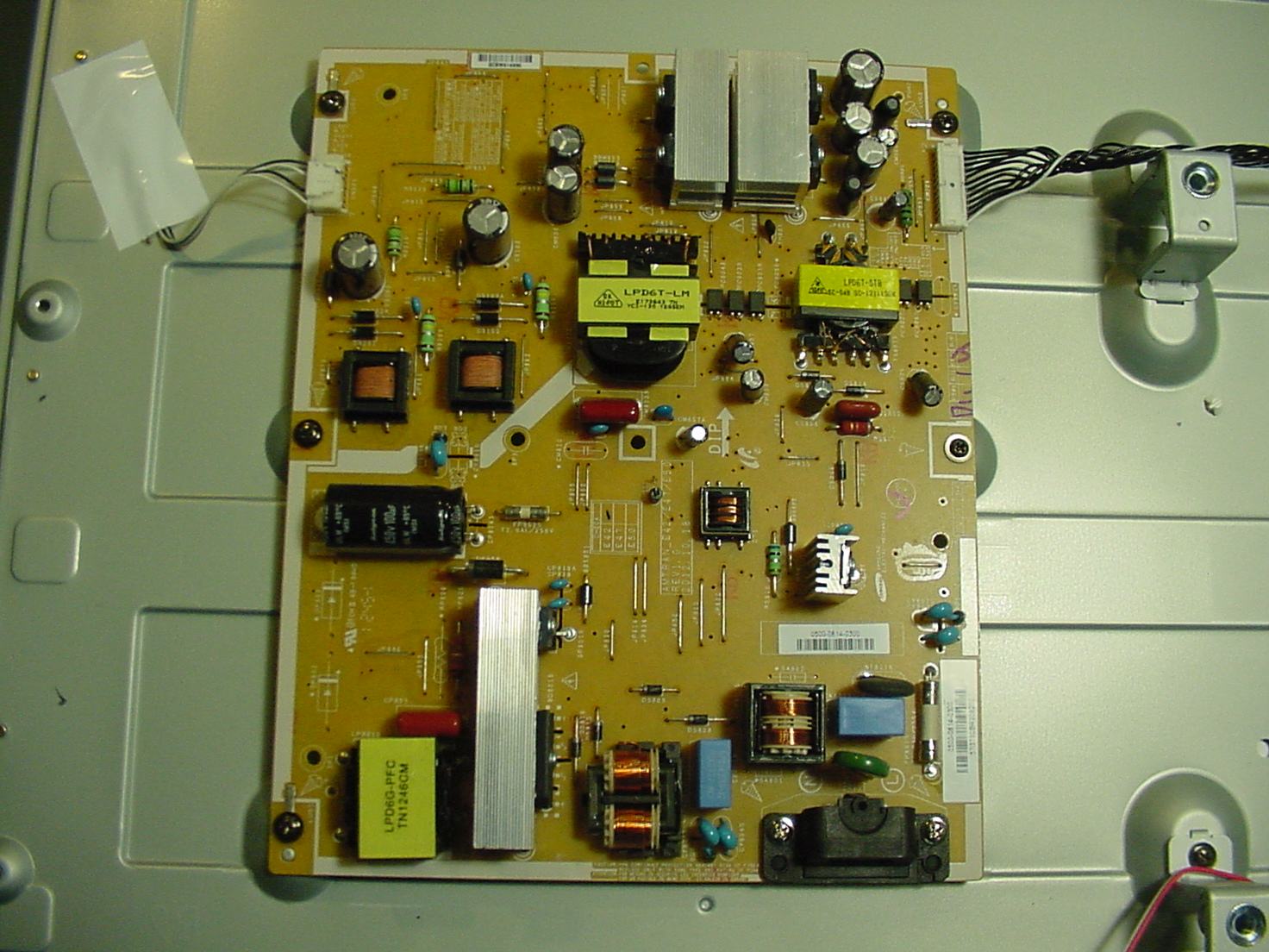

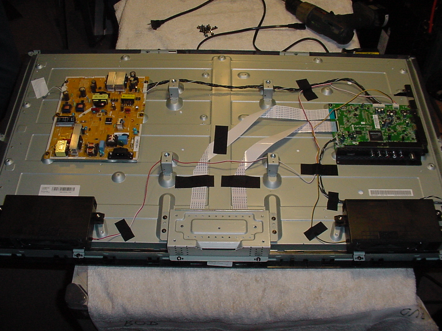

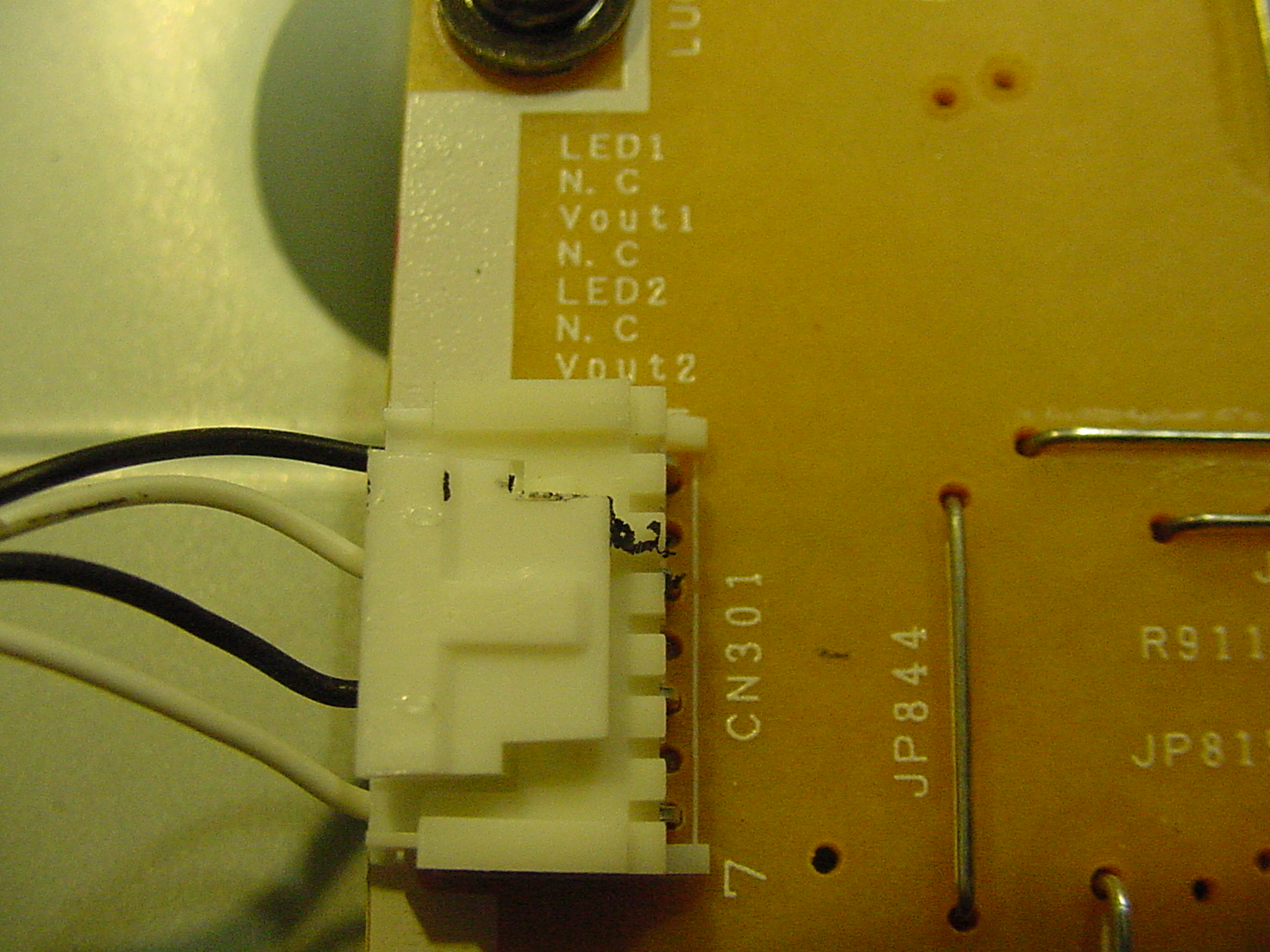

    vizio e650i-a2 backlight flashes then turns off
    by SS454
    vizio e650i-a2 (LWJAOZBP Serial) led backlight flashes then turns off, has video (via flashlight) and audio.
    panel: au optronics T650HVN05.4
    72 led total on 12 strips, 6 led per strip wired in three groups of 24 (led driver board has three anode and three cathode pins)
    link to datasheet: https://datasheetspdf.com/pdf-file/8.../T650HVN05.4/1
    Vizio 56.04219.641G (liteon PA-3231-01WN-LF) Power Supply Unit
    https://www.shopjimmy.com/vizio-56-0...-power-supply/
    Vizio 55.75J01.001G (91.75J10.004G) Main Board...
