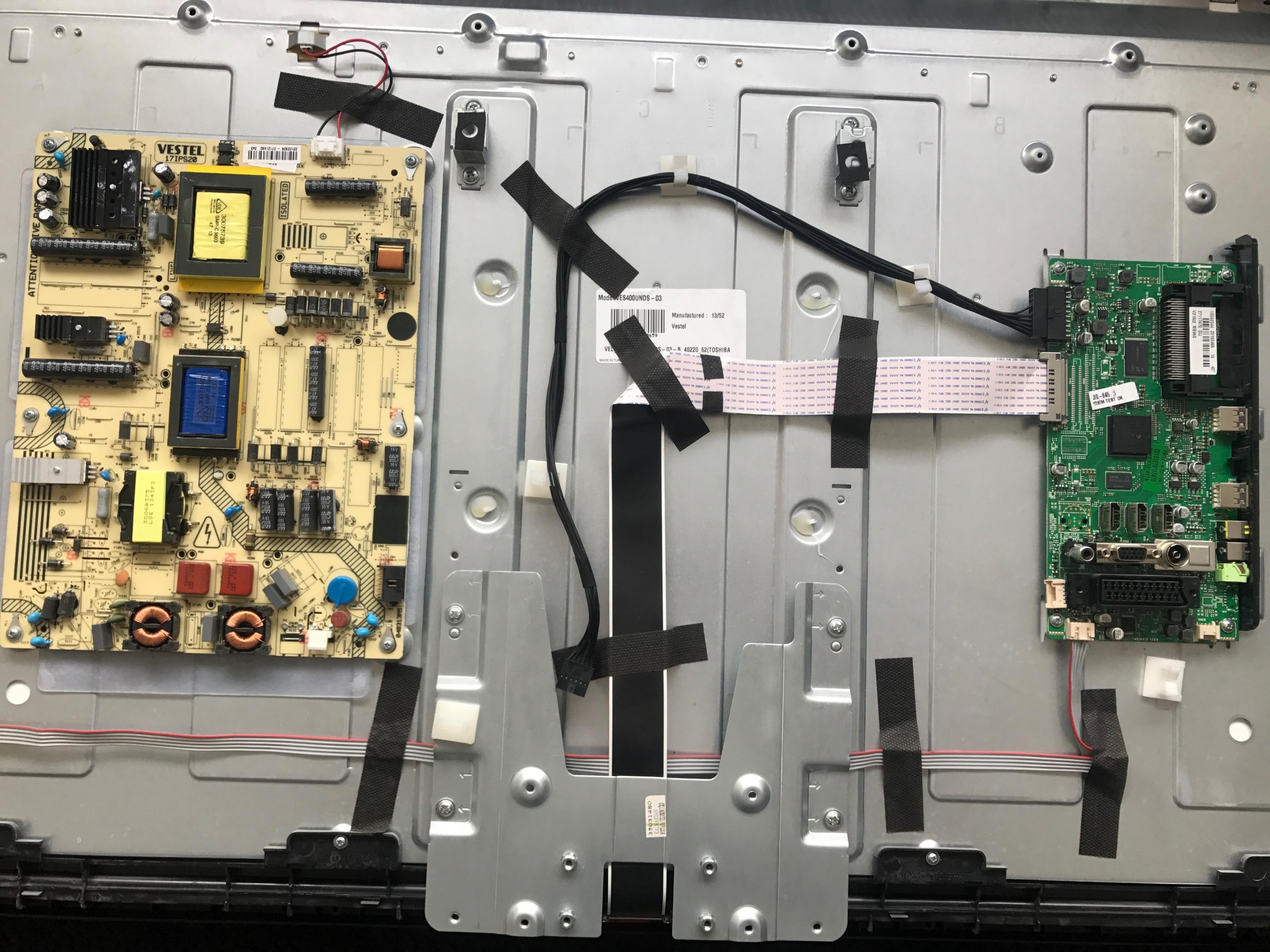

    Yeah I'm an idiot. I was testing them wrong. Turns out there are 4 duds.
    Not only that but I have some SMD LEDs that should be close enough to use. Gonna replace them now, I'll post the results.
    Thanks for the advice!
    • formant84
      • Nov 2016
      • 13
      • uk
      #42
      Re: 17ips20 diagnosing
      Replaced the dead LEDs, powered on... Still no backlight.
      My guess is that my replacements couldn't take as much current as the originals and just instantly died. Got no more time to look at it today, might order the LEDs you linked in and have another stab at it during the week.
      Thanks again.

        Turns out the new LEDs are fine. They all flash once just as the voltage goes up to 190 but then go off straight away before it settles down to 115v. Any ideas?

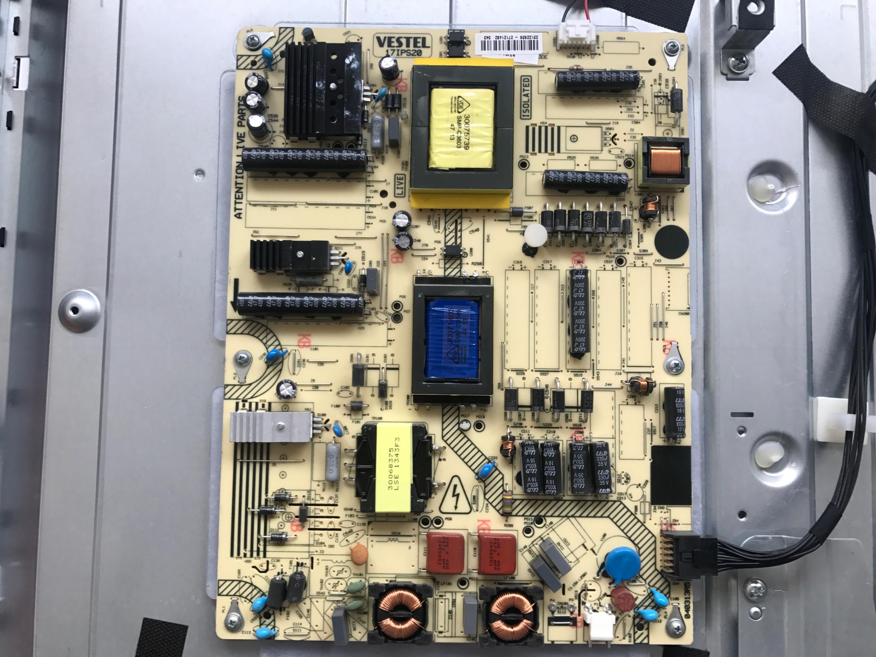

          I Assume the LEDs are powered from a constant current source which isn't working, giving them a spike and then virtually nothing. I've tried measuring the current with my multimeter and it's either around 1ma or the fuse in my multimeter has blown :/

                          my guess its the leds you have replaced maybe upsetting the led ouput feedback circuit? are your replacement leds brighter or darker in brightness?
                          what tv is this your working on?

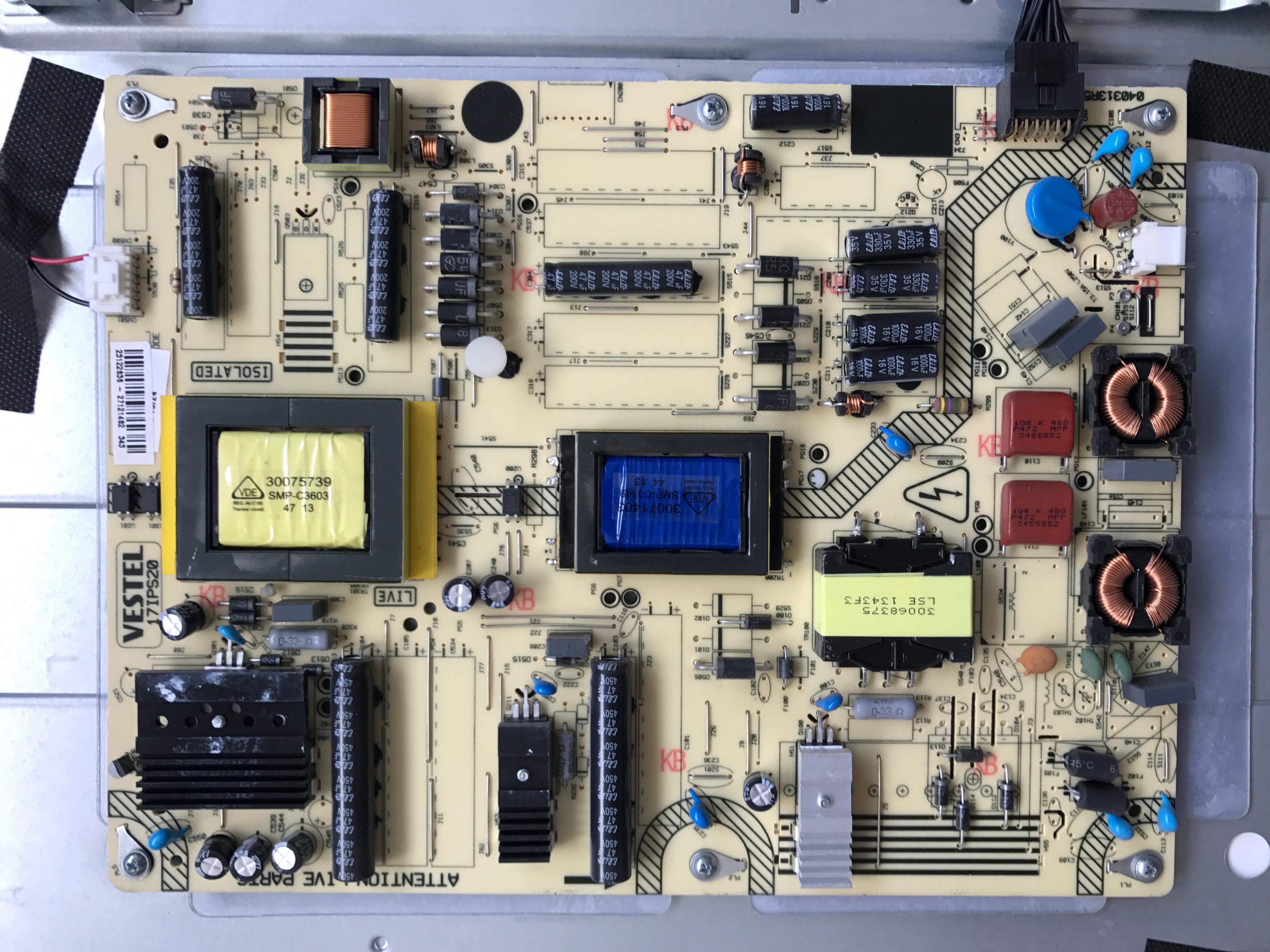

                                    Hello, sorry for jumping on here but I have a 17IPS20 that the power going to the main board jumps from 23.3 down to 15 when the main board is plugged in, when I unplug the main borad the voltage sits at 23.3, I don't get any other voltage on the pins going to the main board, show I not see a 5v? do you think this is a faulty PSU or main board ?

                                      The best way would be to force on the psu by itself and place a load on the psu outputs and see if its ok and the voltages stay stable under the correct load
