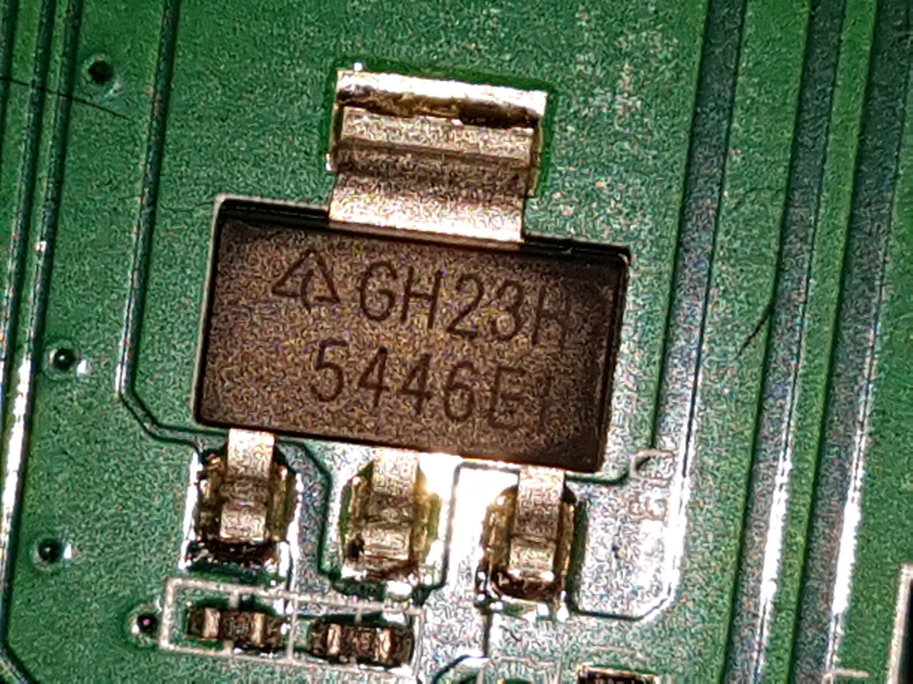

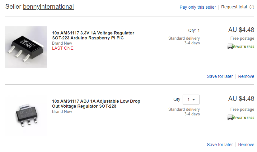

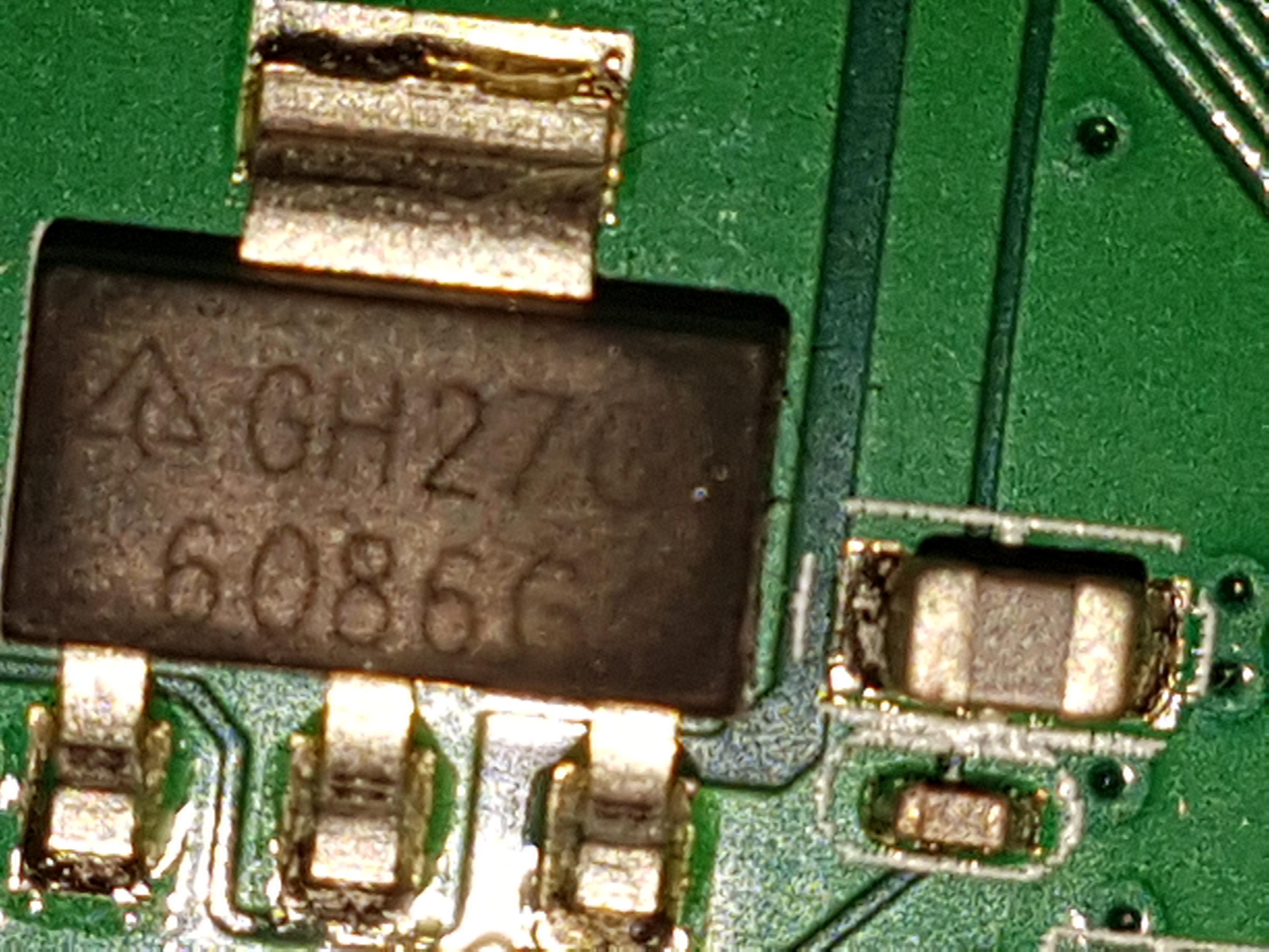

Soniq E40W13C-AU TV Stuck on standby
  • citymorgue2
    replied
    Re: Soniq E40W13C-AU TV Stuck on standby
    So stupidly I tool my flatmates word for the tv being the right model but it isn't.
    It's a s70uv16A-AU. The board is understandably different so I need the correct chip. All the chips on this board have the same number 117 6H3H
    Leave a comment:
  • citymorgue2
    replied
    Re: Soniq E40W13C-AU TV Stuck on standby
    Originally posted by lotas
    Look at the photo
    Weird. Last night I could access that picture. Thanks.
    I can't make out the details but I'm assuming the existing chips will be marked and it's an easy swap. Guess I'll find our tonight when I open it up.
    Leave a comment:
  • lotas
    replied
    Re: Soniq E40W13C-AU TV Stuck on standby
    Originally posted by citymorgue2
    Sorry but didn't someone post a picture of the motherboard that showed where
    BM1117-ADJ and ams1117 adj chips go?
    Look at the photo
    Leave a comment:
  • citymorgue2
    replied
    Re: Soniq E40W13C-AU TV Stuck on standby
    Sorry but didn't someone post a picture of the motherboard that showed where
    BM1117-ADJ and ams1117 adj chips go?
    Leave a comment:
  • jonmobrien
    replied
    Re: Soniq E40W13C-AU TV Stuck on standby
    Ok, so I need one of each.
    Does this order look right?
    And I can use this:
    https://www.ebay.com.au/itm/252948407124
    with wicking, solder and flux to replace them?
    Leave a comment:
  • diif
    replied
    Re: Soniq E40W13C-AU TV Stuck on standby
    Originally posted by jonmobrien
    Hi all, I have a Soniq 42” E42FV16A-AU with seemingly the same issue.
    I am a little confused between the differences between BM1117-3.3, BM1117-ADJ, etc and whether I would be ordering the correct part, compatible part, or completely wrong parts.
    None of my bits actually say 1117.
    I have a GH27G and a GH23H.
    How are these different? Exactly what parts do I need to order? Can I order 2 of one part or do I need two different parts?
    I can see on ebay BM1117-ADJ, AMS1117 3.3V, etc.
    Thanks!
    You need to look at the data sheet. The GH27G is 3.3V and the GH23H is ADJ
    Leave a comment:
  • jonmobrien
    replied
    Re: Soniq E40W13C-AU TV Stuck on standby
    Photos attached
    Leave a comment:
  • jonmobrien
    replied
    Re: Soniq E40W13C-AU TV Stuck on standby
    Hi all, I have a Soniq 42” E42FV16A-AU with seemingly the same issue.
    I am a little confused between the differences between BM1117-3.3, BM1117-ADJ, etc and whether I would be ordering the correct part, compatible part, or completely wrong parts.
    None of my bits actually say 1117.
    I have a GH27G and a GH23H.
    How are these different? Exactly what parts do I need to order? Can I order 2 of one part or do I need two different parts?
    I can see on ebay BM1117-ADJ, AMS1117 3.3V, etc.
    Thanks!
    Leave a comment:
  • rkn8677
    replied
    Re: Soniq E40W13C-AU TV Stuck on standby
    Hi I am Ranjit from Sydney. I wish to convey my sincere thanks to all especially BUDM for the advice regarding the volatage regulator ivBM1117Adj as my 48"Soniq was stuck into stand by. I was getting 5.1V at pin 3, 0.14 at pin 1 and 0.73V. at pin 2 which indicated that BM117 adj is damaged. I replaced it with LM117 adj which I bought from rs online and now the tv is working!!!!!!! Thanks to all again as this tv was first purchase of my daughter's first salary. All the best to all.
    Leave a comment:
  • attainteddragon
    replied
    Re: Soniq E40W13C-AU TV Stuck on standby
    awesome. these are a common failure, not just on these sets, but many others.
    Leave a comment:
  • tanihera
    replied
    Re: Soniq E40W13C-AU TV Stuck on standby
    Yer not wrong, dragon....I replaced the B1117-Adj and the TV is fixed. So the voltages on a working 32" TV are:
    Vin = 5.105v
    Vo = 1.5200 (fluctuates about 0.5%)
    Vref = is 0.2718v.
    Iin = Current into Vin = 176mA also fluctuating.
    Being mindful that the device could have been overloaded to damage it,
    I initially mounted the new one on a heatsink above the board with a 1ohm resistor in series with Vin. Boy, does the LM1117-adj get hot! There's quite a lot of headroom (Vin-Vo is roughly 3.5v) so I'll reinstate the device with a permanent 12ohm resistor in series with Vin to shed some of the heat.
    All good. Many thanks dragon, and other contributors to this thread!
    Leave a comment:
  • tanihera
    replied
    Re: Soniq E40W13C-AU TV Stuck on standby
    Fascinating post, thanks dragon - made me think. It provides the solution without answering my question. Most of my diagnosis is by what things "should" be, only rarely by what things mustn't be.
    On the device in question Vref=Vo-Vj is never 1.250v, so it's faulty, done. The panel led stays red no matter what, yet Vo and Vj are fluctating as if there's somebody at home and the set is trying to start.
    I've just ordered some LM1117-ADJs from RS. Many thanks for your quick response!
    Leave a comment:
  • attainteddragon
    replied
    Re: Soniq E40W13C-AU TV Stuck on standby
    any adjustable LDO regulator is 1.25v above the adjust pin. right hand pin looking from the legs is the adjust pin.
    Leave a comment:
  • tanihera
    replied
    Re: Soniq E40W13C-AU TV Stuck on standby
    Many thanks to all for the great info on Soniq TVs.
    I have a Soniq E32W13A-NZ just come in, stuck in standby. Following this thread, the BM1117-adj Vo=1.422 seems suspicious but not convincing.
    The Vo resistor divider measures at 100Ω to gnd and 467Ω to Vo (with the BM1117-adj still in place) which would set Vo to 1.518V. No sign of heating or stress. So 1.422 suggests an error there, but is it enough to stop the TV coming out of standby?
    Can anyone tell me what the output voltage of the BM1117-ADJ should be?
    Leave a comment:
  • andif
    replied
    Re: Soniq E40W13C-AU TV Stuck on standby
    Originally posted by GSXRJeff
    Hi all, digging up a bit but having same issue as thread poster.
    Soniq E40W13C won't turn on. Limited troubleshooting tooling so i want to replace this BM1117-3.3 with the AMS1117 from above...
    Will advise when done if it helps or not...
    Hey Jeff, any luck ?
    Leave a comment:
  • andif
    replied
    Re: Soniq E40W13C-AU TV Stuck on standby
    Originally posted by ausvantage
    The tv I picked up was stuck in standby . I replaced the same voltage regulator as described above. The type I replaced it with was ams1117 adj ht2438 got about 10 of them delivered for $3 .
    Tv works perfect now no other issues at this stage. If anyone needs these regulators I have many spares.
    Thanks immensely to the above contributors that made this fix easy.
    Cheers
    Hi do you still have some spares? Just got the TV from my neighbour havent opened it yet, same problem so im guessing same fix. Thanks
    Leave a comment:
  • GSXRJeff
    replied
    Re: Soniq E40W13C-AU TV Stuck on standby
    Hi all, digging up a bit but having same issue as thread poster.
    Soniq E40W13C won't turn on. Limited troubleshooting tooling so i want to replace this BM1117-3.3 with the AMS1117 from above...
    Will advise when done if it helps or not...
    Leave a comment:
  • sidds
    replied
    Re: Soniq E40W13C-AU TV Stuck on standby
    Originally posted by ausvantage
    The tv I picked up was stuck in standby . I replaced the same voltage regulator as described above. The type I replaced it with was ams1117 adj ht2438 got about 10 of them delivered for $3 .
    Tv works perfect now no other issues at this stage. If anyone needs these regulators I have many spares.
    Thanks immensely to the above contributors that made this fix easy.
    Cheers
    Hi ausvantage,
    I need the AMS1117 - 3.3 and AMS1117 - ADJ and willing to buy from you. Please email me on sidkumca@gmail.com
    Thanks,
    Sidds
    Leave a comment:
  • synoptica
    replied
    Re: Soniq E40W13C-AU TV Stuck on standby
    Hi guys, just wanted to say thanks for posting all your troubleshooting and findings; I'm handy enough with a soldering iron but my diagnosis skills are limited to replacing components that look broken
    Replaced all three regs based on this guide, at a cost of $2.20 (with spares) from a TV that was found on the side of the road!
    Thanks again
    Leave a comment:
  • catsmail
    replied
    Re: Soniq E40W13C-AU TV Stuck on standby
    Mine is a E40W13C-AU with a similar issue. Tv turns on via remote or buttons no problem. Everything works for about 5 min then the red led turns off and it wont respond to the remote at all. Buttons on tv still work fine. Is this common? It was a "factory refurbished" jb hifi tv. Paid less than $200 for it and closest store is 1250kms away so not worth sending back
    Leave a comment:
  • Michael Long
    No Standby Light on Samsung UN65MU6300FXZA with Mainboard BN94-12440E
    by Michael Long
    I had a Dead Samsung UN65MU6300FXZA with Mainboard BN94-12440E
    Dead / No Power / No Standby Light results after power company had three
    consecutive power outages on/off/on/off/on/off after which TV was rendered unresponsive.
    After exploring the issue found Mainboard was the fault. Then with research on this site determined IC1604 was the suspect. The IC1604 is a surface mounted device (SMD) EEPROM, Winbond Model 25Q40CLSIP. A read on this EEPROM came back with all FF FF FF FF FF in all registers blank and empty of data. I had a spare mainboard with intact IC1604 and utilized...
    09-13-2022, 06:55 AM
  • Loagz
    Soniq S55V14B-AU Stuck in Standby
    by Loagz
    Hi, I'm hoping someone can point me in the right direction....
    I have a S55V14B TV and it suffered a board failure. Main board part number: 222-655036003-30. I couldn't find a board with the exact part number so I've used what looks to be the same board however the part number is slightly different. 222-655036002-30.
    After installing the main board the stanby light came back on, however it wont turn on. I spoke to Soniq Australia and managed to get a copy of the firmware but no service manual. They don't have one. I asked about the different part numbers but they...
    11-15-2021, 02:13 AM
  • samsonn
    Soniq S55V16A-AU stuck in standby
    by samsonn
    I've got a 55" Soniq LED TV which is stuck in standby mode (initiator LED on, but no picture/sound/backlight). It will intermittently start working again for a few days or weeks, but it has been months since the last time it turned on. I've seen a lot of similar issues with Soniq TVs that were fixed by updating the firmware, but I need to turn it on to update the firmware so no luck there.
    I've taken the back off and visually inspected it but everything looks fine. No exploded capacitors or signs of overheating etc. All of the 1117 regulators on the main board were outputting...
    06-28-2020, 02:33 AM
  • noinimod
    Sony 55X900E no standby light, no power. Replaced mainboard already
    by noinimod
    No standby red light, nothing
    This Sony has a separate AC->DC power adapter supplying 19.5V to the TV power board (JK3)
    Disconnected JK3 power board from main board, checked voltages on all the pin outs
    At a few pins I can see the power supply providing 19.5V to the main board
    Based on the service manual triage.. it seems to be pointing towards the power board (JK3) being the most possible culprit
    LED light turns on when I disconnect LED driver board ribbon from mainboard (so i thought it is the mainboard,...
    12-22-2021, 12:58 AM
  • Stunt
    Hp Laptop Stuck on Hp protected by hp sure start screen
    by Stunt
    Hi guys i've got an Hp laptop Zbook 17 g5 Stuck on Hp protected by hp sure start screen.
    I have tried almost every bios available on various platforms about this laptop but the problem is still the same.
    I even successfully build my own bios using the one from the Hp website but the problem the laptop still getting stuck there.
    Even if i try to press Esc key nothing happens. I tried f10 it doesn't go to bios still stuck there i just saw entering setup menu on the bottom left corner of the
    screen that's it and stuck there. I left it until the following day and i still...
    09-02-2025, 01:51 PM
