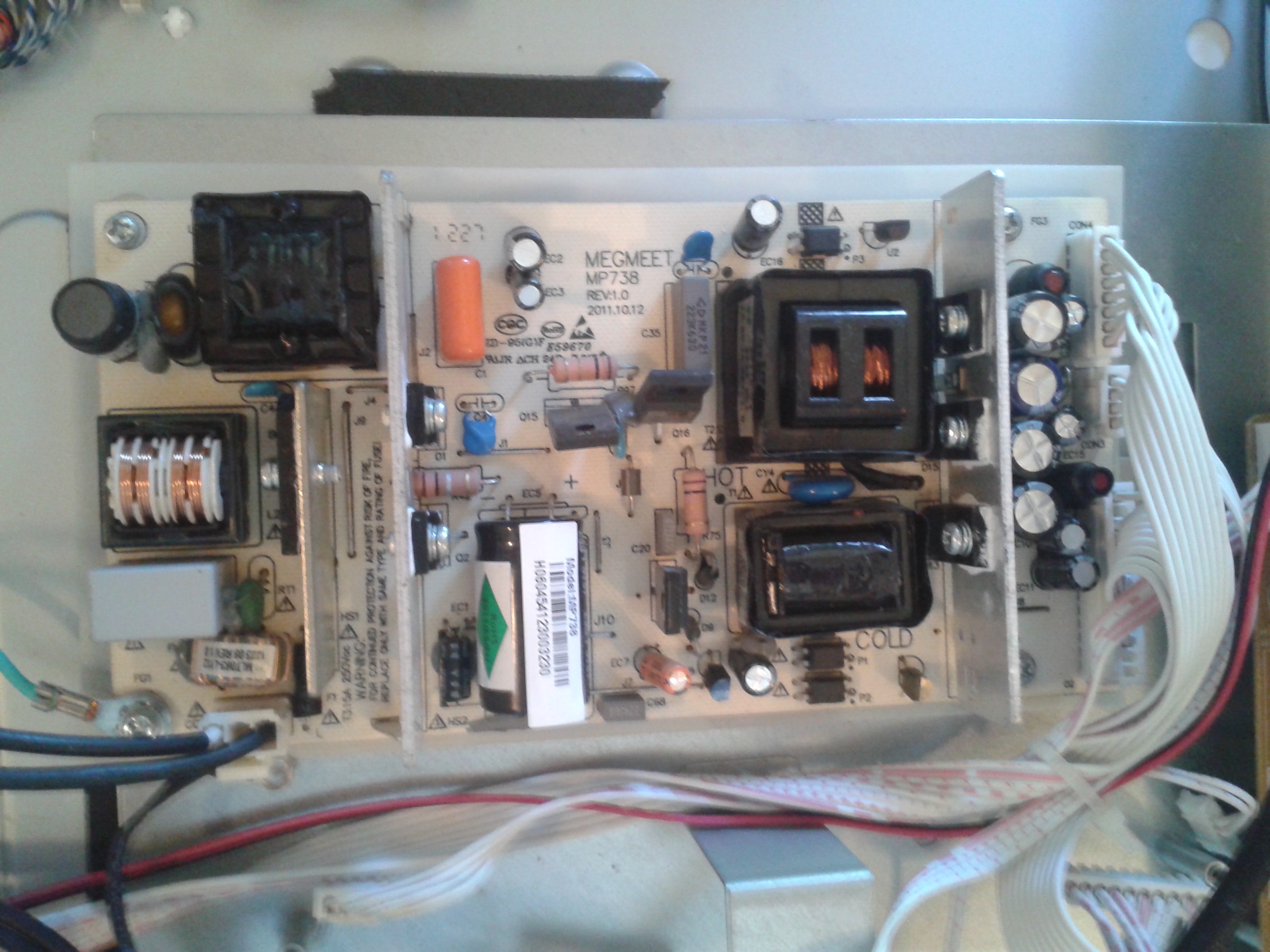

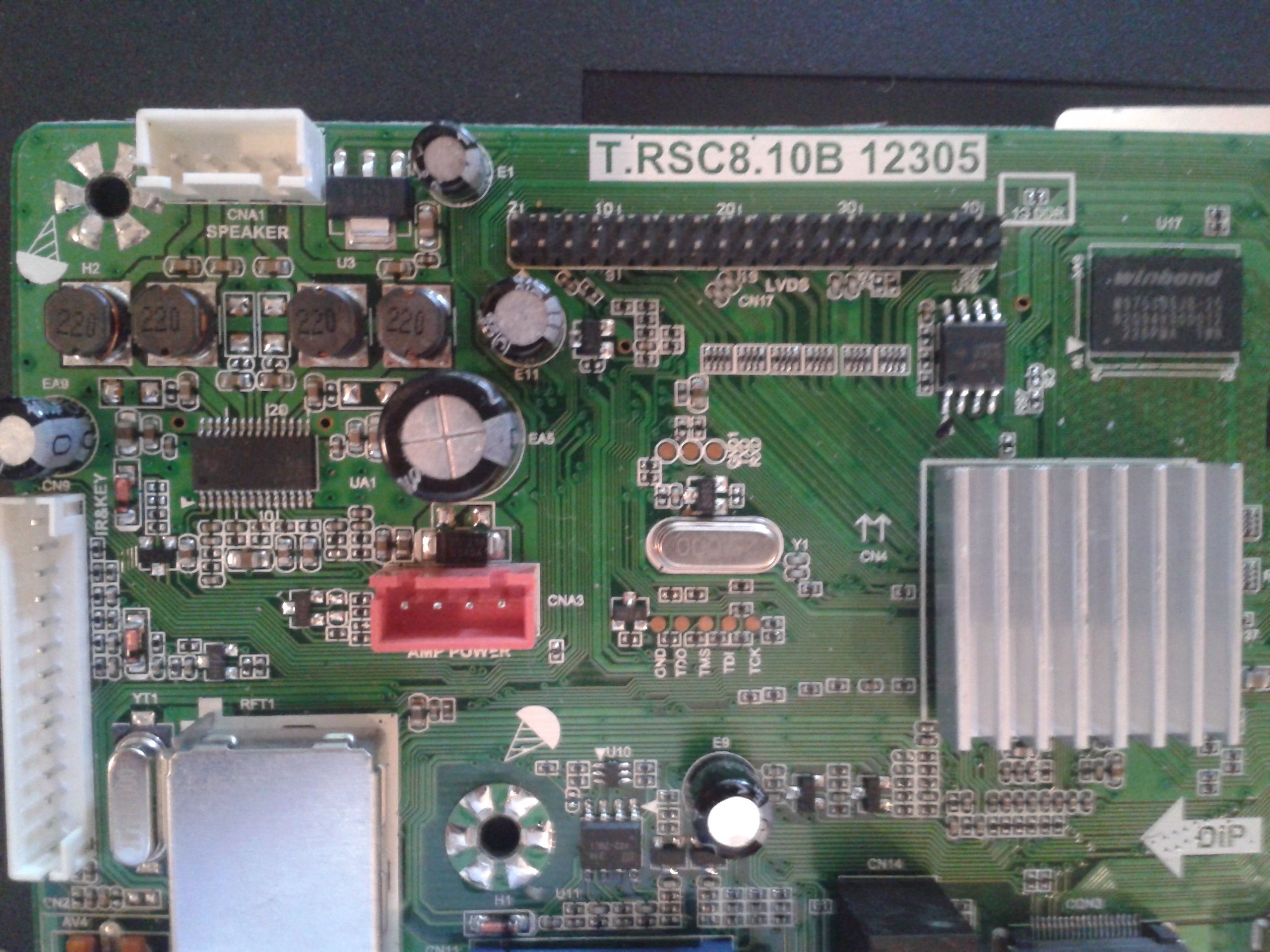

                I will get some pics of the main and power board. I am scared to remove the back again because they designed it pretty glitchy to remove, there is an odd wire which attaches from the built in DVD player to the main board and to the switch panel on the side of the TV, and it is very tricky trying to remove the back without damaging this wire.

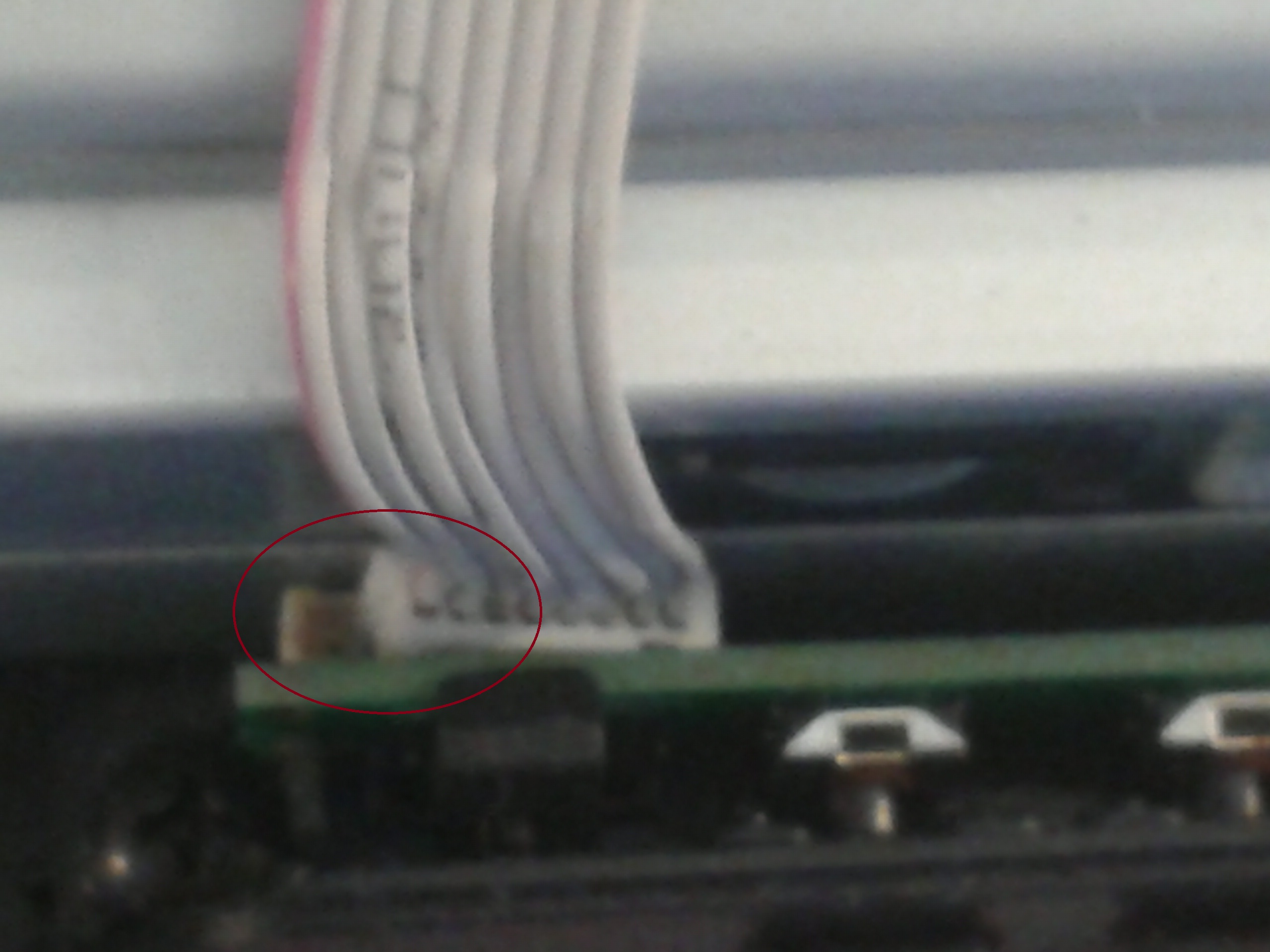

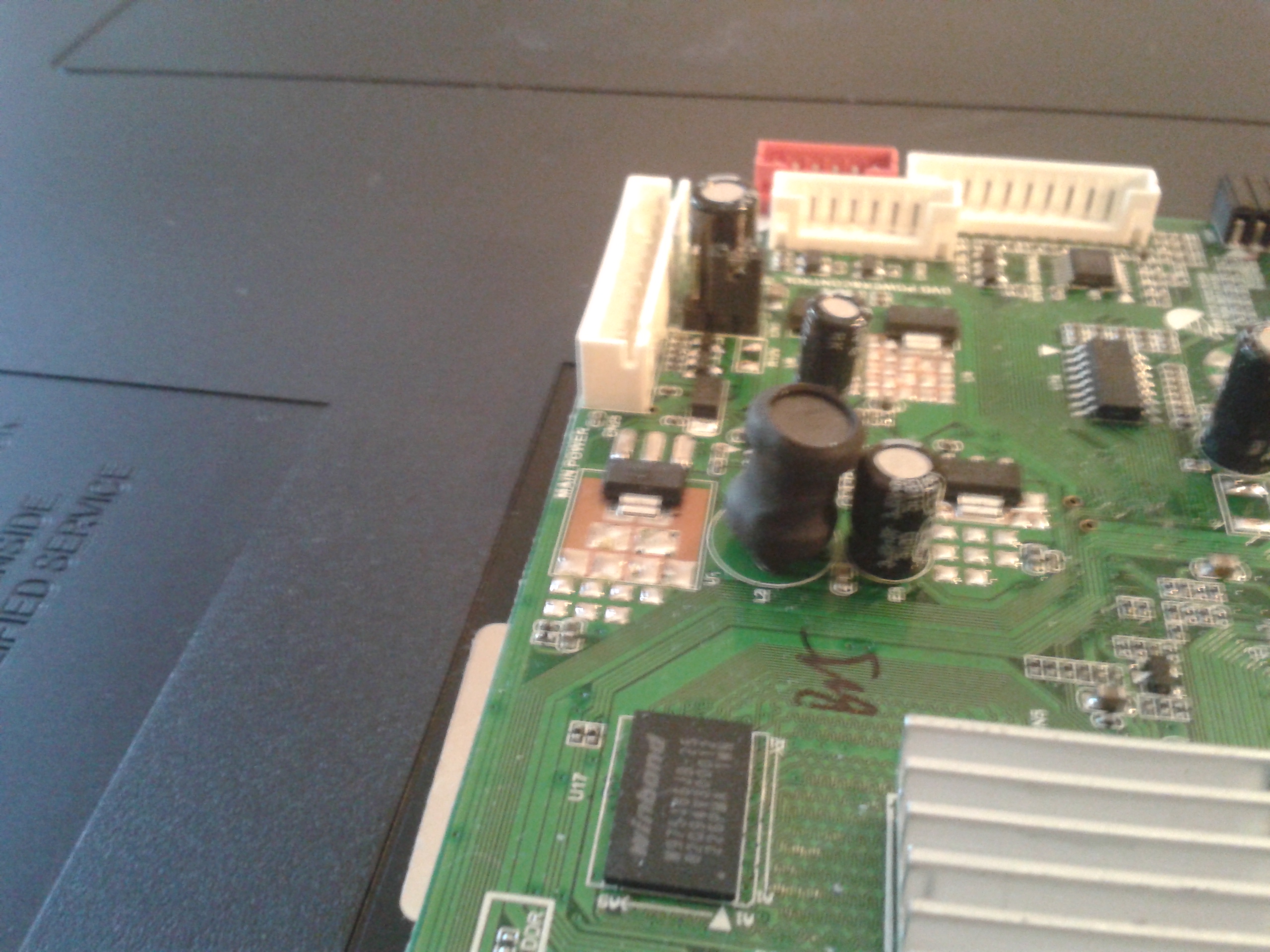

                      I noticed that this one big capacitor looked possibly a bit odd shaped and sort of bent over:

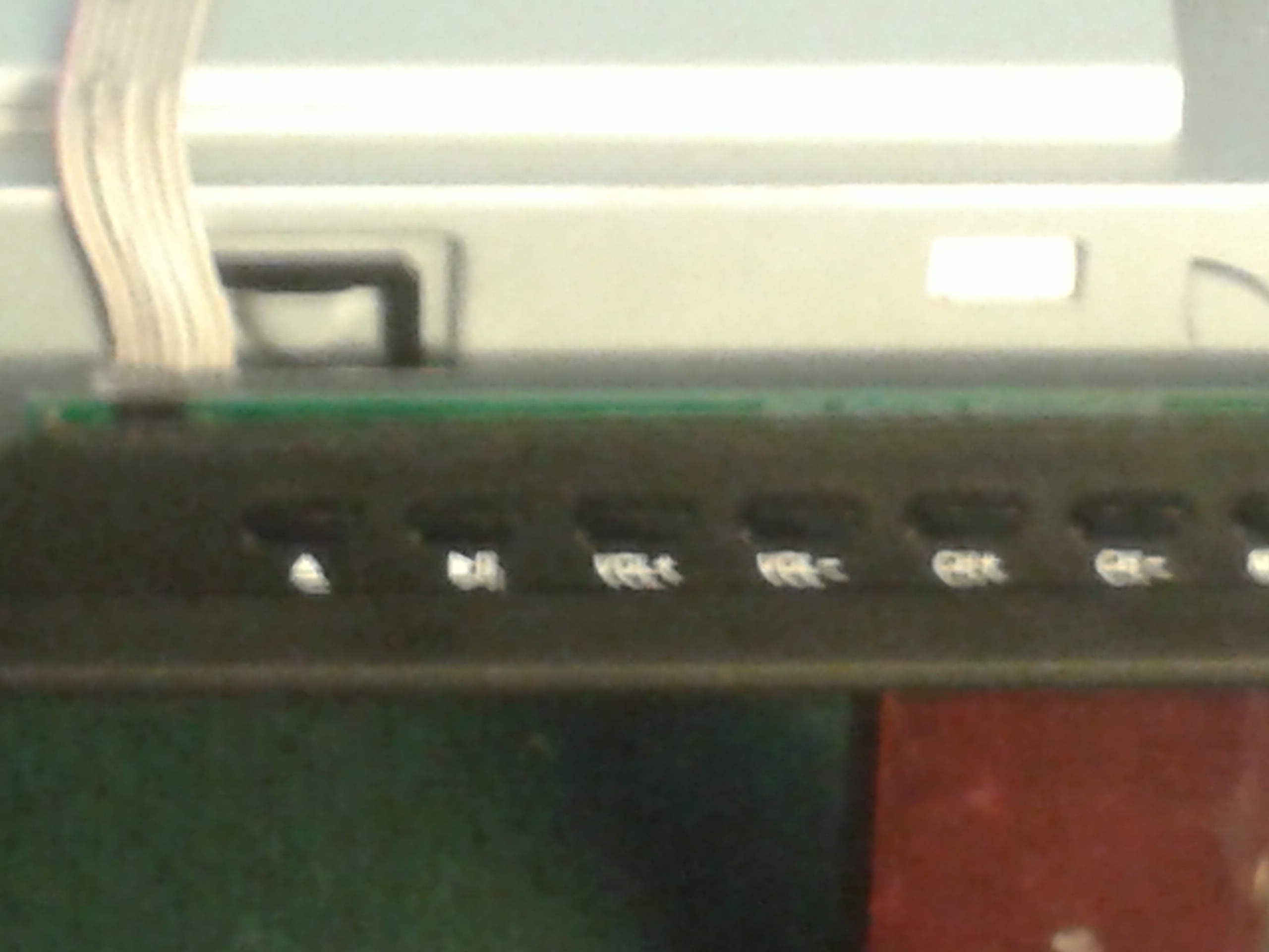

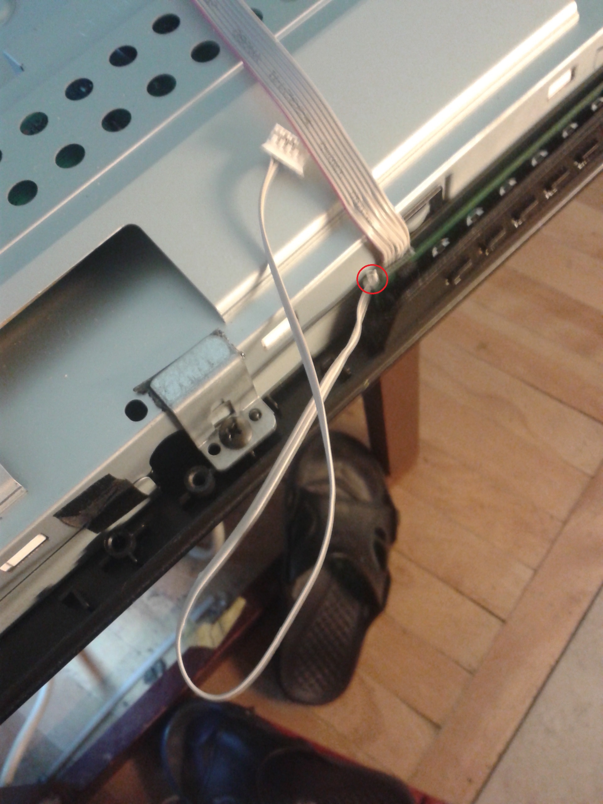

                      here is the damaged cable where it attaches to the switch panel on the side:
                      Here is a close up of the damaged plug, the yellowish part is where the left side of the cable
                      snapped off , this is the portion of the cable which connects over to the DVD player
                      here is the broken off portion , the part which connects to the DVD player resting where it used to attach (circled) inside the above cable plug (yellow portion above):

                          I am looking for a main board
                          t.rsc8.10b 12305 main board for an RCA 32" LCD TV RLCDV3282A-B with built in DVD player

                            try heating and cooling the main board. Maybe you find the problem, or at least know the area. If you had an oscilloscope you could see the ripple on the caps. Try reflowing the main IC (under that heat sink). If you have kept the other boards, you have a few candidates to try things on yourself.
                            Check the PSon signal from the main board to the PSU and see what happens ones the TV turns itself off. Does the PSon voltage go away?

                                  Post some hi resolution straight shot pictures of your main board and your power supply. Next you need a Digital Multi Meter to troubleshoot and we will tell you what to check for.
