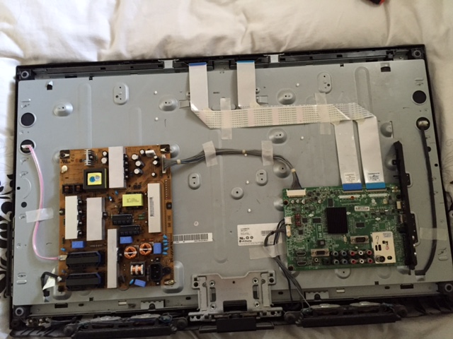

    I got my LG 32" LCD for couple of years now and out of the blue it went dead.
    it started by having from time to time image freeze with vertical lines, thought it's a bad caps issue, so I've replaced them all (see attached pics), after that it worked for couple of days and now it won't turn on at all, only the red light is blinking, I've used a meter and saw that the "power on" voltage is 3.5 instead of 20v (all others have ok voltage).
    Once TV is turned off it shows 0 volt and once on it shows 3.5V.
    what could be the issue?

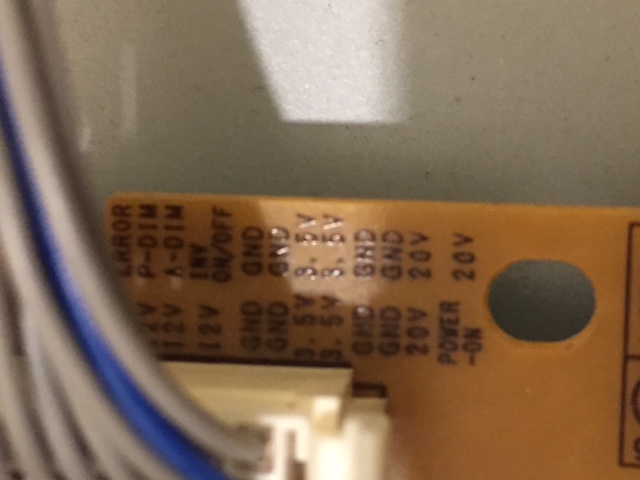

    The power connector is in a dual row configuration so one pin (the blue wire) is Power On and the other one next to it is for the 20v supply rail. The wires will be in the same physical layout as the names printed on the board next to the connector.
    A Power On signal voltage of 3.5v is normal, 20v would be very abnormal.

      Ok, so i've checked the one that says 'power on' but without voltage sign on it, I will try it on today.

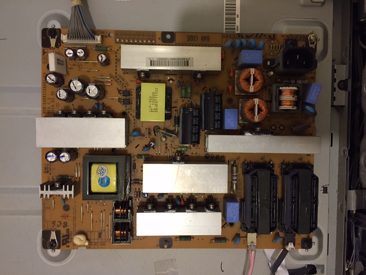

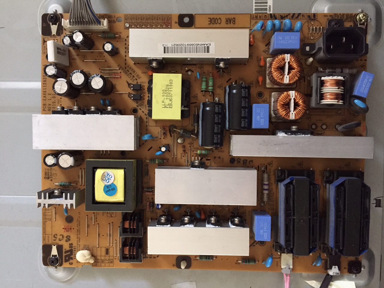

          The first thing to check is that the PFC circuit is working OK. Measure the voltage across one of the main filter capacitors (the biggest ones lying on their sides). You should use clip leads or test hooks if you can to connect your meter, and be very careful not to let the probes slip or your fingers get anywhere near them!
          With the TV in standby, you should see a DC voltage somewhat higher than your AC line voltage. When you press the power button, the voltage should rise to at least around 360v DC or so.

            I've measured the capacitors they are showing correct values.
            also verified all fuses.

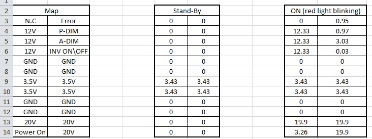

                Can you list all the output pins on the PSU by name and what voltage you measure on each of them, both when the TV is in standby and when you press the power button.
                  See attached pic.
                    Re: LG 32LD550 won't turn on - HELP!
                    Yo u have all the correct Voltages but the main board is not sending the INV ON/OFF command to turn on the backlights.
                      So what should be my next step?
