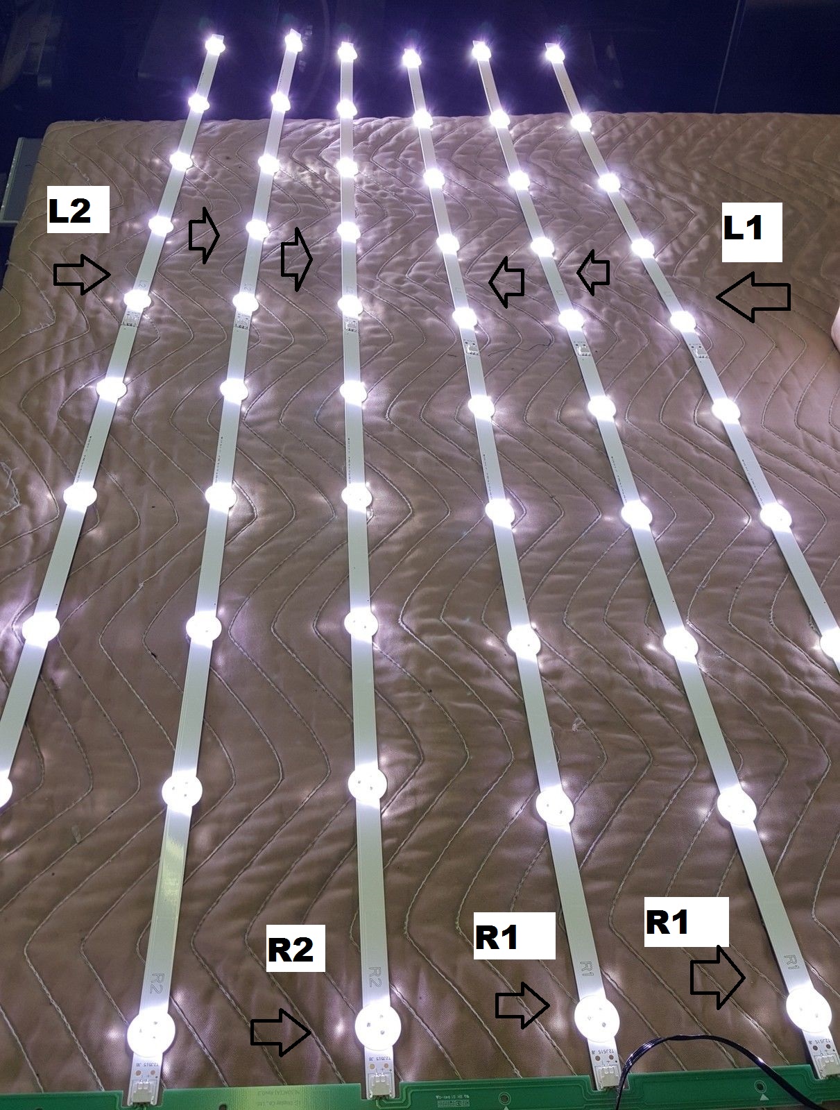

    With a little help from BadCaps folks, I've found that my tv has one or more LEDs faulty. I have bought a replacement set of LEDs, but don't have a clue how to replace the old with the new. I've asked the person who sold me the set, but can't get help that way. Is there anyone who has done this and can tell me what to do??? I have all the boards removed from chassis, all the screws removed that connect chassis to bezel, but pulling on the chassis to extract hasn't worked, and I certainly don't want to do damage to the panel, fragile that it is. For starters, I just want to connect the LEDs to the LED driver and see if all is well. Then I'll tackle getting the old out and the new in. But...the LED driver is apparently under the Chassis!!!

    Photos would help

      You can test the LED strips outside the LCD screen to confirm the problem is indeed the LEDs. you will need to connect the LED STRIPS as pictured
