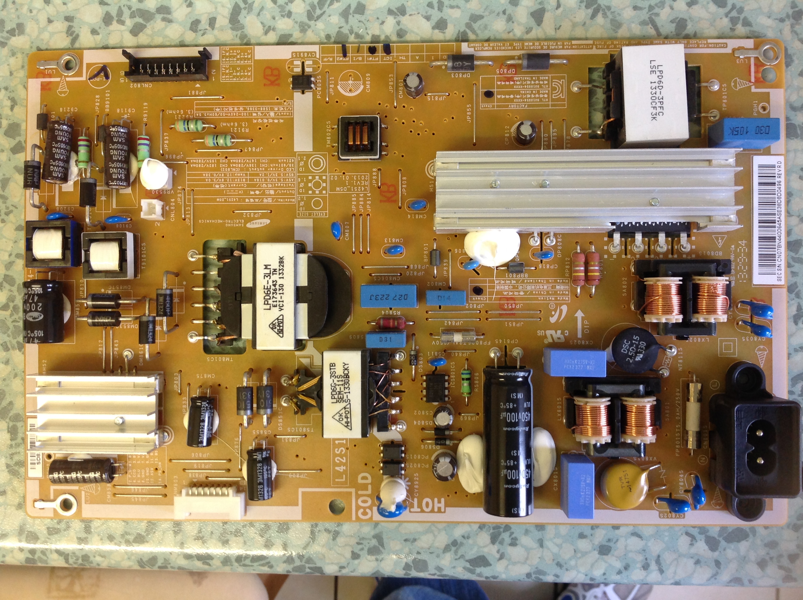

    ]Asking for help please, got a Samsung UE39F5500AK LED TV about 15 months old so out of warranty, when powering up front red led flashes 5 times then goes off, this happens several times, led light flashes in response to buttons pressed on remote , no sound or screen activity at all
    Quick check inside at power board nothing obvious and caps look ok, I do not have en esr tester, when testing powerboard for output voltages they all look to be there.
    I am now stuck any ideas anyone where I should be looking now, all help will be appreciated, thanks

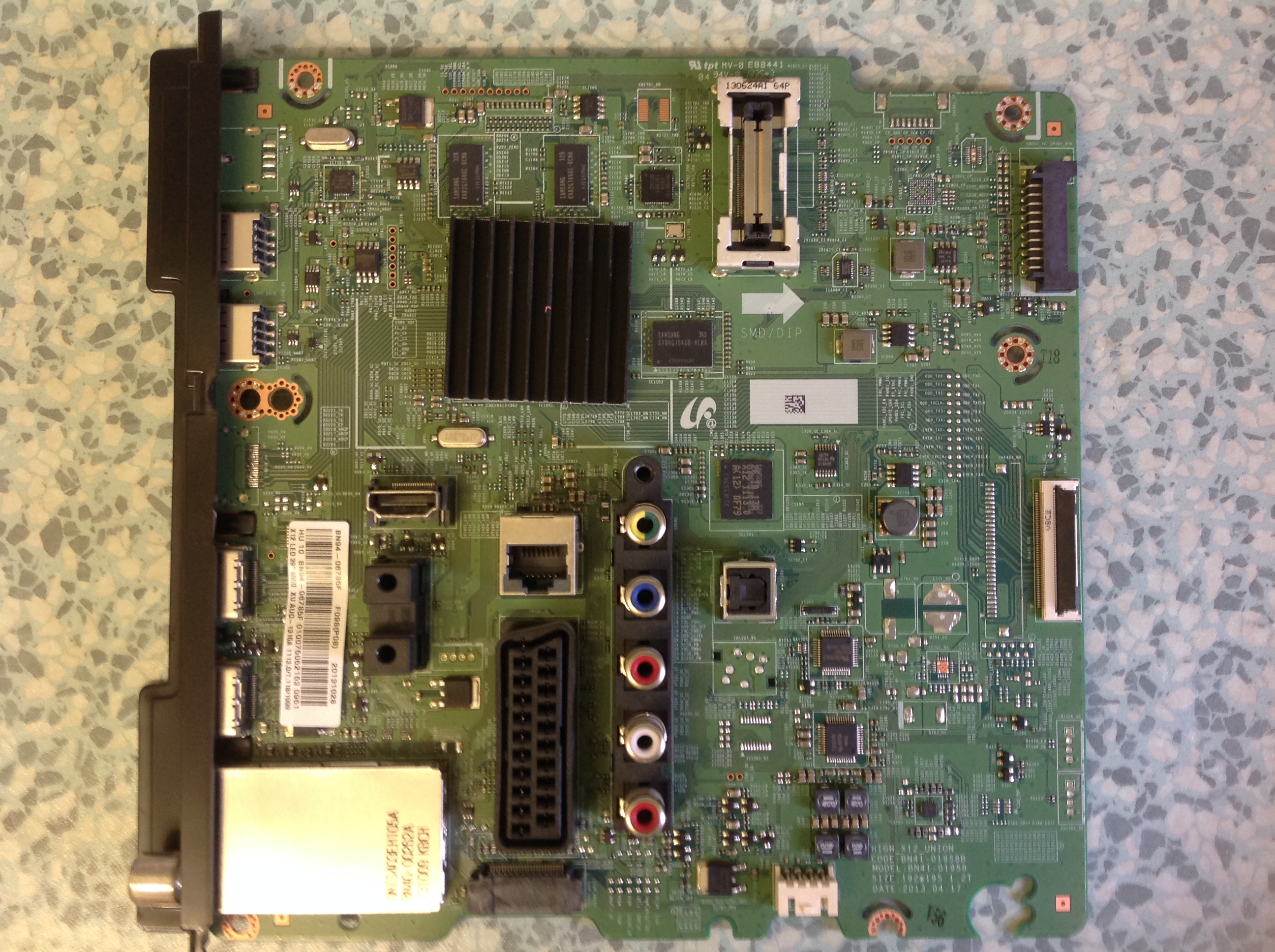

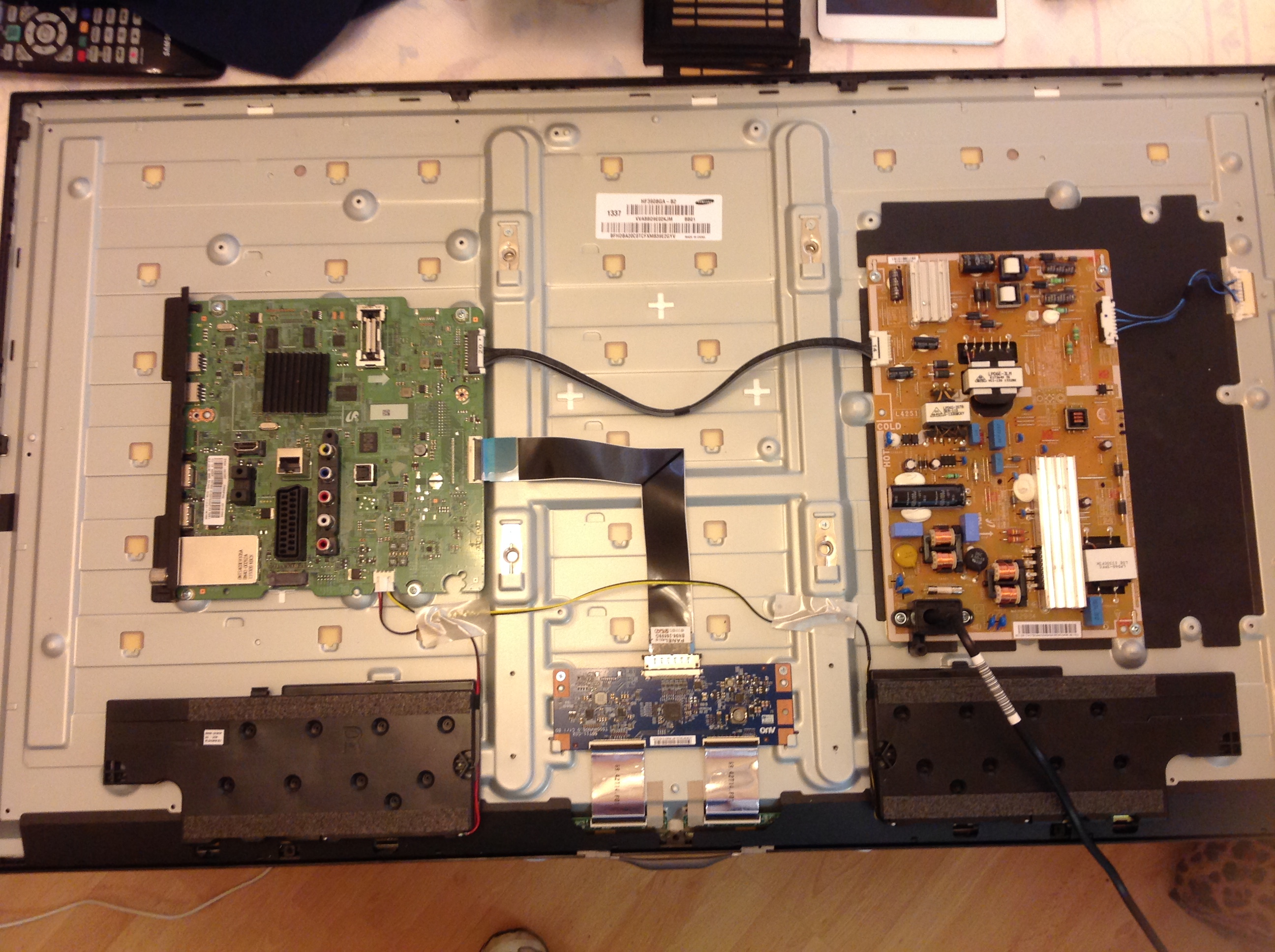

    Re: Samsung UE39F550 dead no sound or picture
    pics of UE39F5500AK

      If you unplug the main board do the backlights come on?
        will try now give me 5 mins
        • london-freddie
          • May 2015
          • 472
          YES backlight came on, is that good or bad

            Well it depends how cheap a new mainboard is!?
            However, It might just be a corrupt EEPROM or bad solder under the processor.
            What's the board number for the mainboard?
              The means the power supply and the backlights are OK, the main board is not sending the command signals to the power supply board.
              Try disconnecting the cable to the T-CON board and reconnect the cable between power supply and the main board then see what happen.

                it looks like BN94-06785F
                  tcon disconnected
                  NO backlight, no sound, flashing led
                    Bad mainboard.
                    Seems like quite an uncommon board.
                    Quite expensive, I can only find one being sold my emos for £45.
                    You could try a reflow of the board first.
