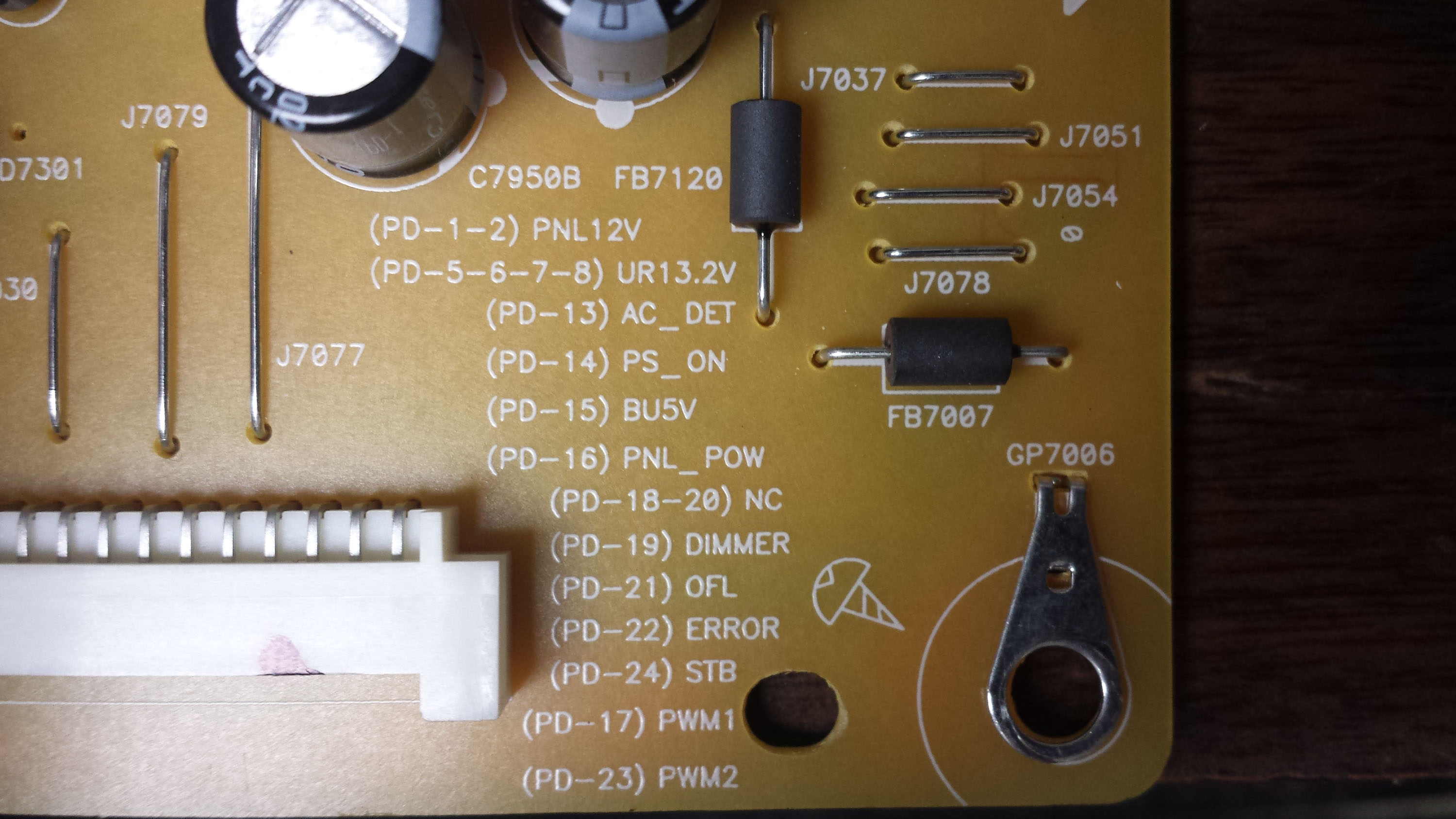

          Power supply has been removed and is ready for bench testing.
          I have attached a picture of the PD connector and pinout.
          I know that normally you can turn on a power supply by shorting the PS_ON and 5VSB pins. However this particular board does not have a 5VSB. It has a STB, which I assume is standby, but the adjacent pin to the PS_ON is BU5V.
          Before I proceed, which pins should I focus on shorting to get this powered up?
          Thanks.

            Bench tested the power supply board today.
            The pinout was in post #5.
            I connected Pin 14 (PS_ON) to Pin 15 (BU5V) which was the only pin that had 5v on it as soon as power was applied to the board.
            With a switch connecting Pins 14 and 15, I get no output voltage on any pin except for P13 (AC Det) which shows around 3.3v, and pins 14/15 which are both at 5v. (switched on)

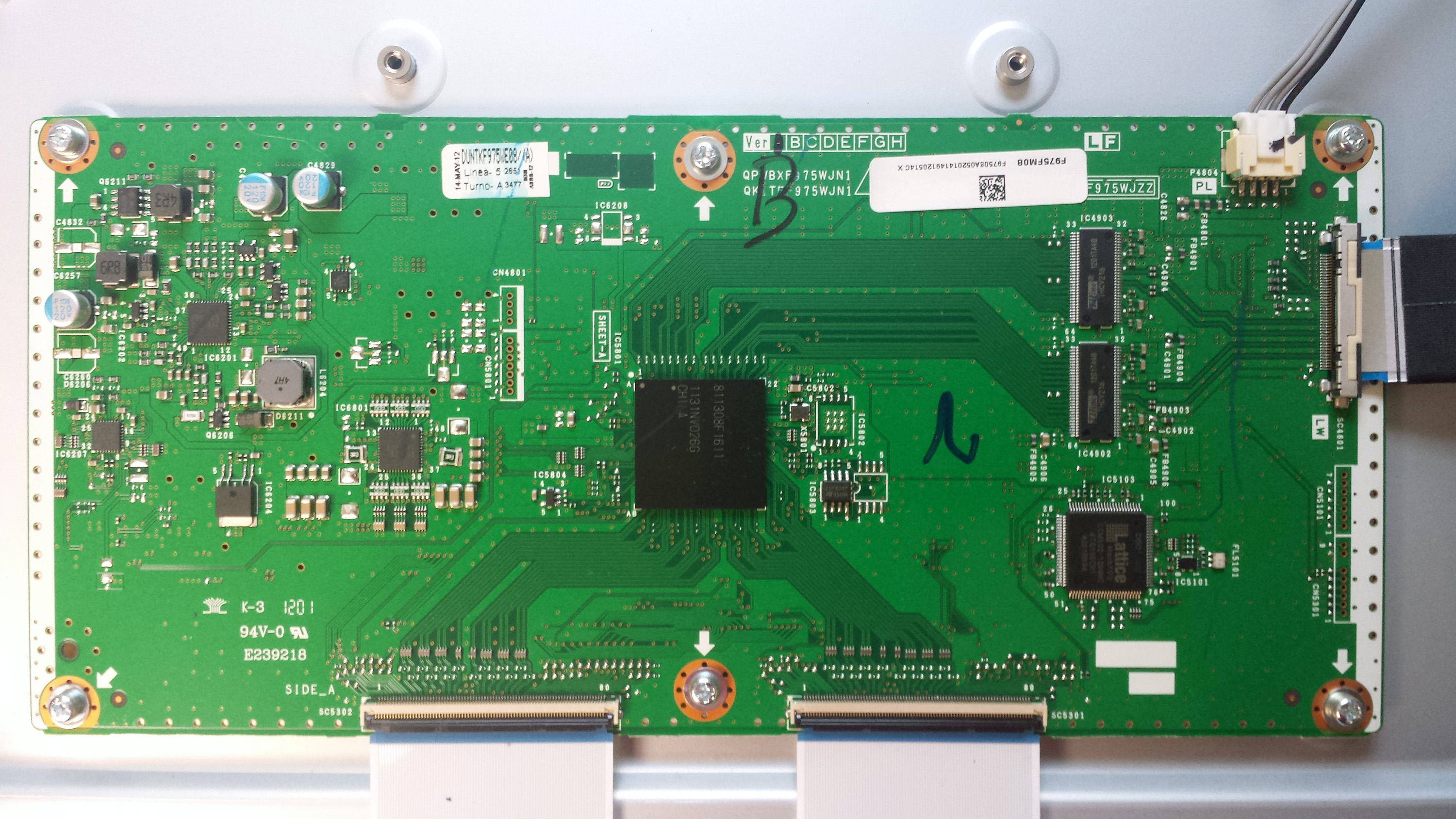

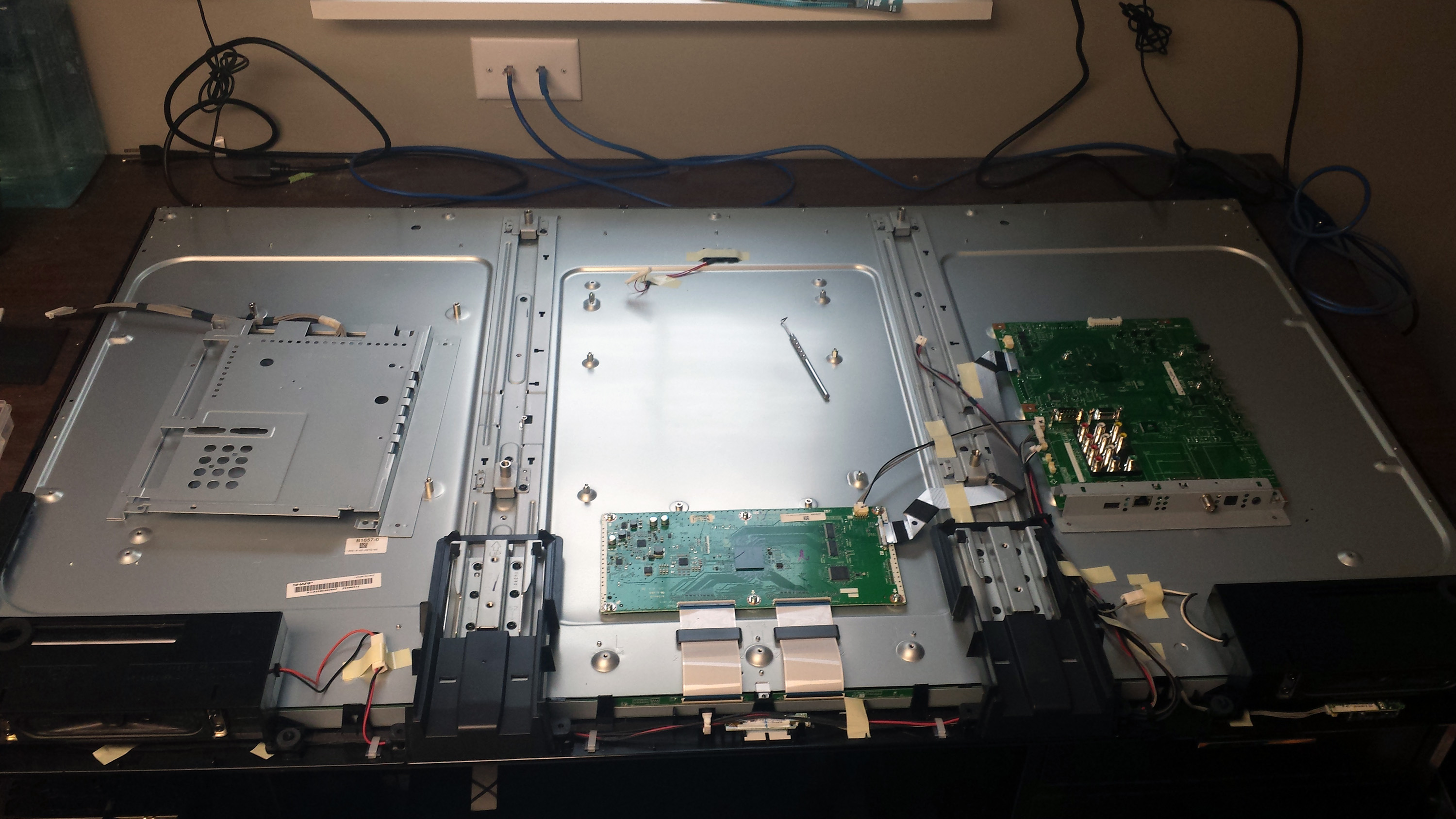

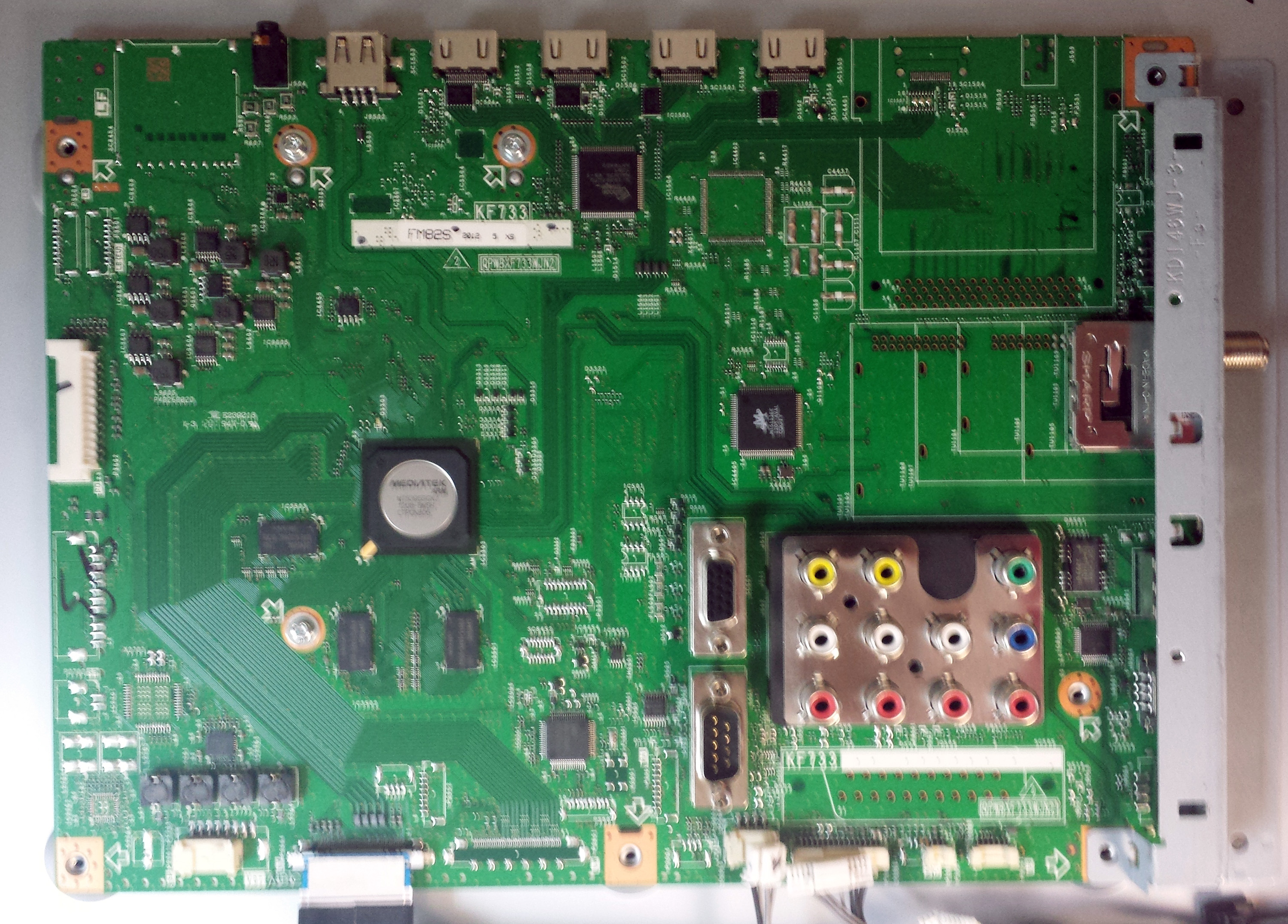

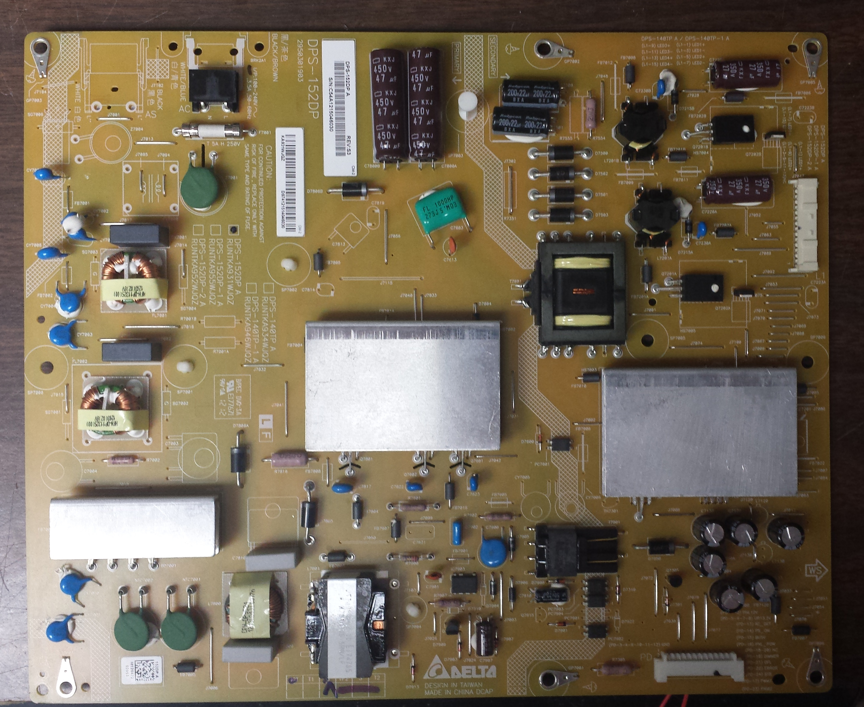

                How about showing good clear pictures of the whole back side of the TV so we can see all the boards, also the pictures of the whole boards?

                  Re: Sharp Aquos - LC-52LE640U - Power Supply Error
                  Check all the fat, hefty diodes D7806B, etc.
                  budm is right....send pix of whole boards.
                    Here are the pictures, as requested.
                    If you need a closer shot of anything, let me know.
                    Seen is the unit itself, the TCON board, the Main board, and the Power Supply / LCD Controller board.

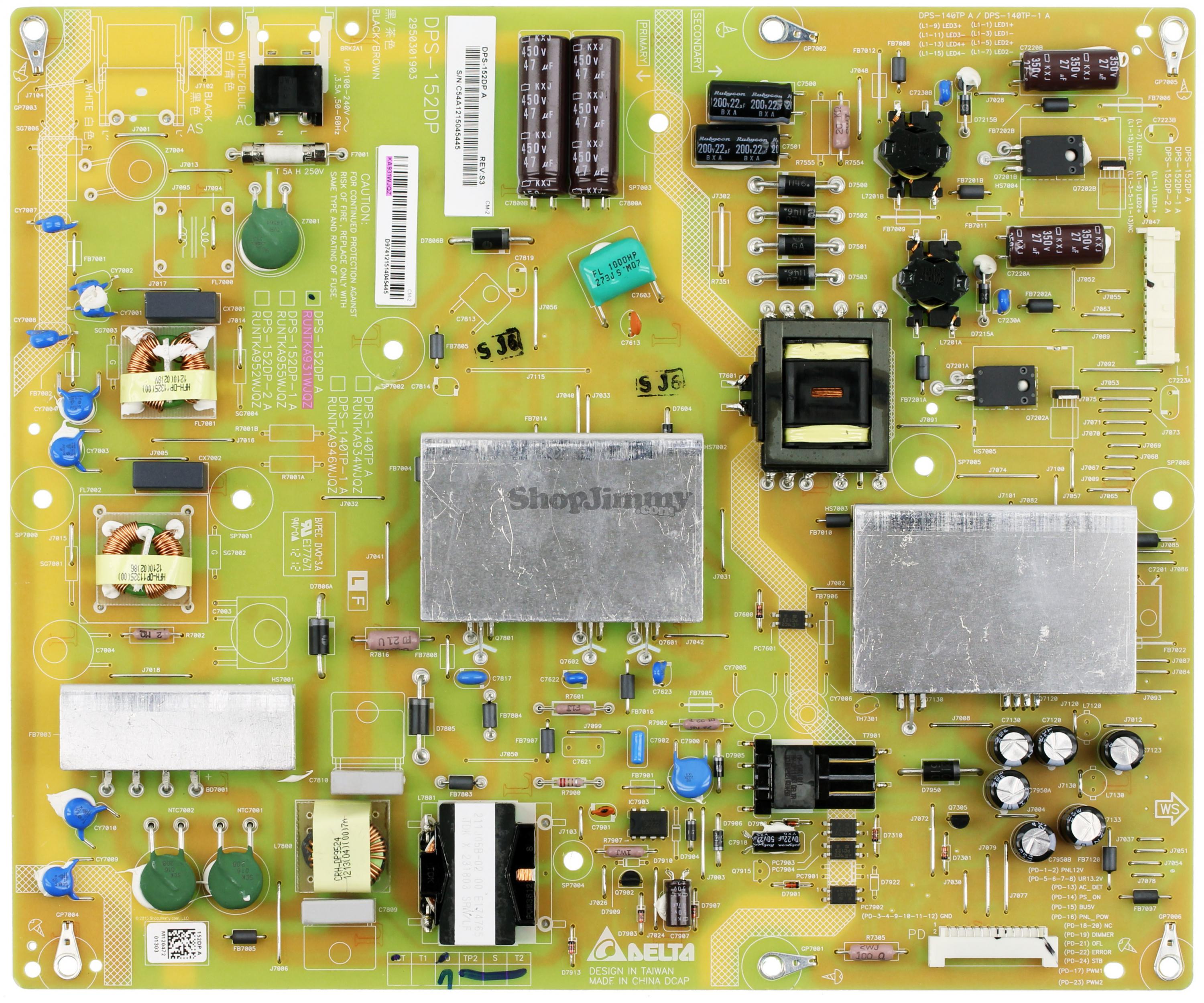

                        can you provide a better picture of the bottom left or the whole thing again of the power supply? I can't read anything, too blurry. The main board pic is blurry too.

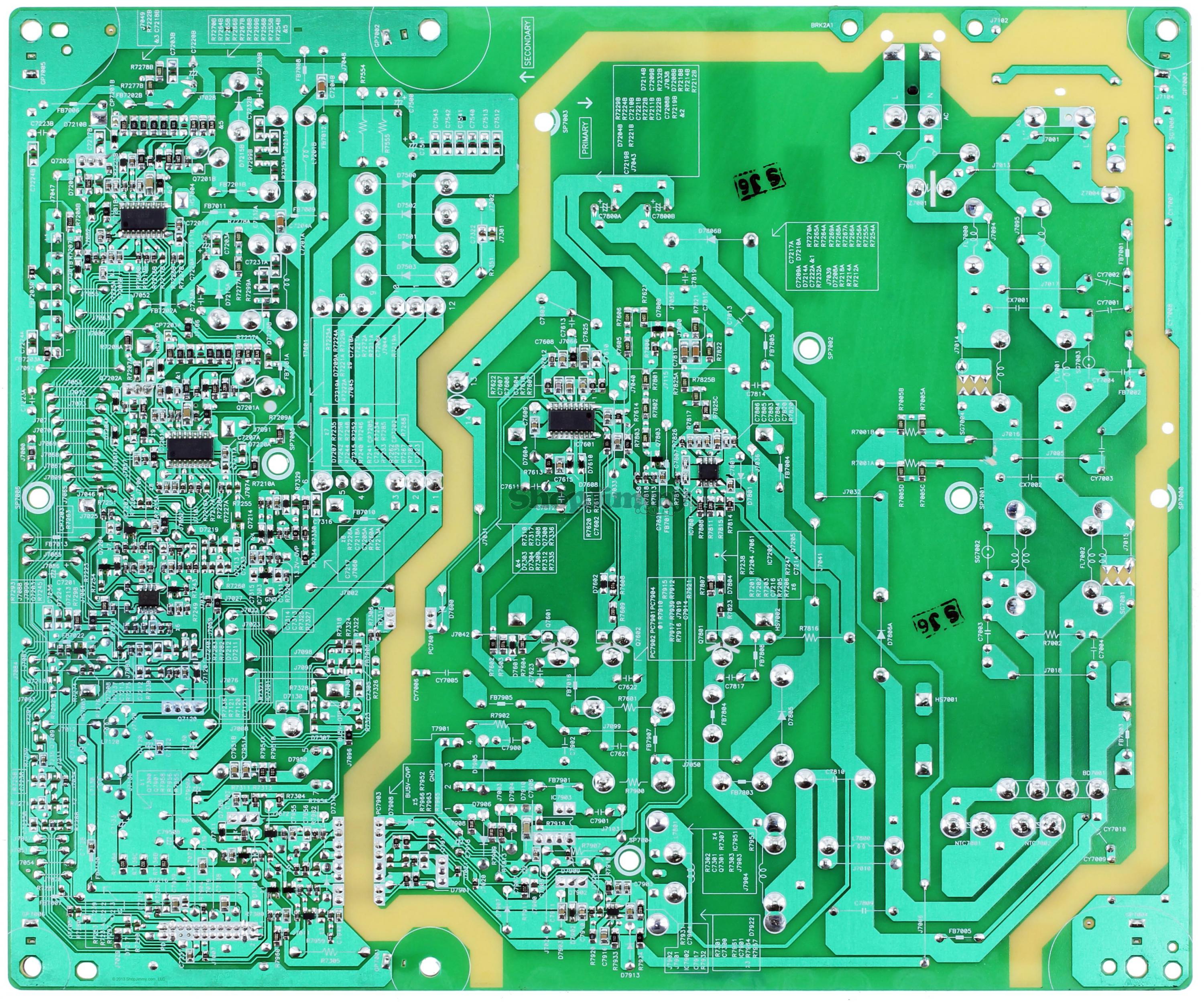

                          I will take some more photos in the morning and get them posted. I will use my other camera that will let me get closer.... boards may have to be shot in multiple pics to get the best resolution.
                            What DCV do you get between the two legs of those two main filter caps (47uF 450VDC) when you force on the power suppl? It should be more than 360VDC.
                            Pictures provided by shopjimmy.
                            http://www.shopjimmy.com/catalogsear...?q=LC-52LE640U
