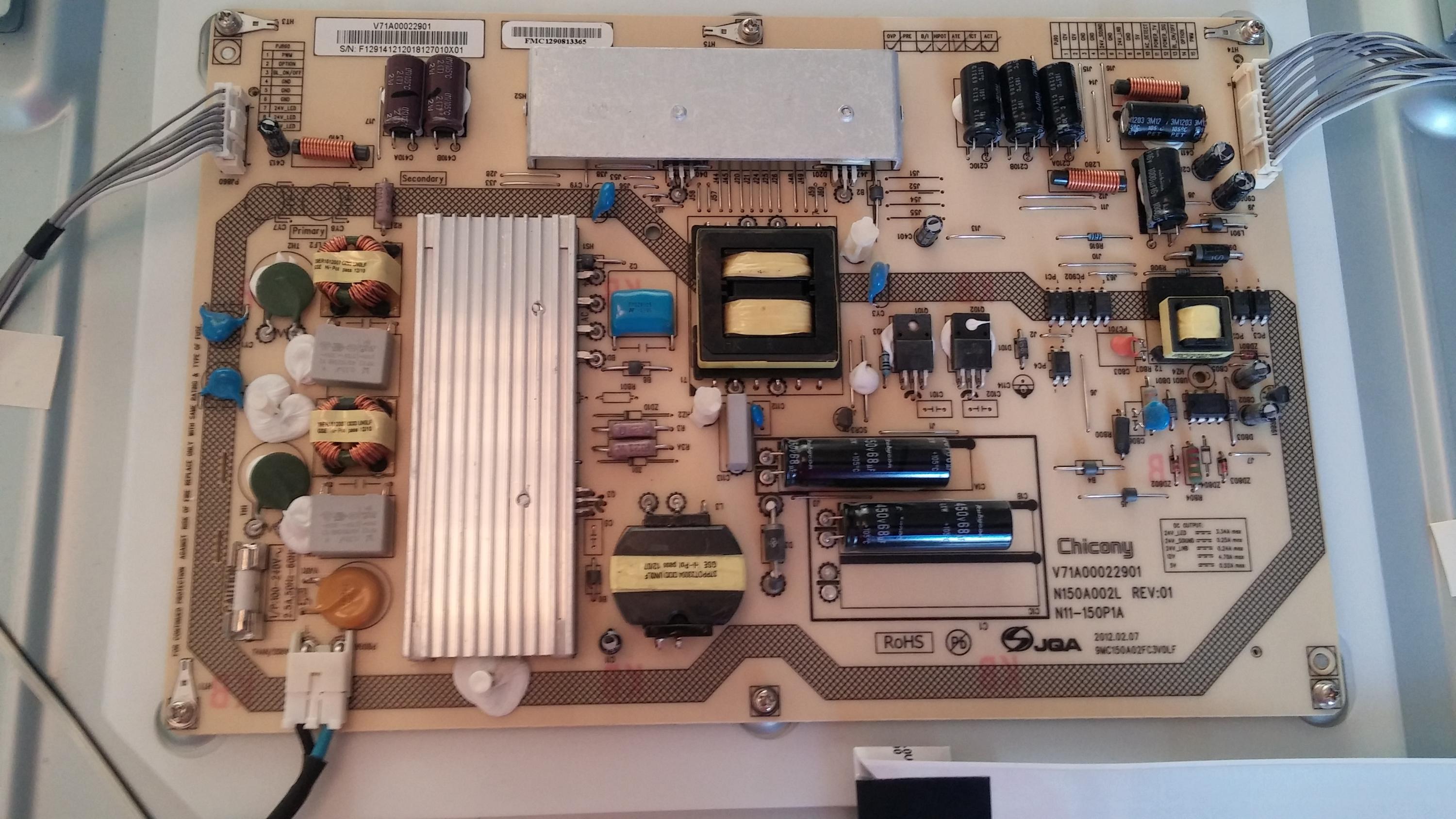

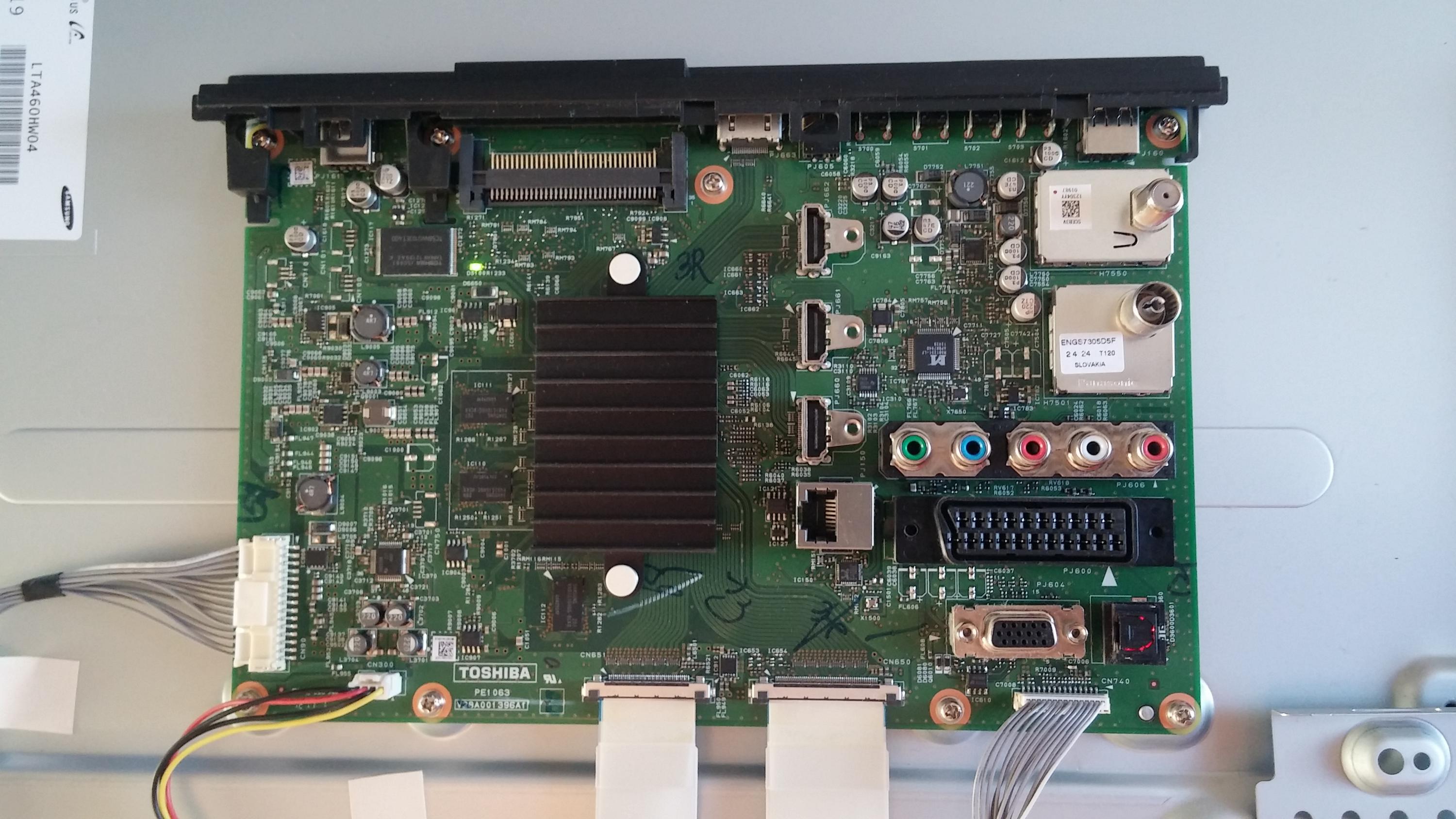

    Hi guys,
    Im Johny and I've got my father in laws broken Toshiba 46TL963B and learn how to play about with the insides.
    My skill level is basic at best. I have an analogue multimeter that I found in the wheel well of my car by chance, although I'm like Harry Potter when he first gets his wand, I can point it at things but have no idea of the consequences!
    The symptoms of the TV are as follows:
    When plugged into the wall, green power light on front of the TV is on, but thee backlights are not on and shining a torch at screen does not reveal any image (although this is hard to tell because I don't know what I'm looking for when TV boots up).
    Unsure if sound is working, again not sure how to cycle through inputs or if even any response from TV.
    With the back off, the main board has a green LED that is light constantly.
    I have read about firmware problems with Toshiba TV's, so downloaded the following files:
    TL_MBOOT_545609.bin
    TL_MFC_246009.bin
    46TL963K_587542_INIT_CLEAR.bin (where K has been changed to B to match model number)
    When plugging USB into TV and powering on at wall, orange indicator light comes on at front of TV as well as green light, and green LED on mainboard flashes on and off slowly.
    Orange light on front of TV goes out and green LED on mainboard flashes quickly three times then pause, and repeat ad finatum until TV is turned off at wall. I assume this is the TV failing to read the USB Drive as its an 8GB drive flashed as FAT 32 where it appears a 4Gb or less drive flashed as fat16 is required, unfortunately I haven't acquired a lower capacity drive yet (I did repartition as a smaller drive but still had the same response from TV)

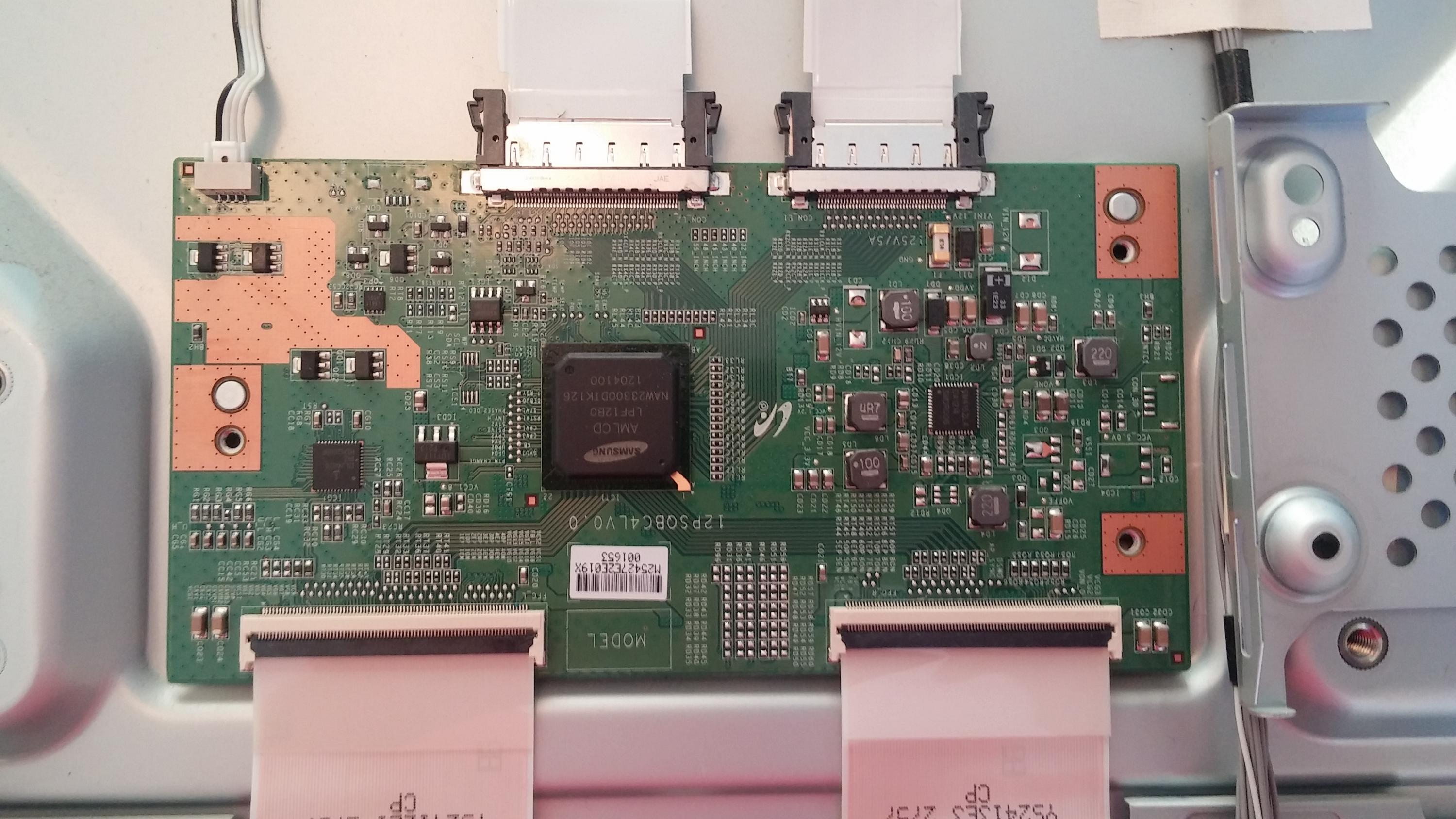

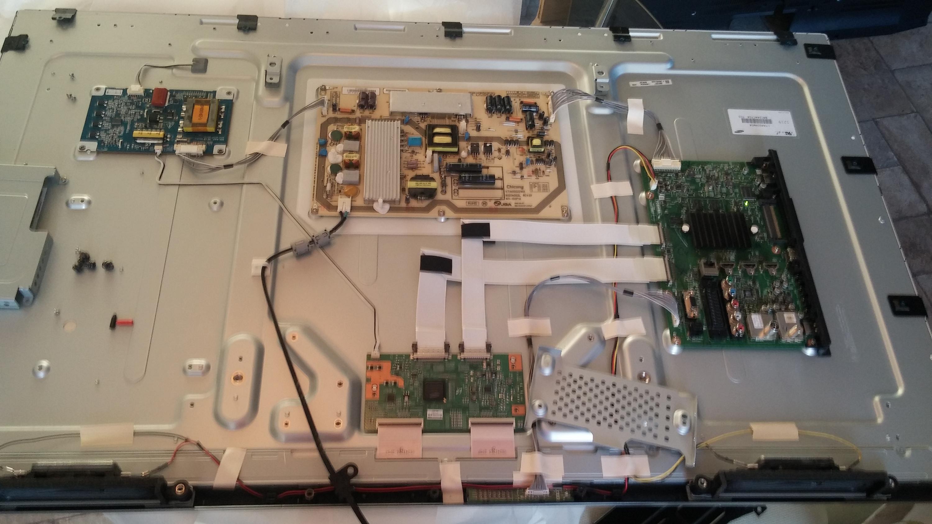

    Pictures of boards uploaded and attached
    I've tested the fuses on the boards (I think) and they seem to be okay (continuity with ohm thingy on multimeter? I googled that)
    I'm open to ideas and can follow basic instruction, which I may need spelling out for my untrained mind.

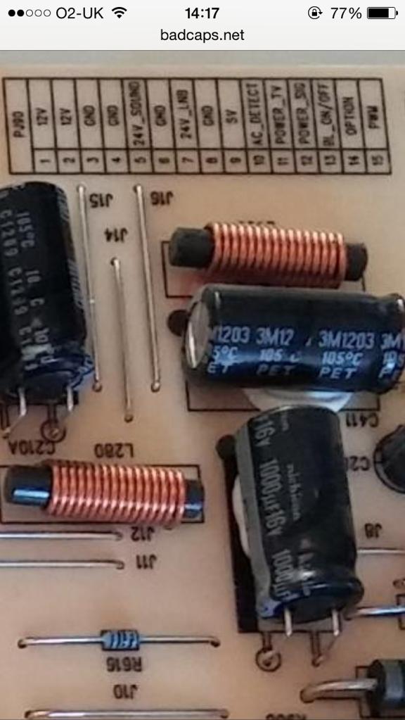

    Re: Toshiba 46TL936B No picture or backlight
    On the above connector monitor the voltage labelled power TV power_tv
    First check what the voltage is on standby then press the on button and see if the voltage changes.
        DC volts.
        Black: to chassis.
        Red: push the probe down the corresponding wire.
          Thanks Hamie,
          I pointed the multimeter at where you asked and it came back as 4V (or just under) unfortunately I cant seem to get the TV to go on standby, the green light on the front of the TV stays green

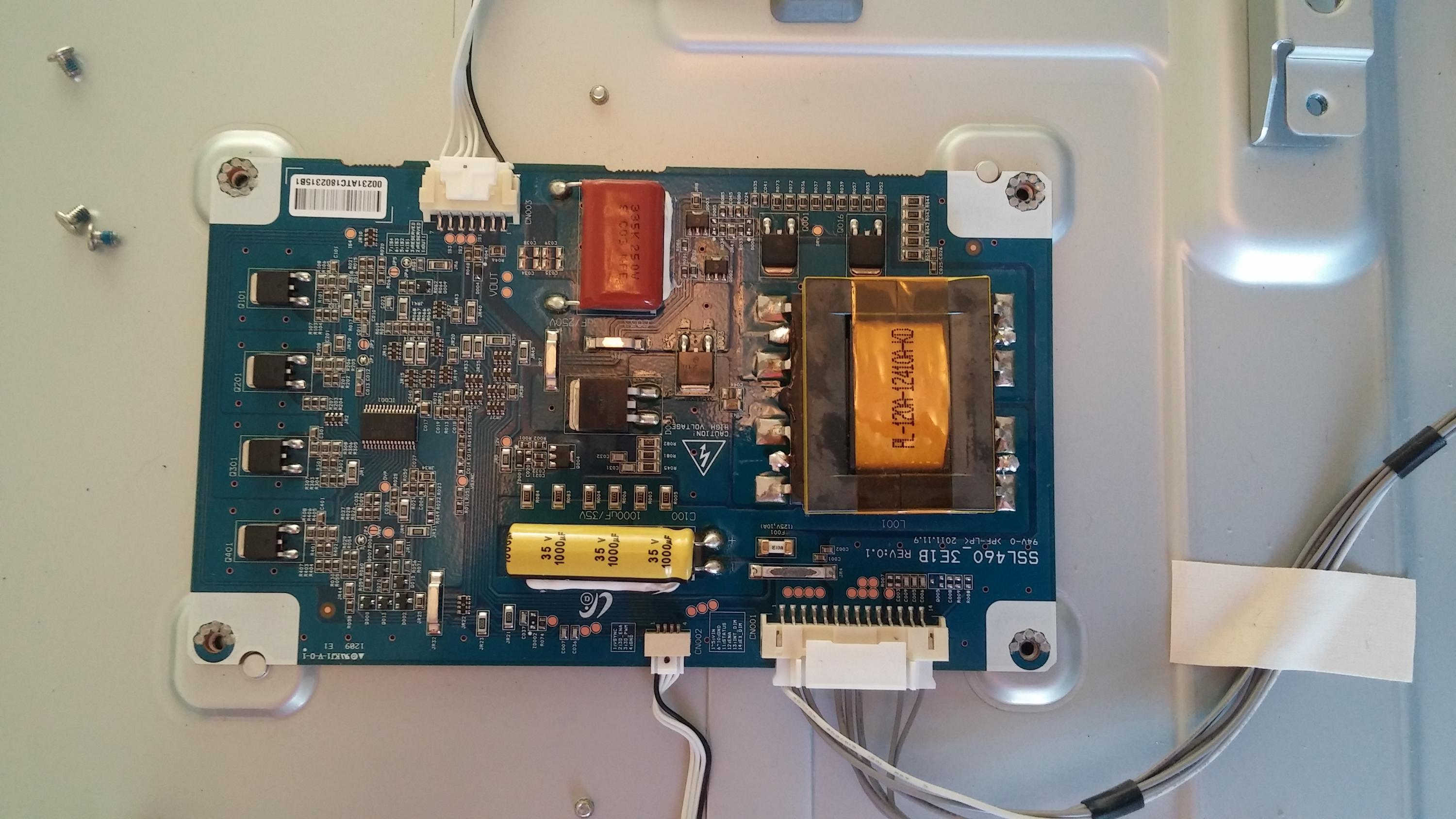

                          9 Pin connector from power supply to LED driver board
                          1- (PWM) 1V
                          2- (OPTION) 0V
                          3- (BL ON/OFF) 4.5V
                          4- (GND) 0V
                          5- (GND) 0V
                          6- (GND) 0V
                          7- (24V LED) 25V
                          8- (24V LED) 25V
                          9- (24V LED) 25V

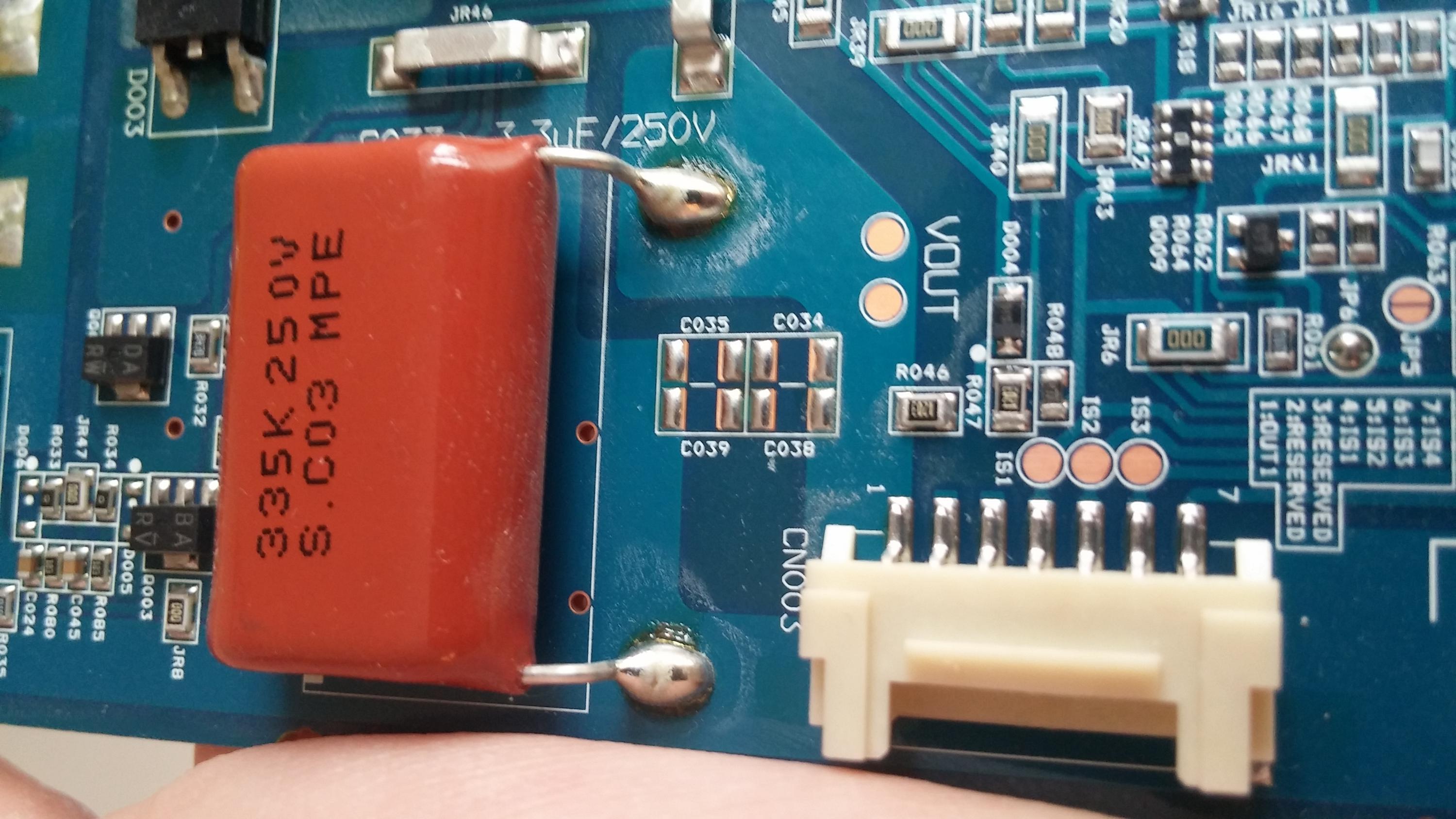

                          7 pin connector from LED driver board to somewhere in the chassis
                          1- (OUT 1) 6V
                          2- (RESERVED) 0V
                          3- (RESERVED) 0V
                          4- (IS1) 0V
                          5- (IS2) OV
                          6- (IS3) 0V
                          7- (IS4) 0V

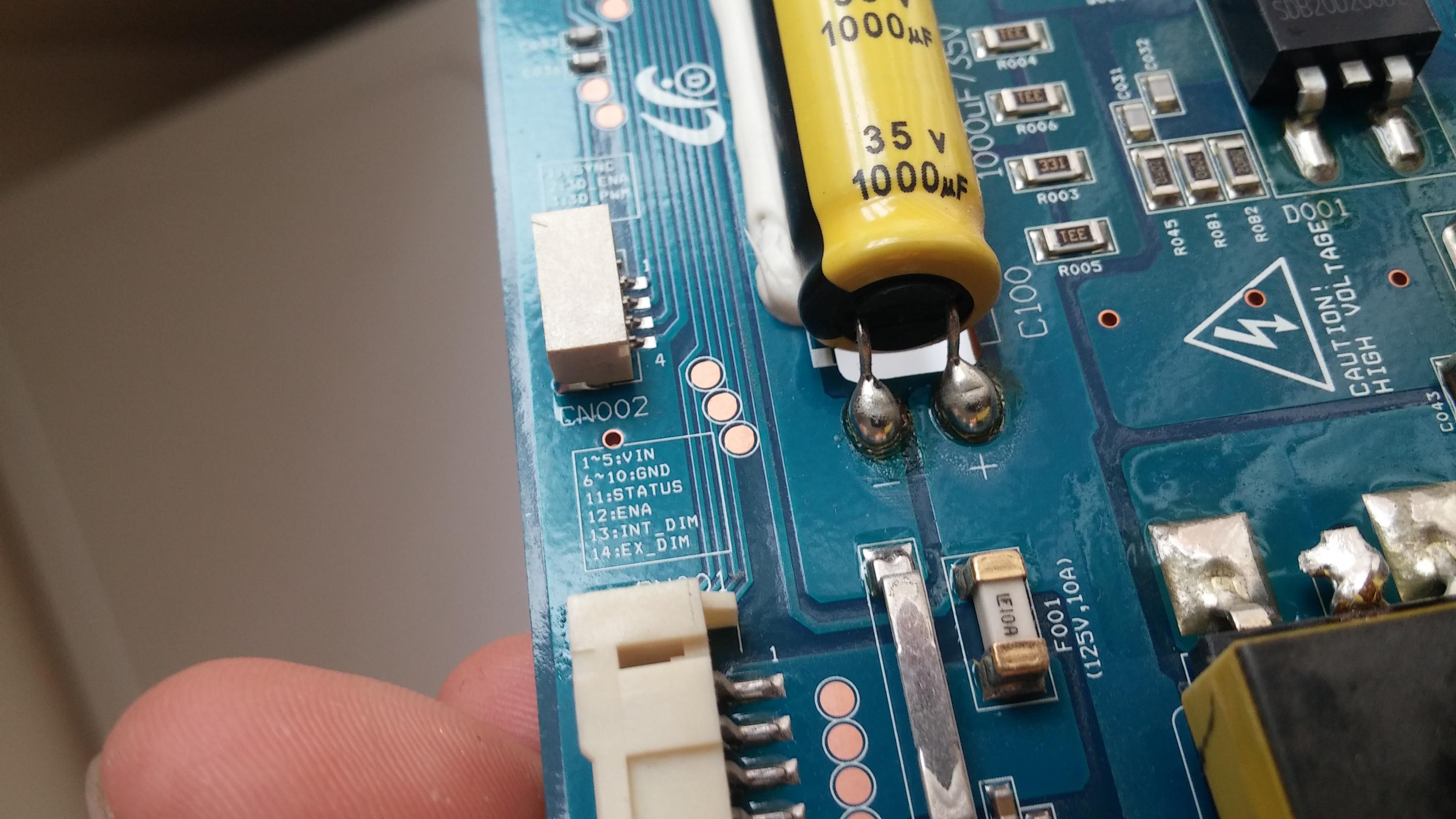

                            Another update from playing about after reading other threads.
                            Noticed that the connector with 15 pins is labelled differently at the point where it connects to the LED driver board, so disconnected the pin at the other side caleld EXT DIM and when turning on at the wall I had a brief flash of light from the backlight before turning off again. Did it a couple of times to see that it wasn't a fluke.
                            Took the readings from the 4 test points for IS1 to IS4 while turning on with the EXT DIM disconnected and got the following readings (not entirely accurate as only a brief reaqding before falling back to zero
                            IS1 - 20V
                            IS2 - 3V
                            IS3 - 20V
                            IS4 - 20V
                              That EXT DIM is the same as PWM, right now using your analog meter to check the Voltage at the LED connector will not work due to your meter is too slow, the output Voltage should spike to >100VDC and then drops down due to the shutdown circuit kicks in.
                              I will not be surprised if you do have bad LEDS.
                              http://s807.photobucket.com/user/bud...?sort=3&page=1
                              This one I had to disconnect the PWM and also set the analog dimming Voltage down (triming the analog dimming control line) to about 70~80% to keep the LEDs on, it will only run for a couple hours at full backlights, but at lower backlights it will run all day. The LEDs in this TV were not completely gone yet so it works, but if your are too far gone then it will not work.

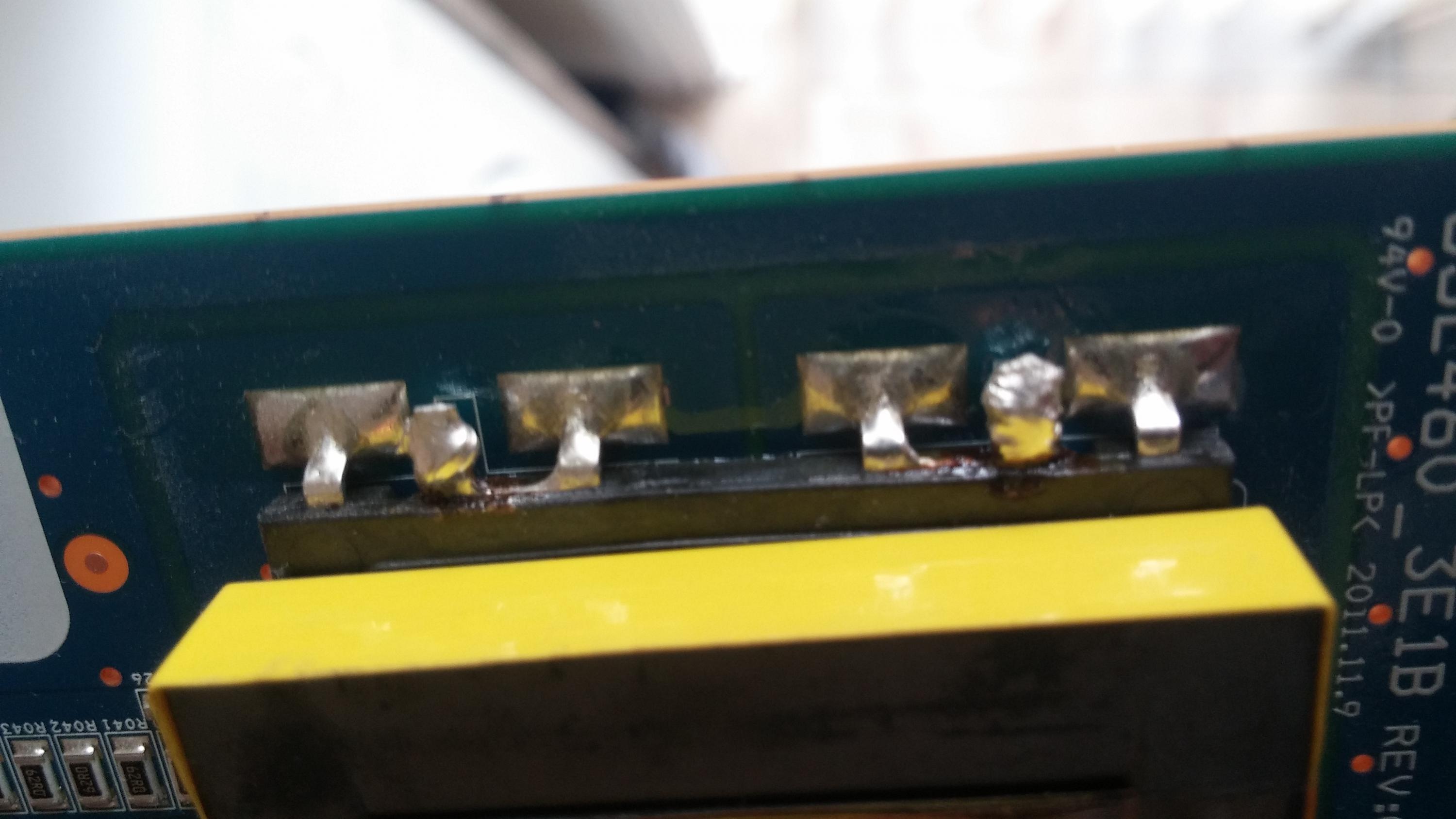

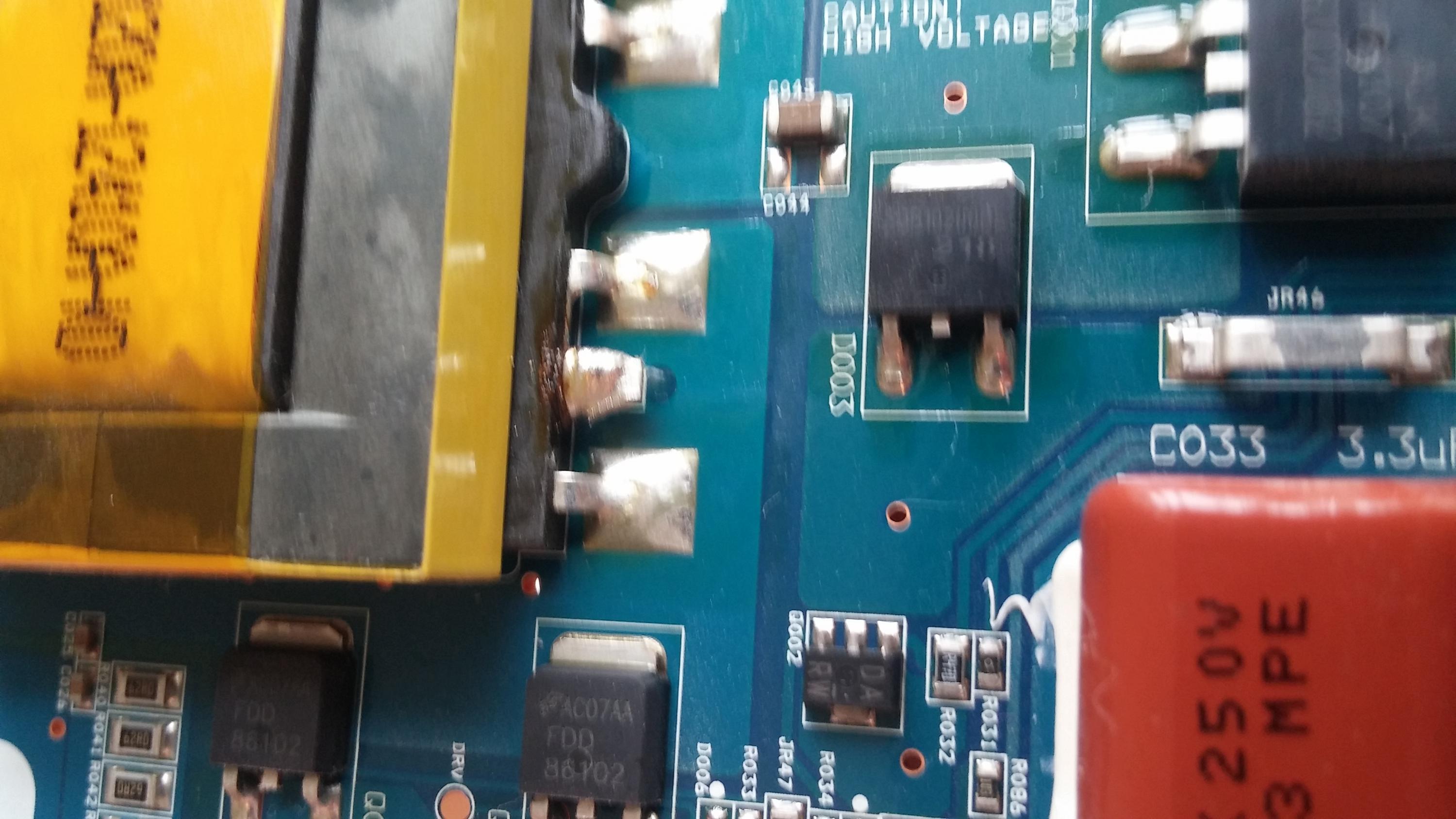

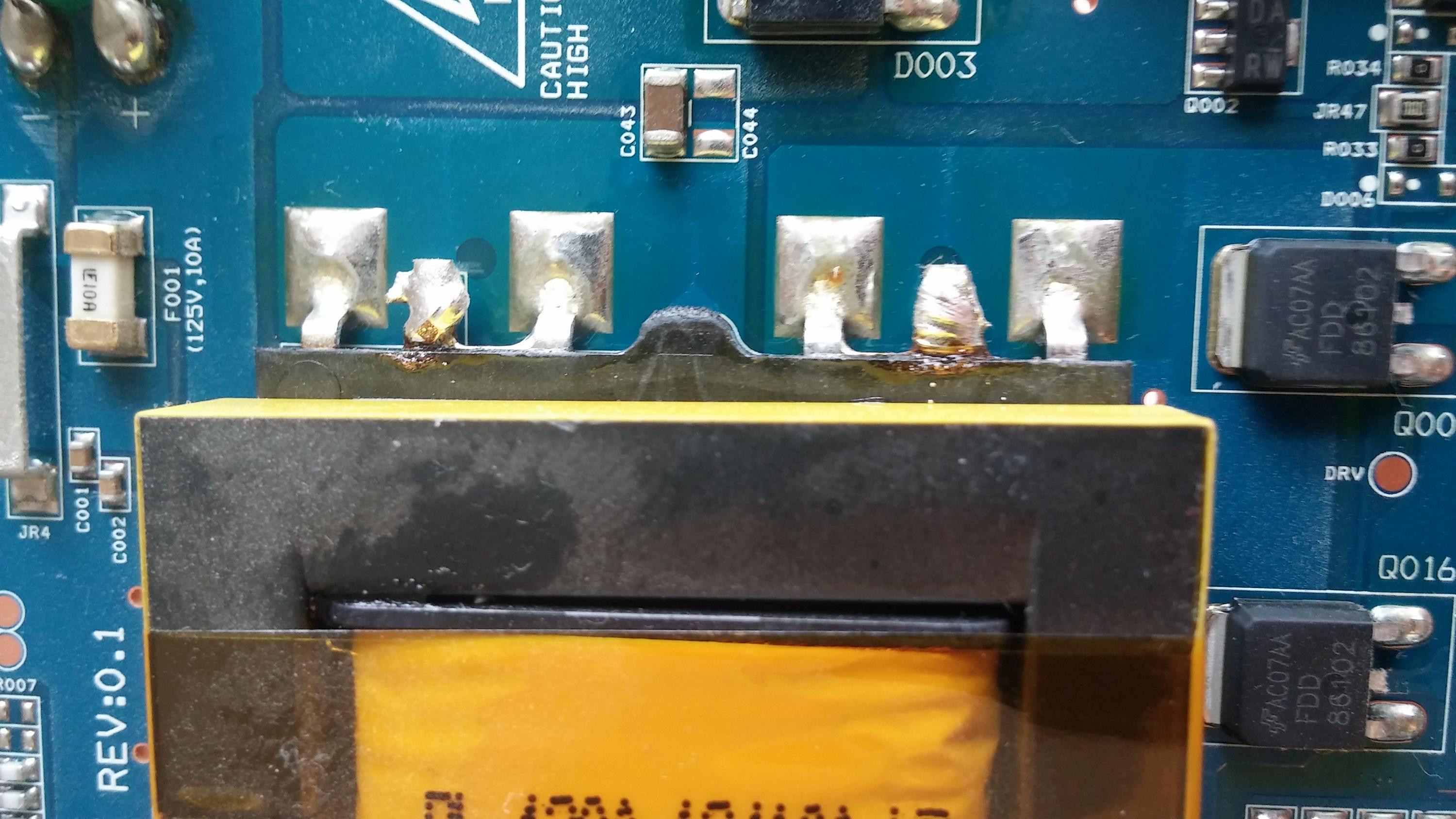

                                Managed to dismantle the screen and get to the LEDs, the LEDs themselves had no obvious sign of damage but the white connector attached to the strip did seem to have a brown burn mark on it. I've reassembled it just now as I don't know how to test the individual LEDs.
                                Incidently its a single strip down one side of the panel, right side of the screen when looking at it from the front
