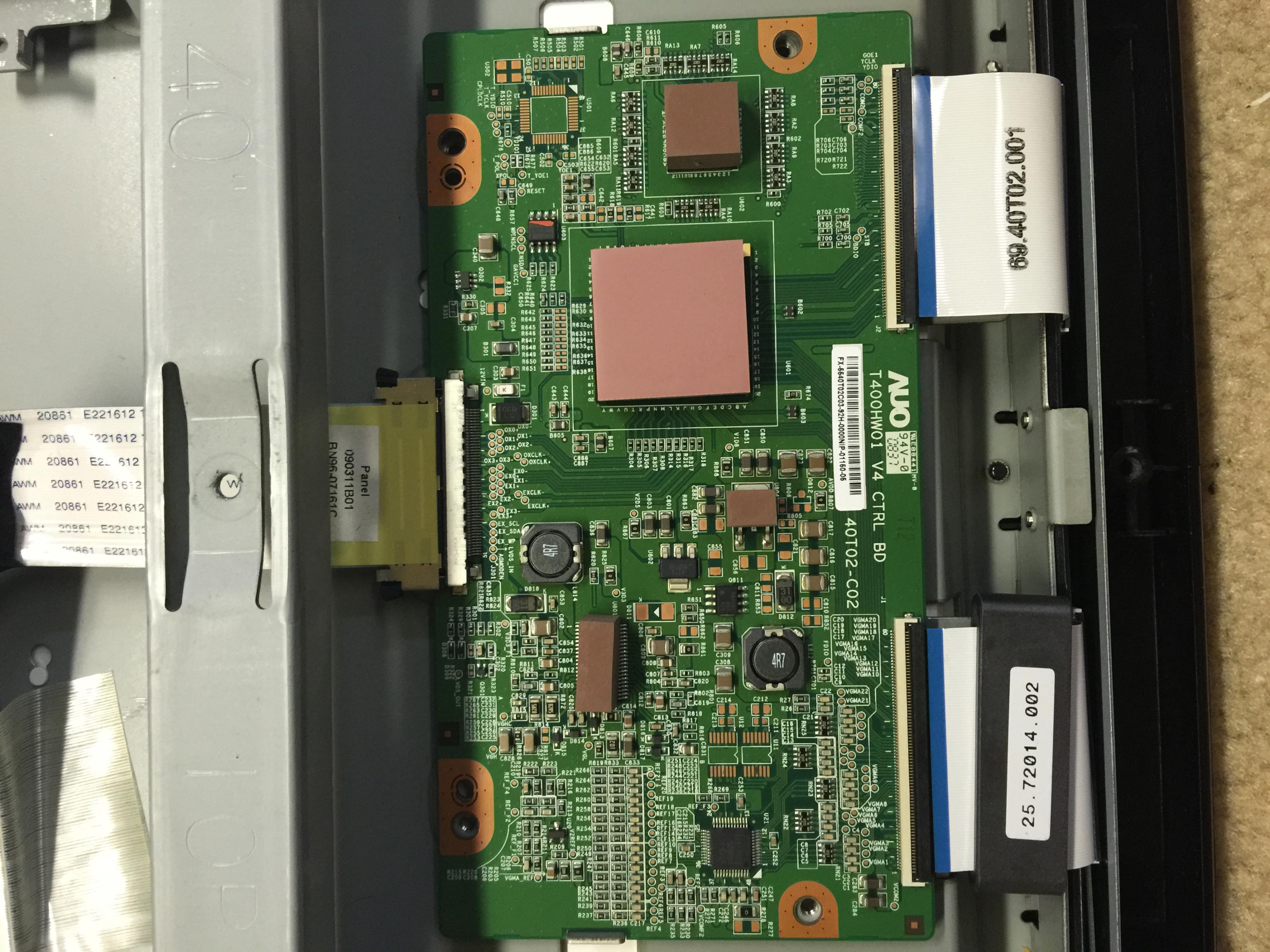

        Sorry! Thought I had them in the description.
        Model #: LN40B530P7N
        It's an LCD screen.

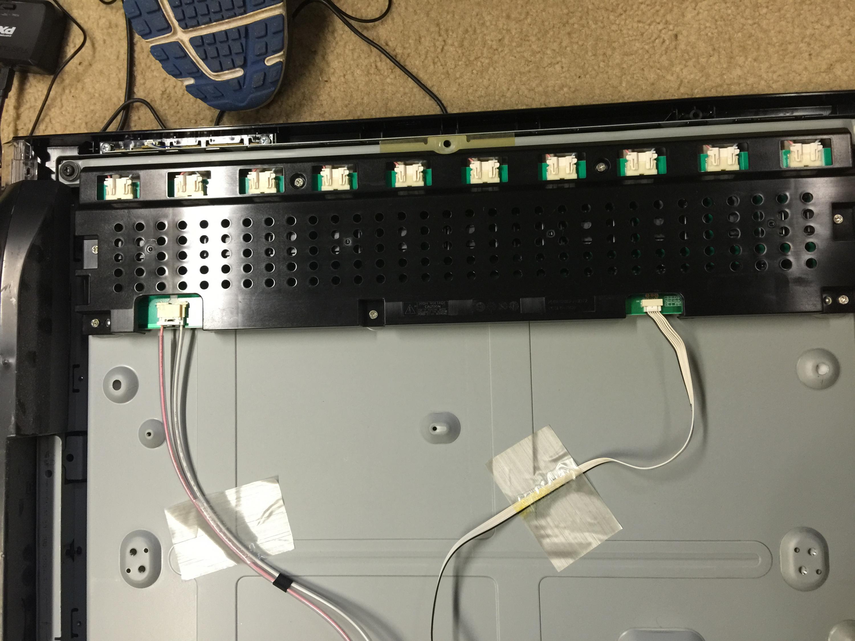

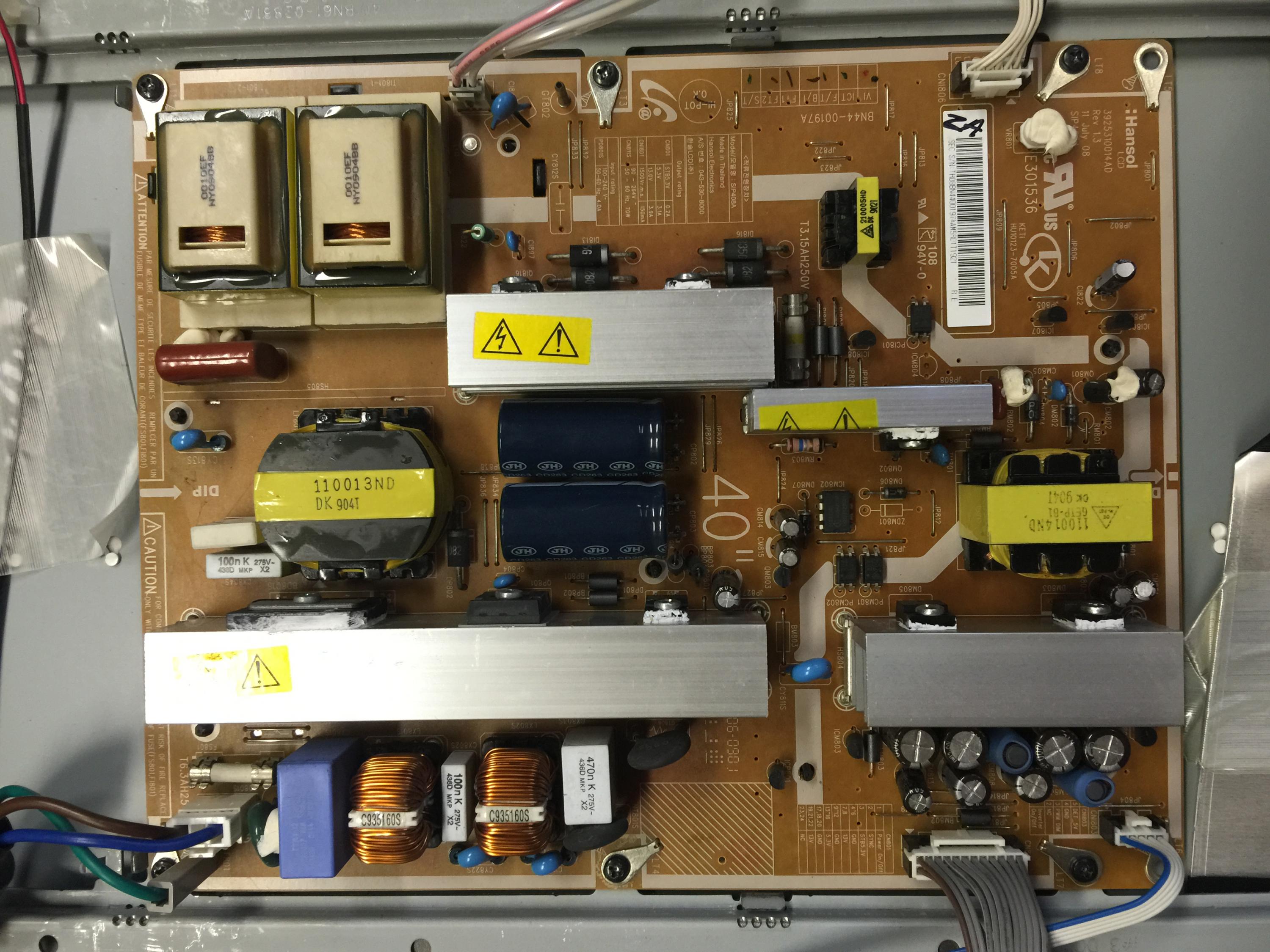

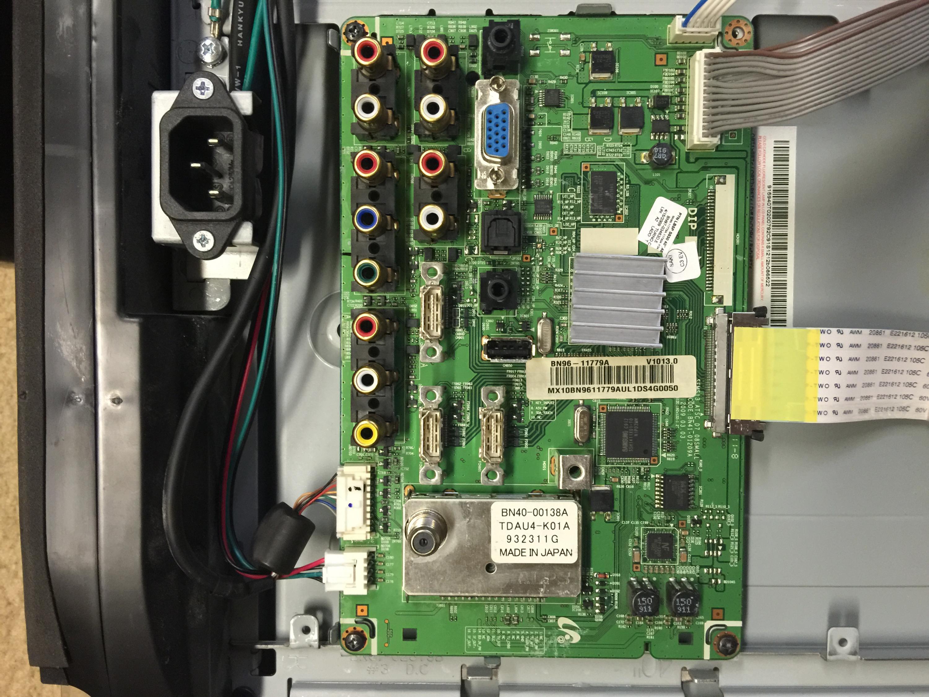

        Here's some pictures of the boards.
        Also when I powered it on moments ago to see if it gave me the same issue, it did the same thing in the video I posted earlier, but I could of swore I heard a high pitched whistle or buzz coming from the tv.

          Good pictures!
          One thing is certain, when (if) you fix this problem, you should replace the capacitors in that power supply. I see some of those evil Samwha capacitors that are known to fail in Samsung TVs.
          I'm not totally an expert at fixing TVs, other than repairing power supplies.
          I'll let some of the other folks on here chime in, they will have some good advice as to what to check (and what could be wrong).

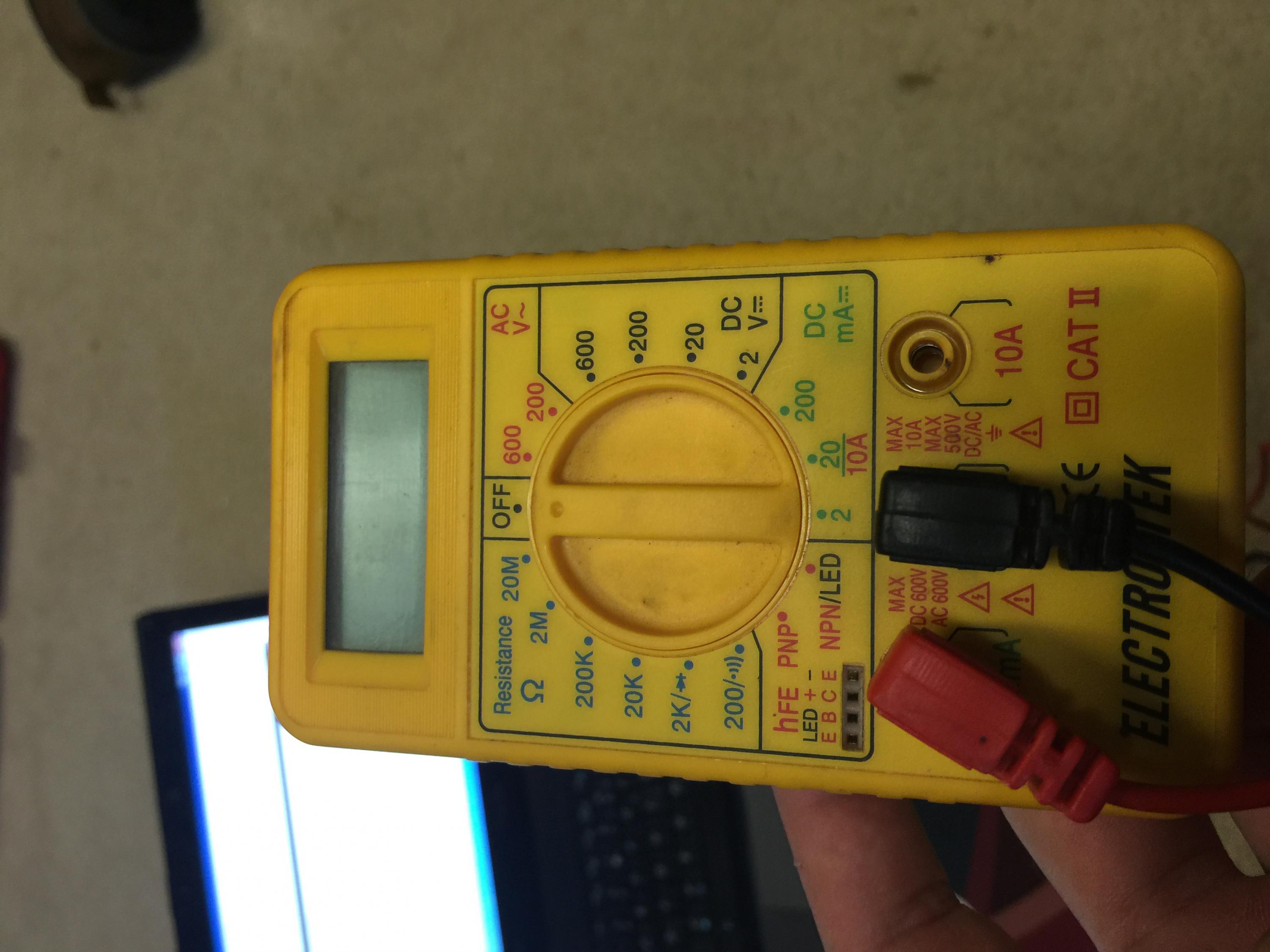

                    can you upload a picture of the multimeter your using? also has your meter had a new battery in lately.

                      Sure. Here it is. Fresh batteries put in today.

                        So with meter set 20 dc volts black probe on metal part of tv casing or tcon mounting screw tv turned on start testing points in the picture staring from 1 up to 20 i think write down your readings be carfull not too let probe slip as very small test points
                        a quick check for you meter test a new 1.5 or 9 volt battery just to prove the meters ok and no broken test lead wires etc.

                            yes bad chip on tcon i would recomend changing it ive never done a chip swop myself too be honest.
                            the start voltage is about right i think it should gradually get less towards test point 22 your is bad around point 11 and 12 try another tcon if i was you try to find someone with a good returns policy as even seconhand one can be faulty too.

                                    I worry about the buzzing sound you heard. The only times I've heard this coming from the TCON is when a chip on tab in the panel has been destroyed and the TCON is feeding a short circuit. The panel just displays solid white vertical bars later on those tabs when tested in another unit.
                                    AS15 faults normally affect the whole panel, not sections of it, but shorts on the AS15 between pins 8 & 9, 22 & 23, 29 & 30 kill can the panel. I've got two panels like that, a Samsung 26A450 and a 32A450 where someone tried a repair of the TCON but didn't remove all soldering shorts before powerup testing.
                                    AS15 legs and pads are so close they are difficult to manually solder cleanly and visual inspections after are not good enough. Solder wicks up between the legs and can sometimes wick between pads behind the legs. Use lots of flux and run a meter over the chip leg to leg, there should be no pins with adjacent shorts.

                                        Horizontal bars can also be TCON timing issues. And yes the voltages look bad.
                                        I'd have a go at the TCON or get a replacement (even temporarily). Get some AS15 chips and find someone to swap them for you. Go see your local college (uni or whatever you call them) and find the electronics geeks who work there, I'm sure they like beer.
                                        The bottom pad may or may not be soldered, easier removal if not. I've done 3 AS15s today and only one of them had solder on the base pad. It doesn't seem to have helped though, it still died.
