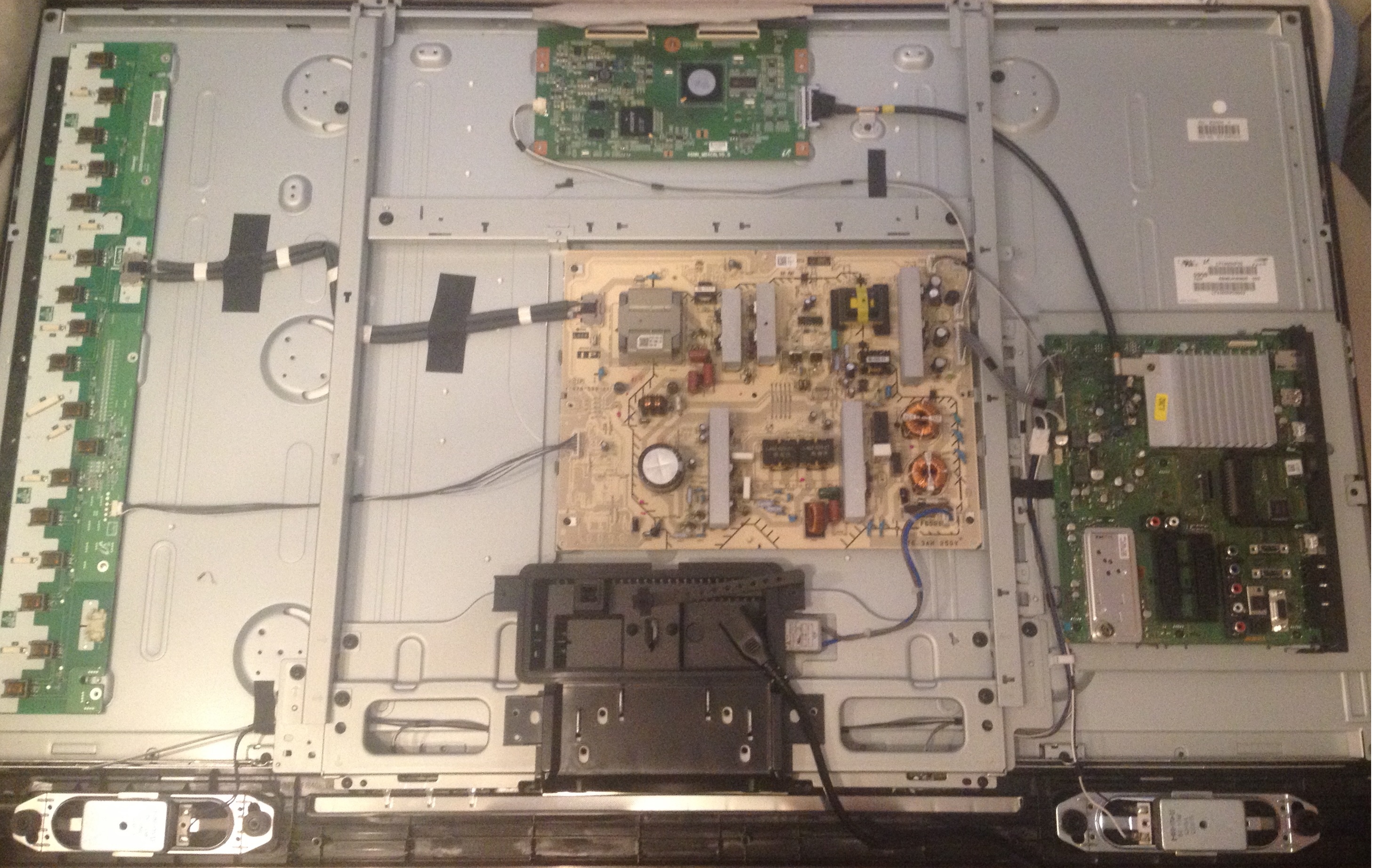

    So I got from a friend this bravia, with a fault that it has no picture. The green led comes on, but no backlight or sound. After a minute or so it shuts down and starts blinking red led(first 1 time then a second delay then 13 times and a second delay, and then it starts blinking 14 times with a one second delay at a loop). So I have taken the back cover off and measured the voltages of the main board(though the error code suggest t-con, panel or inverter/balancer?).
    In CN6150 (Mainboard) and CN6151 (T-con) everything is ok, but CN6701(inverter) the FB(feedback?) lines are at 0 volts, LD lines are at 11,5 volts and the vcc_12v is 12 volts. But the high voltage line read 0 volts.
    In the CN6154 Dimmer line is at 2,3 volts, backlight on/off is at 0 volts, inv_err is at 2 volts and barancer_err is at 0 volts.
    I have tried running the tv without t-con board, but it does the same. Do you have any ideas where to look? I was wondering is the power board broken or just some protection system that doesnt allow the high voltage line to come up.

    Re: Sony Bravia KDL-46W5500 no picture or sound
    Hi!
    I have the same problem, did you solve your bravia problem?
    Regards.
    Joao Pedro
      https://www.youtube.com/watch?v=8oZnSleucJ0
      13-code, same idea.
        jpalmeida; well no, nothing new. I am focusing to the power board next
        budm: thats not the solution, because the inverter/balancer board has no voltage in the high voltage section
          If you're not yet sorted, this thread might be be helpful.
          https://www.badcaps.net/forum/showthread.php?t=29820
