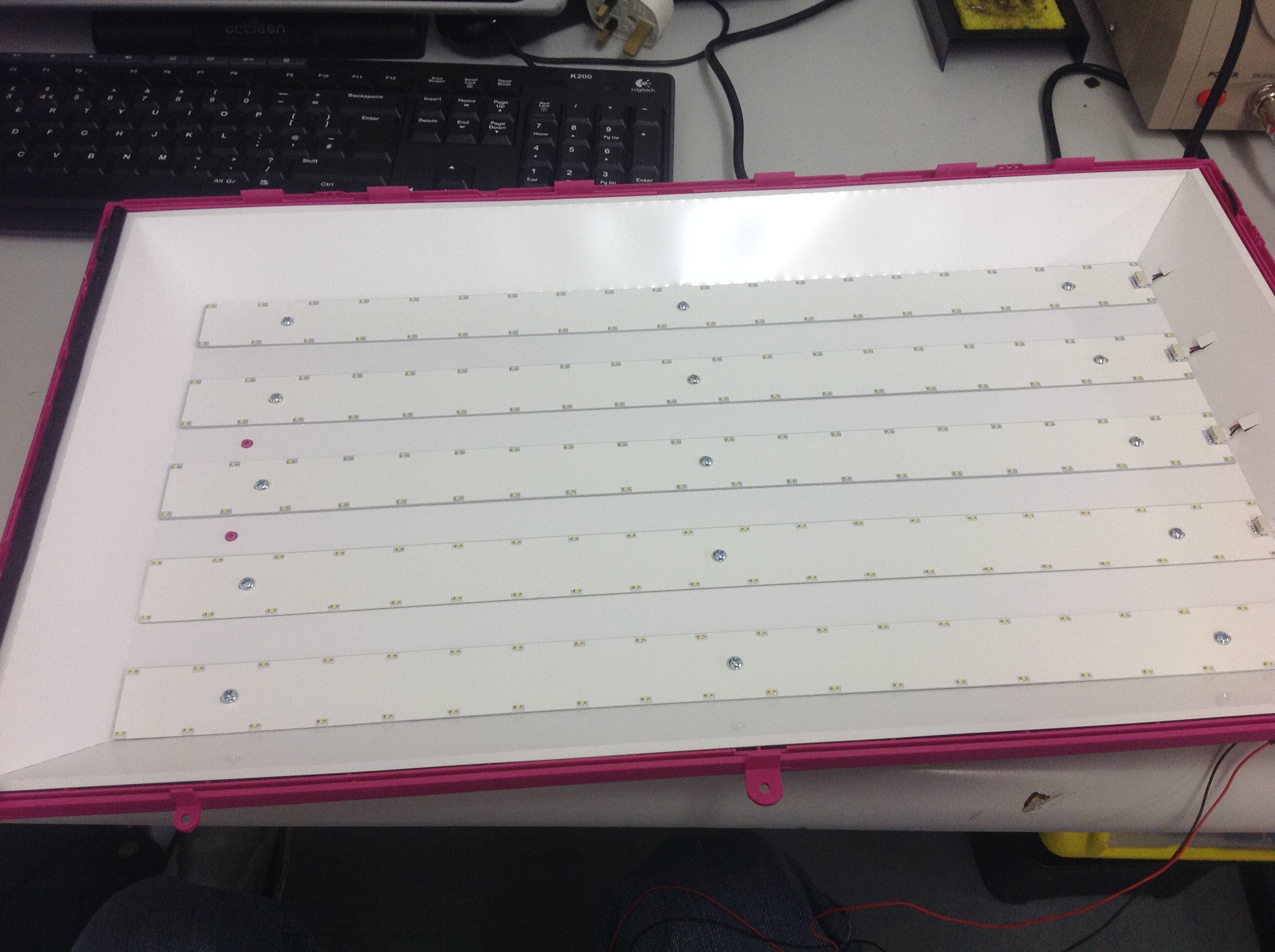

    Here I have this classic example of Vestel shit excuse the French. This is a hitachi brand rebadged Vestel crap 24" Led backlight lcd tv just 6 months old (5 months and 3 weeks to be exact) and already failed because its a Vestel and they truly are not built to last. So normally these tvs when they fail at this age they have gone past the bathtub stage in their product life as they have very little life span, normally the diodes on the psu will blow causing no standby or the firmware will go copout and cause the standby led to flash usual simple faults. Now there is a massive known fault that I have seen over 15 Vestel sets alone with the stupid and very annoying failure that im about to describe. The led bulbs them selves are actually failing. Most led tvs and especially these are wired like classic christmas lights so one bulb out all out, some full array sets will still run the rest of the bulbs even if one fails because they might be wired in parallel but these cheap Vestel's wire the bulbs in series so if one fails the whole strip wont light up, and of course if the psu, mobo or led driver detects a massive change in current it will not fire any of the bulbs. This hitachi come to me with sound no pic expected tcon or mobo but no, backlight wont come up. Opened the panel to find at leat 2 the tiny little smd leds burnt to a crisp leaving browning one the led strip with huge split marks in the centre of them. Now the huge fault and one of the main reasons why these bulbs fail is due to heat, the leds are hard working tiny devices that keep all the heat to themselves which as we all know electronic devices dont like heat. They do get cooled through transferring heat to the chassis of the tv and to the copper on the strips, but this tv did not have a metal chassis but a cheap plastic one which as we know plastic is not a good heat conductor and will not allow the leds to cool efficiently which is why the leds in this set blew up after 5 months of light use because of heat. When they get too hot the whisker in them either bridges and shorts causing the rest of the led to shatter and then fail and not pass any voltage. No why am I making this massive rant thread, the reason is because alot of the time the strips are not repairable due to the way they are assembled, I guess that they solder the leds onto the copper of the strip then add a VERY strong and thick type of pcb layer over the solder joints so that you can not access the solder to be able to replace the whole diode rather than just replacing the strips. Trust me I have tried peeling back this pcb adhesive stuff and have no luck repairing the original strips and im quite decent at soldering if I dont say so my self, making the strips almost impossible to repair. So overall my point is that I hate led tvs because they dont last Ive even seen the good high end ones like lg and panny have the leds fail after some years of use but Vestel takes the lead for blowing leds and all diodes and the bitch is these cheap Vestel strips are not repairable so you then have to find replacements at least in the high end ones you can repair the strips. Not built to a cost but built to fail and not be economically repairable. Vestel your tvs suck and I hope you go out of business and never return, yeah I guess they do keep my tv repair business going but they are a bloody nightmare so I still hate them. So in general avoid led tvs they suck and are not the way forward.

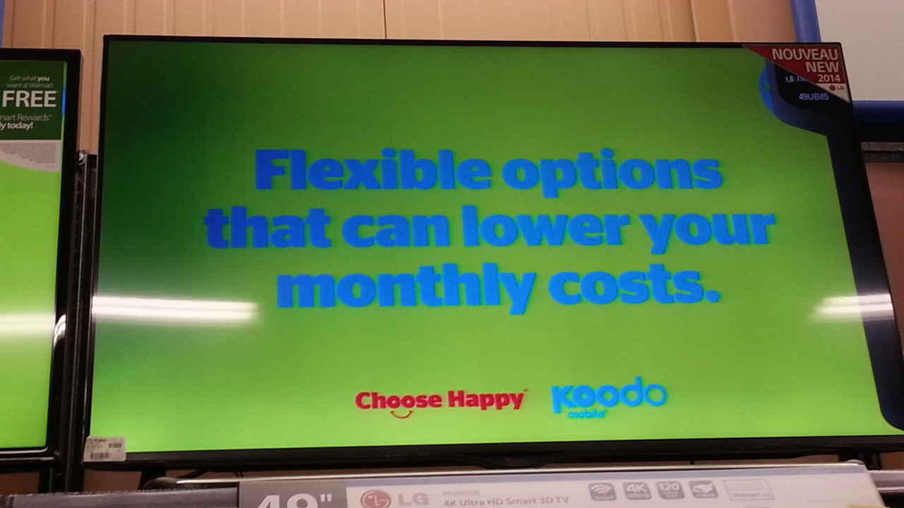

    I think I can beat that story. This one was seen on display at a local Walmart. Harder to see in the pic than in person but the upper left quadrant is darker than the rest of the screen.
    And oh ya, it's an LG 4k !

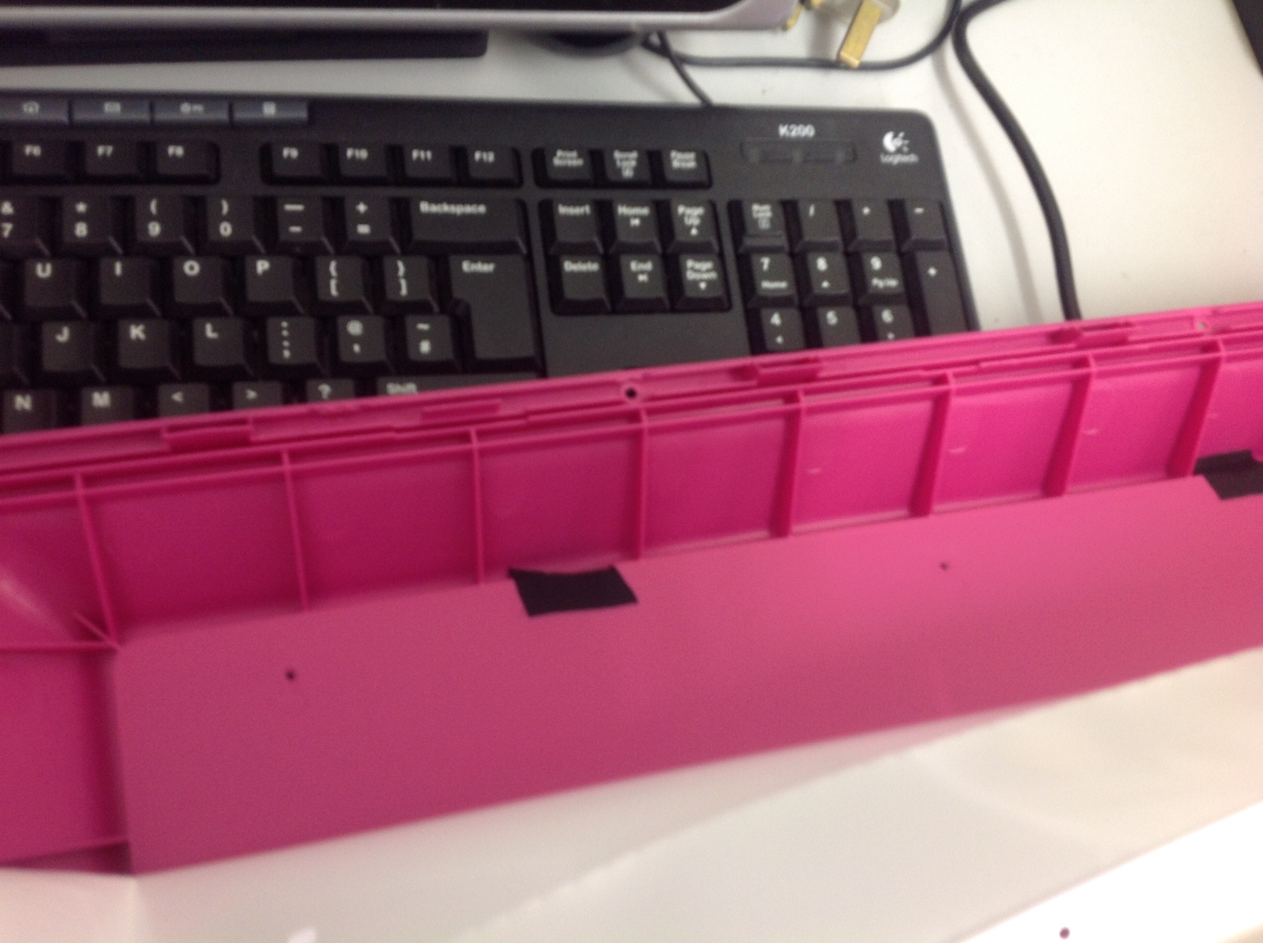

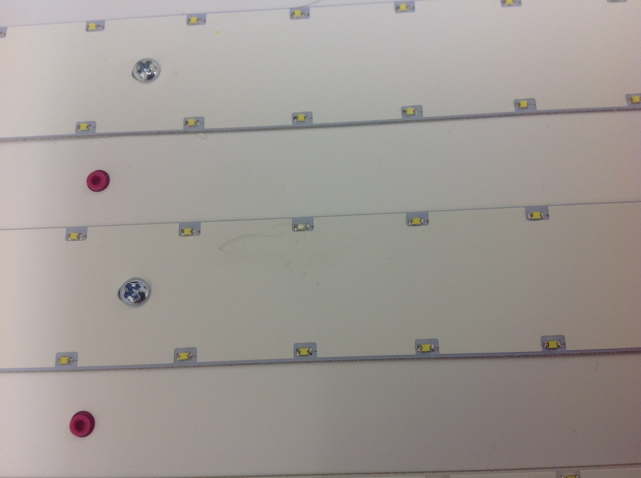

                  Here you go chaps, photos show the chassis of the tv which is pink plastic and one of the burnt up led diodes as you can see the glass on it has shattered you can see that the others still have their yellow glass on and its not like its in the middle of the strip which normally is the hottest part but I have a large suspicion its because of heat.

                    Thats 1 bad led out of the 200 in that panel, and how many of those panels non't have a problem. if that 1 led was replaced the rest of the led's might out last the rest of the tv.

                                  I just ran into a 2012 samsung. Same problem with these cheaply made 3 strip backlight systems. Edge lit seem much more reliable. This design appears to be inherited by oncorp. A. Chinese design. The backlight strips are inadequate for efficent cooling and eventually overheat and blowout leds.
