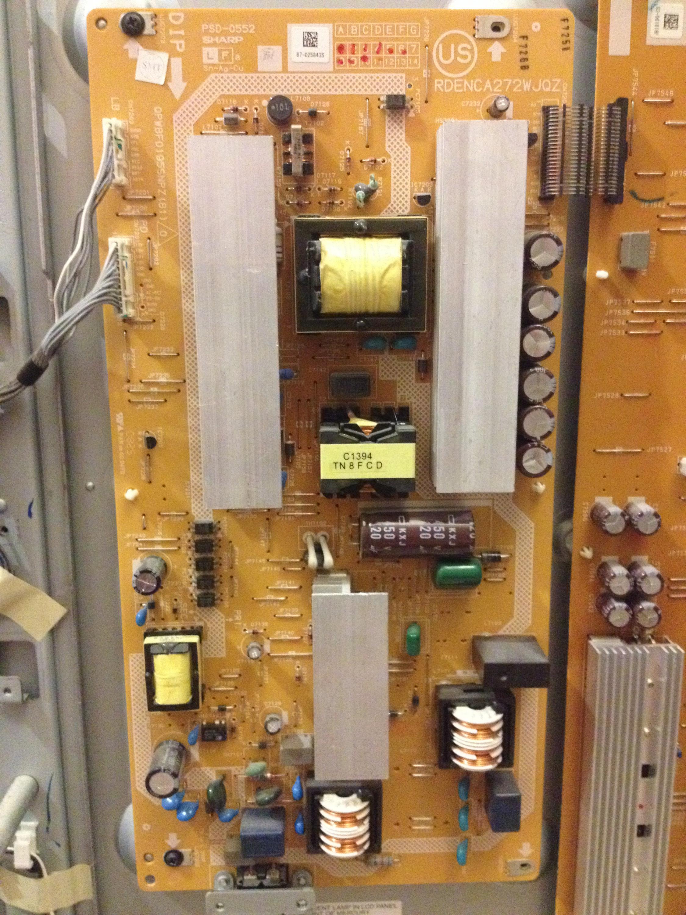

    I'm working on this tv which will turn on briefly, then go black. Symptoms are almost identical to what someone else posted about a few years ago here: (https://www.badcaps.net/forum/showthread.php?t=17101).
    When I turn the tv on the picture comes up with audio for about 2 seconds the picture then goes out. I can still see the picture with a flashlight and hear the audio.
    From some other reading I suspect either the inverter board or maybe the a bad lamp but I'm unsure how to proceed.
    (I do have another picture of the board with all the video/audio inputs on it but it's on my phone which is dead at the moment)

    Anyone know how I can determine if the inverter is bad or if it's a bad lamp?

      Re: Sharp LC-37SB24U two seconds to black
      Measure the resistance to the inverter transformers, it must all be the same.
        The inverter transformer is the one with two wire windings, right? (6 of them on my board). Where do I measure across - where do I start? And as far as measuring to the transformer, which pin? There 10 pins on each.
          The inverter transformer T7501;T7502...mesure the secondary winding
          they must all be the same
            Thanks. Is the secondary winding the one with 8 fins, not four? There are four pins on that half of the transformer. I tried to measure resistance across all combinations of the pins on a couple of them and get an open circuit so I guess I'm not measuring the right things. I'll see if I can find a pin diagram for the transformer.
              are you using the ohmetre to test the transformer?
              • tsm174
                • Apr 2015
                • 23
                yes. I can measure some resistance across the primary windings, but I don't get any resistance on the secondary windings (or what I think are the secondary windings).
                      Ok, finally got around to checking these. Secondary windings (two per transformer) all measure around 550 ohms. Didn't find any blown resistors on the inverter board either.

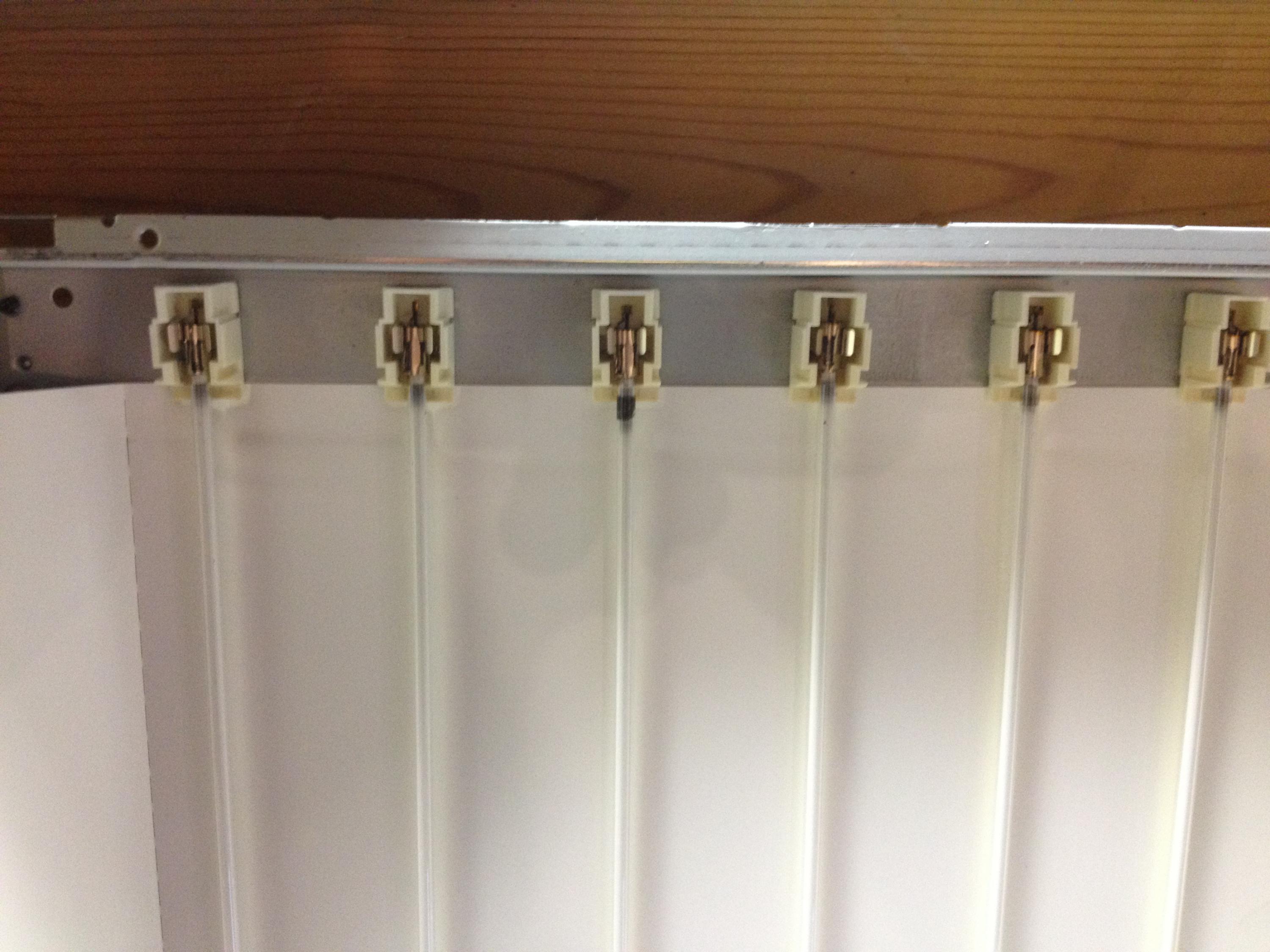

                          resurrecting my old thread - the tv went back to it's old behavior again. 2 seconds to black.
                          Based on other posts I was able to jump C7558 to fire up the tv, reset the lamp error and monitor errors, and the TV looks good.
                          I was able to verify with the test patterns in the service menu that all the bulbs are firing (as far as I can tell - the whole screen looked bright white.)
                          BUT, I read that leaving c7558 jumped is a fire hazard, which I don't want to leave. Is there a way to further diagnose what the issue might be?
                            At this point I'm more or less ready to throw in the towel, so I opened up the panel to inspect for bad bulbs. Again, while I think they are all lighting, I did find one that has some black at the end of the tube. Maybe this one is failing?
                              I would say that bulb is your likely issue. Its probably failing to start some times, increment a counter which eventually causes your set to turn down and not run any more.
                                    Its a common problem with sharp sets and is usually caused by the white plastic holder the lamp is clipped into making a bad connection to the CCFL.
